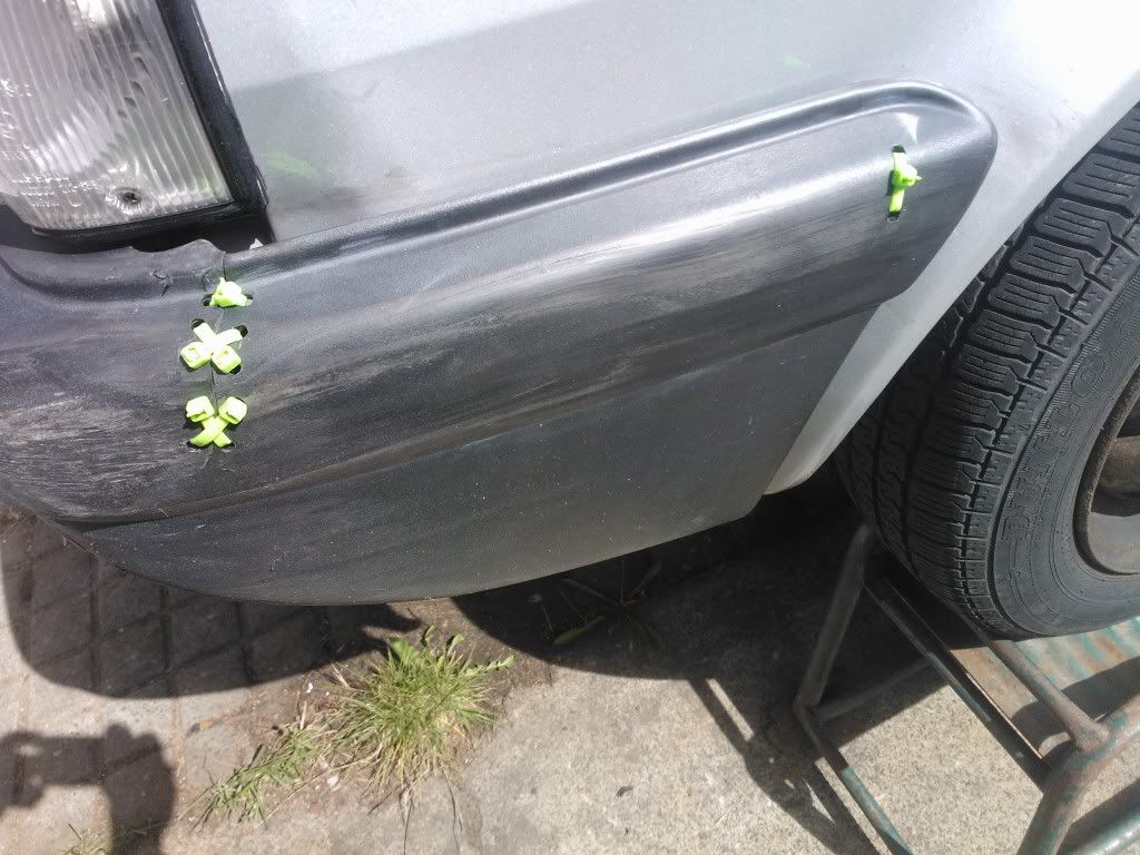

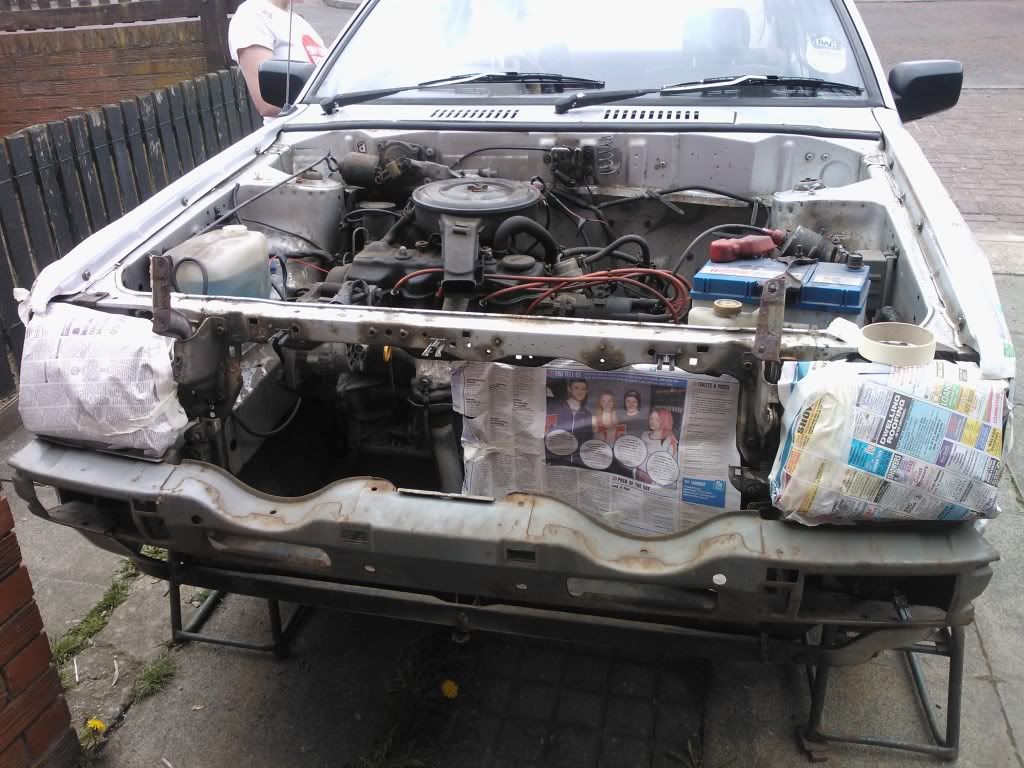

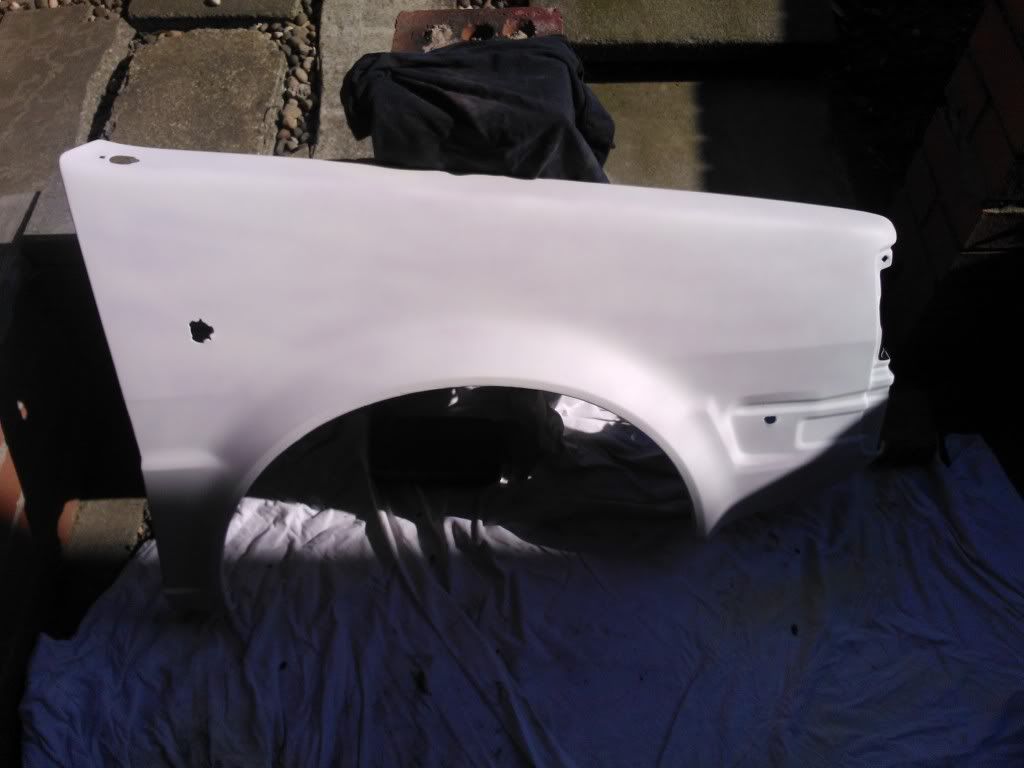

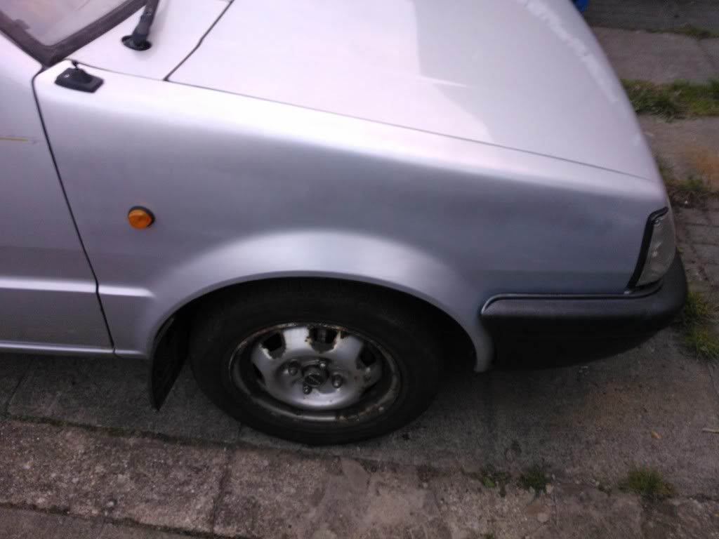

fitted new discs and pads ordered new rear shoes, fitted the wing, doesnt fit the best cos whoever removed it bent it o_O

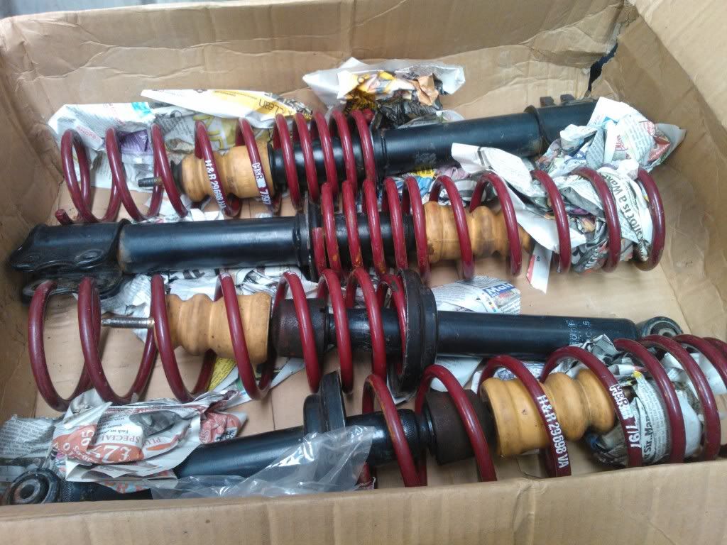

the 2 rear shocks are leaking one of the front sound like its on its way out, thinking i might get some uprated ones and possibly lowering springs, what do people think?
i would if they didnt need to be modded :/ was looking at the monroe reflex dampers and lowering springs
Get stuck in mate and give it a go, if I can do it, so can most people :) first thing I ever made was the polo coilovers mod, now I. Making all sorts.

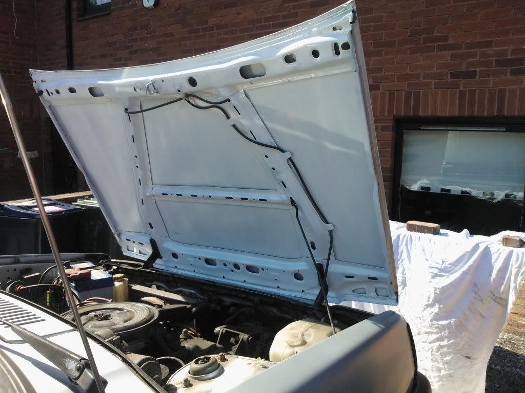

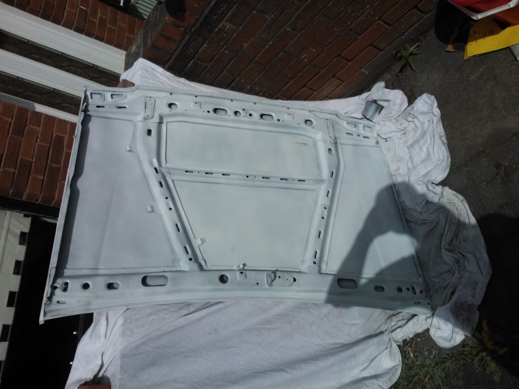

thinking about locking bonnet pins on each corner so i can just lift it off for easy access just not sure

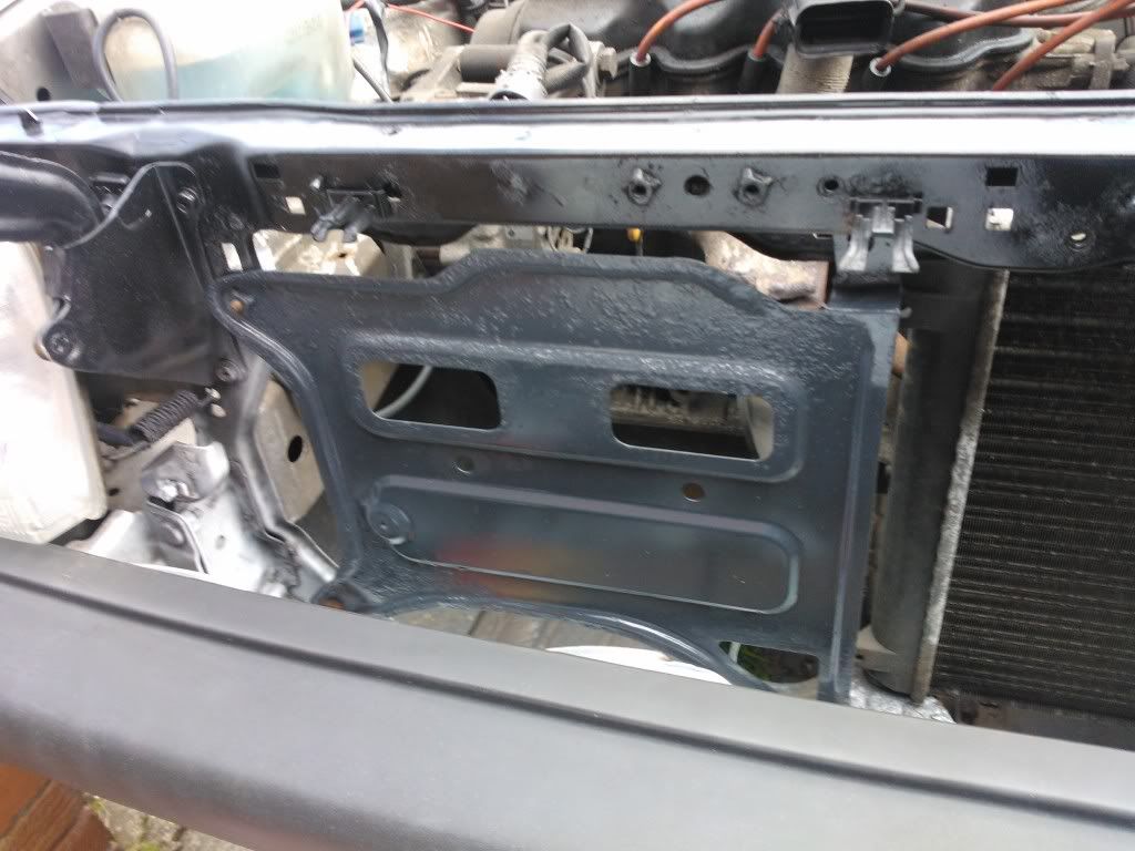

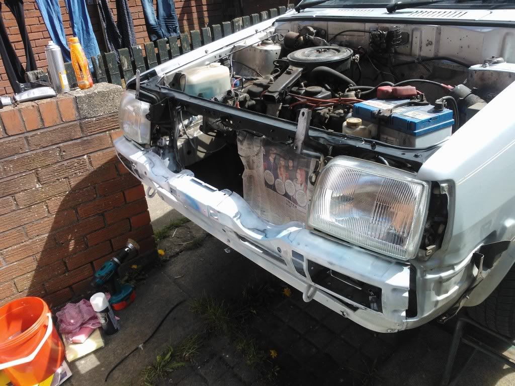

its not too bad thats why i did it myself lol its just hammerite direct to rust im wanting to do the bay just need the time do strip everything out
And on a serious note, youre doing a mint job mate :) And assuming the coilover modding is the same as for k11 you dont HAVE to weld them, if you bring the hole inward a bit, giving camber at the same time, you have enough metal left that welding isnt needed. (polo coilies that is)
Haha well mine arent welded and tbh i dont feel they need it, studs on mine dont even rest on the outer part of the hole as its slotted so the part that would have been welded is actually barely being used. Still, doing it "properly" is probably more advisable
