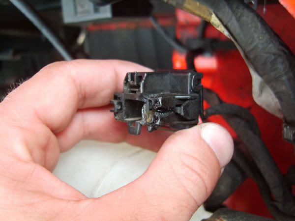

Yesterday I asked the MSC what could be causing my noisey sidelight problem:
http://micra.org.uk/showthread.php?t=15504

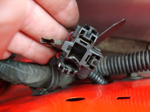

I was advised that one of the headlight bulb connectors may well be loose or even melted.
I checked this morning, and what do you know, they were BOTH melted lol
Driver side:
Passenger side:

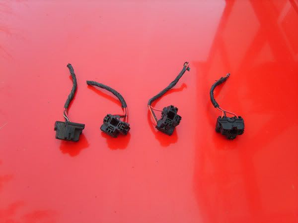

So I went to the scrap yard and got some replacements, and spares in case it happens again:
And hey presto, no more noisey sidelights! Cheers guys!

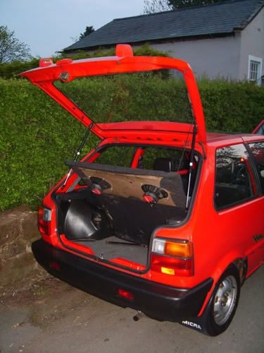

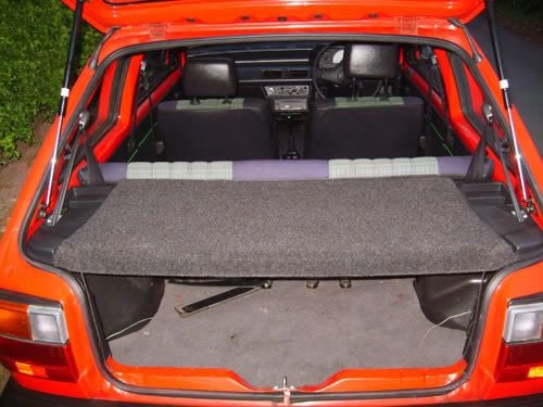

Today I had to get some parts from Chester and go and see my Gran in the mental home so I didn't have much time to do anything today, however I did manage to find time to change the oil and oil filter again. That's the 4th oil change in 1000 miles, because the oil that was in the car was seriously gloopy and had obviously never been changed. I was advised to use an engine flush product to get rid of all the really bad oil that was sticking to the engine, but you couldn't pay me to use an engine flushing product on an engine of this age to be honest, so instead I did lots of oil changes, the oil looks about right now so I'm pleased. Now I will just change the oil at the normal intervals.
I also discovered that when my stereo is on too loudly my back window and rear view mirror vibrate so that everything in my mirror is really blurry....this annoys me, so I'll keep the volume down until I can find a way to reduce the blurry-ness...not sure if that will be possible though.
Lol, sounds like Arnolds car!! The whole thing shakes so much. It feels like the seats have massage things in them!!
Yeah that's what I get with mine, the seats pulse quite badly and it's annoying when I'm concentrating on driving, I tried to take a video of the seats pulsing but you can't really see anything.

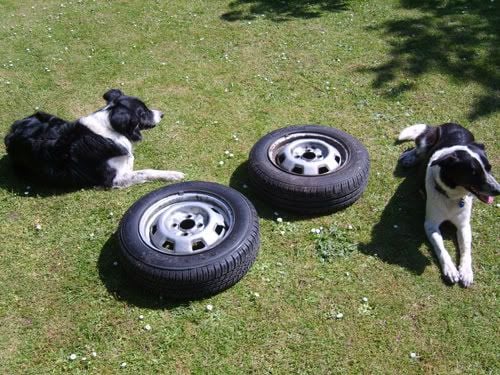

Well today me and my dogs (Meg and Bud) decided to get cracking on the refurbishment of my steel wheels.
As you can see I am only doing them in twos. This is because despite the fact that I currently own 9 Micra wheels (including the 4 on the car), 2 of those wheels have got screws stuck in them, so I don't have a complete set to swap my four over with unfortunately. Anyways, I started with the two rear wheels. As one of the rears was in the worst condition out of the lot:

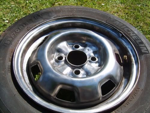

Yuk. Anyways, after much wielding of the angle grinder with wire wheel attatchment, I got the worst wheel looking like this:
I haven't got all the muck off yet because the wheel wasn't big enough to get into some parts of the wheel, and I don't have any bigger wheels in the garage, but I think I've made a good start on my refurb. I also need to get the tyres off the rims before I can do much more cause they're getting in the way, especially where the valve is.
Getting this far as thrown up another issue for me. I was originally going to paint the wheels black, as I think it would look better than painting them silver...as I think silver paint can look very tacky very easily. However now that I have taken off the original Nissan wheel paint, the metal under neath is quite a nice colour, a deeper colour silver, and shiney...and I quite like it. So I was thinking of maybe just cleaning them up thoroughly and then just spraying a clear laquer over them to seal them from rust.
Comments would be appreciated as I'm not sure if that would work.

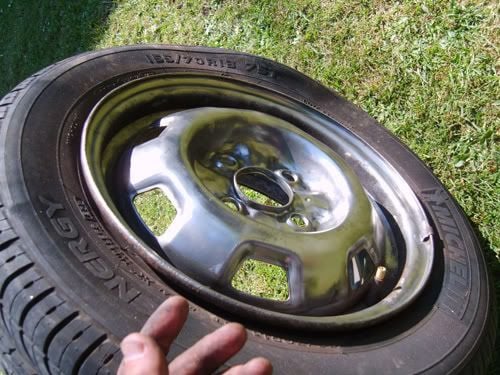

For your convenience, I just sandblasted one wheel...it took a lot longer than I expected (never tried sandblasting anything before) and it only took the paint off when the compressor was at full compression, so I could only blast for about 10 seconds before the compressor went off pressure and thn had to wait like a minute for it to build up again...plus I used a hell of a lot of sand, and I still didn't get all the rubbish off because I ran out of sand....and the result...a cleaner wheel, but not shiney, at all. I lent my digi cam to my little brother but when he comes back I'll post up the results so you can see. My compressor is only a 25 kilo compressor, if you've got summat like a 200 kilo one then you'd make short work of cleaning up anything.
I'm sure you could sandblast them, then use a polishing wheel to get them shiney again, however I've decided to just paint my wheels black after all. i wanted to go with the shiney finish, but I've spoke to a few bodywork people and they've all recommended NOT laquering onto the shiney surface as, apart from the fact that the wheels get too hot, the laquer also won't grip the surface. It's a bit annoying but to be honest it's taking ages to get the wheels to a shine that I like, and one wheel in particular is suffering badly from pitting from where the rust was. So, once I've finished cleaning them I will coat them in red oxide to stop the rust, then primer them, then paint them.
