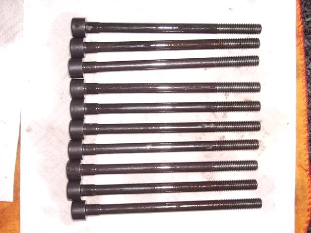

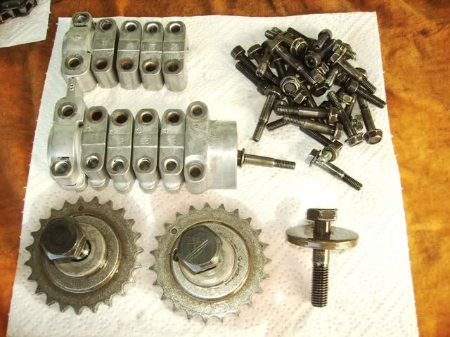

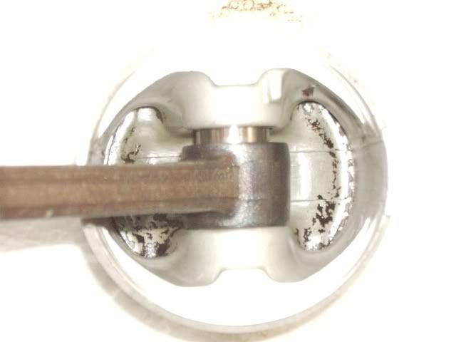

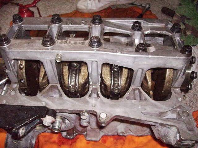

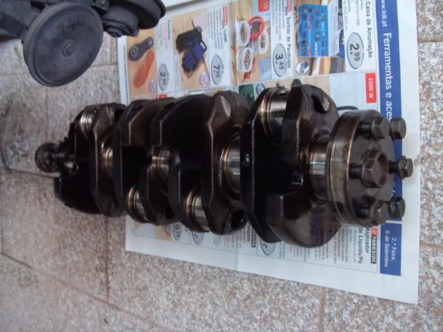

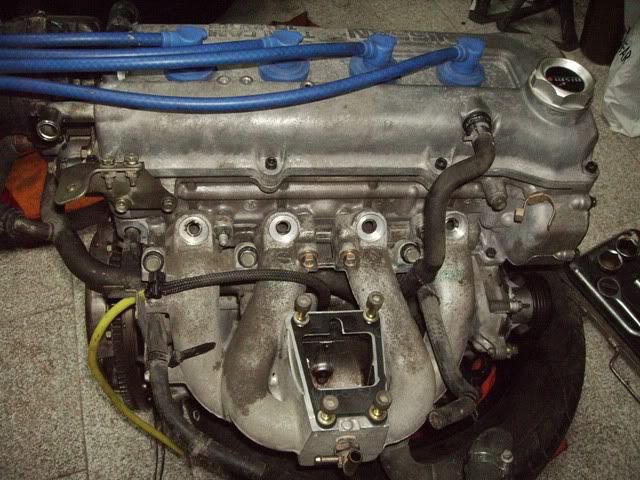

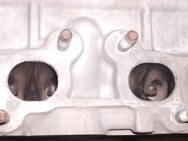

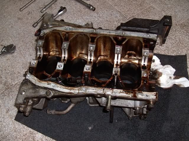

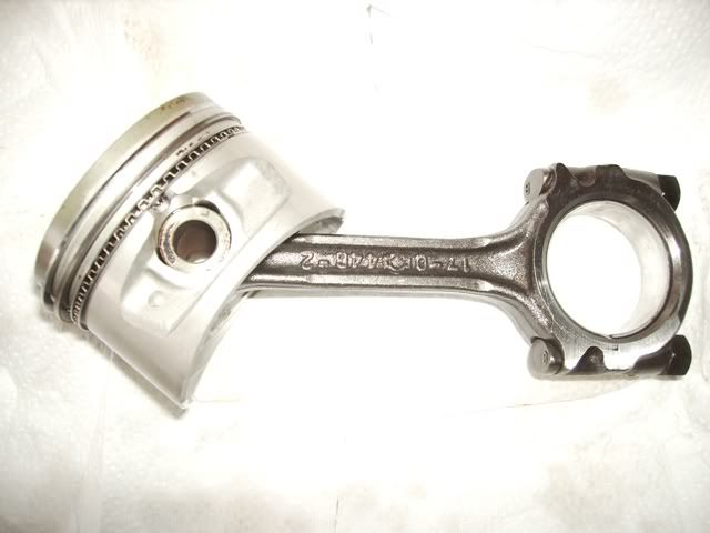

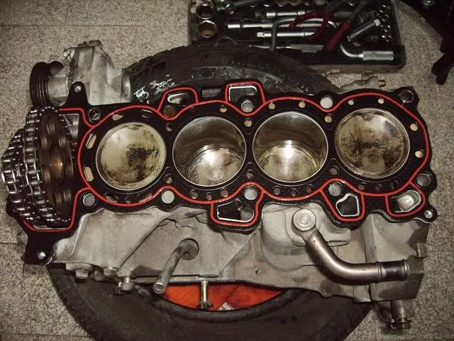

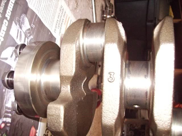

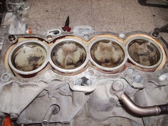

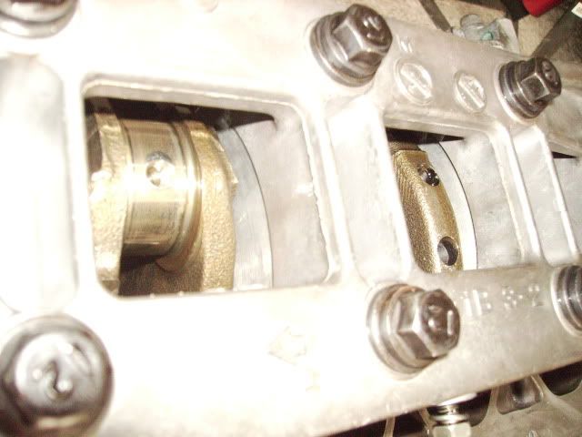

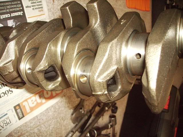

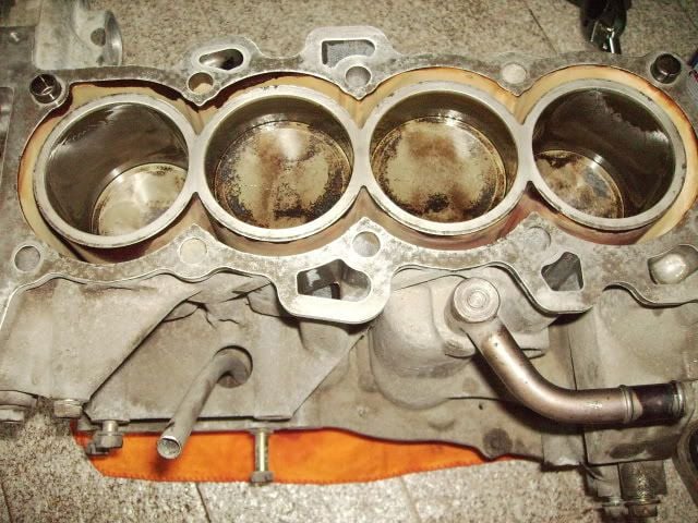

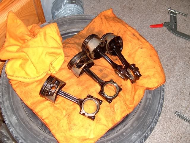

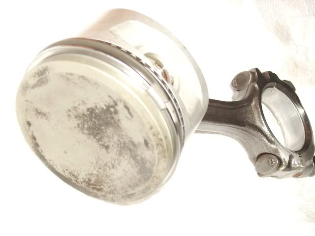

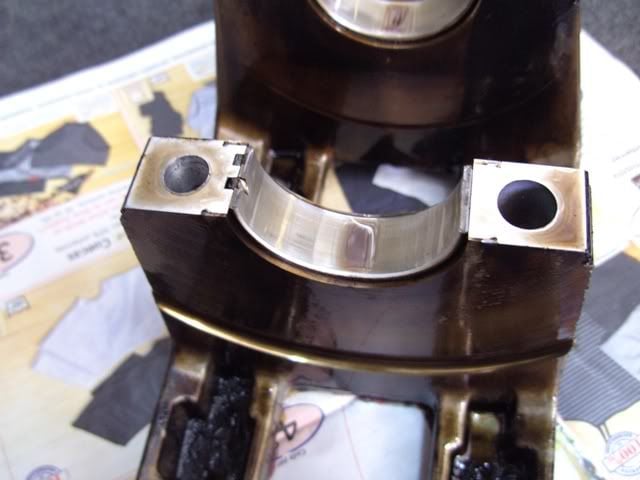

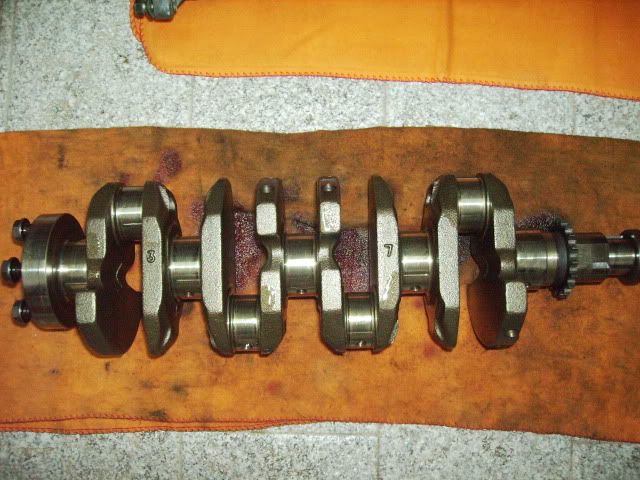

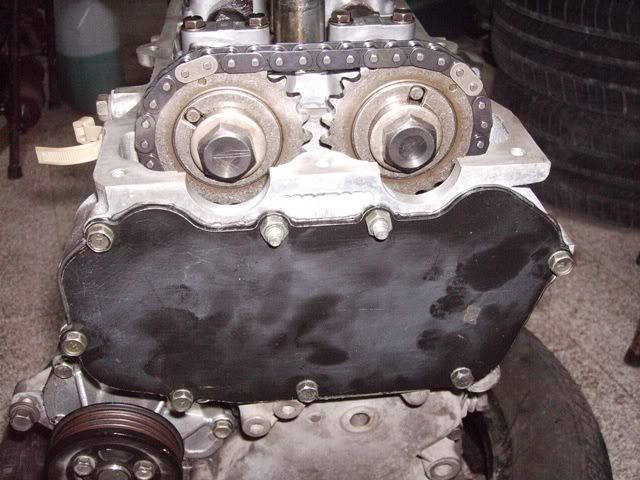

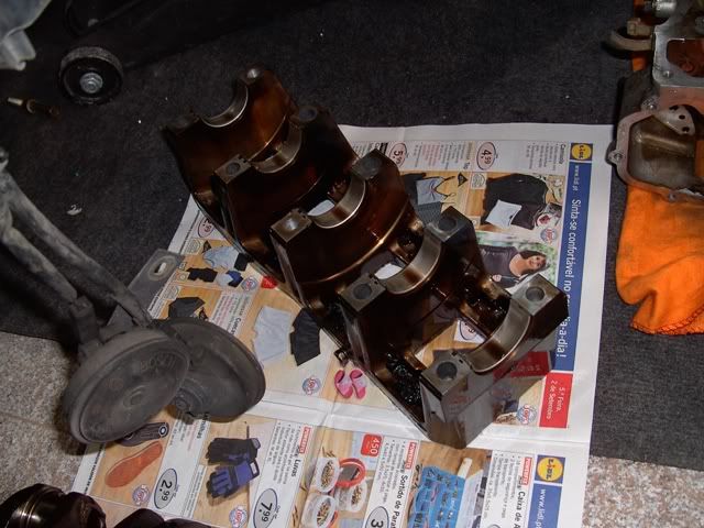

Some more things done on the engine. The HG was glued to the block, its all dirty on the inside, but the crank and the bearings are ok. Pistons rings look ok, just the oil control rings looks a bit clogged, but nothing special. Will take more pics tomorrow.
ah nice. memories of when i overhauled mine.

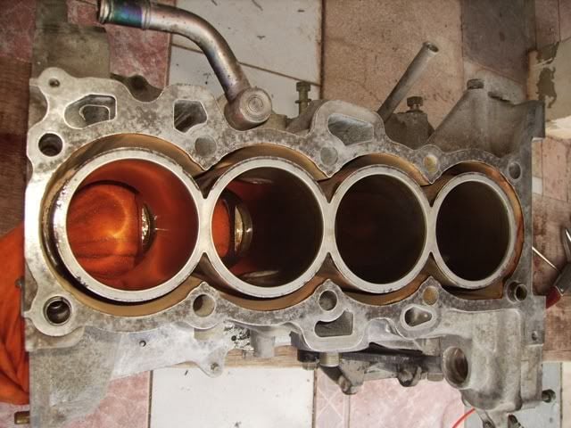

i see some burn marks on the back of cyl1 gasket ring, ya think thats where it failed?
Most probably yes. Now the previous owner says that the HG failure was repaired, but the HG its ####ed up, and the head has its water circuit full of rust (and the block too), if a machine shop had it to repair, it would be cleaner, right? :down:

i wonder if it previously overheated, crushed the HG, blowing exhaust into the coolant and resulted in lotsa fumes through the coolant system or prev owner didn't change the degraded coolant and so rusting the internals?

have you measured the ring-gaps with them inserted in the bore mate ?
Not yet mate, need to clean the engine block a little better. I inserted them again on the pistons to check the ring-to-piston gap, seems ok, will check the ring-gap soon. Thanks for the tip. (Y)

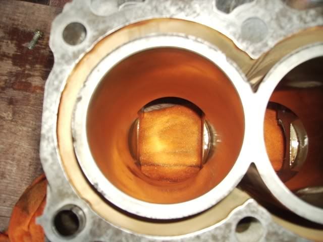

Tomorow i will buy a kit to settle the valves just right, clean the block a little better and check the piston rings end gap. And i will use some alluminium cleaner, it says that it reacts on contact with the metal surface and needs to be washed with water right away, i think i will mix some water so its not so concentrated. But the water passages on the head and the block needs to be cleaned, it has so much rust "glued" to it...

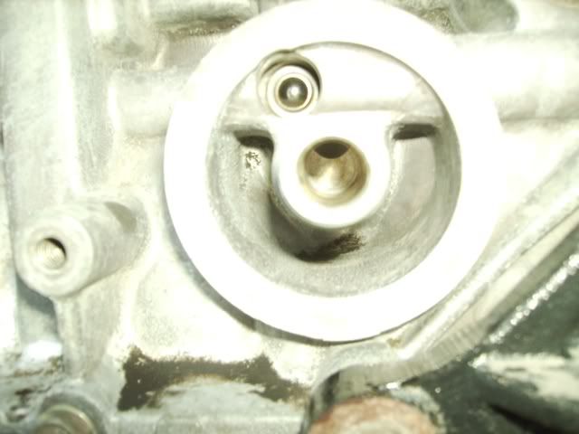

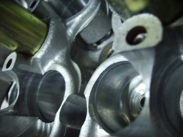

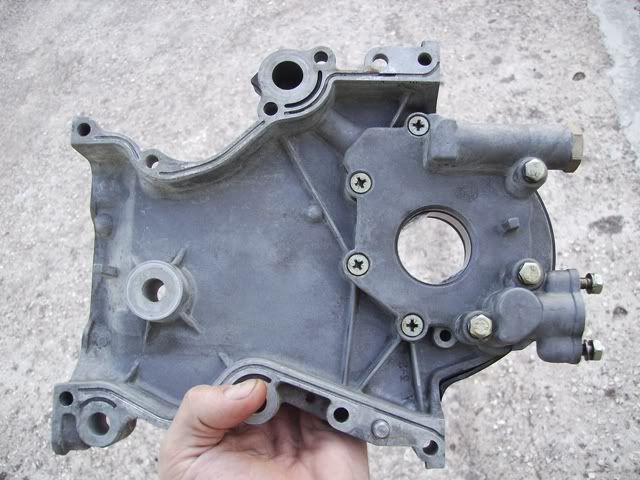

BTW, is it normal to put some oil on the oil pump, drive it manualy, and some oil goes throught the middle section where you drive it? Its just a bit of oil, not a big quantity, just enough to "wet" that area...
the gap in the shaft will be closed when the pulley is bolted up tho wont it mate ?
Maybe youre right, with it on the block and the pulley bolted, it will have less gap. But i will check the other oil pump i have (better condition), if it does the same thing, i will use the one i cleaned earlier (from this engine im rebuilding), otherwise i will use the other i have.

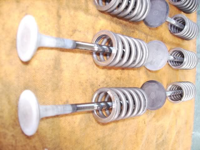

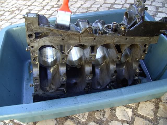

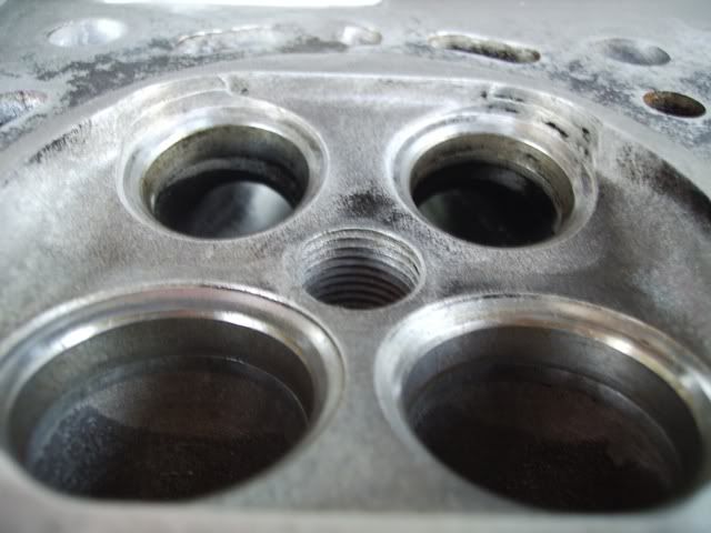

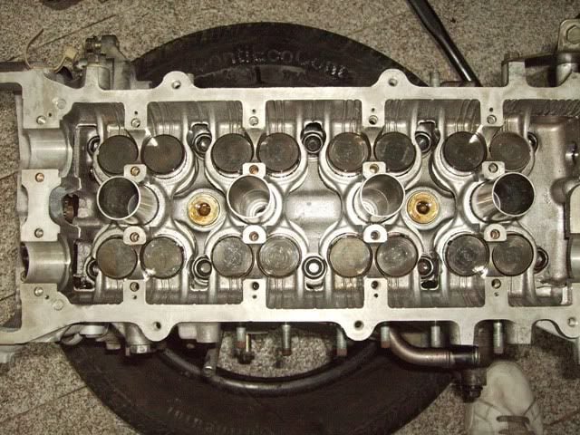

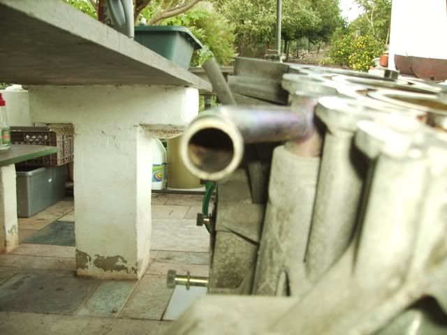

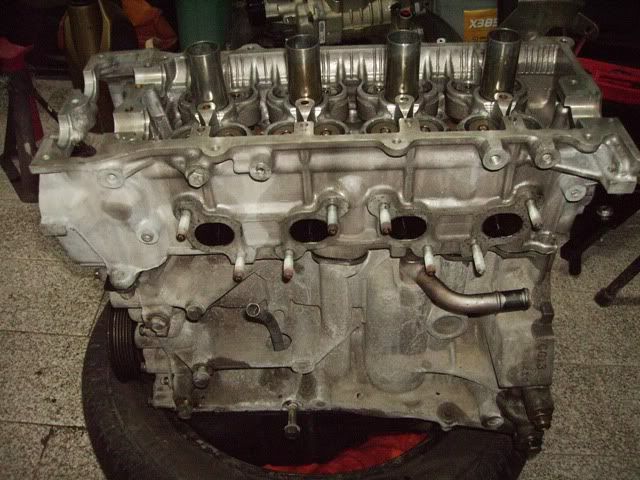

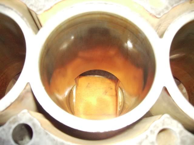

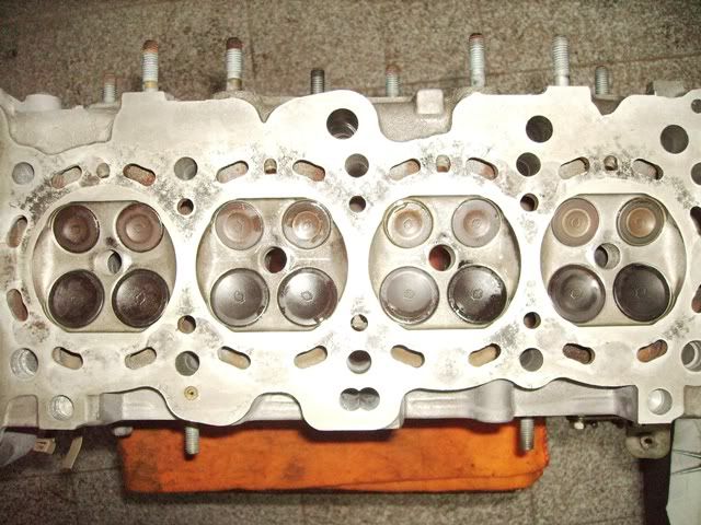

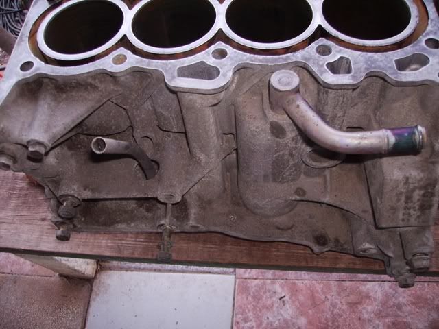

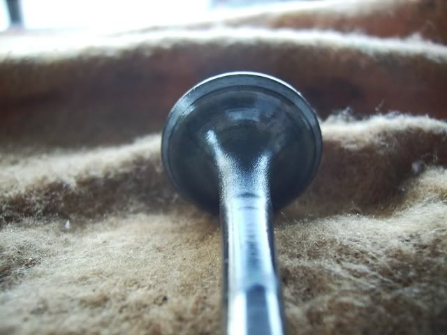

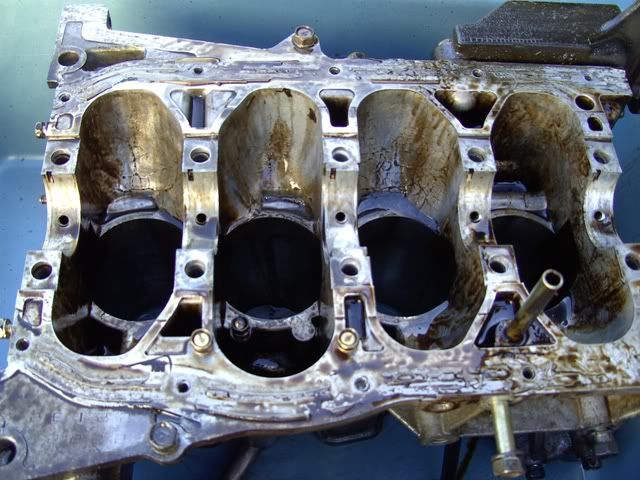

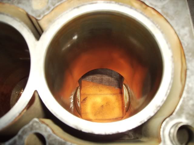

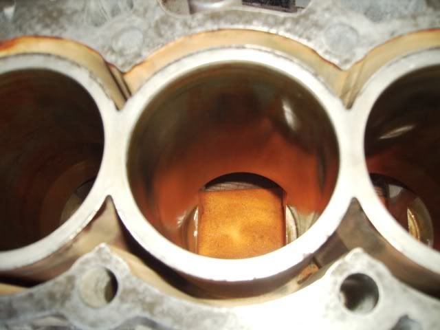

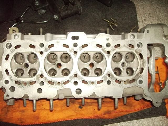

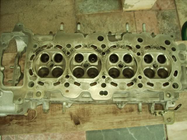

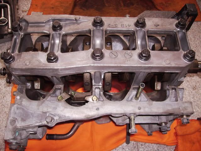

Today i grinded the valves, cleaned the block, checked the piston rings end gap (2nd compression ring on 2nd and 4th cylinders are near the limit, i will check if i have some bigger ones) and the water channels on the head are clean, on the block i couldnt get it clean.

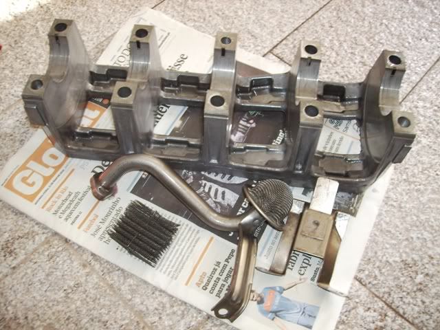

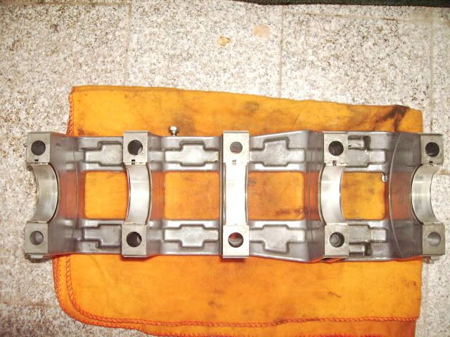

Block already cleaned:

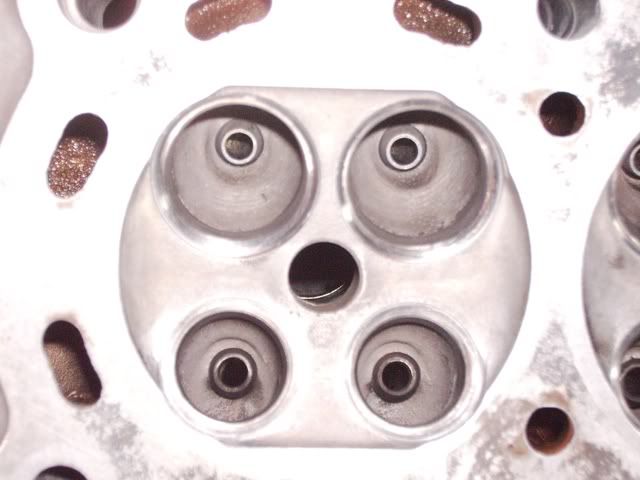

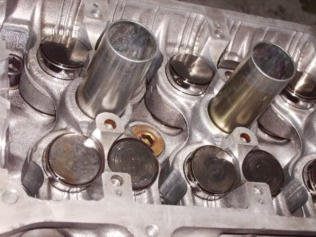

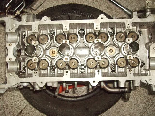

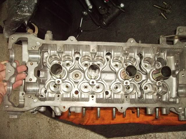

Head after grinding the valves and cleaning the water channels:

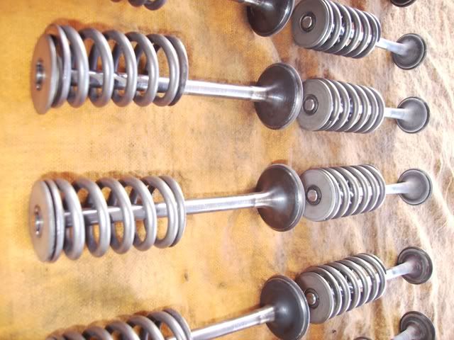

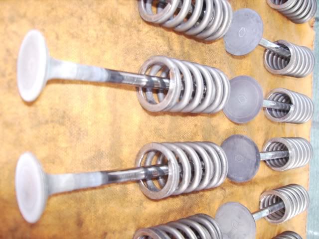

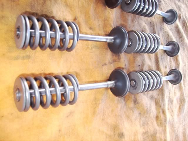

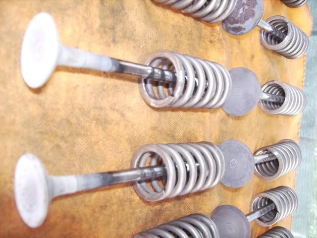

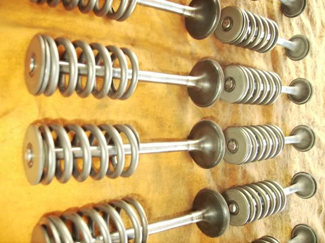

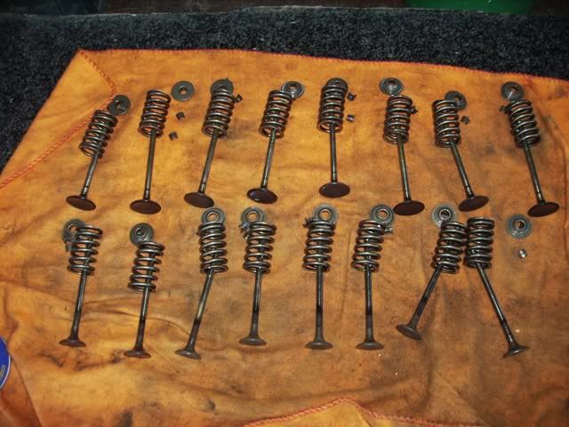

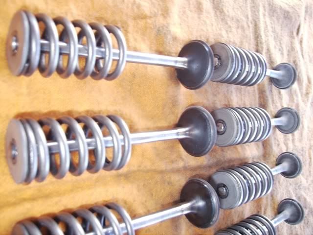

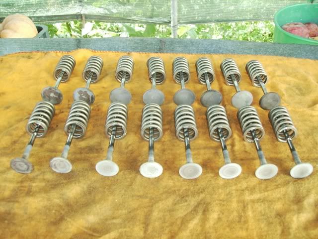

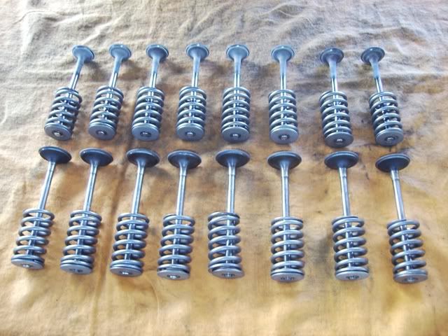

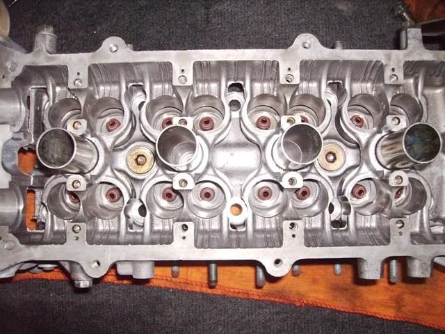

Valves already grinded:

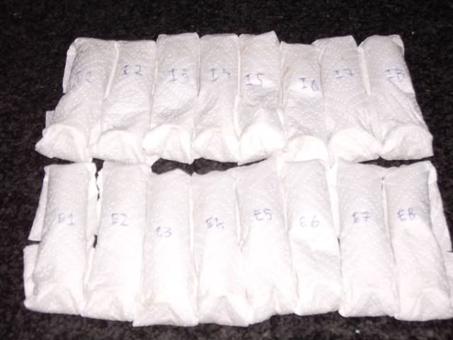

Numbered and oiled ready to store them:

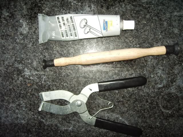

Here the valve grinding kit and the piston ring compressor (helps big time):

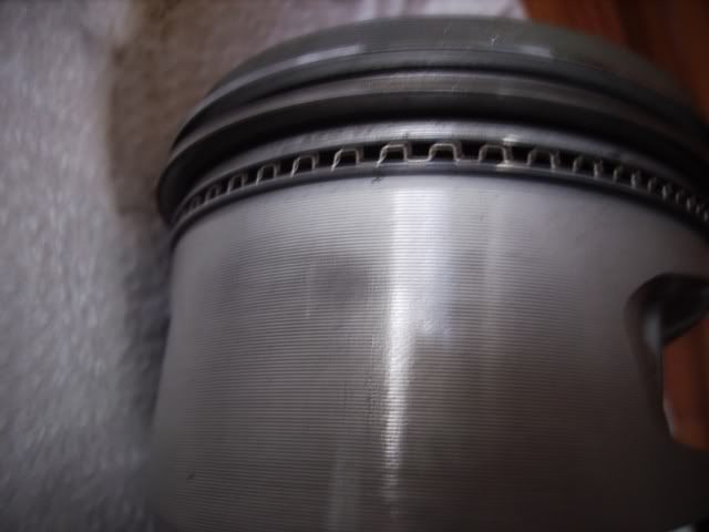

I thought doing it, but then i was reading this article and thinked twice:
http://www.angelfire.com/biz/snwvlly/bikes/dnthone.htm
I even bought a Cylinder Hone Tool, but i will not use it...

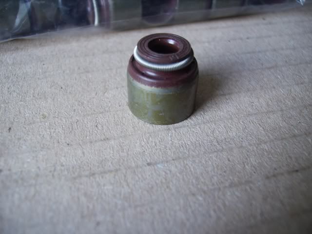

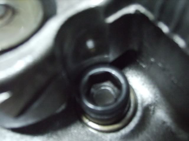

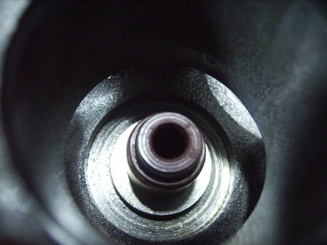

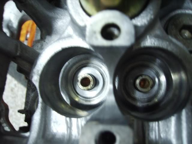

BTW, the engine was drinking oil because of defective valve seals on the intake side, on cylinders #1, #3 and #4.
i dont buy that personally mate fwn imo you will end up with an engine that drinks more oil than before, and smoke on startup (tho i stand to be corrected :grinning:)
I want to test it, lest see if its better or worse... lol

just googled bout using oven cleaner on alu engines and ppl say it takes off any anodised coating then eats/pits/darkens the alu surface cos its caustic soda?
and you have to wear rubber gloves too eh, but i doubt if it does any harm as long as you wash it off soon after use
will them yellow domestic gloves do? no fluffy cuff included
sister said try the weaker cheapo supermarket brands first then the more ££ branded if needed
Yes, try those cheapo ones first. And i dilute it on a proportion of 1 part of oven cleaner to 3 parts of water, does the same thing and lasts much longer. :p

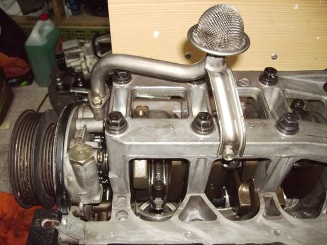

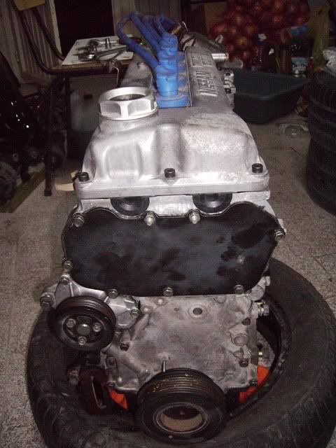

Block already assembled, just need a valve spring compressor to assemble the head, ordered one on last week, and still not arrived... :(

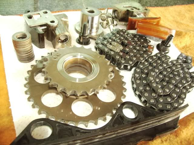

just tried cleaning some spockets, bracket, n tensioners with hot water & persil and wow that stuff is magic. clean metal.

Good news, your new engine will be very nice (Y)
I will not paint the block, i wanted to spent as little as possible on this rebuild, as i dont have that "feeling" for this engine. And i used it as a test for the major rebuild i will make for the Supercharged engine (the auto block i have).
