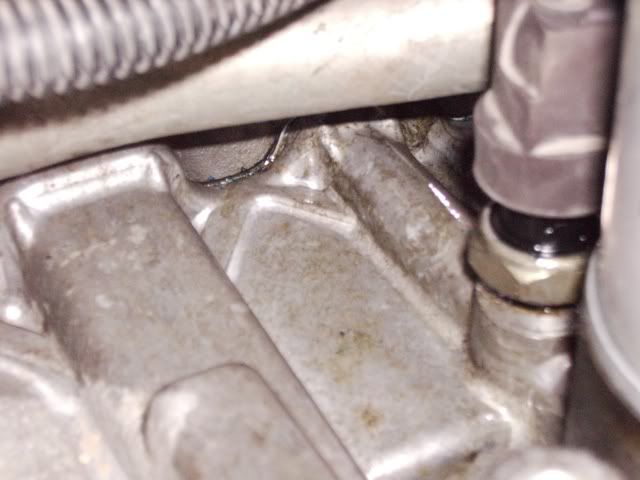

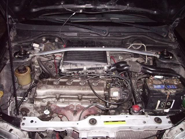

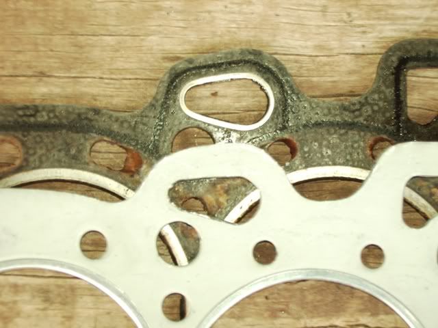

Where it leaks, on the stock head gasket there is a metal ring that is compressed, on my metal head gasket it doesnt exist:
Seems that the re-torque solved the oil leak on the headgasket. :grinning:

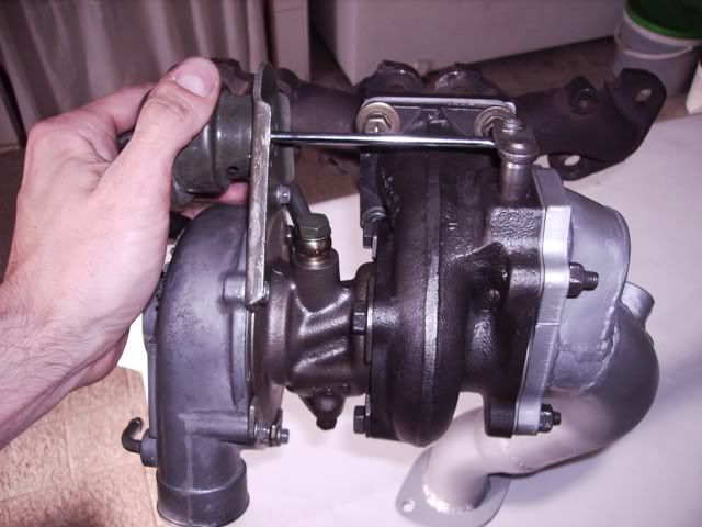

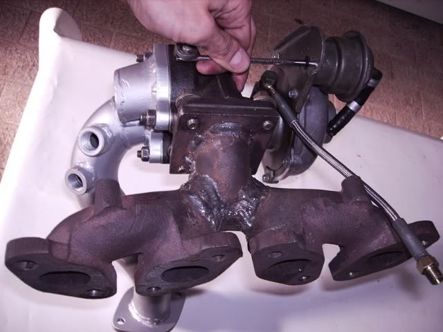

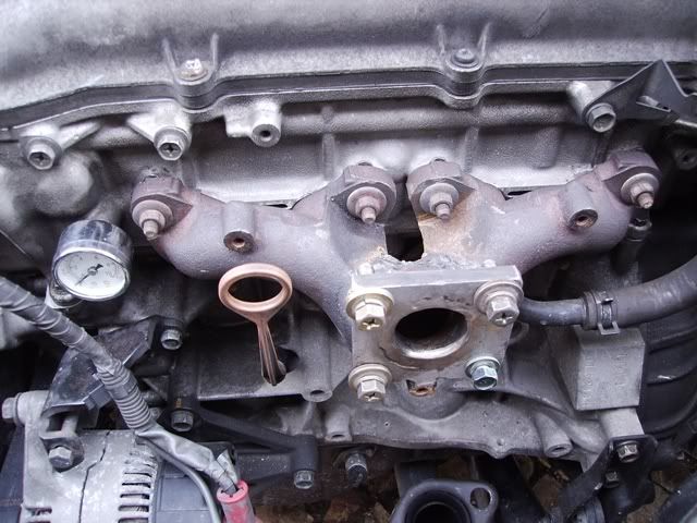

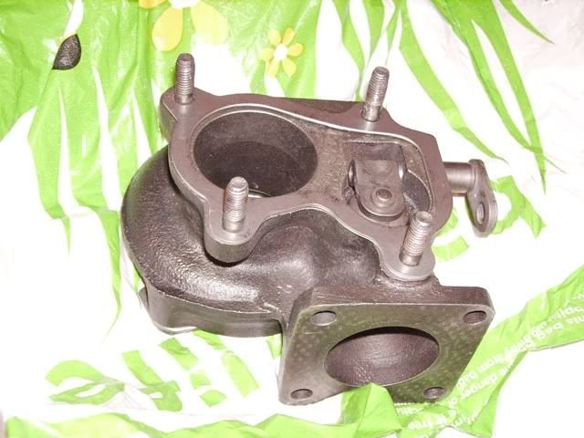

Already have the turbo flange, but one of the studs doesnt line up, need to redrill it and make a new gasket:

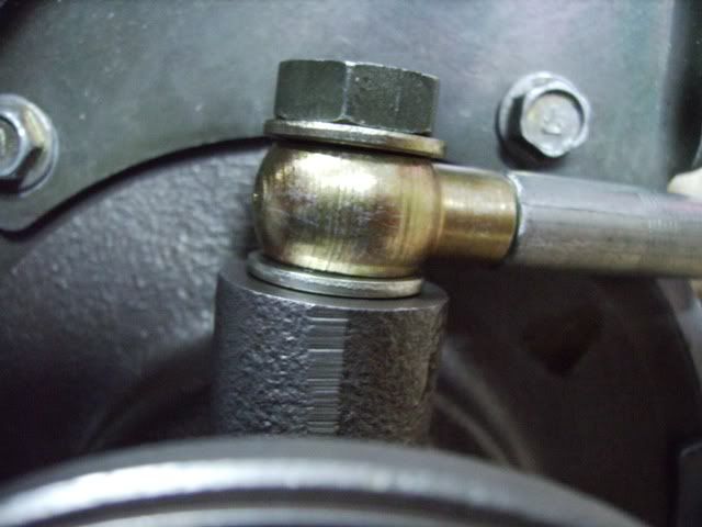

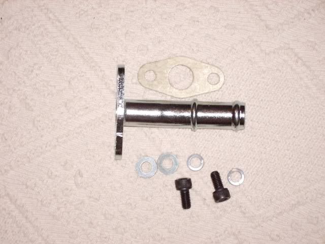

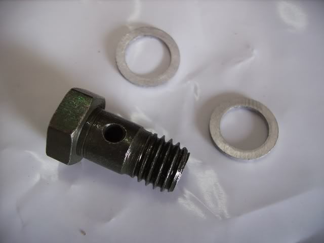

Also have the banjo bolt for the turbo oil supply:

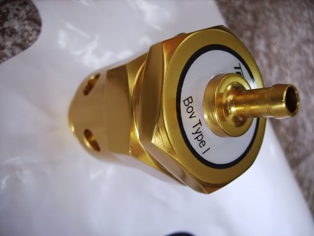

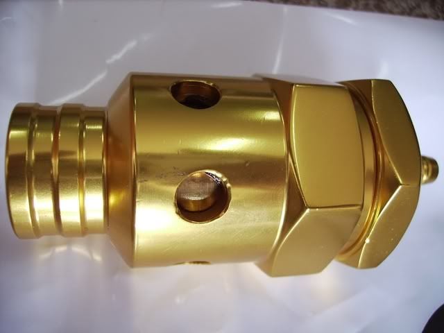

Dump valve:

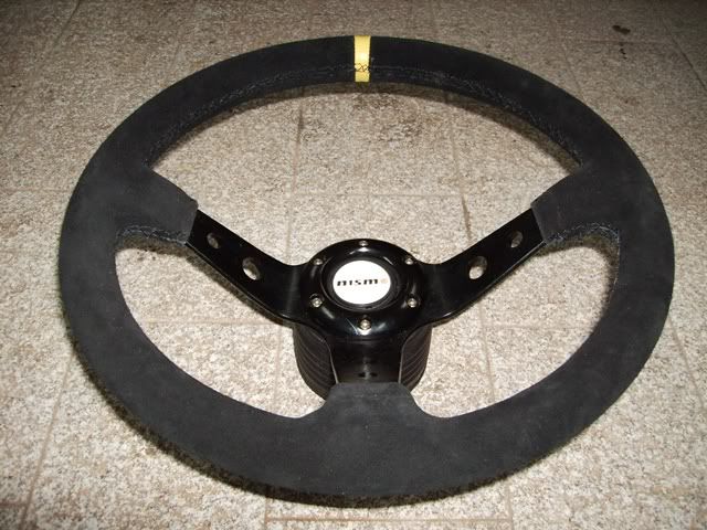

New steering wheel:

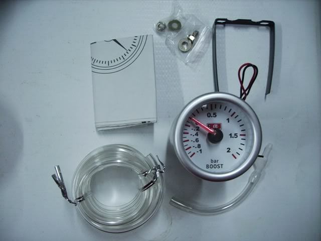

Boost gauge:

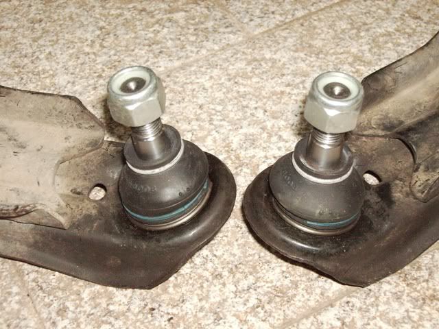

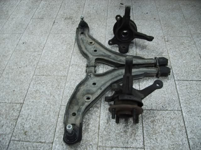

Hubs and wishbones with new ball joints:

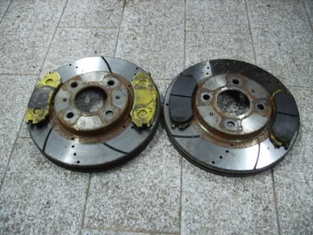

New discs and EBC Yellowstuff pads from Stani:

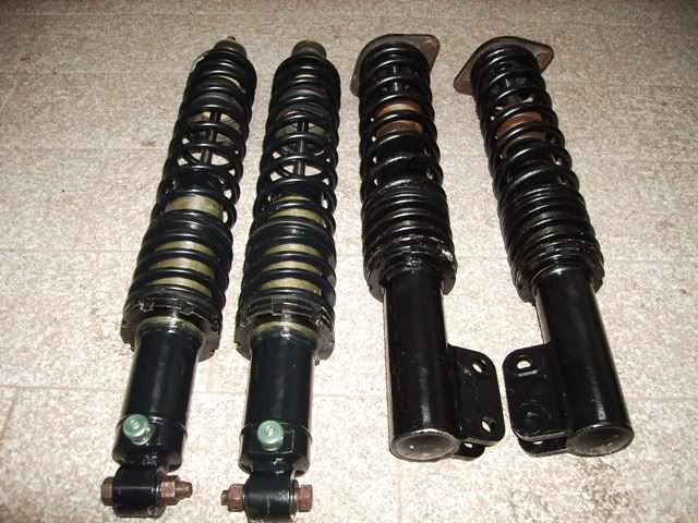

Cleaned and painted some of Stani's old suspension and handling parts.

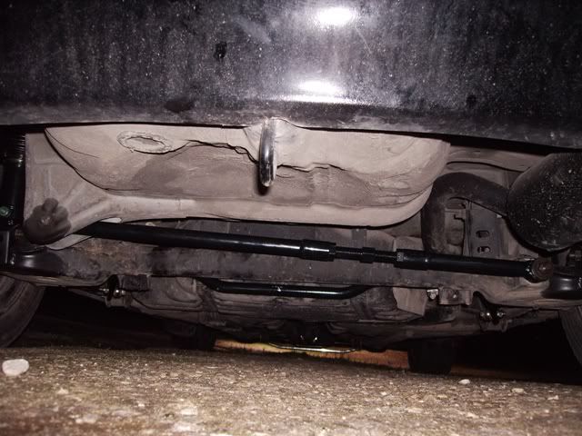

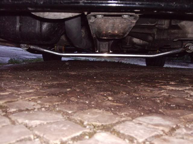

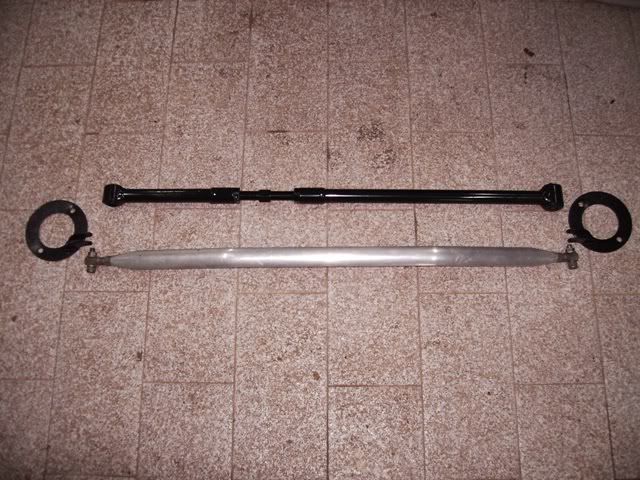

Adjustable panhard rod and strut brace:

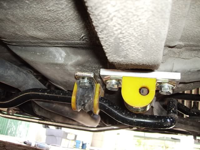

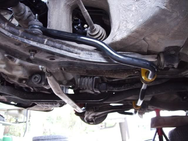

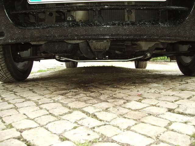

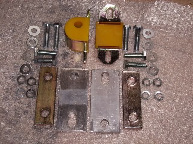

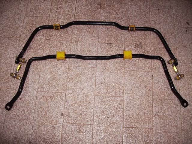

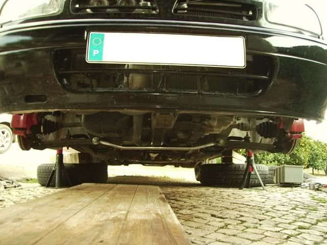

Front and rear 22mm anti roll bars, the rear one has adjustable drop links:

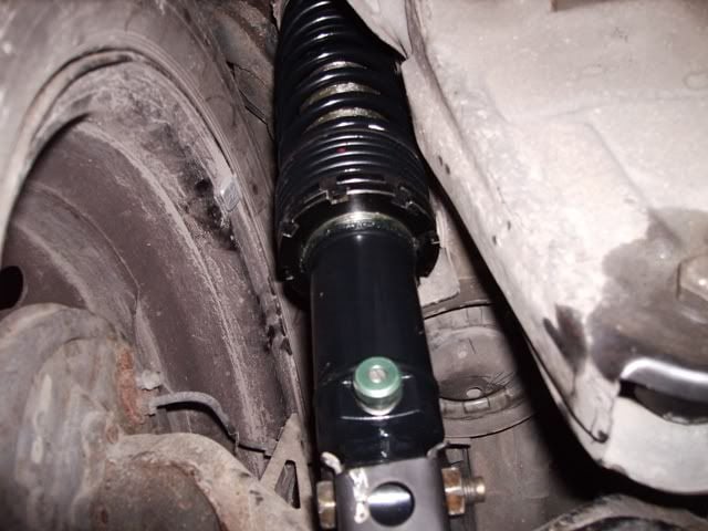

Spax coilovers:

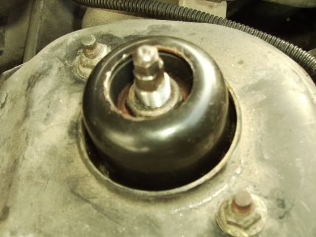

BTW, i re-greased the Nismo top bearings, its a nice piece of art, very well made, did you opened them when you had them? You would be amazed with it. :grinning: And i set the dampers to the middle setting, dont want to have a harsh ride. :laugh: If there is good weather this weekend, i will install the parts on the car.
Cool and no i didnt, i opened the stock plastic ones though, well they kind of fell open lol did you manage to turn the rear green knobs? I miss them, my standard springs are terrible, i just hope the 50mm ones are stiff enough as i cant remember what the ride is like with them.

The plastic ones are crap compared with the Nismo ones. Yes, i was affraid about turning the knobs, but it is very easy, they just get stiffer when you set them to hard. Today it was raining all day, hope that tomorrow or sunday is a sunny day and all the handling parts are installed. And need the 4 Falken ZIEX ZE-912 tires (185/55R14 80H) i ordered, on the next week they are installed also, and then the SR will "eat" all the bends. :laugh:

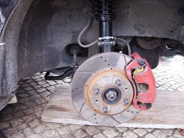

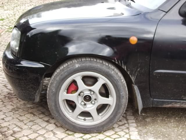

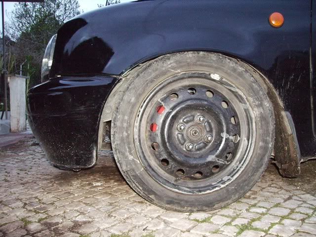

Installed all the suspension and handling parts, but the front is very low:

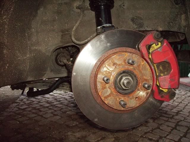

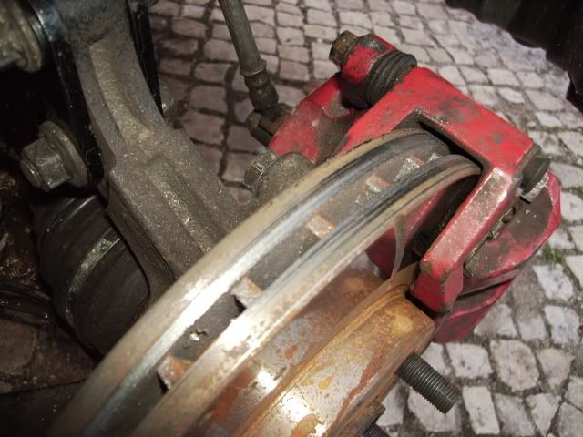

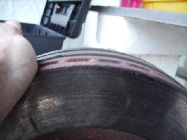

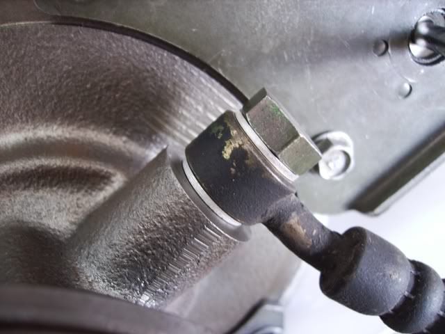

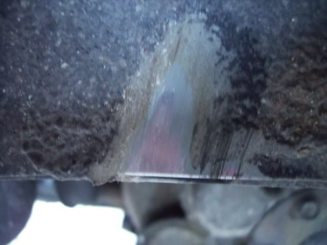

When i tried the car, the front discs were touching the calipers, need to reduce 2mm in diameter, just like i did on the previous discs (which i installed again):

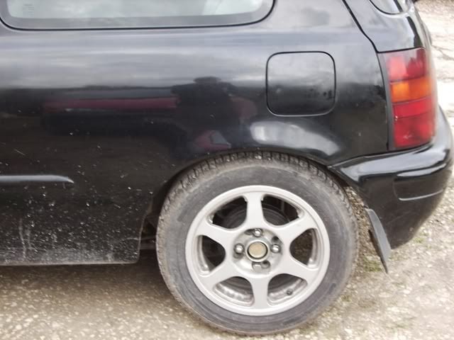

The wheels touch the chassis and fender, really need to rise the car:
Installed the rear parts:

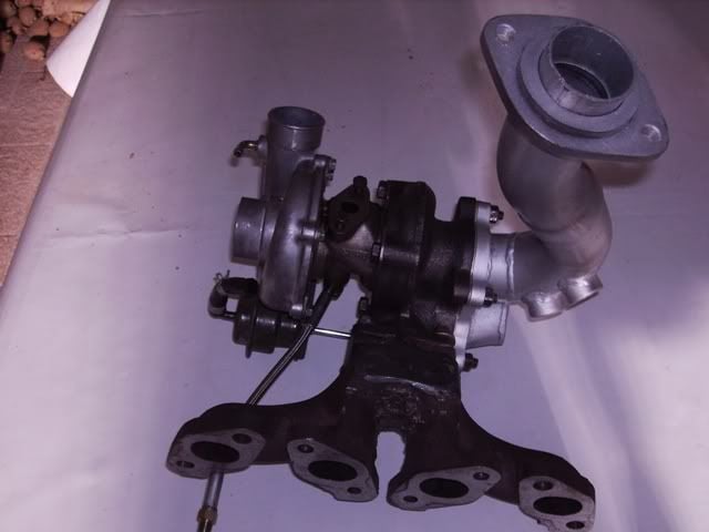

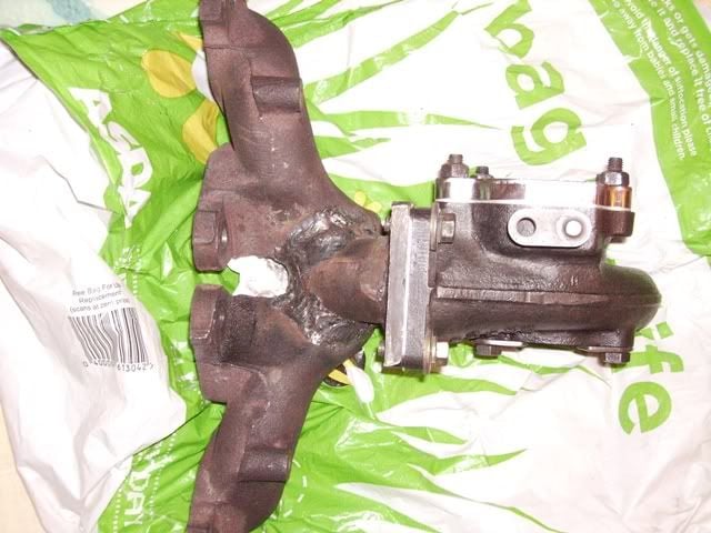

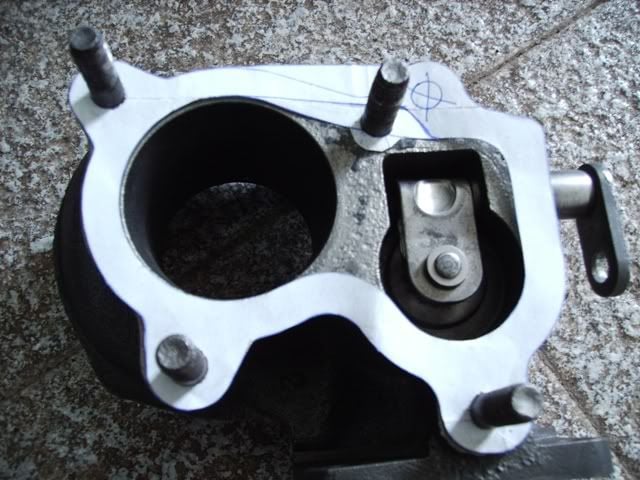

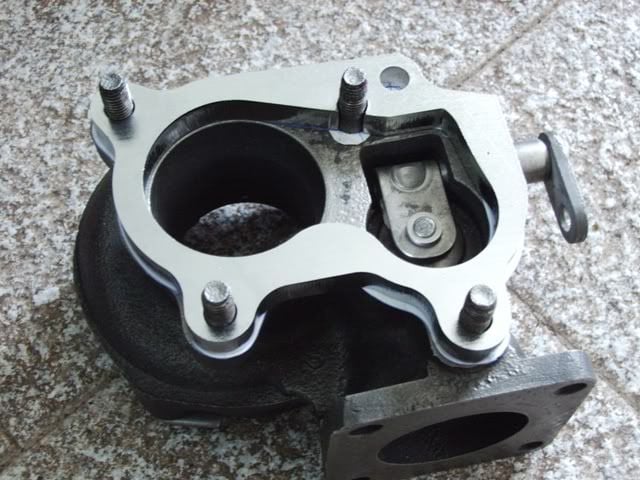

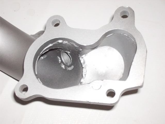

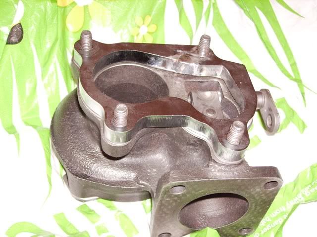

Meanwhile i altered the turbo flange and made the gasket mould:
Wow youve been busy. Thats exactly how my car sat at the front and it only rubbed when i had wheel spacers on. What calipers are you using that makes them rub the disc?
I will need to rise the fronts, maybe 20mm, cant drive it like that on the country roads. :laugh:
Im using AD22VF calipers from GTi-R. And i had the same problem with the other discs i have, had to grind 2mm in diameter...
I installed the old front struts (Ventura springs) and will be like that until i can get a way to rise the front coils. Also installed the alloys that were on the grey Micra:
looks lovely bags, cant wait until I get those anti roll-bars and some coilovers, out of interest is there a noticeable difference with the front and rear ARB's?
what size discs are you using? there are different size discs for the pulsars: mine are 256mm and have never had those rubbing issues. Yours may be the 258mm ones eh hence the 2mm skim required? Have you installed two washers behind the calipers to space it correctly?
Its a hell of a difference, the car is much more stable, but as im using Ventura springs at the front and some old tires (until i sort the front coilovers height), the front seems a bit imprecise, but even that way the car is much more stable and i can fly around corners. And the rear 22mm anti roll bar is twice as thick as the stock one. :eek:
Im using 257mmx26mm GTi-R discs. And yes, i had to use the washers between the caliper carriers and the hub.

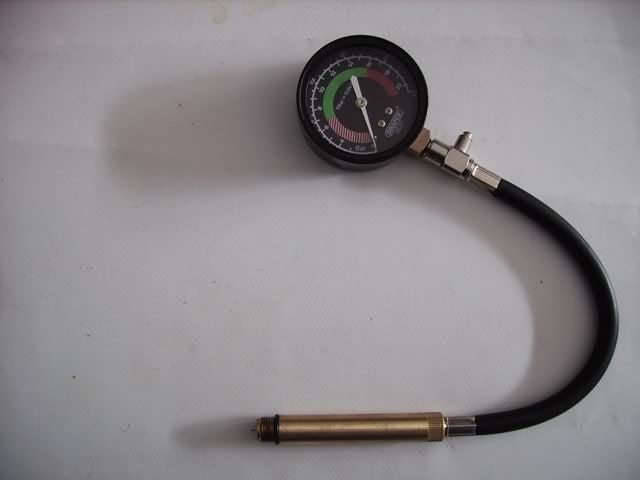

Ordered a Compression Tester, got it yesterday and tried it on the current engine, on all cylinders i got 11,5bar:

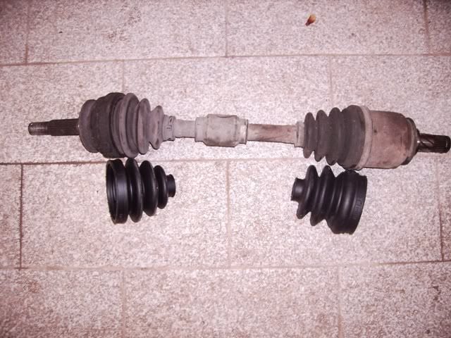

Got 4 CV boots to repair some good condition driveshafts, the current ones will break soon:

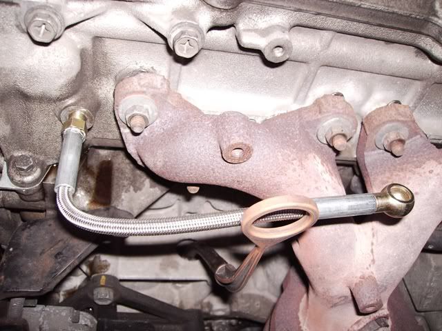

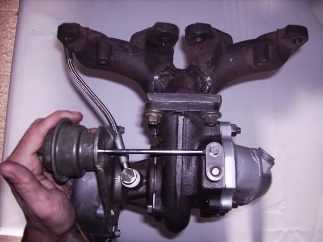

Already have the braided oil line for the turbo, to connect on the head, and washers with o-rings:
After a journey to a machine shop the stud that didnt lined up on the flange is on the correct position, its aligned with the flange and the gasket, and its easier to solder the turbo elbow:
Will be something like this:

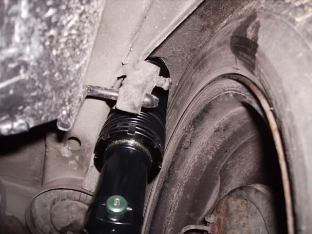

very neat mate :) cant believe the progress what coilovers are they as i noticed you have the rears with the springs on them.
i thought that the rear shock mounts wouldnt be able to handle it all on there own or did you beef them up alot?
Thanks mate (Y)

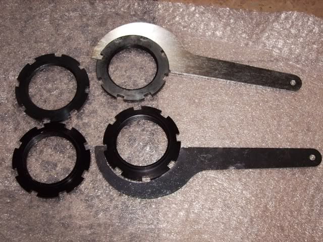

They are Spax coilovers, that i bought from Stani a while ago. They are holding just fine, no reinforcement needed...

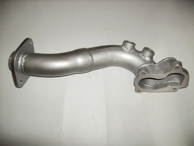

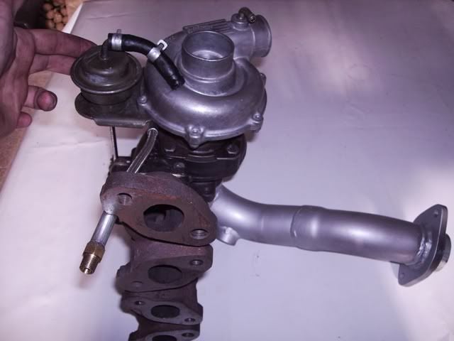

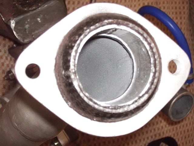

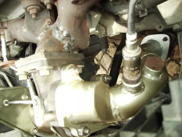

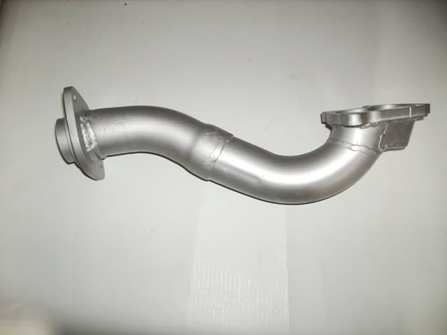

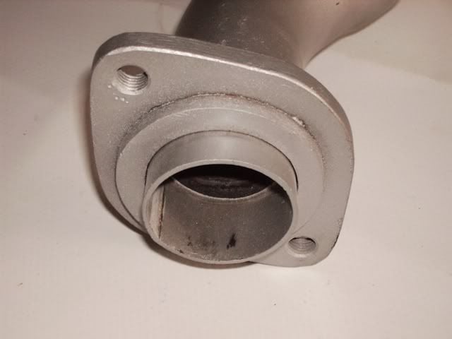

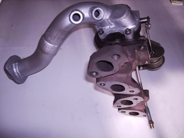

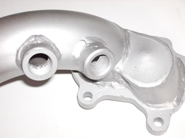

Already have the turbo elbow/downpipe, its a nice piece of art, fits on the conical shape of the stock exhaust (on my case on the Lloyd exhaust) and has two holes for a lambda and wideband sensors:
hey baguete d'ya think its ok to position the wideband that close to the turbo to function longterm?
cos i have an innovate lc1 kit and my turbo exhaust has one port in the gtir elbow joint for the O2 and another port close by on the downpipe. if i could use the wideband on that downpipe port that'll save me from having to weld another bung further downstream near the 2nd cat but some sites suggests it should be at least 18 to 30" away from turbo to keep it below 500C or else it may burn out?
or shall i just get the bung welded further downstream anyway to save the sensor for afew quid of welding labour?

The turbo lowers the temperature of the gases, and i will use the wideband on the second bung, the first one will be for the lambda sensor. I will just use the wideband for mapping, not for normal road use, but i dont think you will have any problems using it on the downpipe...

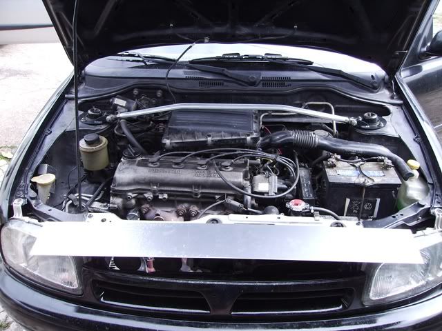

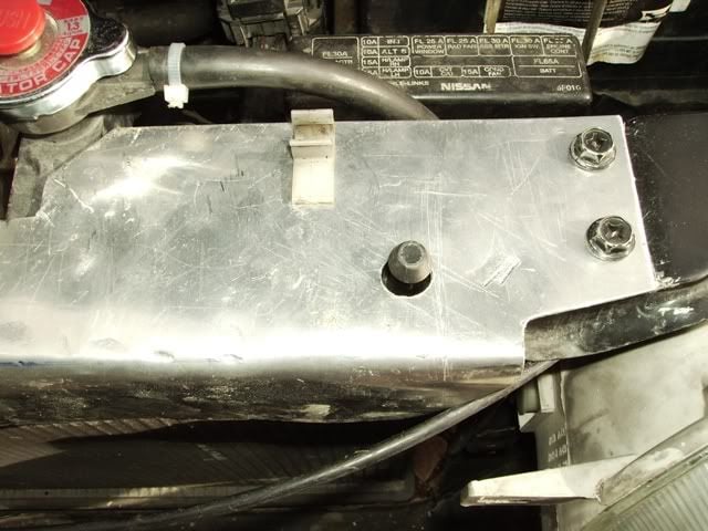

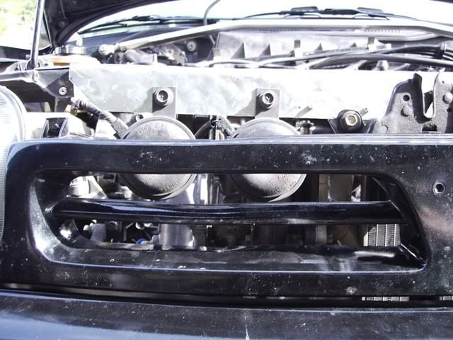

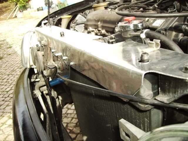

Got an aluminium sheet to make a new radiator support, need to move the top of the radiator a little bit to the front:

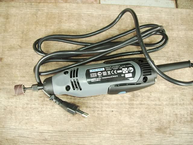

I will use a Dremel to polish the manifold:

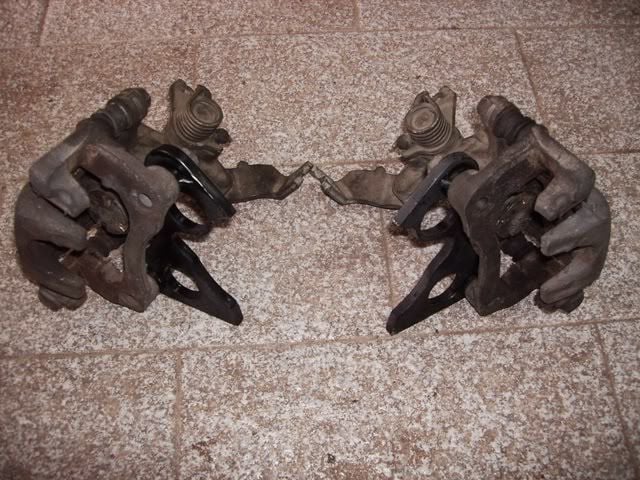

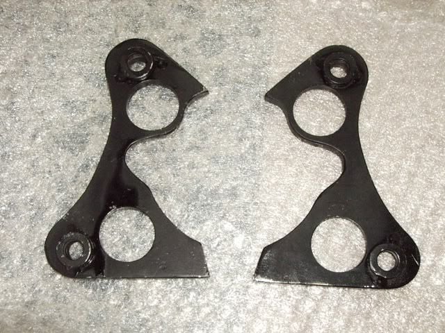

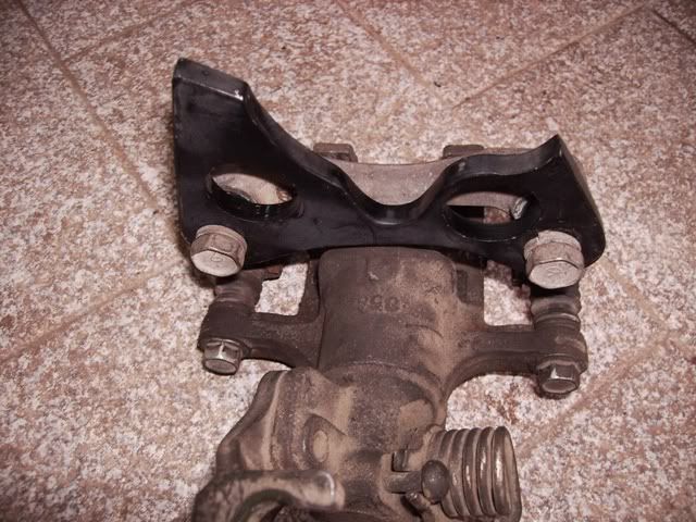

Tested the brackets for rear disc conversion, they fit nice on N16 calipers:

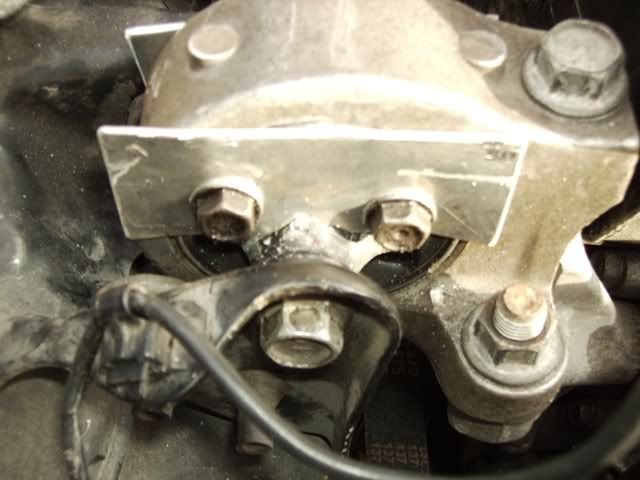

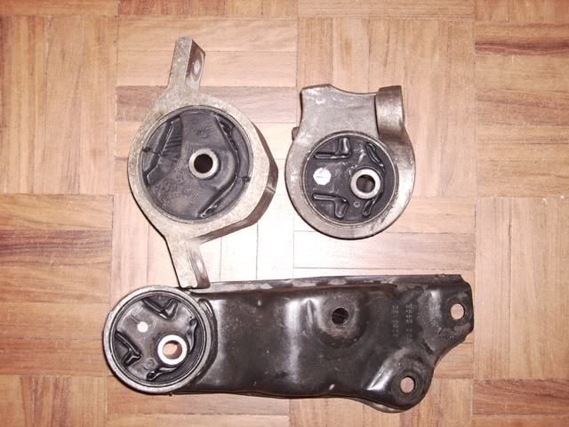

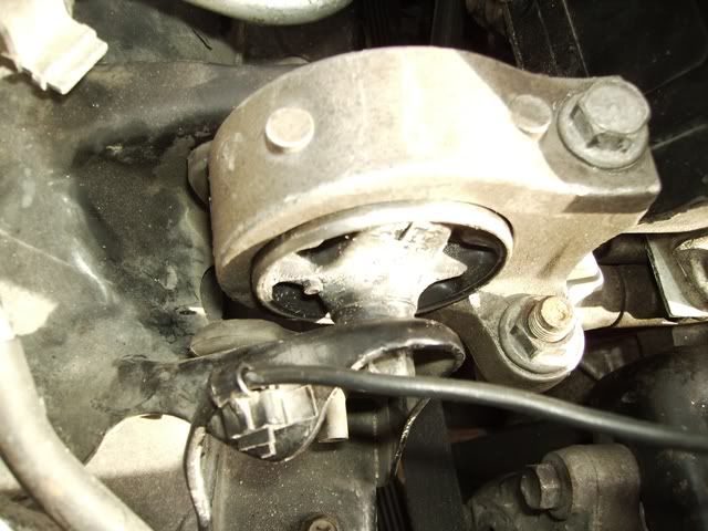

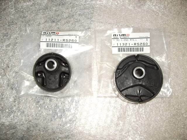

New Nismo engine mounts already fitted on the brackets:

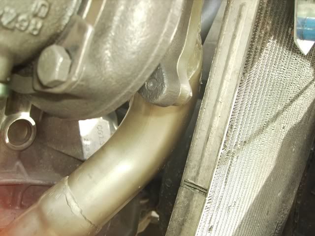

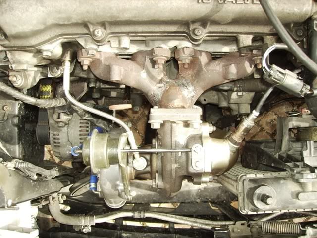

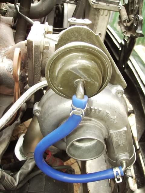

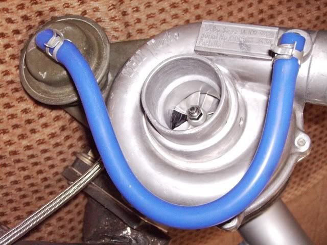

And i can finally install the turbo, already got the oil return and boost controller:
Turbo install, will post a video soon:

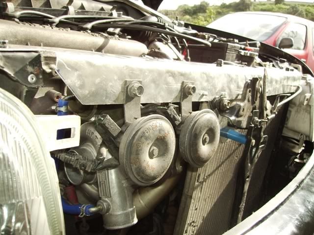

Had to do a new radiator support so it doesnt foul on the downpipe:

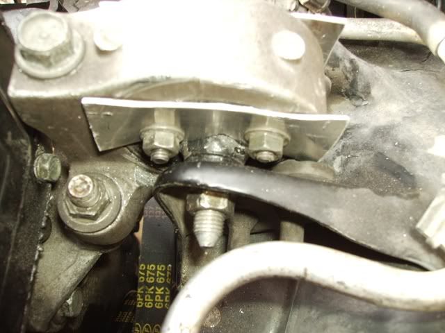

One of the Nismo engine mount decided to break loose from the bracket, had to make a temporary solution:

It is said to be bad idea to run the turbo without the intake connected, it allows the turbo to spin much faster than it ordinarily would because there is no pressure to slow it down. (martin thinks that that is how he did his turbo in)...
Setup looks good though! that downpipe is nice.
Yes, i know, i was just testing it, im not driving the car now. Just need the intercooler so i can buy the intake pipes, after that is remap time.
The downpipe was custom made, to fit stock exhaust (or Lloyd exhaust in my case). (Y)
Looking good mate! Yeah that's how I did mine... Oops
110 down m25 with no load on the turbo it span like a goodun
All fixed now though
Phew ..won't be doing that again ;)
You will have to come over hear mate when it's finished to a " boosted Micra meet " and have some fun!!
