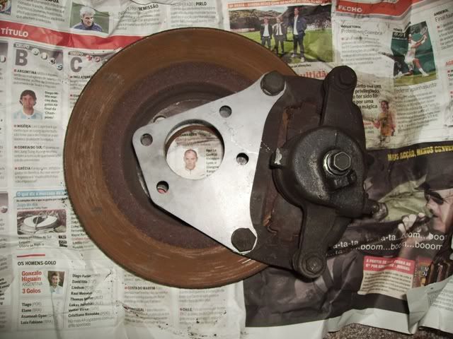

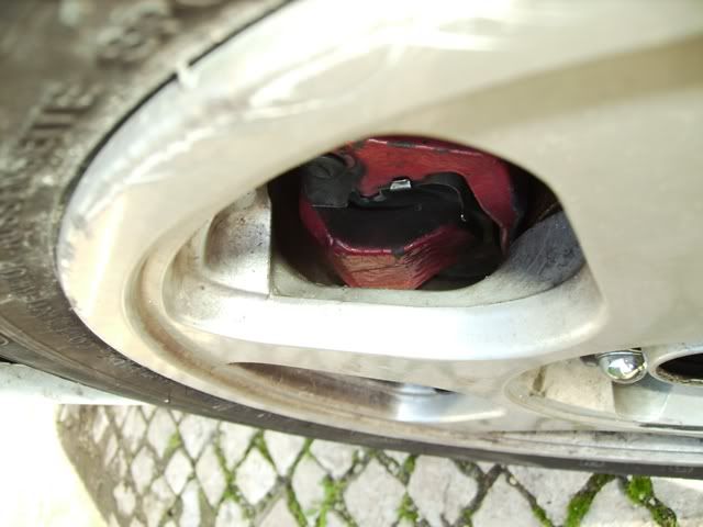

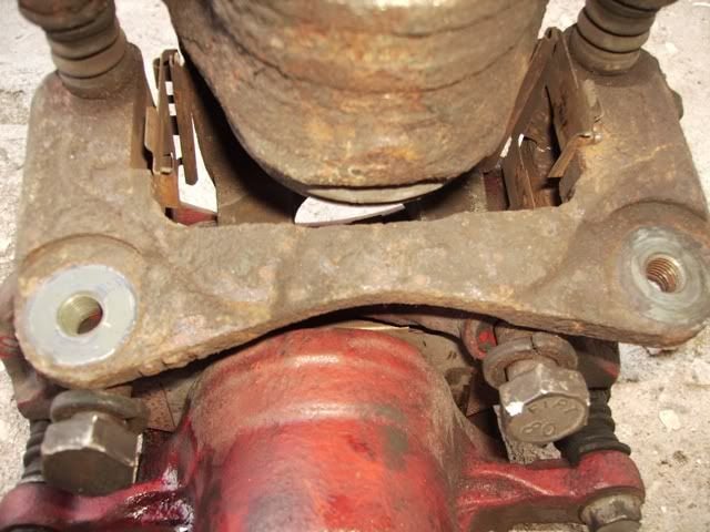

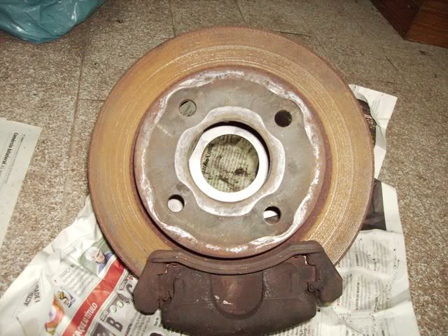

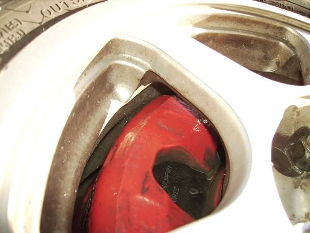

Tested the brackets for rear disc conversion, these are the ones for using with front calipers, just using them as a mould for new ones:

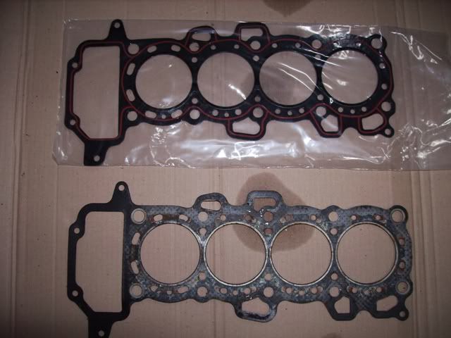

Will get some metal headgaskets done for the 3 engines im making, using the original ones as base:

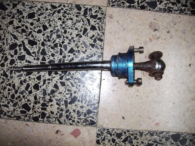

GTi-R Short-Shifter:

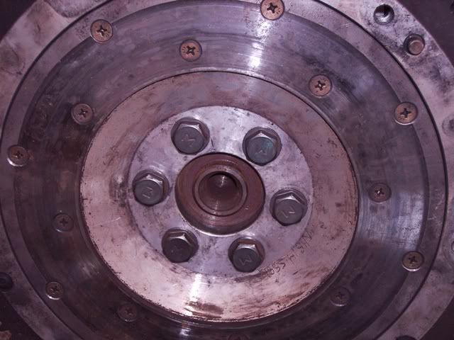

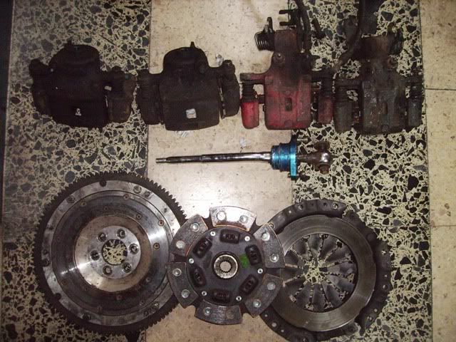

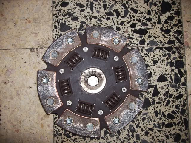

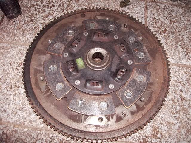

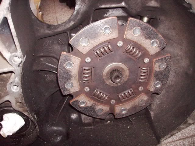

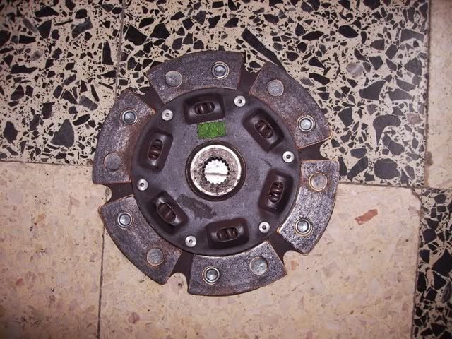

GA16 XTD Stage 4 clutch (190mm):

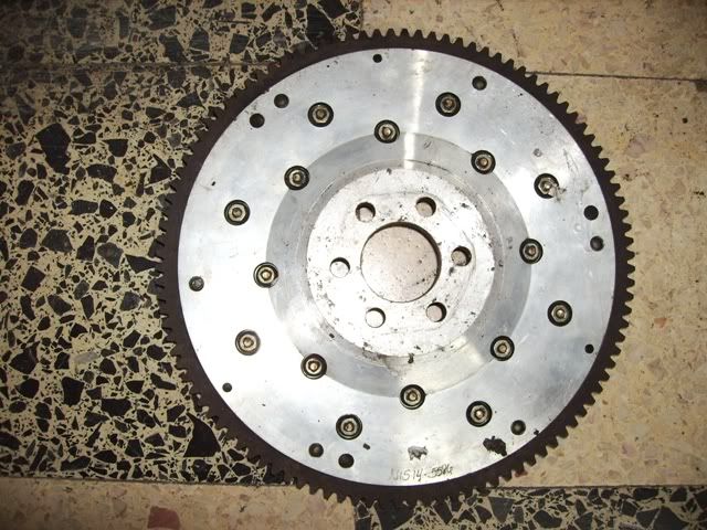

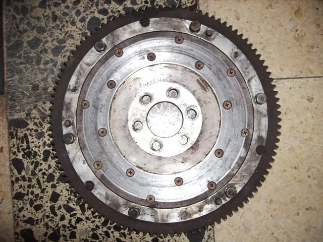

GA16 Fidenza flywheel, with only 3,1 Kg:

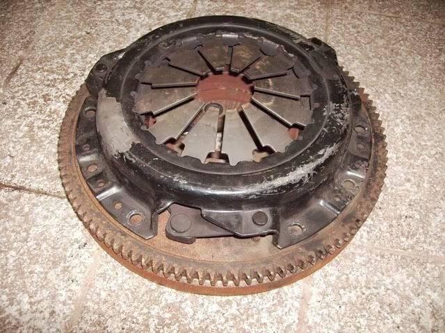

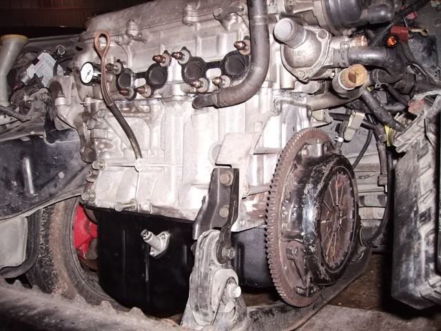

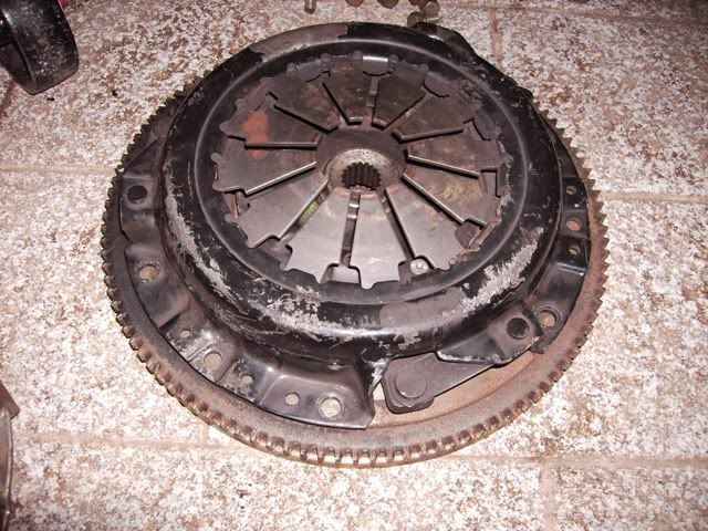

As requested, i tested some flywheel/clutch setups, using stock gearbox.

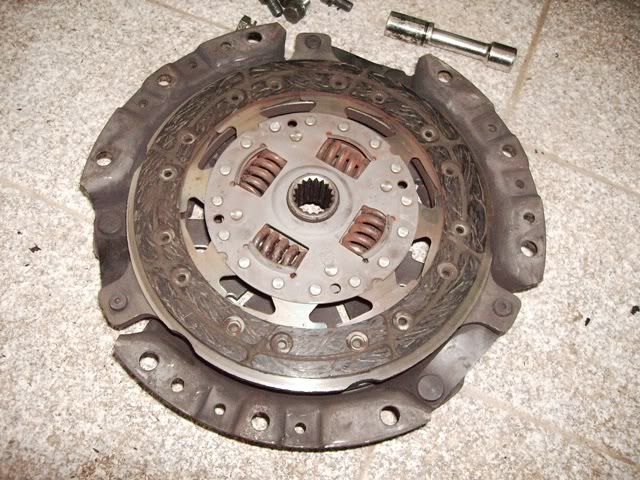

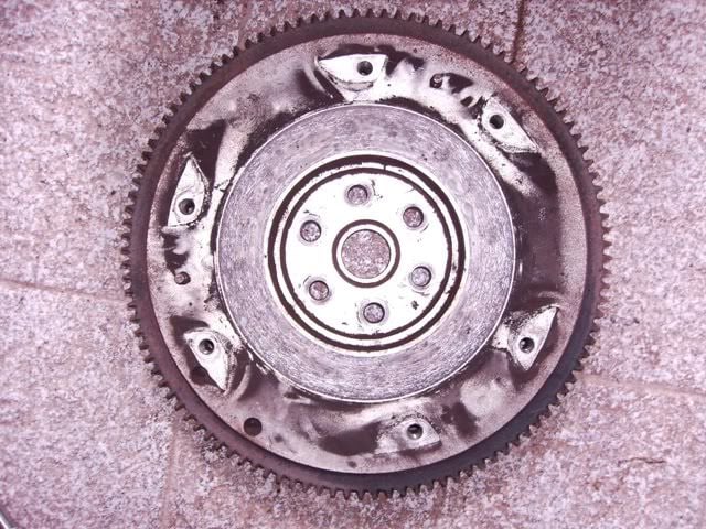

Stock fly + clutch:
As you can see, the GA16 clutch disc fits CG box:
And the GA16 fly fits CG crank:

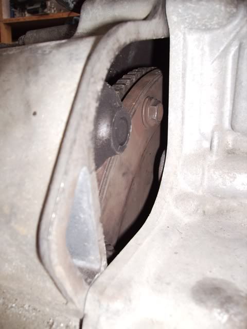

So, lets get it installed:
There is a little difference where the fly ring sits, about 3mm closer to the block, but the starter motor should mesh just fine.

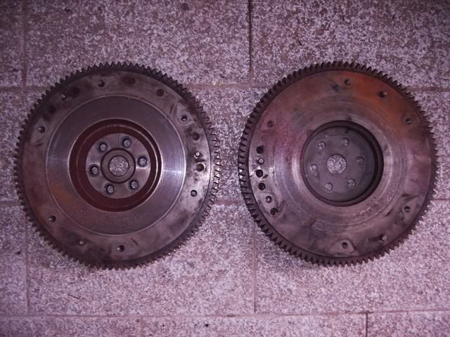

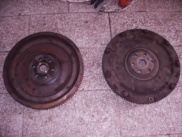

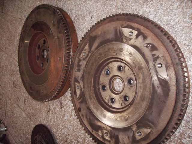

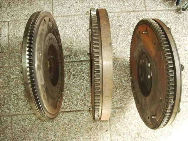

I also wanted to see all the differences, 1.0, 1.3 and 1.6.

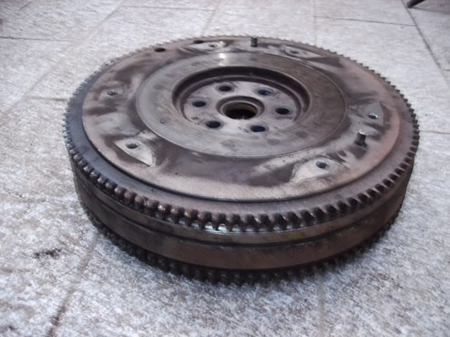

From left to right, 1.0 Pre-Facelift, 1.3 one piece and 1.3 three piece:
1.0 Fly:
1.3 Fly's:

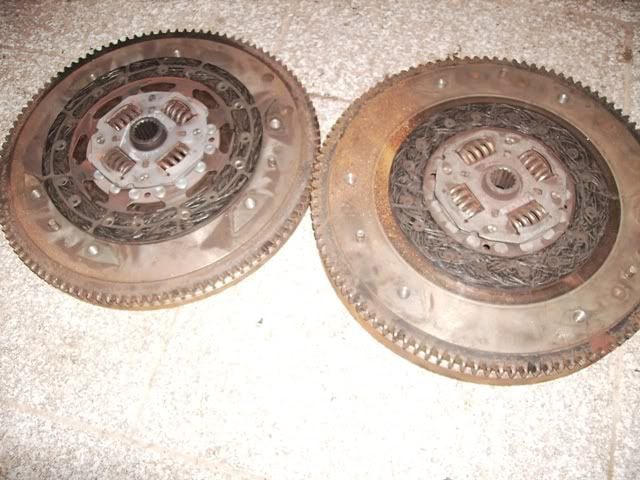

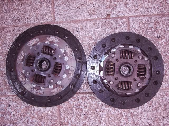

Comparison between 1.3 and 1.0 clutches:
1.0 Fly on top of 1.3 Fly:
Side by side:
1.3 Disc on top of 1.0 Fly and 1.0 Disc on top of 1.3 Fly:

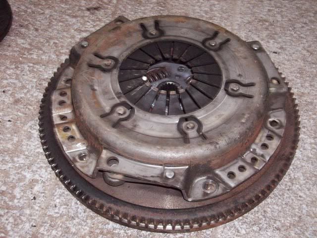

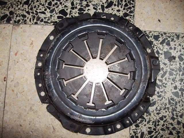

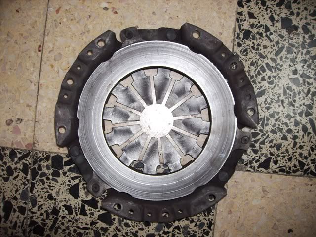

1.3 Clutch Cover on top of 1.0 Fly, it can be redrilled:

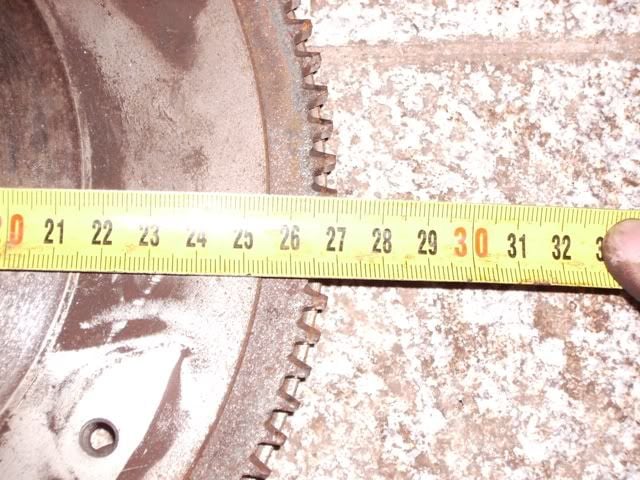

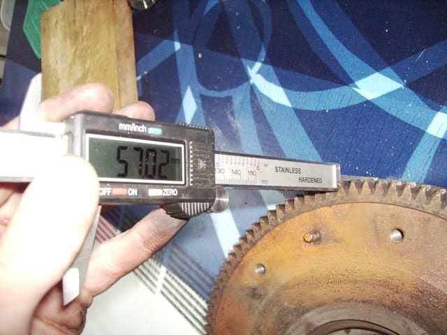

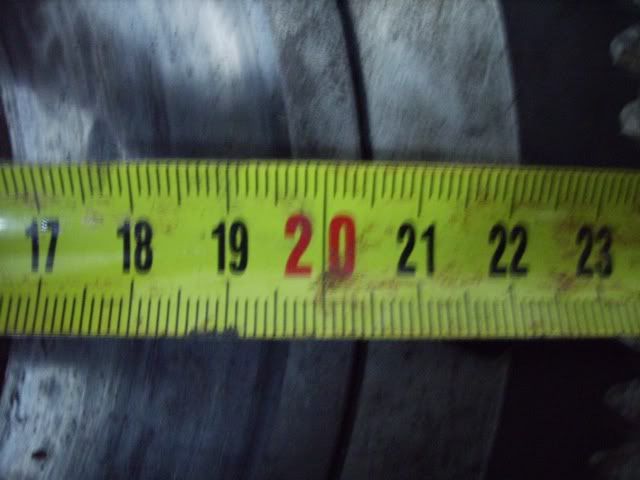

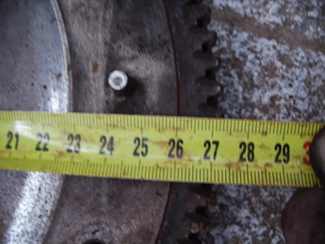

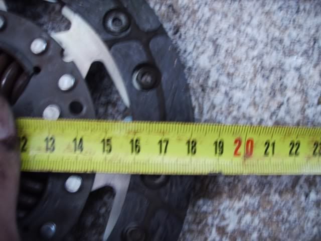

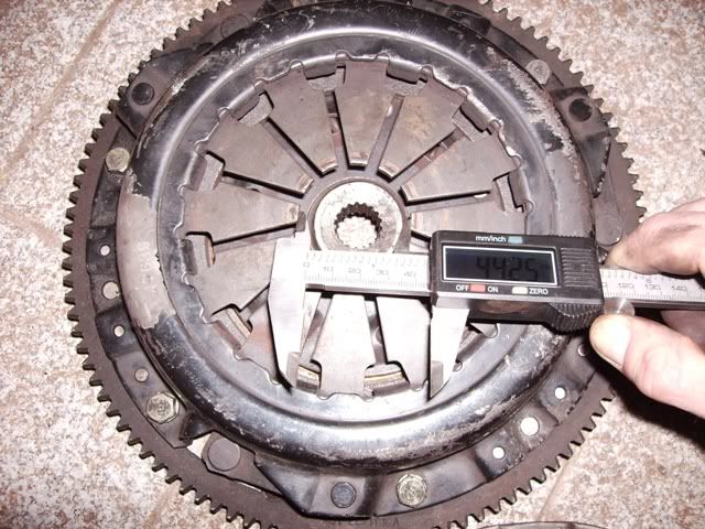

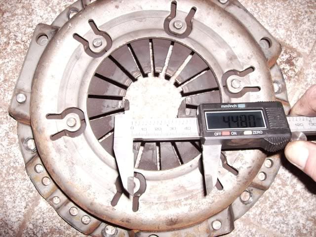

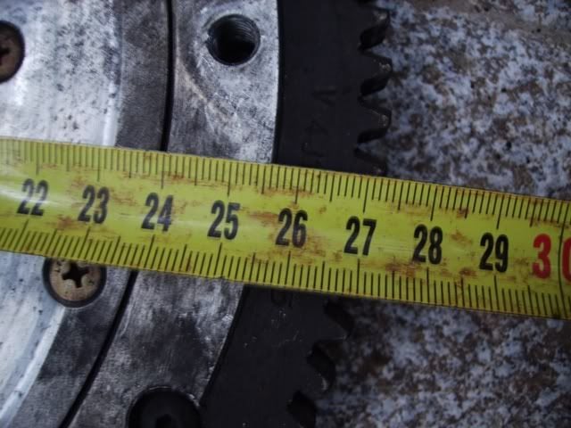

1.6 Fly diameter:
1.3 Fly diameter:

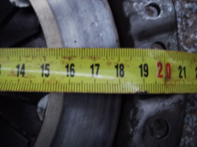

1.6 Plate diameter:
1.3 Plate diameter:

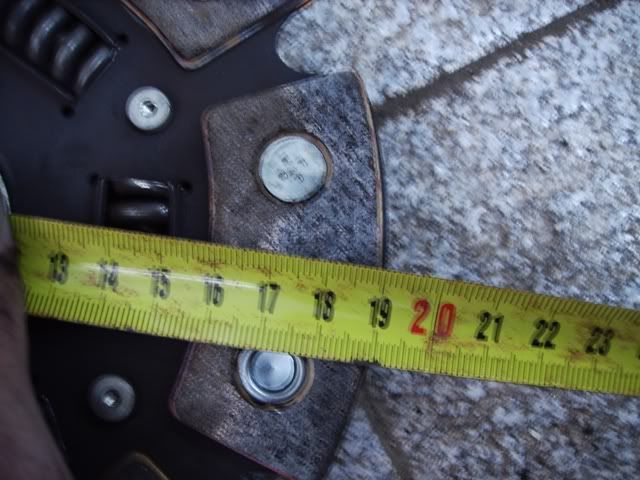

1.6 Disc diameter:
1.3 Disc diameter:
1.6 Clutch cover on top of 1.3 Fly, can be redrilled too:
1.3 Disc on top of 1.6 Plate:
So, the 1.6 setup will work with stock gearbox, having a 190mm setup instead of 180mm, good for some serious engined Micras. But the 1.3 Fly can be redrilled to suit GA clutch, because GA Fly should be heavier than 1.3 Fly. Nothing that a Fidenza Flywheel cant do. :laugh:
BTW, i will check if there are 200mm setups, because im almost sure they exist, maybe on Primeras...

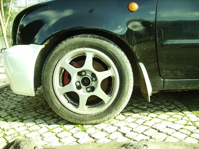

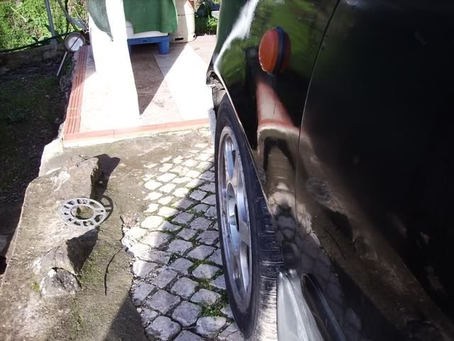

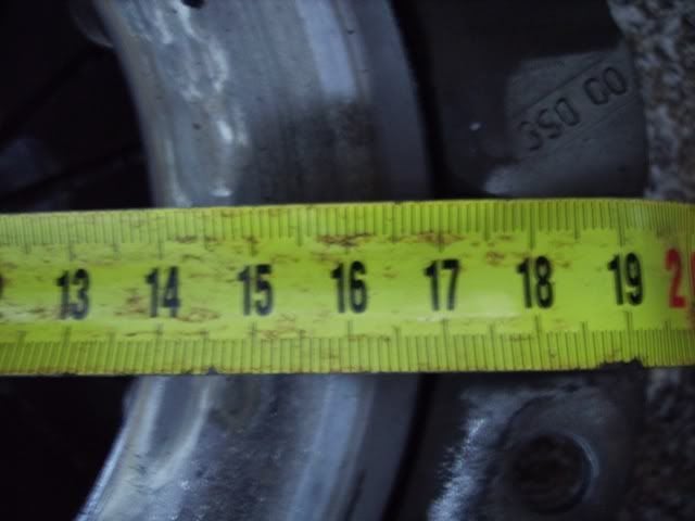

I'm assuming you were using unmodified 14" steel wheels and spacers? What sizes spacer did you need to get clearance using GTI-R brakes?
valuable info n pics there (Y)
Still have to take some more measurements on stuff to complete this.
And i forgot to take a pic of the space between the Fidenza Fly and the block, its more or less 27mm... (Y)

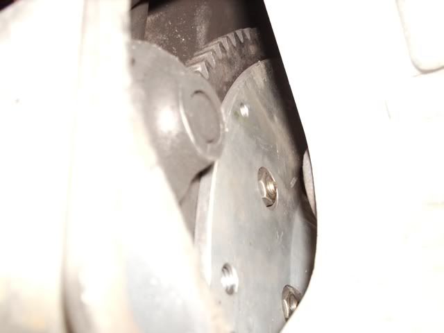

The stock 14" steelies dont fit GTi-R calipers without spacers, even the ones modded by Frank, you need at least 3mm spacers...

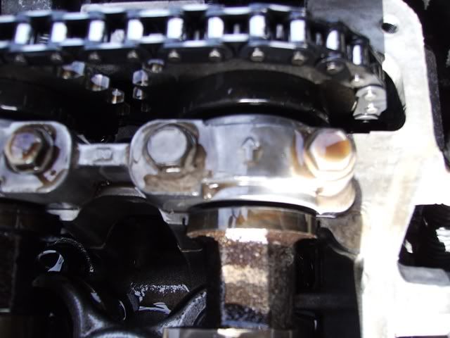

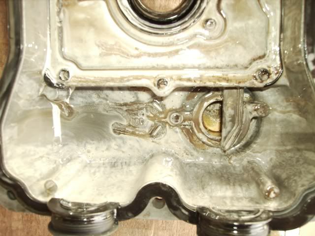

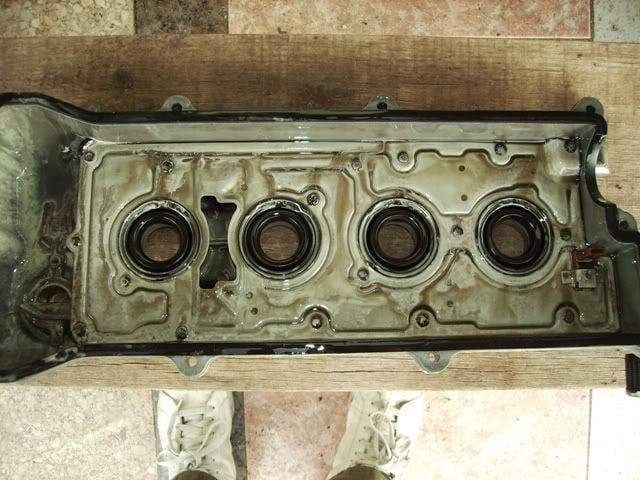

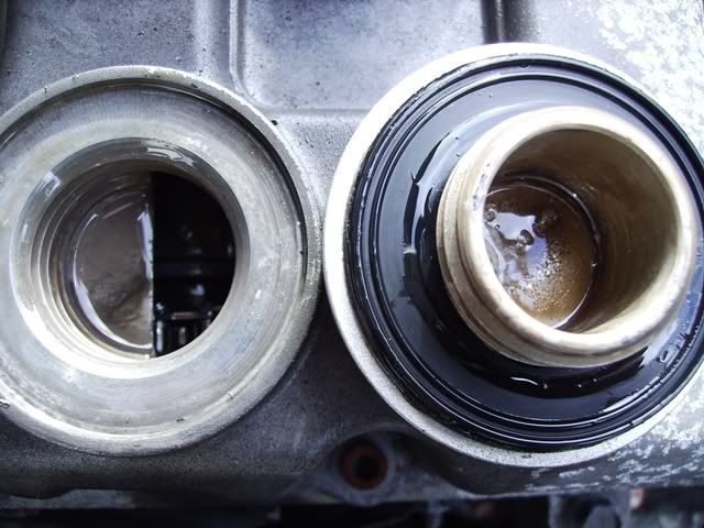

BTW, the current engine is well screwed up, starting to make some mayo:
And checked if S13 calipers would fit Micra, no can do, the spacement on the carriers is different:

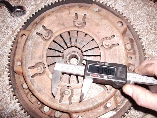

Some new stuff done, hope it helps...

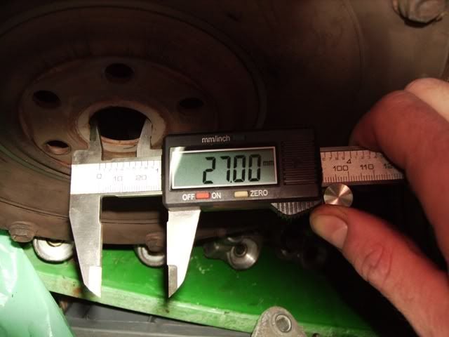

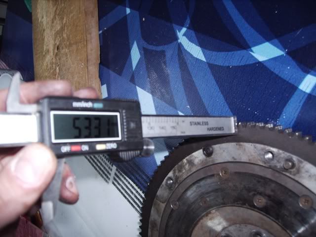

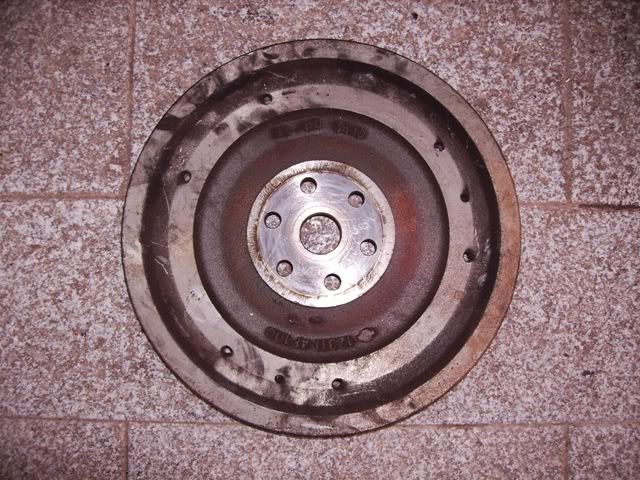

Diameter of the 1.0 fly:

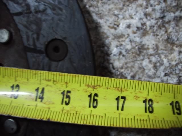

Diameter of 1.0 disc:
Diameter of 1.0 plate:
1.6 Disc on top of 1.0 fly:
1.6 Plate on top of 1.0 fly, can be redrilled, but i dont know if the starter motor will hit the clutch plate and of the starter will mesh:

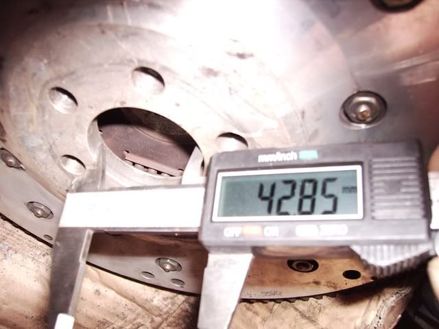

Diameter of the friction plate of the Fidenza 1.6 fly, only discs of that diameter can be used:
Diameter of 1.0 plate hole:
Diameter of 1.3 plate hole:
Diameter of 1.6 plate hole:
Diameter of the hole on Fidenza 1.6 fly, i think i will use a spigot ring to center it:
Diameter of the hole on 1.3 fly:

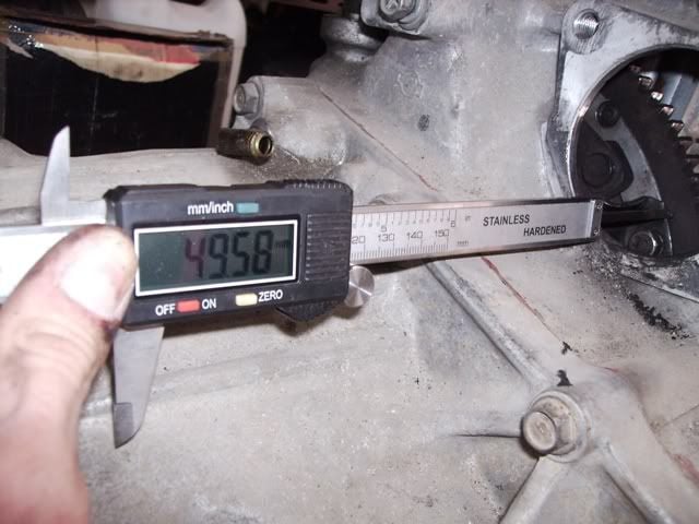

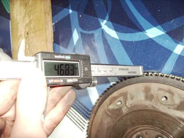

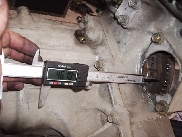

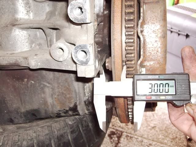

Used a piece of metal underneath the flyhweels, to check the ring alignment to the starter motor:
The reference is a 1.3 one-piece flywheel:
1.3 three-piece fly, sits 0,7mm further apart from the block:
Fidenza 1.6 fly, sits 3mm closer to the block:
1.0 fly, sits 9,5mm closer the block:

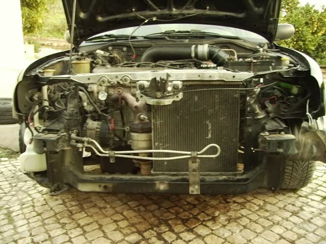

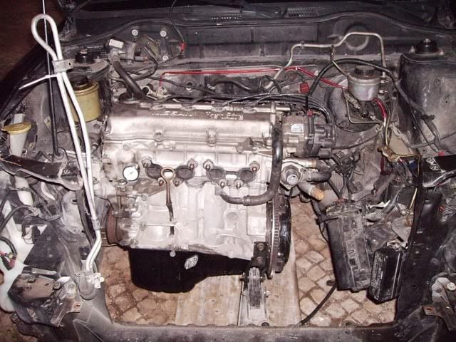

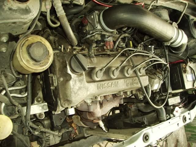

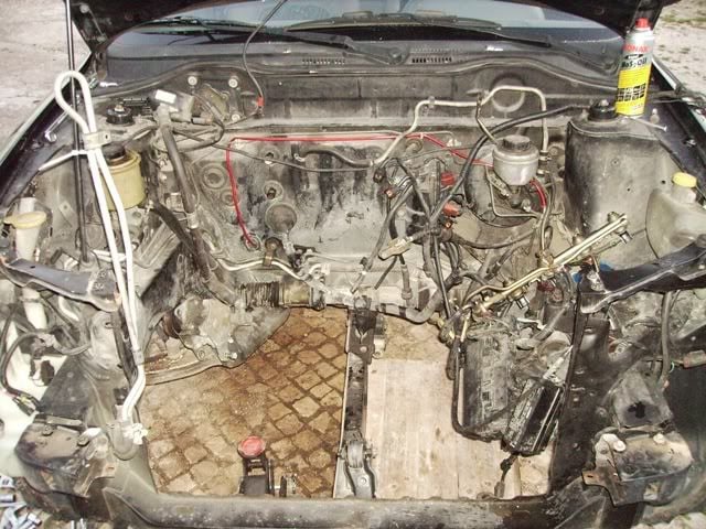

Engine installed, so far so good:

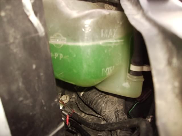

Doesnt bubble on expansion bottle, good sign:

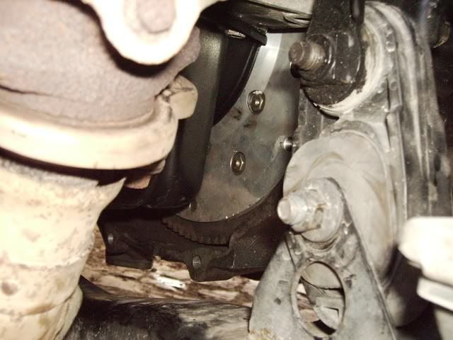

Installed the Fidenza Flywheel and XTD clutch, its plug and play and the starter motor works the same, the engine starts without problems. Didnt used the plate between the engine and the gearbox:

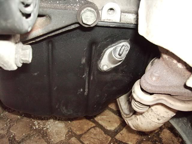

Oil return blanked:

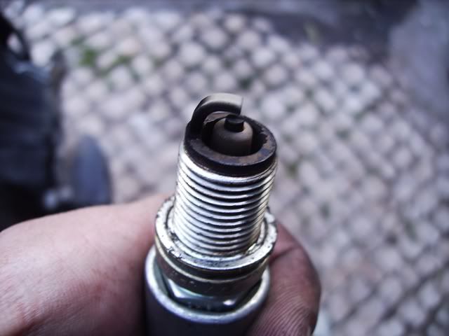

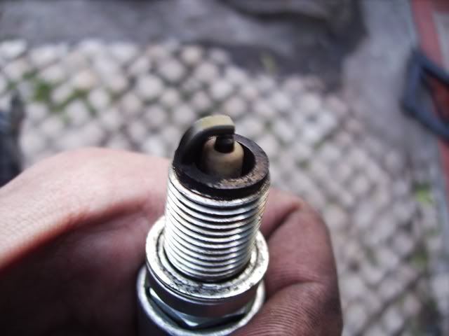

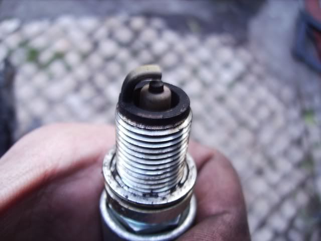

Spark plugs color, from cylinder 1 to 4, all the same color:
One video showing the engine running, even with less compression ratio its impressive how the engine speeds up:
[video=youtube;lm-8vOFY4L4]http://www.youtube.com/watch?v=lm-8vOFY4L4[/video]

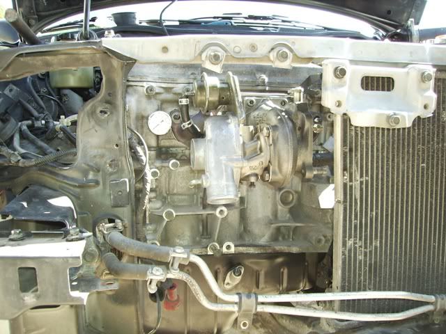

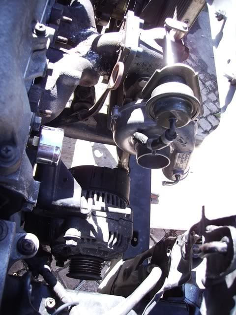

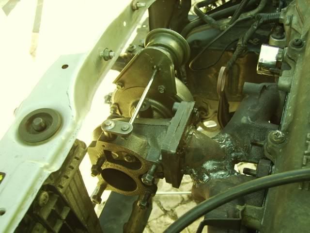

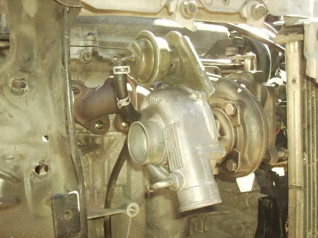

Test fitted the manifold and turbo, as you can see it doesnt hit anything. And i need to get another intercooler, the one i have wont fit how i want it:
Already running:
That clutch is very hard to control, grabs really fast, if you try to be gentle it starts to kangorooing, if you rev it more you light the wheels, if you dont give enough revs it stalls... :eek: The lighter flywheel doesnt help at all. I will break the engine mounts in no time... :p

I made a typo, instead of Fidenza, it should be read Fidanza (which is the correct name of the brand)... :blush:

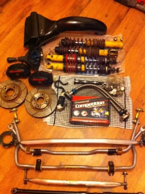

Installed the Peter Lloyd exhaust, great noise, even better than Janspeed.
Bought another bucket seat and a dished steering wheel (pics tomorrow).
And i received this (thanks Stani):
Spax Full Adjustable Coilovers with Nismo Top Mount Bearing/Bush
Upper Strut Brace
Whiteline Lower Front Strut Brace
Whiteline Front Anti Roll Bar
Whiteline Rear Anti Roll Bar
Whiteline Rear Adjustable Drop Links
Rear on car Adjustable Panhard Rod
Nissan Pulsar Calipers, Discs and Yellowstuff Pads
Group A Rally Airbox
Auto Sprint Inlet Cam With Buckets for Double Underbucket Shims
Magnecor Blue Ignition Leads
walbro Fuel Pump
Greddy Oil Filter Relocator
Short Shifter

Interesting stuff, seems that Primeras P10/P11 1.6 uses 200mm disc, there are some options with 215mm disc with the same part number as Nissan Bluebird 1.6 86-90 that uses CA16 engine. So, if its right, they have the same PCD for the cover plate. Have to talk with a friend that has some N13 GTI's, to check if my XTD clutch will fit CA16 fly. If it works, a 215mm setup can used... :p
http://cgi.ebay.com/ebaymotors/F1-R...ptZMotorsQ5fCarQ5fTruckQ5fPartsQ5fAccessories
so technically this would fit the cg13 spline? would need the flywheel too i guess?
will 220mm fly fit inside the box matey?

About the 215mm clutch, the spline is the same. I still didnt solved that, but check the earlier pics, they show the stock fly diameter and you can compare it with the other fly. I would say that you need the fly also, could have different PCD for the clutch cover...
a 220mm disc would have the cover boltholes in the starter ring gear martin :eek: and the 2.0 flywheels are 8 stud into the crank i believe
Yeah, no 2.0 flys can be used, just the 1.6 flys. But the question still is if the PCD of the "normal" 1.6 fly matches the Primera Wagon 1.6 215mm cover plate. If they are the same, a good clutch setup can be made.
