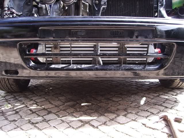

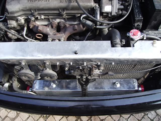

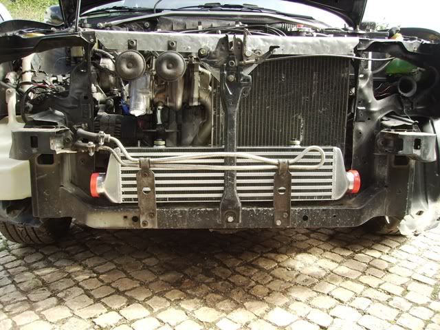

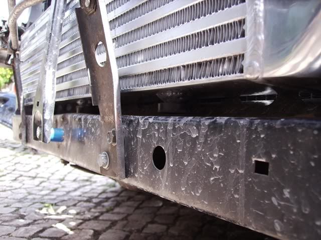

Got the intercooler, tested it to check the pipes i need to buy:

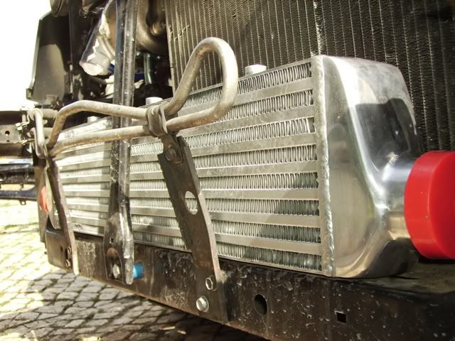

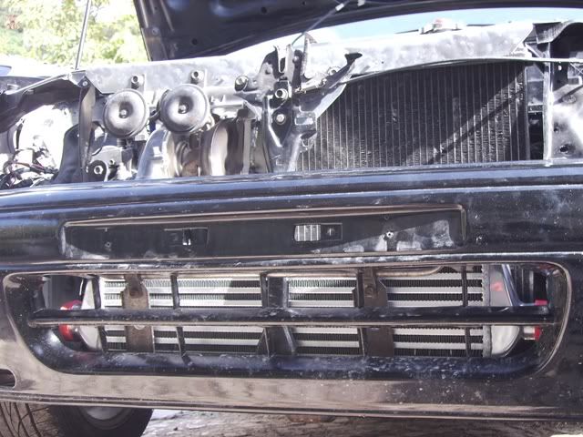

It was a bit high, so i cutted the lower supports, that way it gets more fresh air:

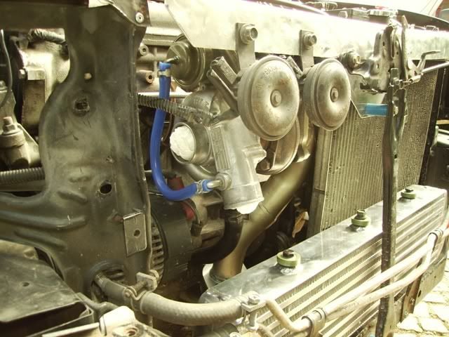

Will have to rotate the turbo a bit more, so the pipes doesnt foul on the intercooler:
just like on mine, I'd remove the stock PAS cooler & bracket and just make a new one from central heating copper pipe to route over the top of the IC, may give IC slightly more cooling too
Will do for now, i just need the car running with the turbo, maybe later i can make a new PAS cooler like yours. (Y)

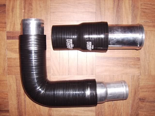

Just need the pipework now... :p

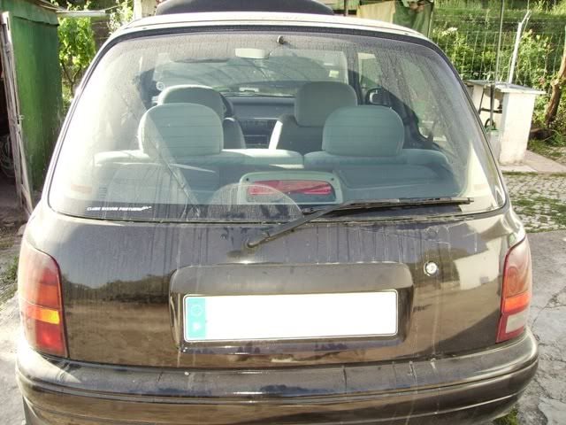

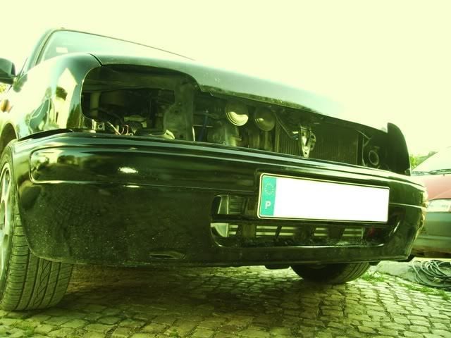

Need to rise the license plate so the intercooler get more air:

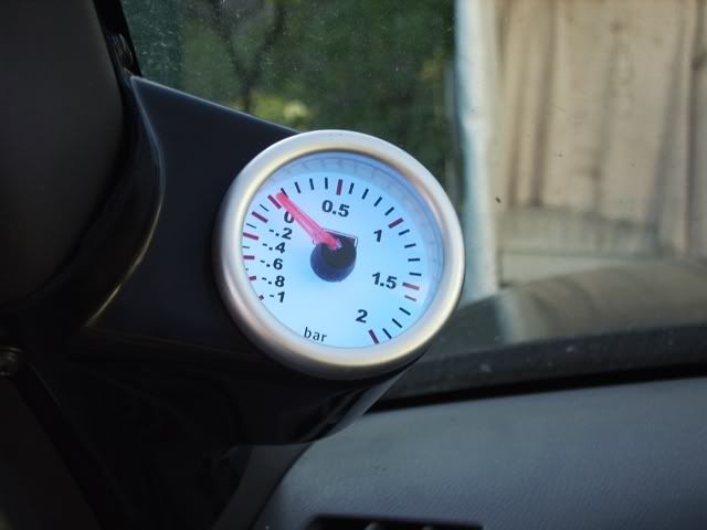

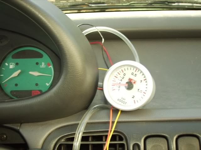

Boost gauge wired, just need a pillar gauge pod:

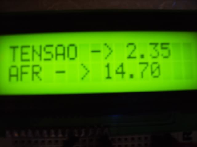

Wideband installed:

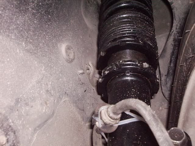

Front Coilovers with new collars:

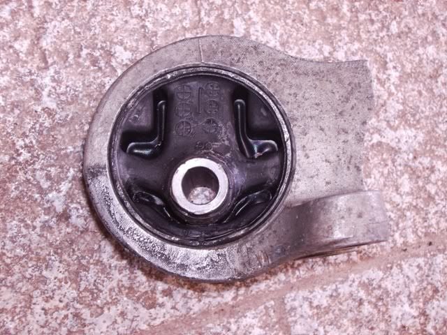

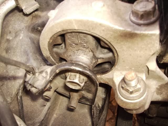

Another Nismo engine mount on a new bracket, this one wont get loose:

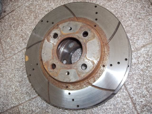

GTi-R discs with minus 2mm in diameter:

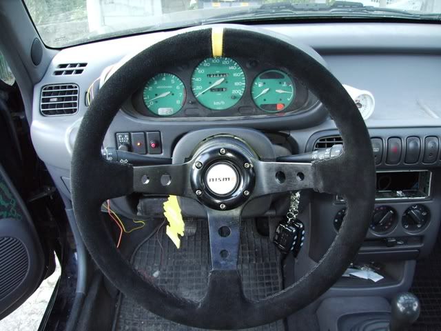

New steering wheel:

Hehe that's what I thought too, you have bought the same wideband controller :p
I have my wideband sensor/controller for almost one and half years, but Pollyp bought the display, i didnt. :grinning:
why don't you relocate the number plate to the left or right?
images
I cant mate, if the bumper has a place in the middle, i must have it on the middle. Only cars with no place on the middle of the bumper can use it on the side, and i dont want to attract much attention on the car. But its no big deal raising the license plate... (Y)
cut abit of the bumper above the reg plate off so its flush and mount the reg plate higher so the bottom of reg meets the top of the mouth opening
Nice idea, will do that if i have time, have less than 2 weeks to finish the car for our national Micra meet... :down:

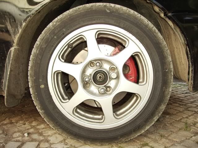

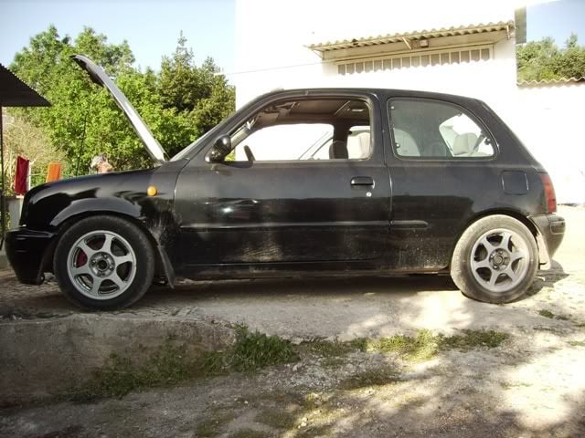

Installed another Nismo engine mount, "new" hub because the other one was a bit loose, the GTI-R discs from Stani with 2mm skim in diameter, modded rear wiper motor so it sits on lower position and adjusted the height of the coilovers:

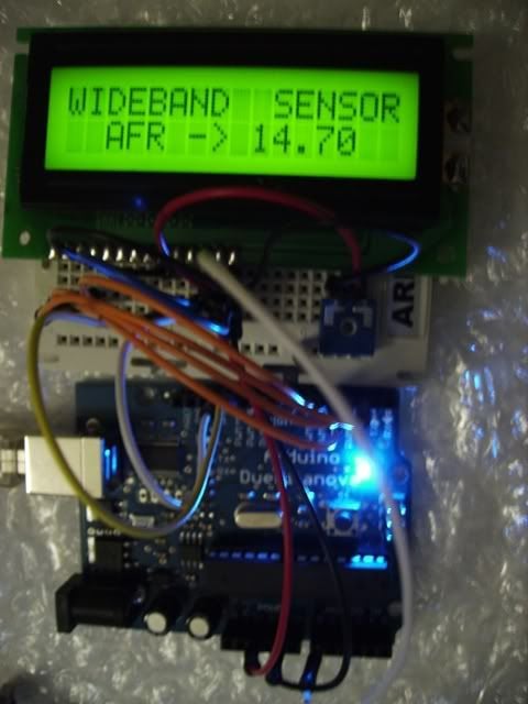

Still waiting for the intercooler pipes, so i had to make another mod, still on tests. Thanks to my brother i will have a Wideband display, fully home-made:

I'm very impressed matey, that is awesome!! Cars coming along very nicely mate
