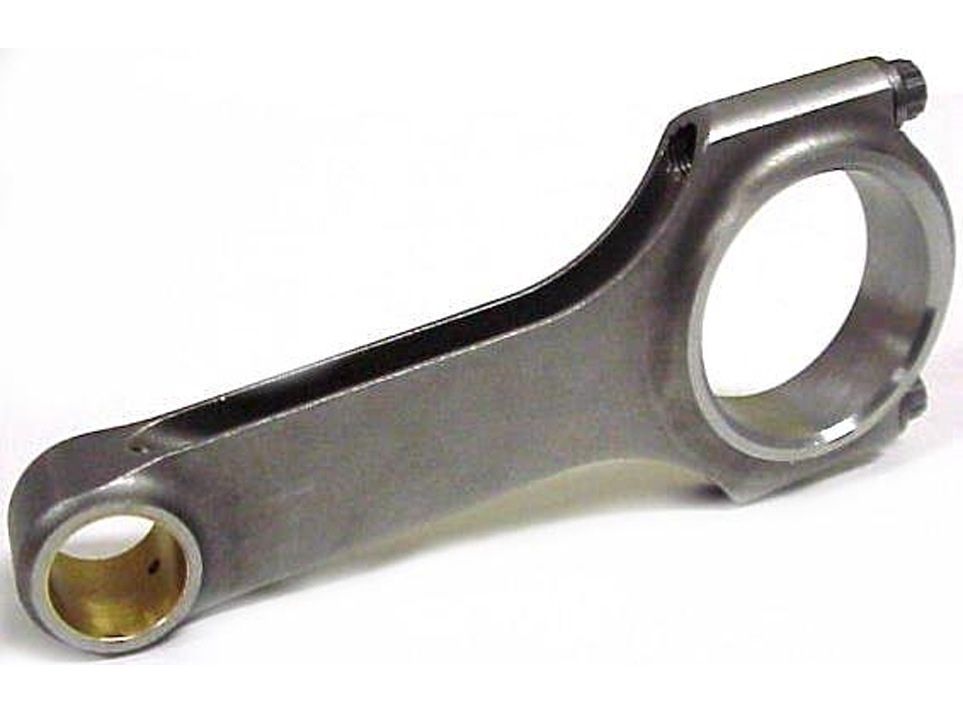

What piston and rod is that?Recieved the conrod im going to experiment with, if theres not much in it ill have the crank machined to suit and im getting custom pistons anyway. Need to get the ex-turbo engine apart and get started! Withinthe next 2 weeks ill hopefully know if they'll work and go from there
The piston isnt being used so im going to see if the gudgeon and micra piston will press on
And heres the forged rod ill be using if all goes well
