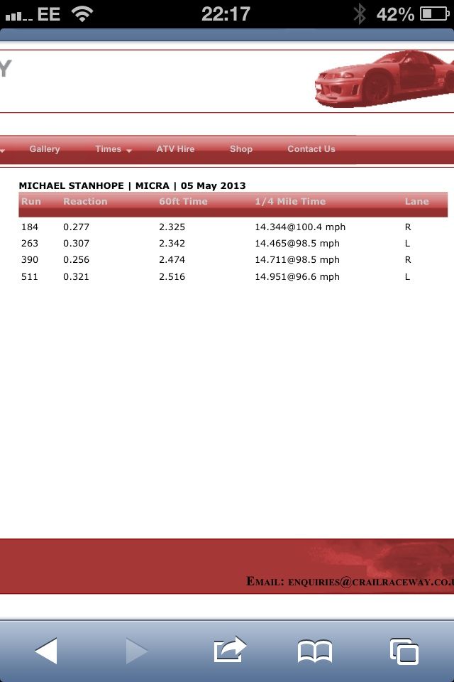

Yup but frank it felt poor top end, im sure it was already damaged from the start. I even said that to my mate in the integra that i wasnt happy with how it felt, post mortem is a while away, need to make sure i have enough bits to put it back to standard lol toying with forge pistons or whatever you recommend fitting ;)
aye the stock pistons are the weak link @ 170+hp eh stani (yours must be nearing 200hp to do 14.3,s)
