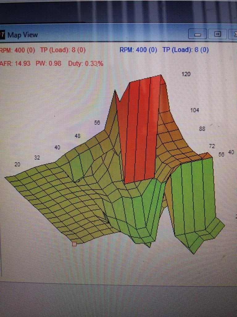

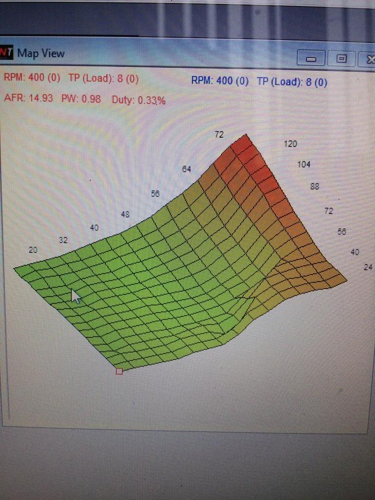

Last night i got the drivers side pulsar brakes done and also loaded a new map onto the car. i had sent the one from my car to baguette and he managed to tidy 2 areas up where my mapper couldnt adjust at the time (turns out the section near the top of the rev range was acting as a fuel cut which explains the 6300rpm limit) so upon loading that the rev limit was instantly 6900rpm and i thought **** it and decided to have a little tweak myself! Turns out i needed to start from scratch from about 3500rpm upwards but i think i got there and there is a noticeable improvement in terms of coming on boost and the revs through the gear changes! here a few pics of the maps:
original map
armando's tweaks
my go
the low rpm high load areas are still to be sorted but when i was mapping last night i cant see me ever being in those areas so its fine to run at the moment.
Also high up the revs in 4th the wideband shows high 11's which will be slightly lower at the same rpm in 5th
original map
armando's tweaks
my go
