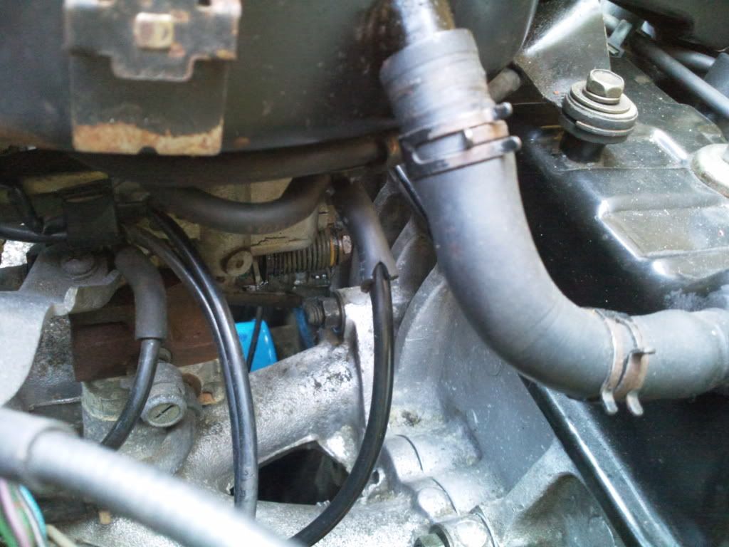

Check the plugs to see if they look mega lean. Knocking on a NA MA10 is INCREDIBLY RARE, to the point I have even tried to make it happen and I have never succeeded, so something must be wrong, and the only thing I can think of is very lean fuel mixture. They are incredibly simple so it shouldnt be hard to solve. Perhaps see if you can find another non ECC carb, and swap it over that may cure it completely. Do routine checks too like oil/water to see that that is all ok.
Steering should be the same. It was not necessary to remove anything relating to that? Short shifter is a complete pain I agree with that. When I moved the car for you to collect I was surprised how tight it was.
Split breather pipes mate, ordered some of Boostjunkies which should be here tomorrow, as soon as I sealed the split, Sweet.
Srted the stalling :D Still sunds a bit ropey
Ok that explains the idle. PLEASE do check the plugs I once killed a test MA10 engine on bike carbs that was running lean, however it still sounded fine. If yours doesn't it does need looking at.
Right, think I've found what the knocking noise was. Huge plastic connector unplugged and dangling down near the gear box. Battered to bits as it stands now but cable tied it up out of the way. Hope it was not meant to be plugged into something since the manual conversion.
Spent 30mins cable tieing up all the other loose disconneted bits and bobs to stop them rattleing around in the engine bay.
Also spent alot longer than 30mins (plus :) )changing most of the pipes over :)

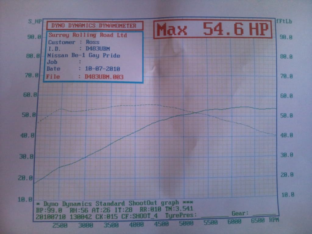

Awesome car bud! Sitting here chuckling away over the name on the Dyno printout :laugh:.
Yeah, Charly has a sense of humour, tis ok, I used my knob to rim the dor handles on his Porsche :D
