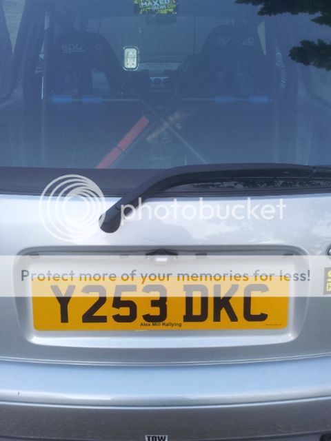

Should do. You could always take a bulb out of one and check - Probably equivalent to cutting the wire.
What light(s) are you removing ? (Always looking for new areas to save weight on)
Ah pics didn't load last time for me, hence question.
Already done that, replace the twin lights for a single LED one designed for a bike, VERY light and bright and draws very little current.

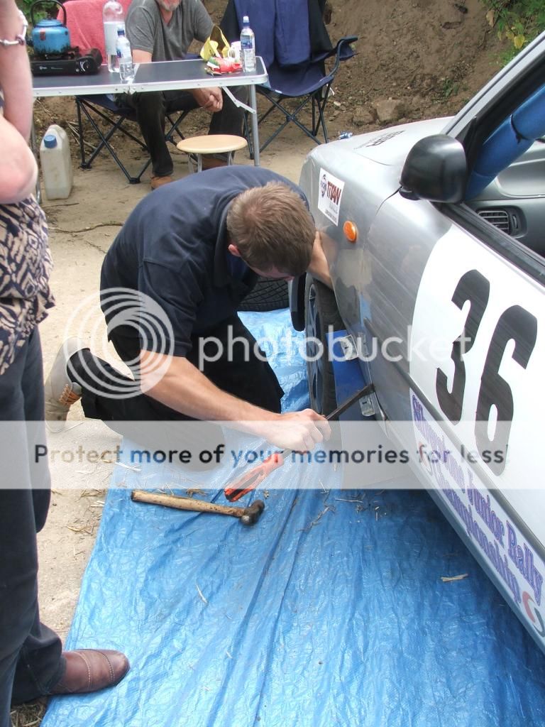

Allen key in the top and open ended spanner?
7mm "brake caliper" allen key and a ring spanner, not an open end
Turn the allen key only, clockwise to crack the seal then use the spanner![]()
