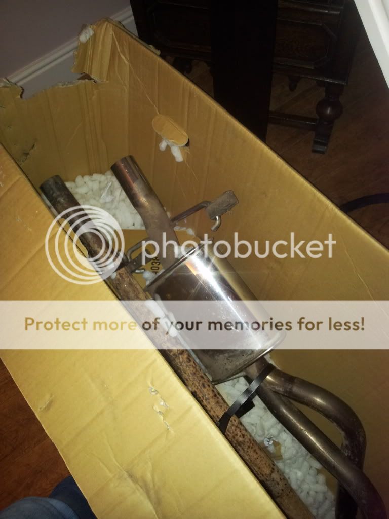

Only gaskets I got for the PLR was where it joined the bottom of the first cat for mien anyway. Just used exhaust putty and slide the exhaust together for the rest of it
Weld a boss in mateThe minimal modifying begins yes
Getting it fitted tomorrow morning, am stupidly excited...
Only issue is, cars got a two lambada sensors but the exhaust was designed for a micra with only one ( dizzy engine)
You reckon i could leave it unplugged or should I just weld a nut on and plug it in?
Weld a boss in mate
Ooh... I'll send you a sketchAye, thought as much, should be easy anyway
You need any more measurements whilst the cars going to be on a ramp?
an extended boss will be preferable faultcode evasionThe minimal modifying begins yes
the 2nd lambda needs to sense a diluted flow alex (else the ecu assumes the cat is shagged, and flags a mil)
i had assumed you were decatting mateEven though I'm keeping all original cats and manifold, is one of this still necessary? I thought they were only needed if you did a cat delete?
is that new exhaust 1st catback or 2nd caback alex ?
yes the reason i asked mate, the coilpack cat is longer eh1st cat back, only got the one on coil pack engines (mani fold cat)
if it does hit the a/r/b, you can just fit the earlier mani/cat eh
