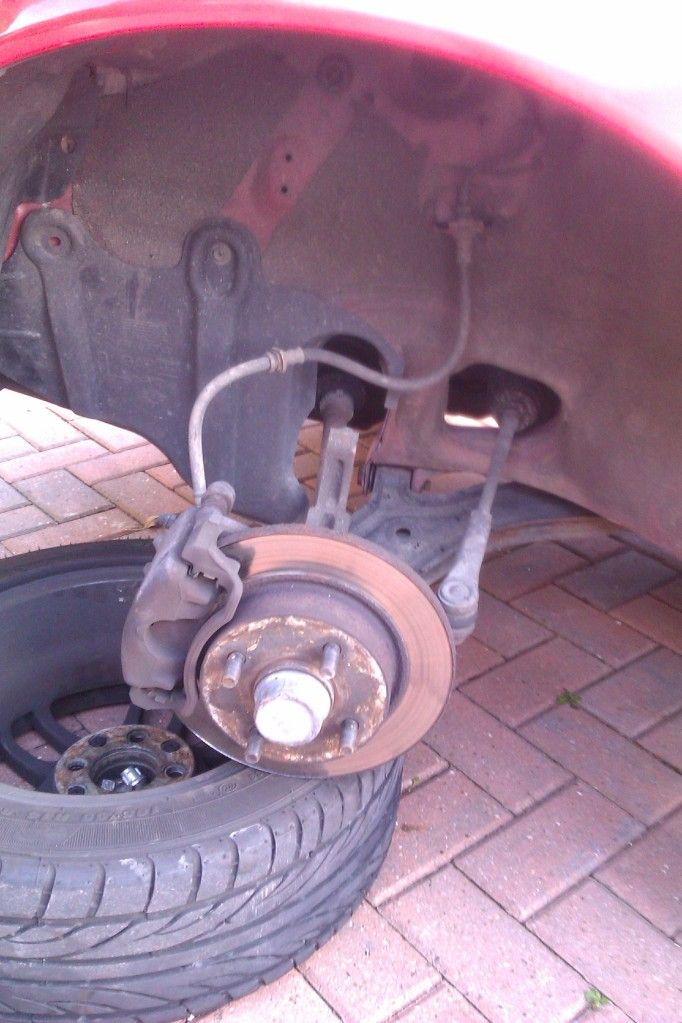

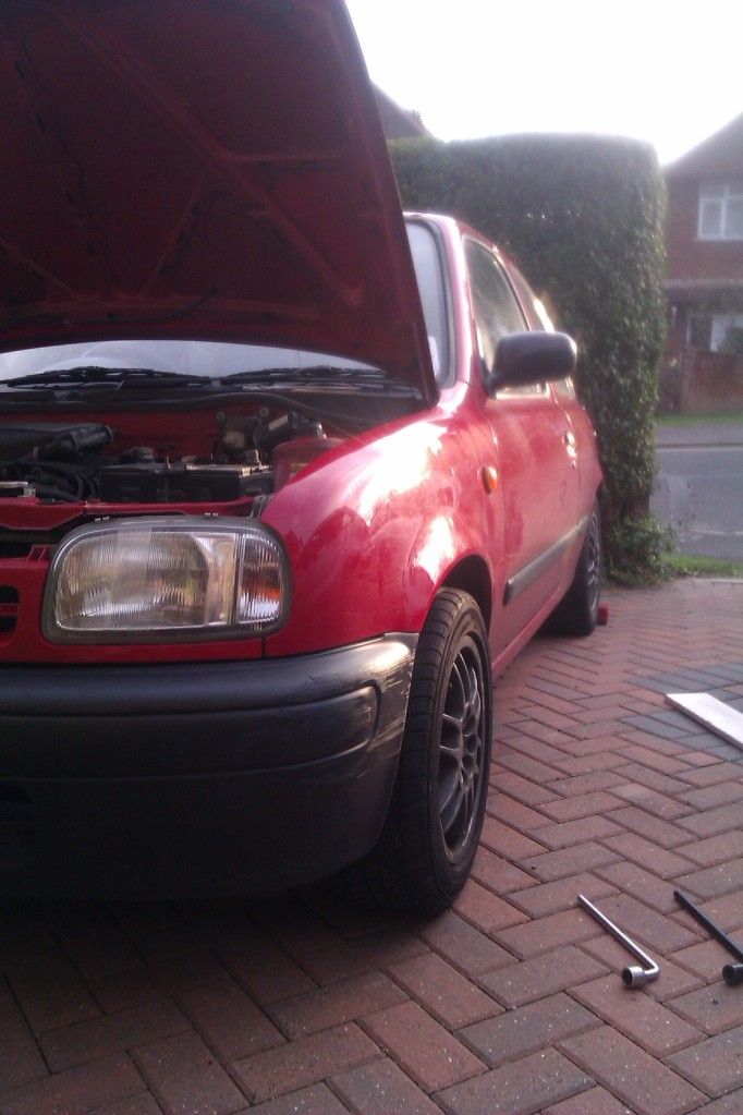

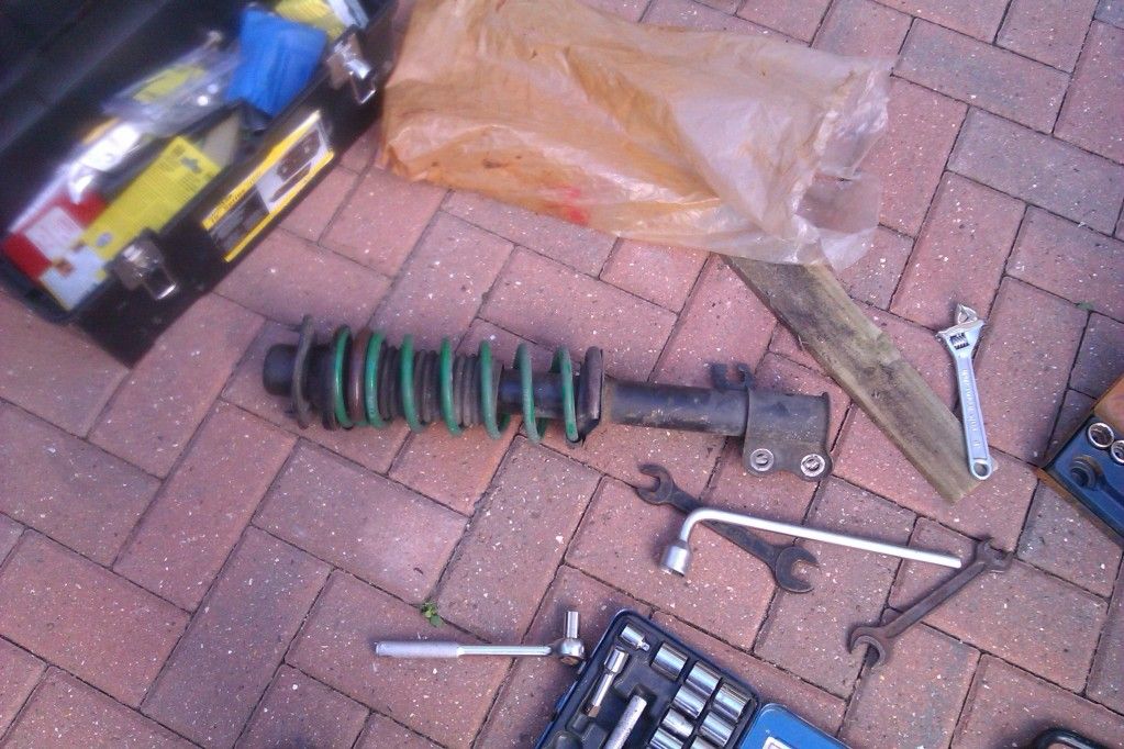

Wdid? Made it lowerrrr, ish. Took a coil off the front springs, could maybe have done another half coil but figured see what this is like first. driverside has settled nicely and looks mint :) passenger side has had no weight (my fat arse :p ) on it like the driverside so ive parked the left on the downhill part of the drive to get some more pressure on it to settle overnight. If its not evened out nicely by tomorrow or tuesday i'll have the front off again and take another chunk off each side or maybe swap the left/right springs over as the right has most of the weight when its just me in the car all the time.
Shocks out
Free shock makes it easier to check the spring will still seat once cut
everything back on after cutting
left
right
has settled more not after a drive but its not perfect and too dark for photos anyway

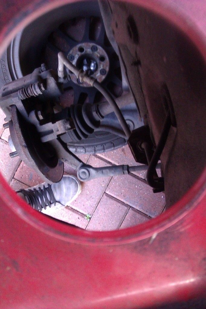

Well today I managed to fit matiz setup to the front, now when I drive I can feel left side wobbling, its not the tire pressure or the wheel studs, moved forward creeping while popping my head out the driver side to see if the driver side is ok which is normal compared to the left, whilst installing the matiz struts I realised the left side drive shaft came out the wheel hub, like flopped out :s tried putting it back in but there was a small wosher kind of thing on the driveshaft was out of place small metal ring, to make sure what did people use for the assembly of the strut when using this setup? Ie top mounts rubber things and the cup? Thanks in advance
i used the micra top mount and matiz cup on mine pal :)

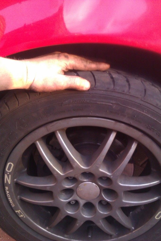

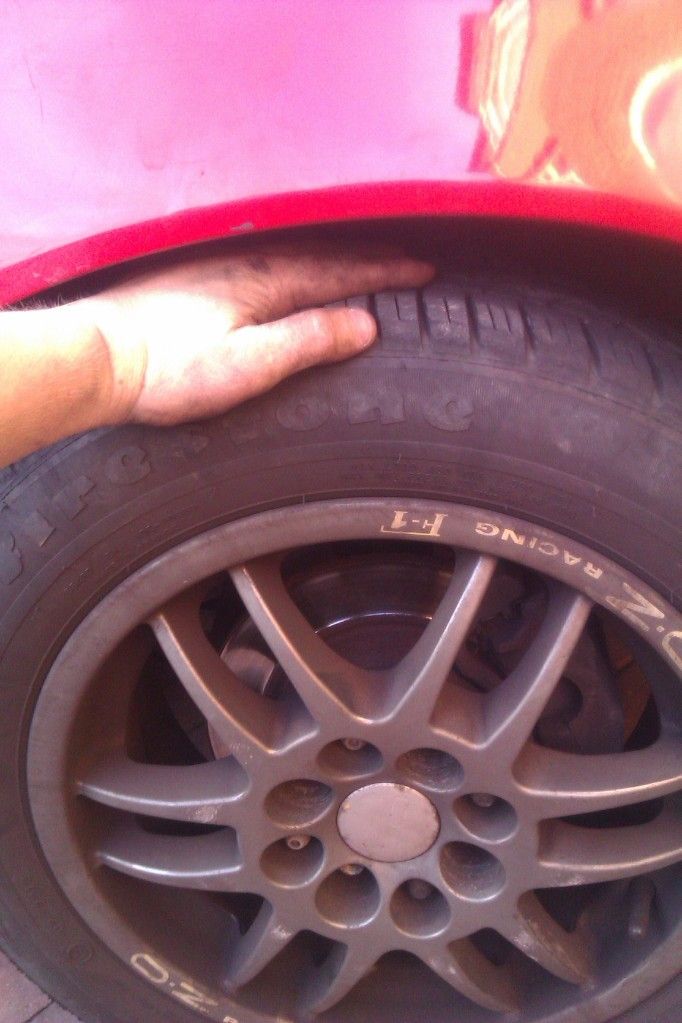

Added some neg camber, just a little, looks much much nicer. Cheers Frank for tips yesterday.
But I got carried away filing!
Only joking, did the bolt trick behind the hub.
