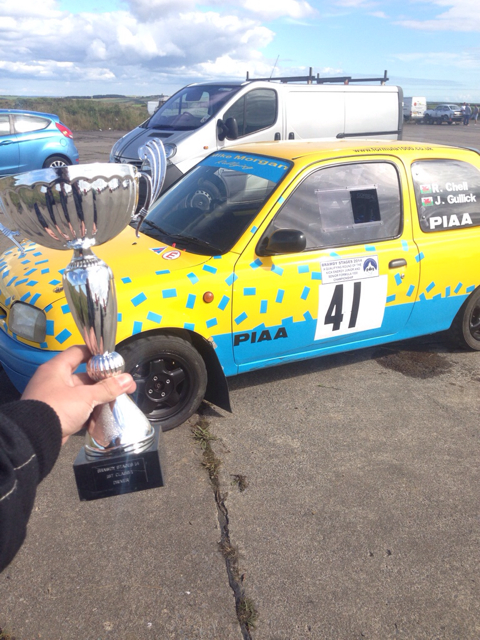

1st in class, 19th overall! Caught and passed 1.4 MG, 1.6 Nova, 1.6 C2, 1.3 Mini, MK2 Escort(twice, he didn't have problems either!), and almost passed a 1.6 206 3 times.
Beat so many higher powered cars in the little beast!
Gearbox topped out 85mph @ 7000RPM but the tight sections were rapid.
Happy happy!
