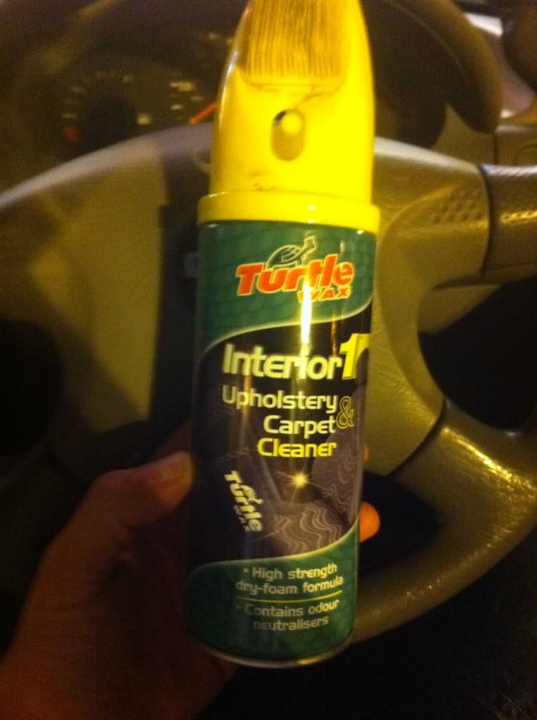

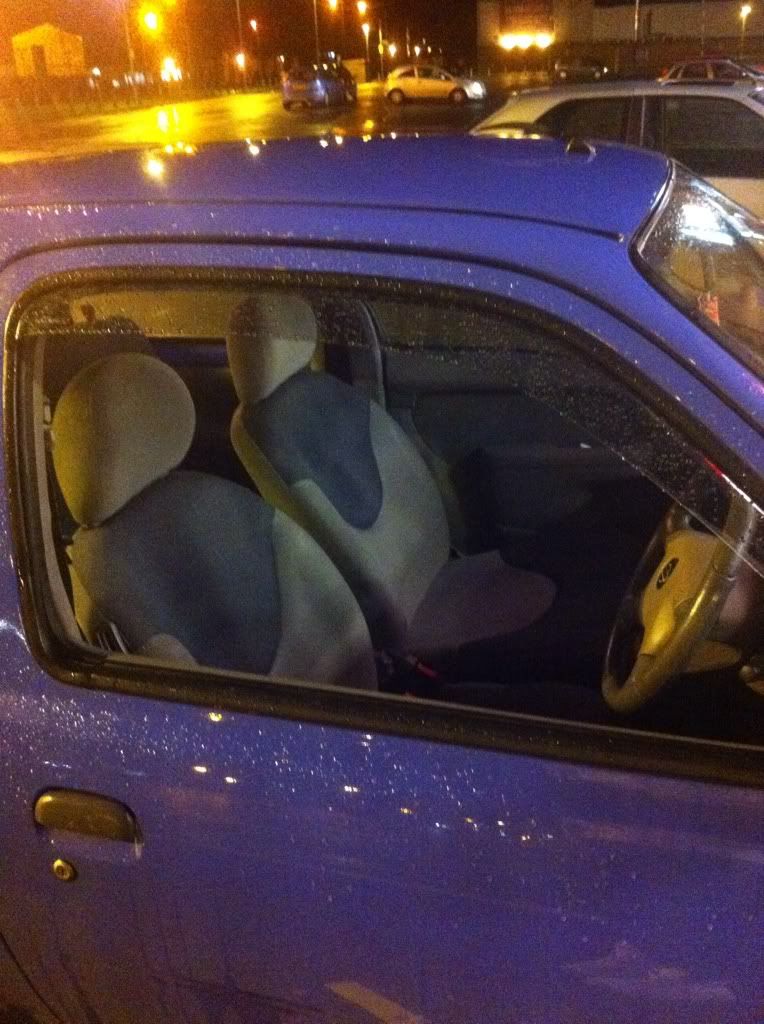

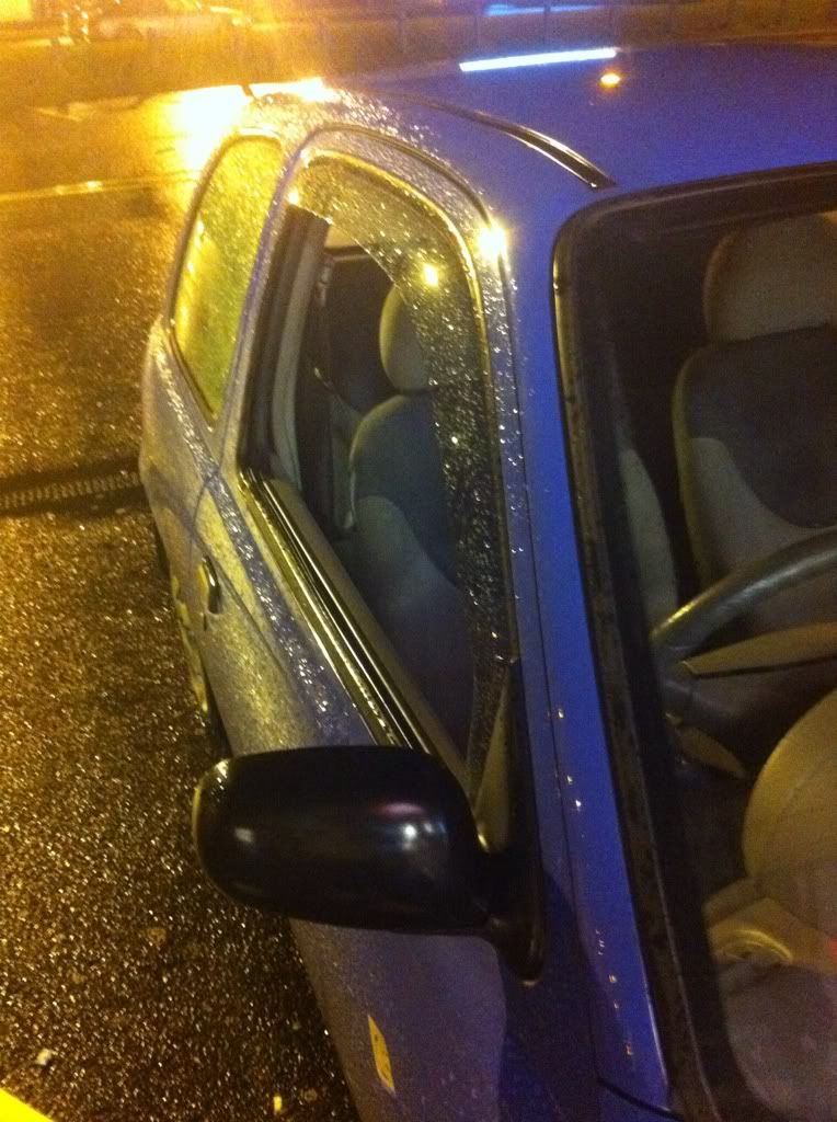

Oh and bought a interior shampoo il end up doing soon and some wind deflectors fitted :)
