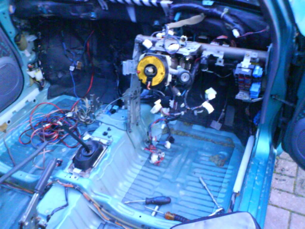

you little 2 bit,,,,,,,,,,,,,,,,,,,,,, eng sensor , eng fuses , interior fuse loom swap succesfull. car started,eng check light flashing car switch off happen'd 2-3 times till i realized my other nats key is on the same bunch.started with no check light and cars running smooth now under 2k cruising is back
