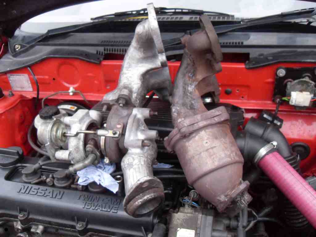

Im running 7psi from the T3 on standard internals. Done about 5000 miles now and running sweet. Please with how quick it is. :)
When i first did the conversion i did a small (and im sure inaccurate video) and 0-60 was about 7.5 - 8.0secs and that was with lower boost than im running now, standard biscuit tyres, standard suspension and my MK1 bodged exhaust.
Now im running double the boost, coilovers, 15 x 7 steels and decent MK3 version exhaust.
Will get another video up at some point.

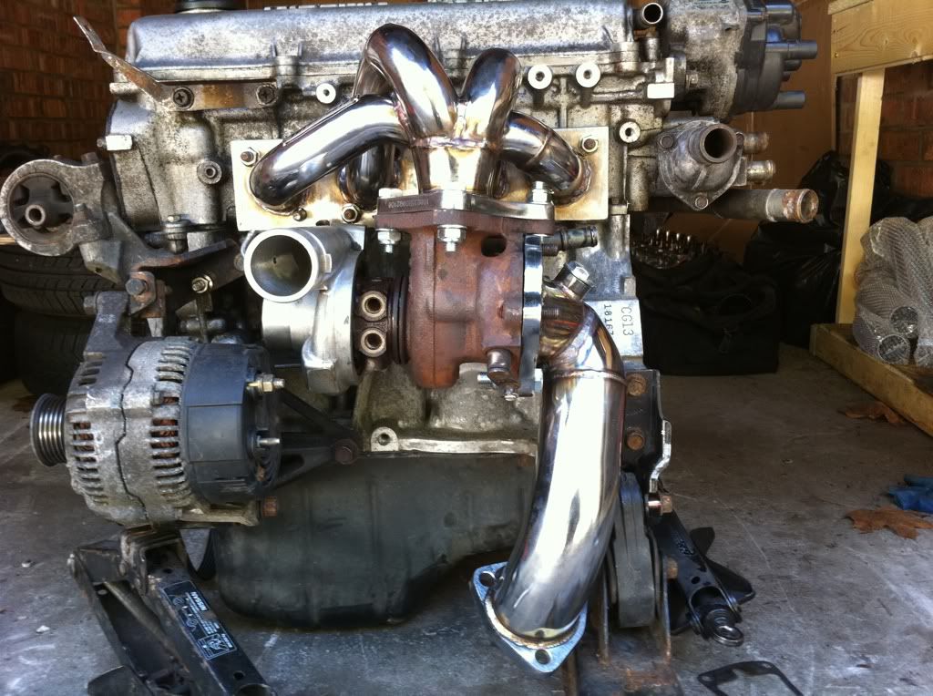

Stani1029
That looks the dogs bollocks. Did you put a bigger second cat to make up for emissions stani?
No i dont use a cat with the system i had made but i have a seperate system which im going to fit for MOT that includes a cat.

You dont really need a welder. The only bit you need some custom skills is making the exhaust where as a welder does come in handy.
As for the actual conversion you dont need that much other than normal tools and depending how you route the intercooler pipes then maybe an angle grinder.
Where i routed mine i needed to cut a bit of the front panel but i did that at the same time of replacing the front crossmember.
Any questions if you do the conversion your more than welcome to bung me a PM or even call me if you get stuck. There is loads of us on here who have met all the pitfalls of turbo charging. We can help.

This is the Manifold im considering, franks sexy handywork - believe the turbo to be a T15?
