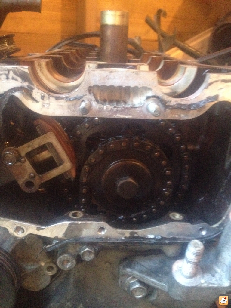

Some problems as always happend, I have opened the timing cover off and took off the timing upper retainer out as I wanted to fit it back on 1 long screw fell down the bottom, put my hands down but no luck. I try to take the bottom cover off but it's not coming off. Can anyone help ? What if I took my oil sump off wil I find the screw ?
I say should. I always took extra care when changing the top tensioner on my 1.0...which I did several times.
Sent from my HTC One using Tapatalk
U mean 2nd mark on the pully? And then like tip ex on both cams and then take them out? Will the cams come out with the timing pully coming off ??
there,s a thread on here from about 2009 azzy, where a member dropped 1 of those 2 tensioner bolts down the void, he ended up taking the sump etc off
If you bought a haynes manual it would explain all of this lol
I have the manual on my apps and I have followed it, but there is no markings on my cam pullys, as someone here said it might be in my sump, and I can make my own markings but saying that how do I know if the last owner had it timed probley for me to make the markings and just melting pistons lol
the markings/coloured links wear off usually azzy, you just count the links between the dots on the sprockets (loads of threads on here and cisco,s)

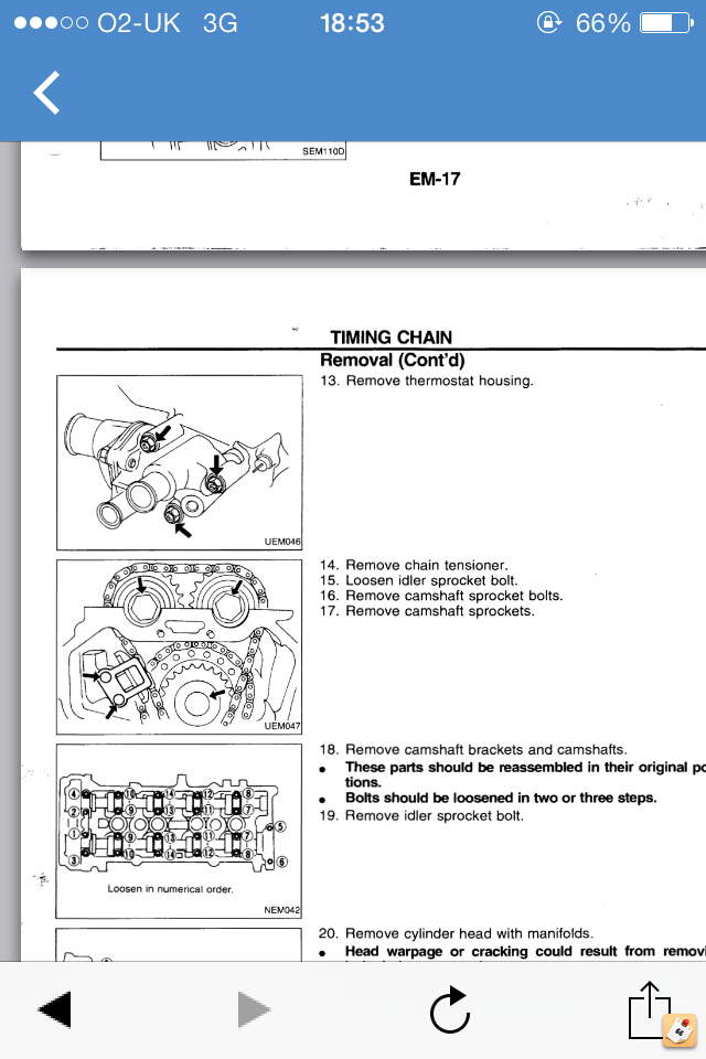

Frank on the Nissan manual it says take cam bolts off, chain tensioner and idle pully bolt but won't that move the other pullys and cam if my chains still on ?
you only need take 1 sprocket off mate, 22mm socket and breaker bar, and 22mm open end on the cam
u can't get it to open frank I had a big breakers bar on it with a 22mm socket on cam end and a 22 mm spanner on inside cam holding it down and trying to break it loose, it's really tight or stuck
Nah youre just not strong enough, putting weight on the breaker with your foot and holding the cam with the spanner always works

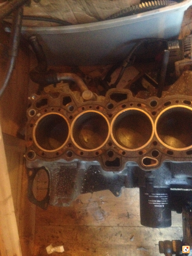

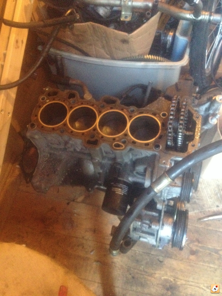

now just checking the pistons looks clean and no wear or scratches, need to 2x head gasket, will I need arp bolts ?
Standard bolts are fine but I'd recommend buying the victor reinz headgaskets over any cheap ebay/motor factor ones
Yeh it's more clean now as I cleaned it with wd40 with a smooth rag, so do u just drop 2 gasket in without sealing it ? And then drop head on with bolts ?
think my chain is ok, has Polly or frank use 2 head gaskets if so are they from eBay or custom, or from Nissan genuine ones don't know wat will suit boost
2 x Victor Reinz OEM ones, pretty sure Stani mentioned this before

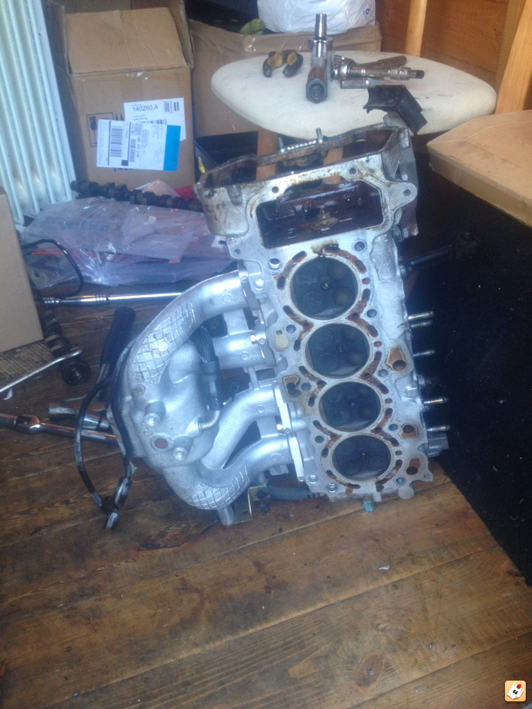

if the sealing sections of the head are really pitted or warped then skimming it would help.
if it's mosty smooth then I just clean it absolutely spotless n dry with carb cleaner and clean rag.
if there's any remaining bits of gasket/dirt on the sealing faces, I lightly scrape the surface clean with several fresh sharp razor blades (don't scratch the surface, just the unwanted gasket/dirt) till u only see shiny metal and clean & dry with carb cleaner.
I used single victor reinz HG (genuine nissan ones) on my turbo no probs.
nissan sell em for £80 but I got the same HG from ireland for £34
http://micra.org.uk/threads/pollymobiles-rebuild.35251/page-98#post-637680
cheapo ebay HG don't last well under boost.
fitting head bolts, I thoroughly clean, retap, reoil/regrease every one to ensure smooth tightening with a good quality calibrated torque wrench & angle gauge.
