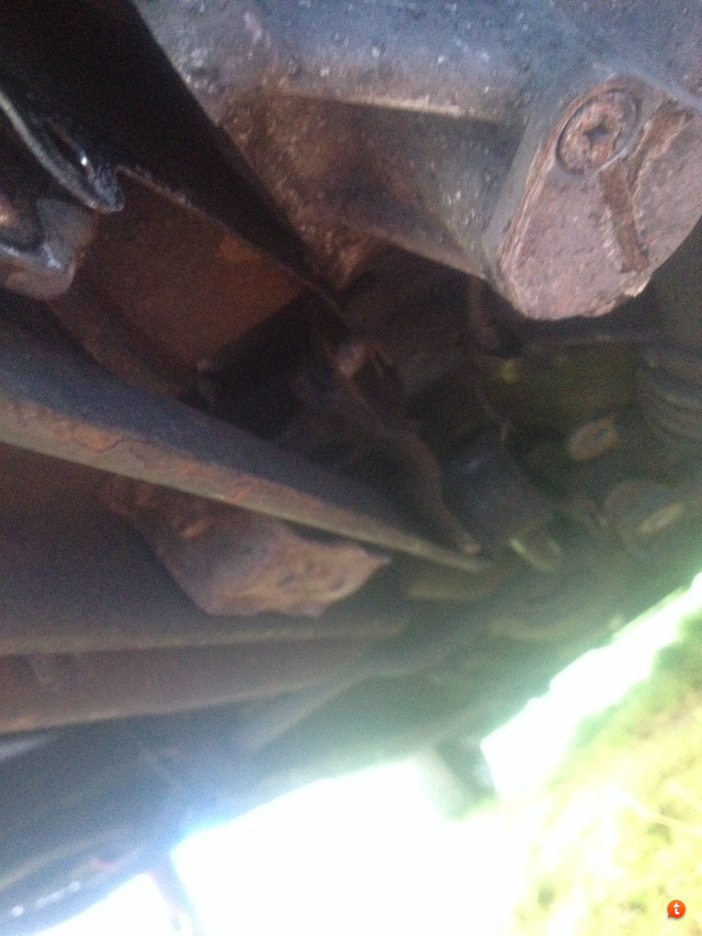

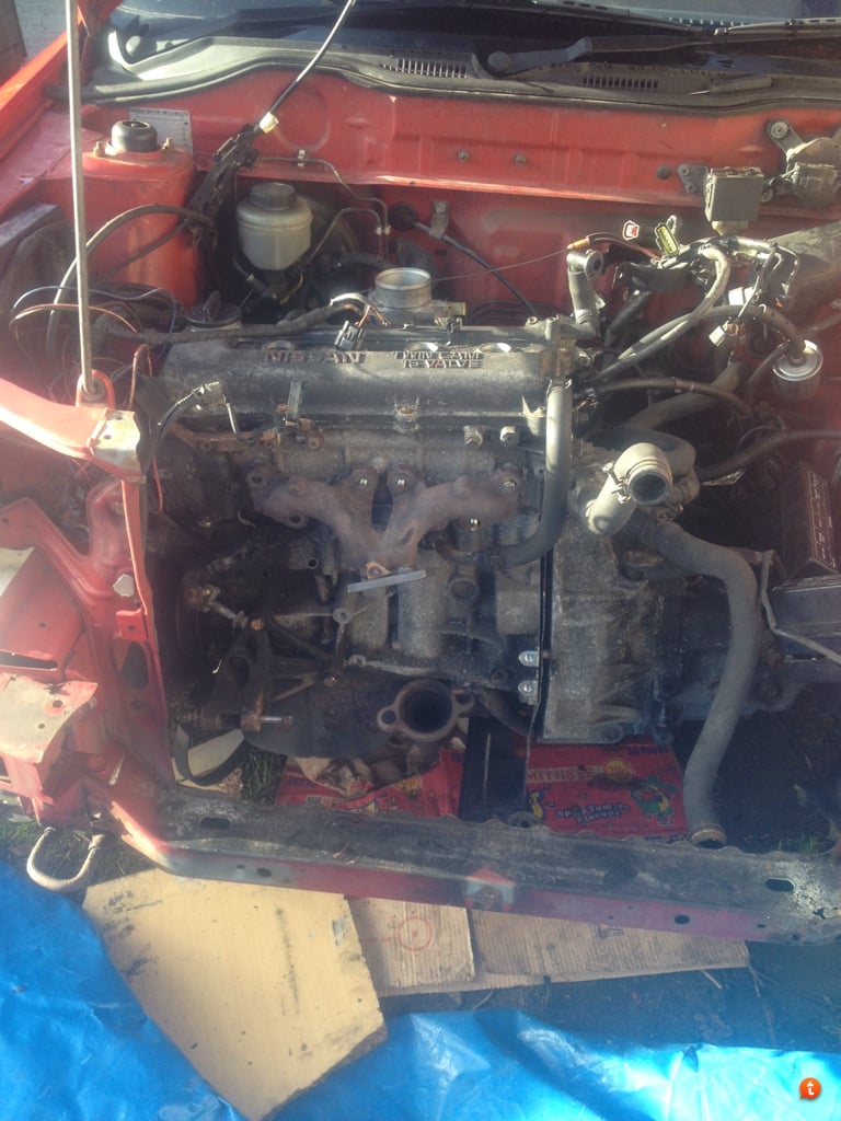

All bolts out now so nothing should be holding it in?, its looks solid on the left hand side or is it sat on support bar?
U mean under the engine where the rear mounts are that bar ?don't know how you are taking the engine out but could you just undo the support bar?
the engine is in place with bolts and gearbox now but the bolt is bent ? And it won't bug off I have to hacksaw it off but how will I get the broken bolt off after ?If the nut is off you might have to line the engine back up to knock the bolt out, and yeah maybe remove the support bar just be careful![]()
Am guessing that's best way and more safer getting under the car and then get that bolt off ?I would bolt it back up via the other 2 mounts and deal with that first bud then you just got the other two to take out to drop the engine

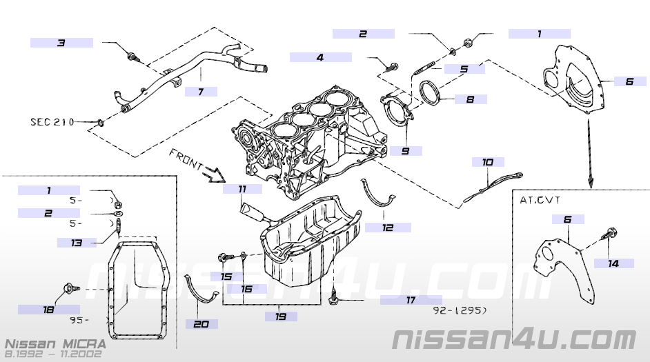

yes Polly it's on a plate holding on the gearbox ? but the bolt isn't coming off ? is it best to take the gearbox off and shafts ?reason why its not separating is cos of that annoying black metal splashplate (once been through all that hence left it off for good).
it sits between the engine/flywheel, RH shaft/gearbox, rear mount bracket/gearbox.
so to remove the engine, you'll need to remove the RH shaft and rear mount bracket off the gearbox.
Yes that's the one PollyNumber 6 Rear Engine Plate:

Polly that is so right it's too heavy on the bolt by 70kg, Polly am thinking if u can help with my enginelooking at the pic, the 3 bolts that are holding the rear bracket to the gearbox ain't coming off cos the entire weight of the engine/box is resting on the centre beam causing a shearing resistance. need to lift/relieve the load off the bracket

I didn't wana get a crane and then the days no good to start the work, I thought I'll try how frank did his by lifting the engine out and leaving gearbox in, And this blog is only for time being, I will start a fresh blog when my cars all doneWhy on earth didn't you just get a crane. I just bought one then resold it on eBay a week later. Still your turbo build makes for fun reading. Keep up the good work.
