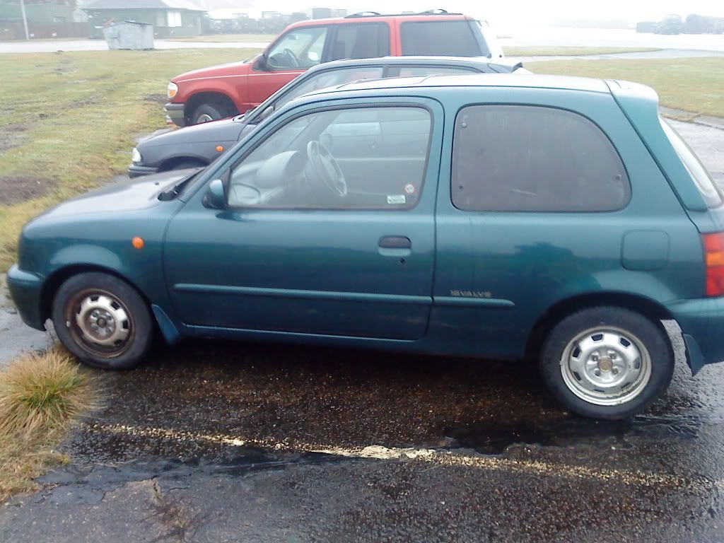

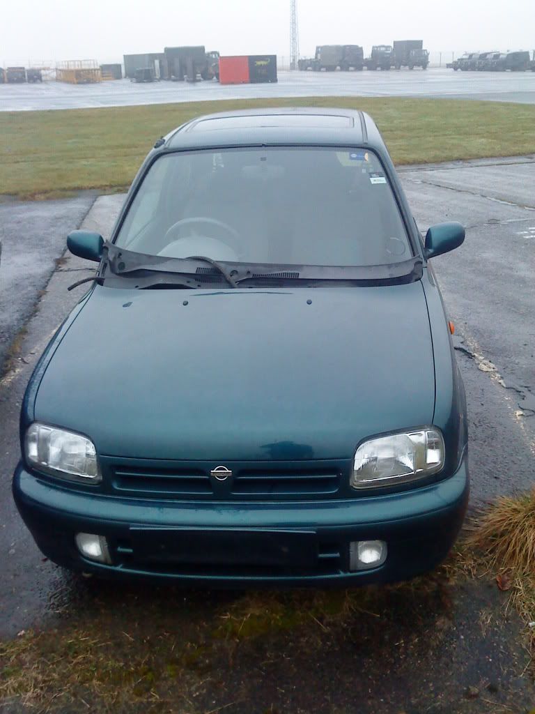

As I've said before in my intro post, I have been given a '95 Super S. The car is in a real state. Got some pics, and will get them up as soon as I can host them.
I've bought a new battery and she fired 1st time. :grinning: Now for the work to be done.
Both front seats are out, and I´ve only got four bolts.
Handbrake disconnected. (Done today and working great)
Rear indicators and reverse light not working.
Touch of rust on boot.
Boot stays missing.
Wipers not working in front and missing arms (Got arms today)
Battery clamps need replacing
Rear wiper and motor missing (May just get a grommit)
Front crossmember needs replacing.
And loads of little things that need connecting!!! :suspect:
I went to a scrappy today here in Germany and found a UK micra so was chuffed. Got a few bits off it but will be raiding it soon. LOL
Thats it as far as I can remember, but I will get her back to her former glory!

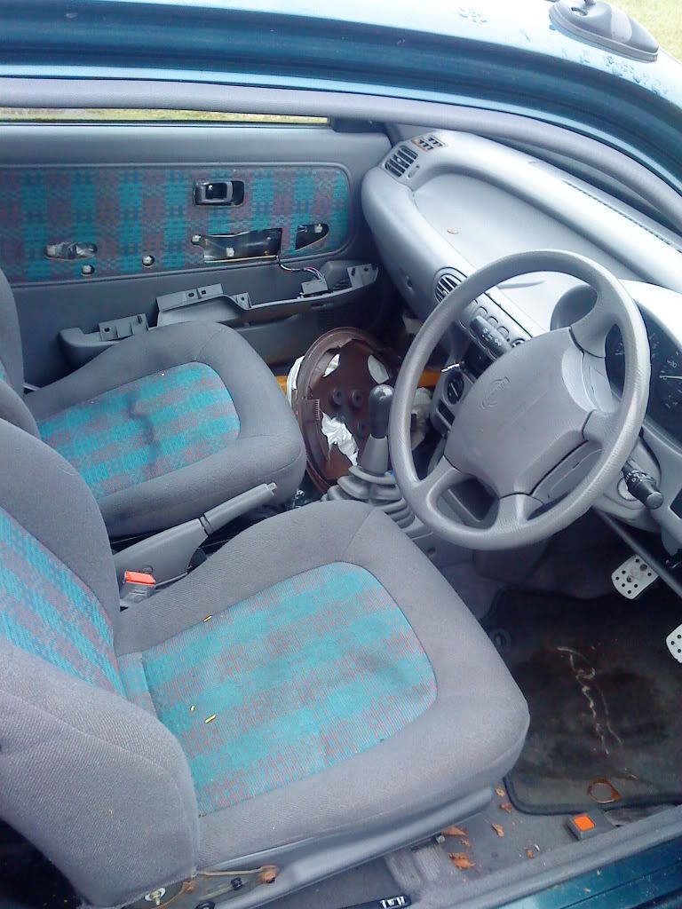

ooh hang on to those seats mate that trim is rare as fudge cake! its the same stuff as in Ciscos beast :D
ah wait i have just noticed you are in Germany, i think that makes this car an Sr, basically in some countries instead of getting the Sr model, they got a second addition super s (the super s badge at the back will have a red S on it) it has the air bag and that blue trim which gives it away

This Super S is actually an english version. We all here buy our cars in the UK cause we get them tax free (classed as export. I got my Zafira in Nov for £9500 brand spankers) I know the original owner of the Micra when he first got it, and it has had another owner since. I was keeping the trim cause I quite like it, which is the best reason LOL I was thinking of painting the center of the dash and a few other bits the same green as the car?
are they? ive got that colour trim in mine :D ...i personally prefer it to the red/purple combo.

ooh you have that trim? i think i have some door cards in the red and purple, and MM has some seats he may be shifting ;)

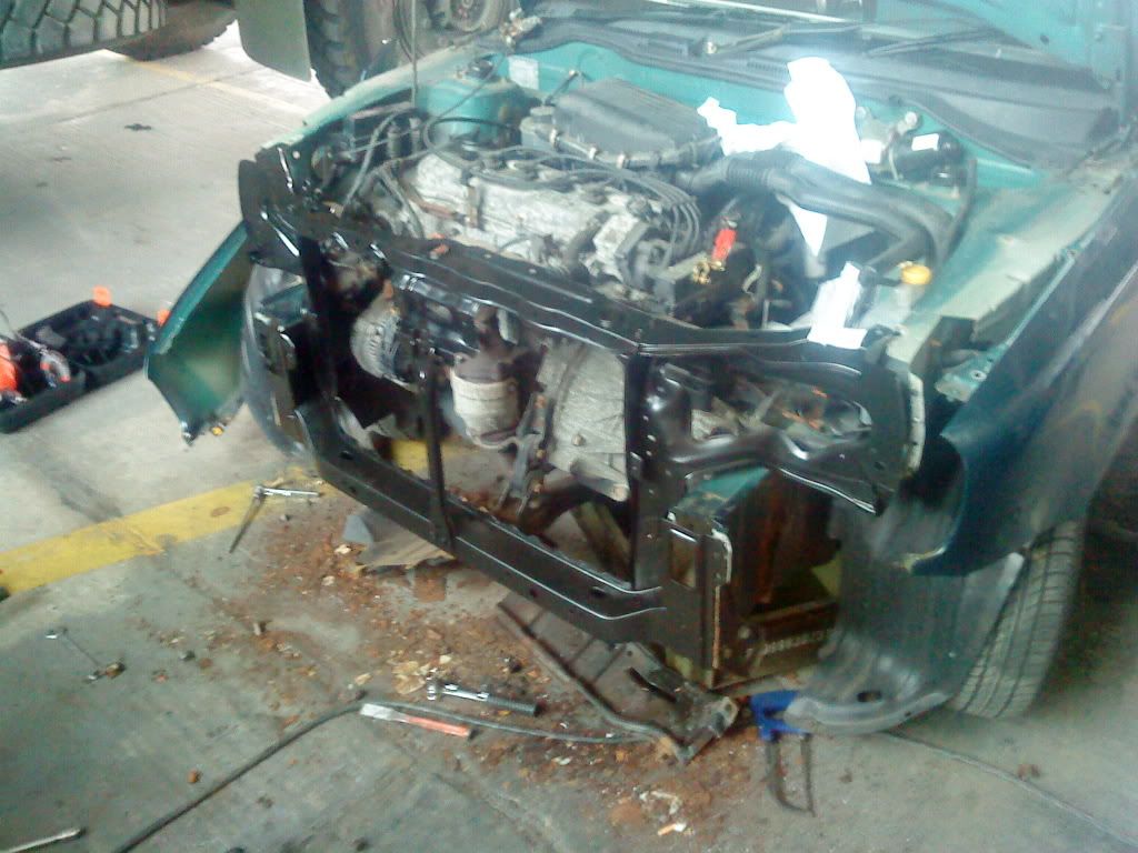

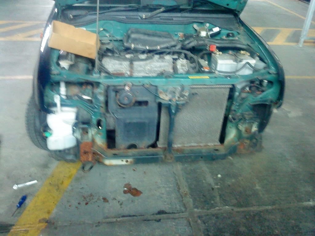

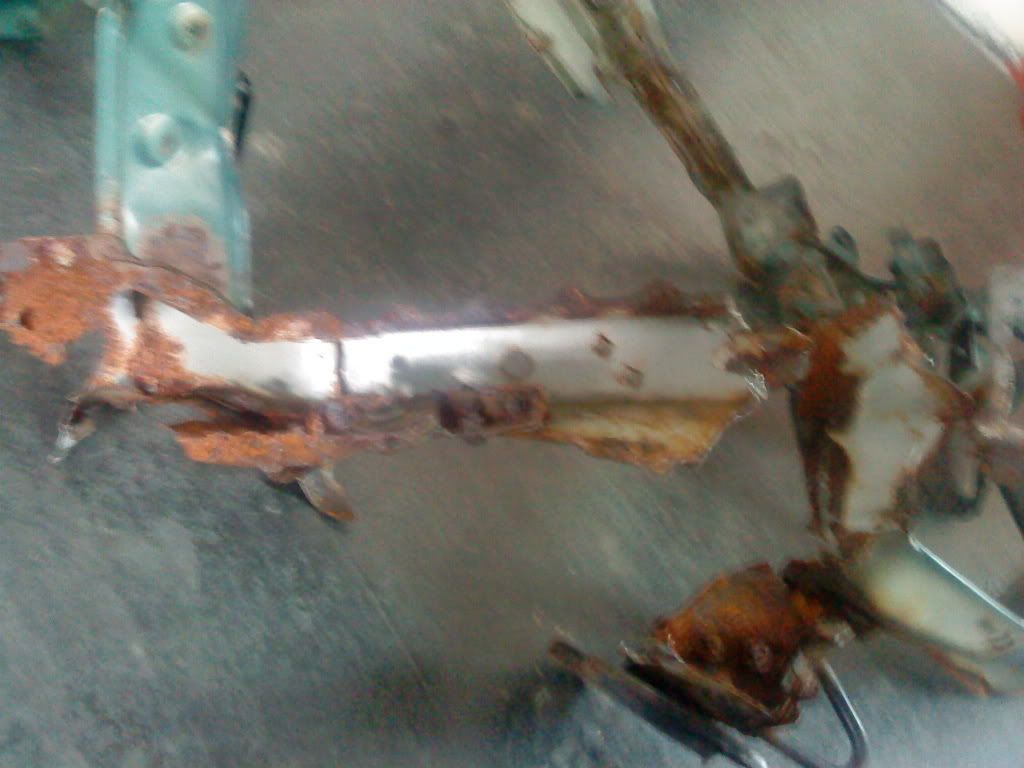

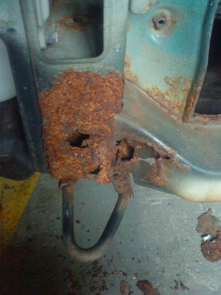

Took an hour earlier to go and strip down the front of the car. Found a big hole on the drivers side of the crossmember, and there is no metal at the back anymore.

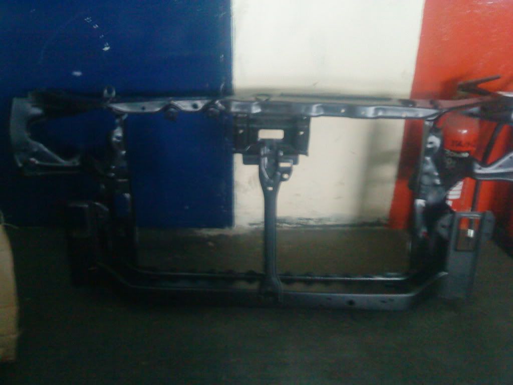

But got my replacement already!!
One last thing, anyone know how I can change my main title to Tim's Super S??
Another quick update. Took my 3 and a half year old girl with me to camp today to do some more work. She's a real lil spanner monkey. Just had to ask and the correct tools were passed. lol
Managed to get everything stripped out that needed to be ie radiator, horn etc. just grinding left now because I didn't want to do it with her around. So hopefully will have my new front panel in the next day or so!!
What I did discover was a hole in the drivers footwell so going to clean it up and weld a plate over it. Hopefully no more surprises!!

That is some nasty rust you have there, I took the front bumper off my car and found a large rust spot but it's easily changed. That new front looks the business.
Another quick update. Managed to get the front panel and cross member off eventually. Some of the tack welded nuts broke loose thanks to the rust, so a bit of a struggle, some blood (literally) its off. Just to show the back of the crossmember and I'm sure it'll be understood why I needed to change it.
I know its a bit blurry. Thats the back btw.
And the new one fits a treat!! Just got to weld it in now and get some new radiator mounts for the bottom!!
More when i get the welding done and the rad back on.
