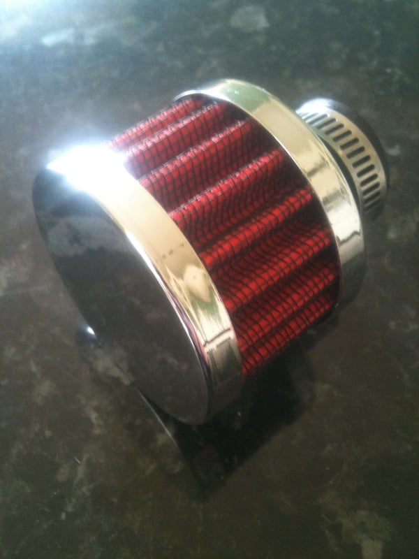

Just ordered a mini filter :p
Can someone please help in regards to the filter?
This is the one i want right...?
http://www.ebay.co.uk/itm/K-N-Air-F...arParts_SM&hash=item4155a989cf#ht_2181wt_1163
However that looks square, whereas the filter in the box i have looks more rectangular like this...
http://www.ebay.co.uk/itm/N15-Almer...CarParts_SM&hash=item19be2f72b2#ht_883wt_1163
But my box looks exactly like the one in that picture Frank just posted.
Bump, want to order a filter tonight.

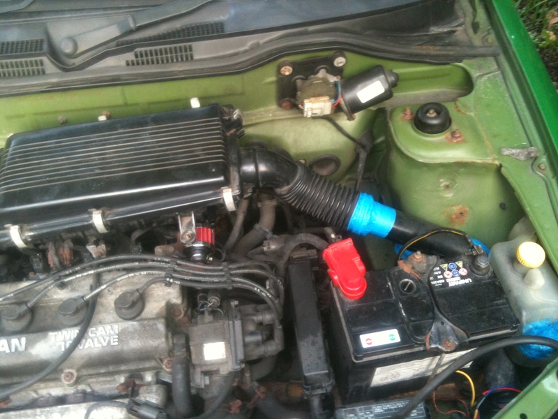

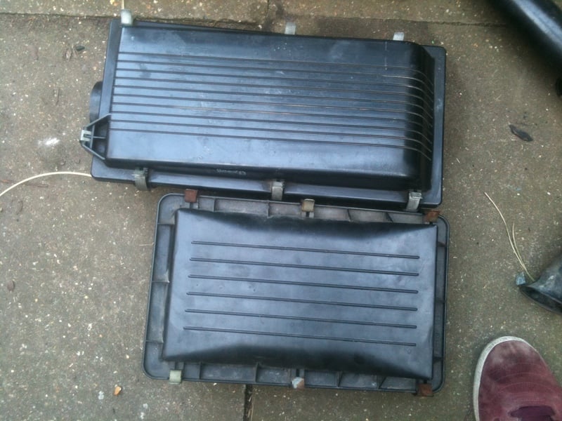

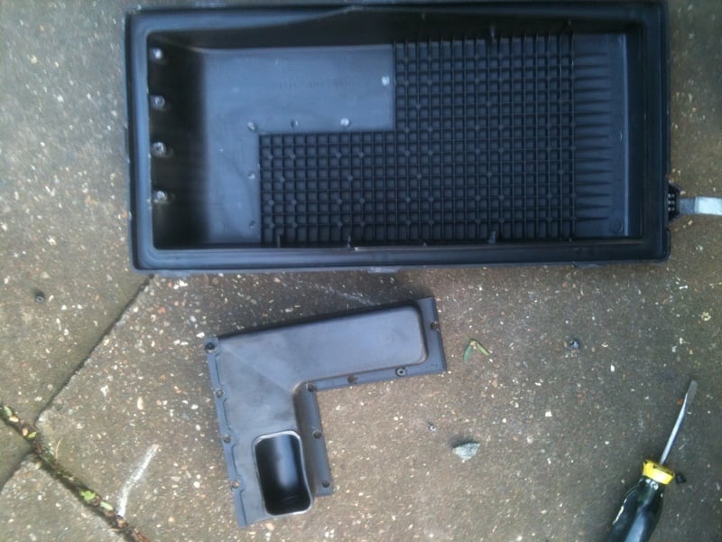

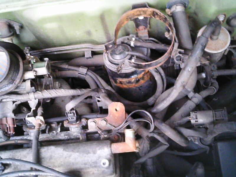

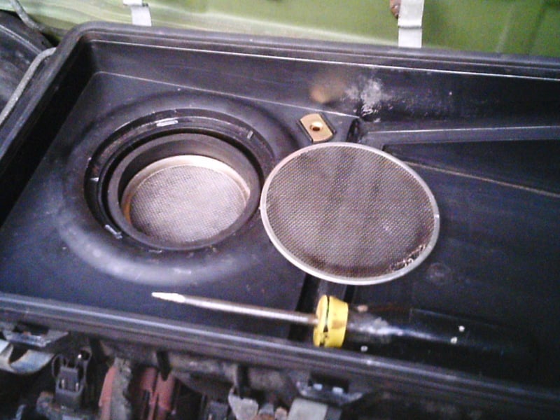

Well my breather filter came so i changed my airbox today to the larger Almera one. Went reasonably well to be fair, although i have had a poke around a few times before. Took off the Micra and got some carb cleaner in the throttle body, then went to put the Almera one on but forgot the carbon cannister gets in the way. So i took that out it's holder and placed it lower down, it seems reasonably secure but will probably cable tie it to something eventually. Also wedged the breather filter on as much as i could as that was getting in the way a bit.
Got the box on then had to chop a bit off the CAI so it would fit, also closed up the rest of the holes with masking tape as i put it back together because i couldnt find my other tape. So got this on and went for a test drive, certainly a different noise, slightly louder but not a lot, it's a deeper noise though. It does actually seem to have made a bit of a performance increase, not sure if this is half to do with the carb cleaner though. When i got back i took the resonator (think thats what its called) out the lid as i heard that makes it a bit more noisy. Put it back together then realised id left a bloody screwdriver on the scuttle panel when i went for a test drive!! How it didn't fall off is beyond me but thats just an example of how clumsy i am. Anyway it made no difference to the noise as far as im aware but it did however seem to make it pull a little better, unless that was just a placebo but im not usually one to fall for those.
Then i decided to take the mesh out of the Almera airbox, seeing as i already have mesh on my throttle body there wasn't really any need for it. It seemed to make a very slight difference, it felt a lot 'free-er', more easy flowing so to speak. Took a video with my little keychain cam, but i held it in my mouth so theres some gross noises haha, and also you can see the speedo and the road so not sure if i should upload it as i may have crept over the limit a little.
Also got a vid of the difference in noise and will compile them and upload it when i can be bothered, but there's pretty much no difference when filmed from near the engine so its not top priority.

dude, you can turn the canister through 90 degrees and re bolt it to the bulkead on the lower bolt hole only, check out my blog for pics :D
Spacers as long as they are secure and centric can be as wide as you want in all fairness. porsche regularly run ones over 30mm from the factory
It didn't seem to want to turn much when i tried, got a pipe in the bottom aswell as ones in the top keeping it sort of upright.

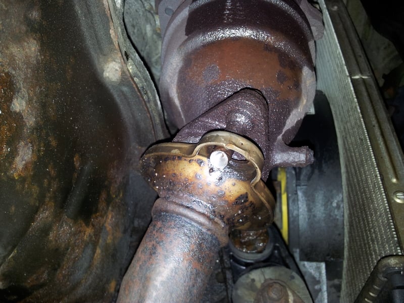

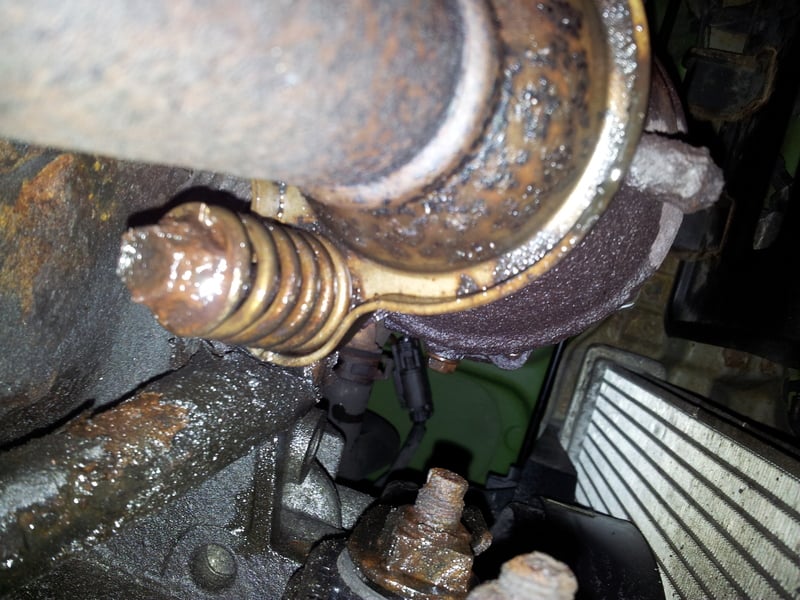

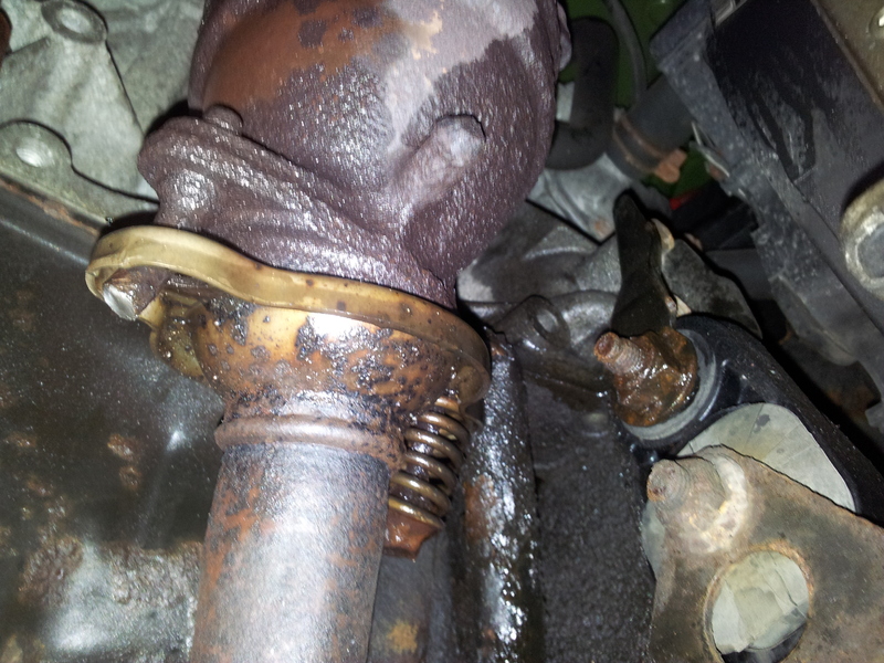

I ****ing hate my car now. After pissing about all yesterday and managing to get half the exhaust off i set about getting the downpipe and 2nd cat off today. All i've achieved is to shear one of the spring bolts off, round the other one off and bend it a bit, crack a 13mm socket, snap a hammer, and become depressed and angry. It's probably going to need towing to a garage as the other bolt is going to need snapping off and then the rest of them drilling out the cat. The other bolt is so damn hard to get to though.
Here's some pics of where im at.

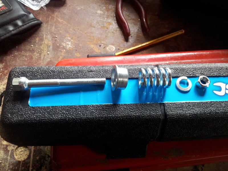

Here's the new spring bolts i picked up but they're different to the Micra ones. Shall i bother with them or what? And how do i set them up?
THIS is why im not modifying coilovers or anything, ill just **** it all up like i do with most things.
Cheers.
ya, jap cars and rusty bolts are pretty well in bed with each other. i was lucky, mine were not seized in the first cat, the ones on the system were poope so i took a grinder to them. looks like you will need to take off the manifold now fella, get the flange glowing with some flames then try and get them out so atleast the threads will be saved, makes it easier to get new spring bolts in. but if that fails grind them flush either side of the flange and drill them out, you can use the new ones you have then, split washer and nut on the topside.

And don't blame the car, or your gear. A bad workman blames his tools! Just imagine how many mechanics come across problems like this every day, but HAVE to overcome it in order to make a living. There's always a way. Don't give in and tow it to a garage, finish the job! You can do it.
an angle grinder on the top of those bolts will see them fall out, clean up the holes with a drill and stuff your new bolts in.... jobs a guden, just take your time.
the ones that have rounded/snapped and bent are threaded into the flange matey, there is no bolt on the standard ones as there is on his new ones :D
