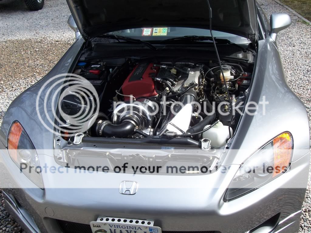

Oh yeah... Beat the **** out of a Honda s2000. He told me he just can't use the power on he roads... When he flashed me to pull over. So yeah a micra beat you... Is it me, or saying you just can't put the power down in a modern and better handling car... Or does it mean I can just drive my car better?
