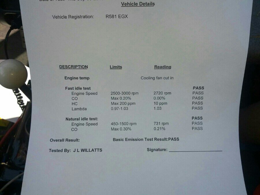

Oh also checked the lamda which was out in. still clean so oil and what not must be happy with us.

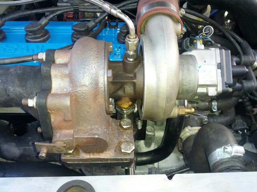

Guys can I time this like a na and then just leave the piping off to the tb .. There wouldn't be any boost and I can have some fun... Would the turbo spin to freely?
like so... Have I done something wrong? I left the filter on the turbo to stop crud. The mesh is still on the tb. Is this okay. My brain thought that the removal of the bubbins allows no boost. Leaving the filter on the turbo helps slow it down.
But boost still uccured when pushing it. So I thought remove it all. Is that not good for the turbo? Sorry just panicking this end.
thats fine chris :) you will lose a bit of throttle response because the t/b has to inhale through the (non spinning) compressor wheel, and you will lose a bit of top-end because of the exh mani backpressure
Chris dont panic you're fine. It'll try produce a little boost as the wastegate wont allow all exhaust gas out the same rate as normal
Has the turbo just been spinning its bollocks off then? Would it damage it? I thought it wouldn't be massively bad for it. The turbo Defo has more play now. Maybe a mm or two one side to the other.
Maybe because there is less oil jamming it up? Could it be when the engine is pushing more oil through it, it might tighten up?
the tubby will slacken/free up a bit now its running (the old oil tends to dry out and turn to lacquer when left unused)
Hmm okay. So do you reckon k should connect up all the piping but leave the wastegate disconnected like it already is
Do you reckon that play is anything to worry about when i get it boosting?
