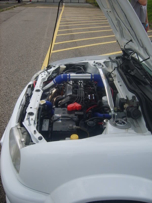

Just to continue with the sc fiddle i was on about...after fitting new vac lines (they are used to equalise the sc's case pressure) i can say its makes no difference to sc sound (which i suspected it wouldnt) ...but ive gained about another 1 or 2 psi on the boost gauge. So i think its probably running about 7psi max now. So far the cars very happy :D
I deffo think its the air filter thats stealing my whine though lol...

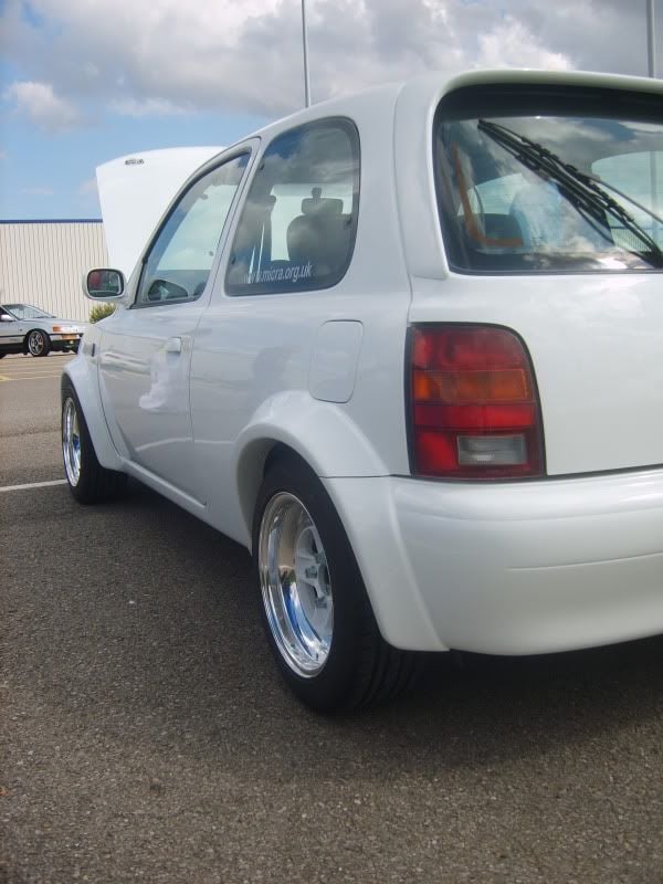

Pic below (taken by a JNE member) is probs the best one to try and give you an idea of the rear spacing...tbh it could probs go at least another 5mm

well after looking at the arches more, i think im gonna cut them up...again :D
I can then get the front down possibly another inch, though that will need testing as the roads here arent always low car friendly...for the rears im only gonna know for deffo after i stick some weight in the car...but if needs be they'll get cut along with any metal that gets in the way (as 2 1/2 fingers width is a little too much for my liking) ;)
