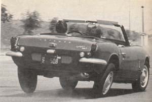

Usually attaching a scary picture like this (which caused me to go Argh! what the $%(! you're right I don't want that....
Jacking was explained as due to a high roll centre not a particular suspension design or due to the positive camber in the picture (it'd be negative if the suspension was going the right way!).
I eventually (I think) got an idea what jacking was and what causes it.
In the above picture say (for arguments sake) we got the centre of mass and roll centre in exactly the same spot so the car didn't roll at all, or all cornering force was being directed sideways through the roll centre with no rotational component.
If you follow the dotted line in the above picture from the roll centre to the tyre contact patch there is a slope downwards this means there is a sideways component (the majority) and a vertical component(minor) which isn't causing the suspension to compress but weirdly to extend.
So rather than compress the suspension on the outside wheel it's extending, if the centre of mass was above the roll centre body roll would be combating/balancing this extension and we might corner flat.
Looking at say this picture (picked at random
Overall the car seems to have some roll but viewed in isolation the rear doesn't seem to have any roll (what would it look like if both wheels were on the ground?).
The wheel on the inside is either compressed or neutral, when we'd expect it to be extended, but it is connected to the outside wheel via the beam axle IF the outside wheel were being extended and twisted by jacking this force could hold the inside wheel up via the beam (think of it as a pivot around the roll centre which is approximately the beam axle centre). The rear of the car is also higher than the front, which may be because of braking dive but could also be caused by the same jacking force, lifting the rear as in the first photo above.
