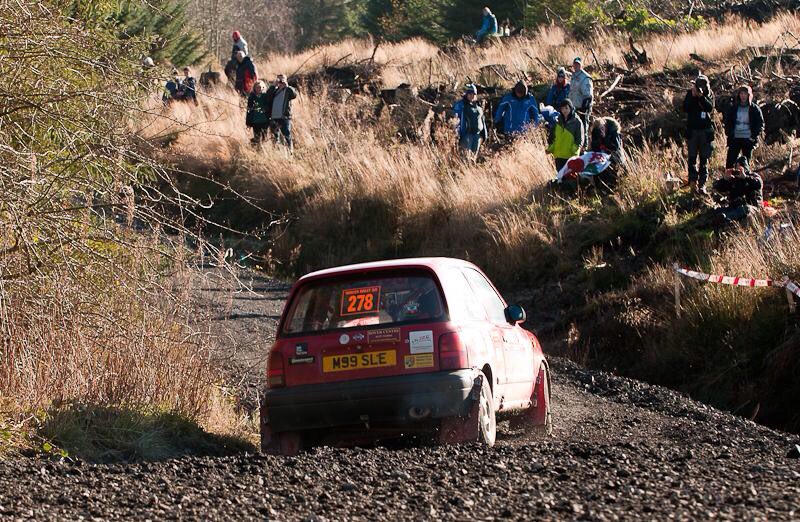

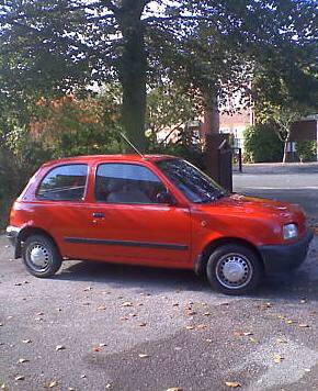

Too much history invested in our Micra now to move away, standard road car to WRGB!
CU-L2g2WIAAIwKJ.jpg:large
CU-L2g0W4AAKRI2.jpg:large
