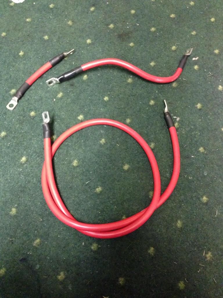

Few more hours tonight, battery is in, few decals on the cage to stop glare and an scratching. Fire extinguisher pulls re routed to hand and electric cut off.

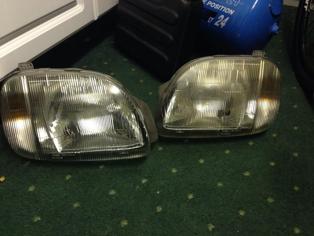

Made a start on the Jap plastic headlights that were quite glazed. 20mins and a tube of toothpaste later seems to be coming up a treat. One down one to go

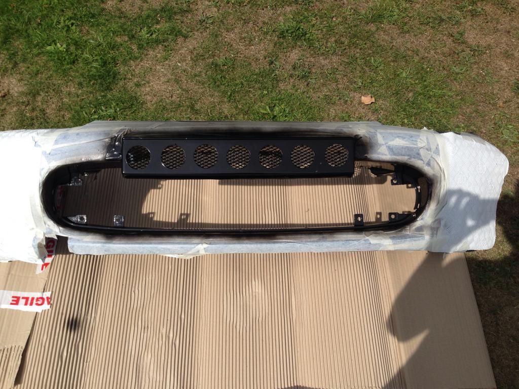

Bumper paint touched up for new mesh (destroyed on the last hillclimb and parted company with the car on the third day!)
Battery is on and hooked up to the cut off switch, plenty of power to start the car first turn of the key and only 7kg :)

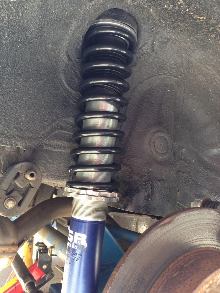

Rear coilovers on from BSR Racing. Impressed with the fit and finish, replaced the old exhaust rubbers you can see in the pic, sits a lot more level. Went for a quick test run, suspension was fine however the front left caliper had stuck on, the disc was smoking pulling into the drive so soon had the caliper off and piston freed (lack of use!)
Very nice. is the dust boot sitting a bit wonky on top of the treaded part though?
Mmm they look delicious and very easy to adjust ride height compared to the cumbersome original spring mount point. Are the lower mount end adjustable for adjusting the bumpstop position like on my bc v1?

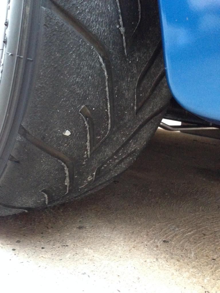

Had about 1hr 40mins on track thrashing about. Front wheels were scrubbing under load so stiffening the dampers and increased ride height sorted that. A048r tyres I have discovered take a while to get to temp on a light car like a micra. Stiffer front springs and a different tyre choice for the Manx classic next year.
