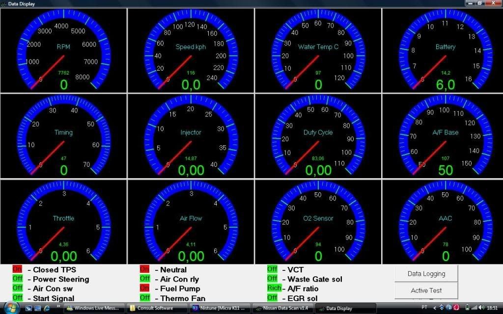

It almost stalls when you let go the accelerator, but now it got better, changed some ECU maps:

These are the max values while doing some tests:
Even with 1.6 injectors -> 83% injector duty cycle @ 7750rpm = not good :down:
