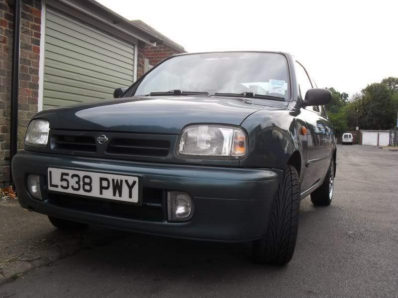

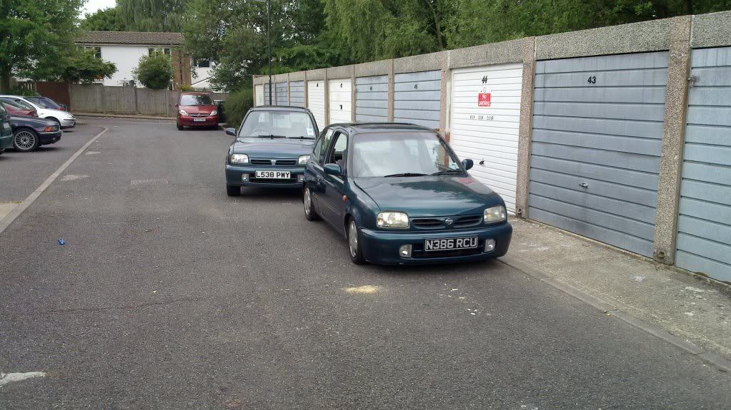

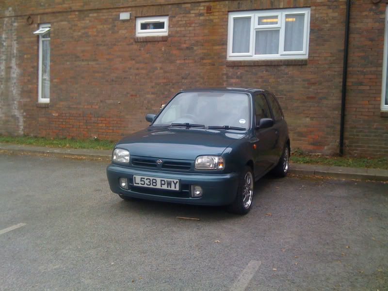

Here you go Shaun. My car with Shaun's super s
thanks
wow mate didnt know you were serious when you hinted this a while back
k10 super s
k11 super s
and it looks very straight!
thas what the other guysaidbout the culla on his:laugh:
other guy?! lol didn't even think i would be in this situation with a K11 in the first place. but that 40cc and fuel injection makes a hell of a difference! (Y)

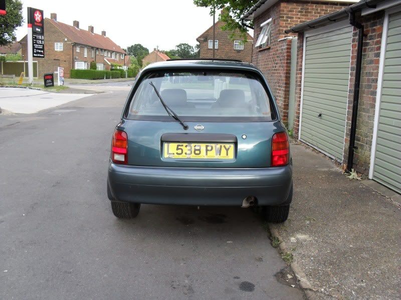

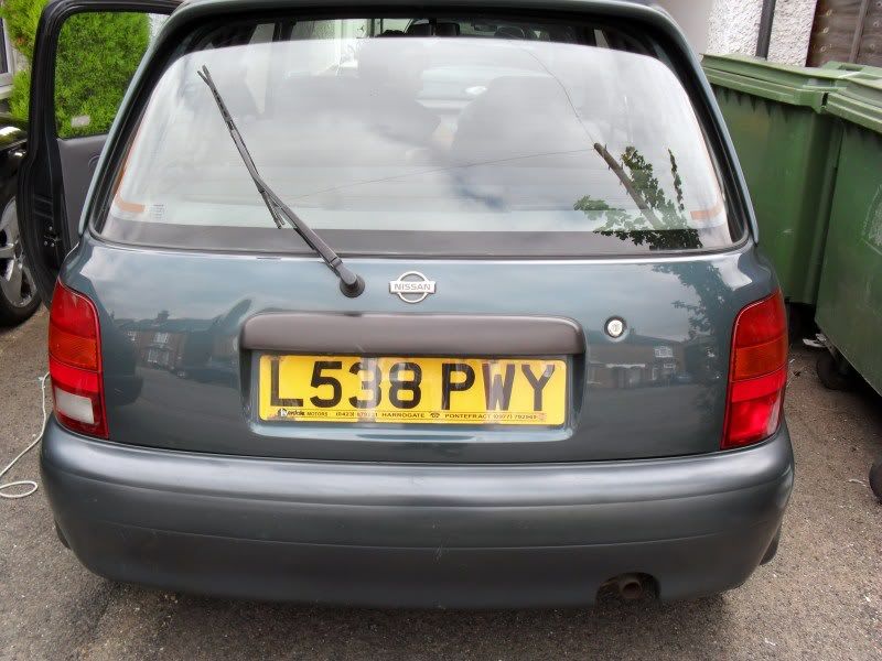

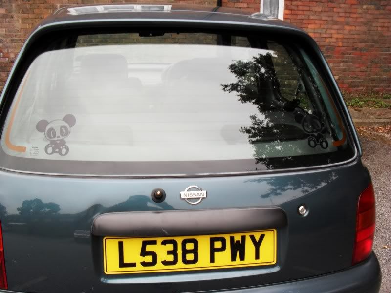

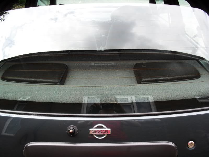

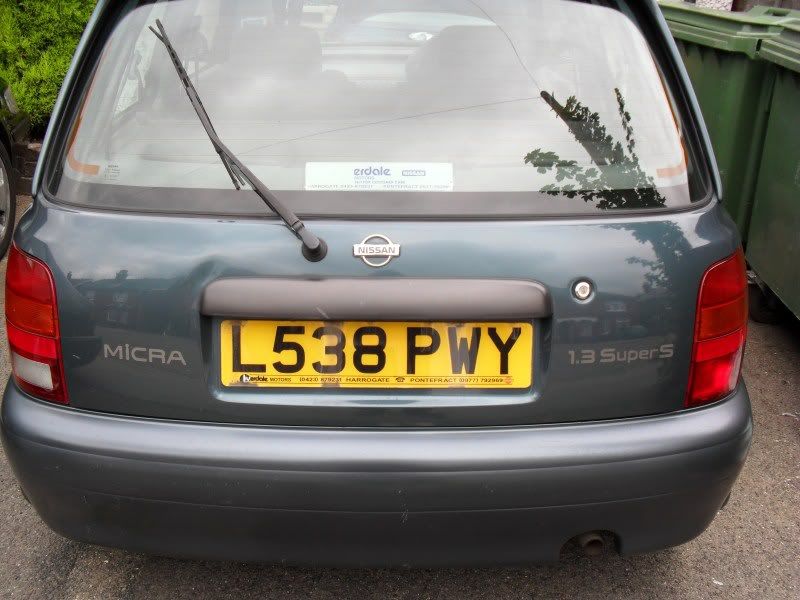

Update: (no.1 of many!)
Debadged of course :p
Before:
After:
And yes there is a dent :( one of many little ones!

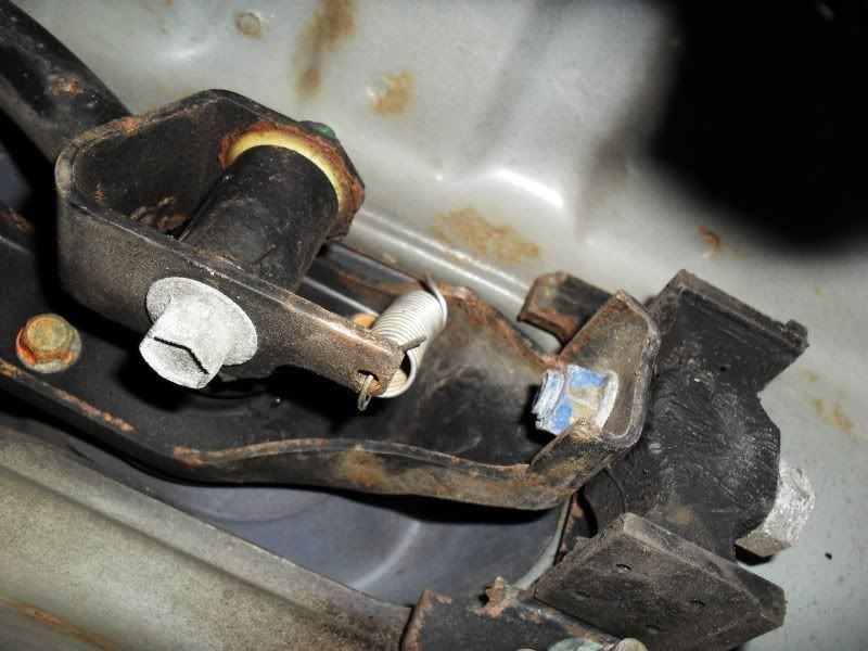

Update: First Mechanical Problem.
Gearstick/ Gear selector?
seems you have to manually pull it all over the place, when in neutral sitting still if you move your gear stick towards 1st and release should bounce back to middle?
same happens if you push it over towards 5th.
mine just sits there stuck, also seems to be some sounds when selecting gears sometimes like a spring or an obstruction?
Any ideas from people that have played around this area before?
Do NOT want a garage monkey touching it. :p
Shaun
That happened to my K11, stick flopped to one side. It's a spring underneath the car that holds the gear stick in the upright position.
Ah ok but see mine doesn't flop (lol)
it needs to be manually moved everywhere!
but will check this now thankyou! (Y)

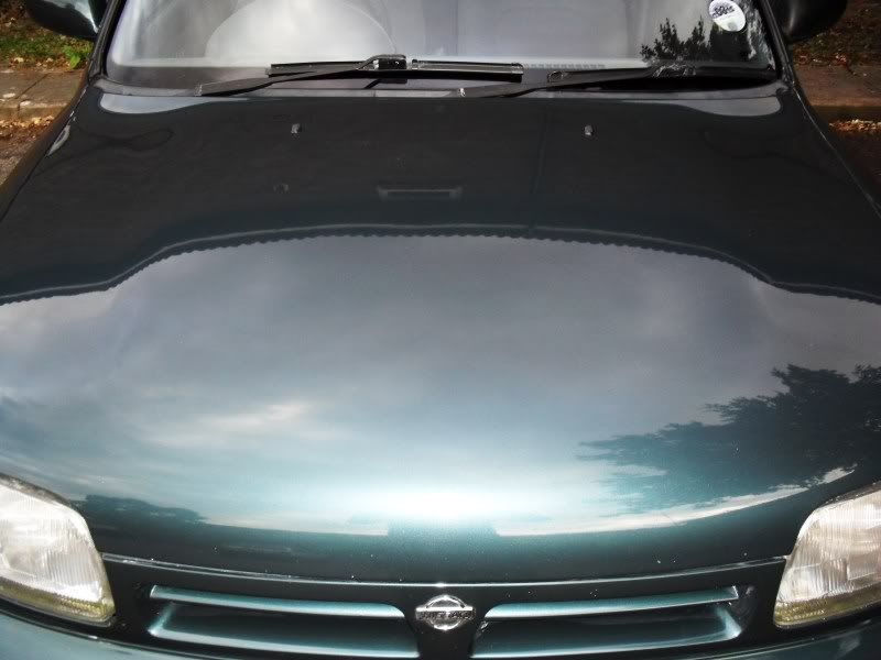

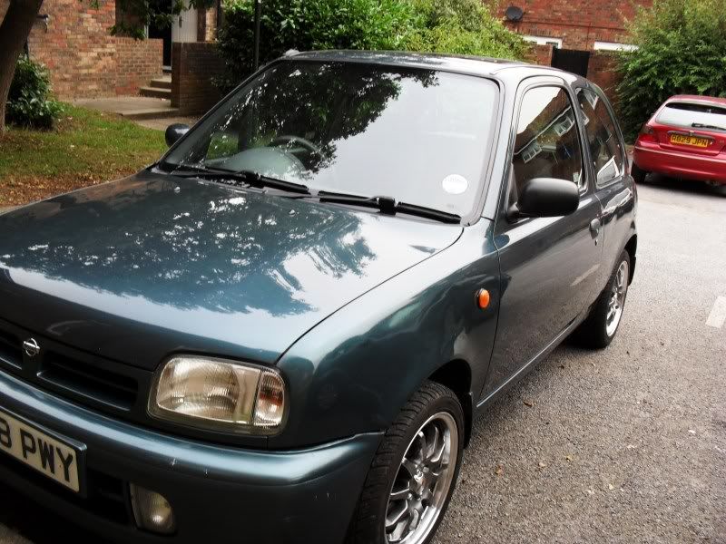

Update:
Overspray on the bonnet has been removed thanks to Mckenziecz (again) which means i can cross this off my list! :blush:
(little blurry sorry but shiny!)
Shiny side!
More soon...:grinning:

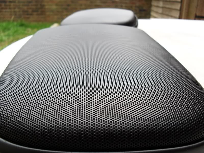

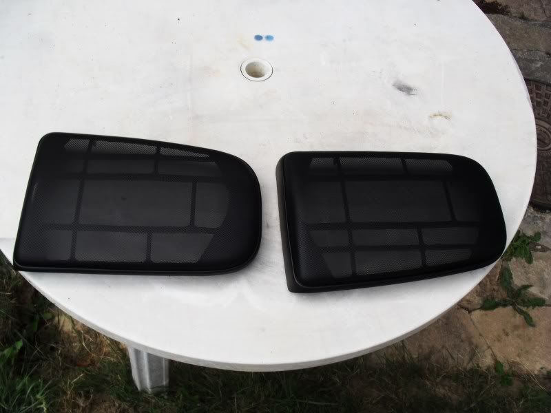

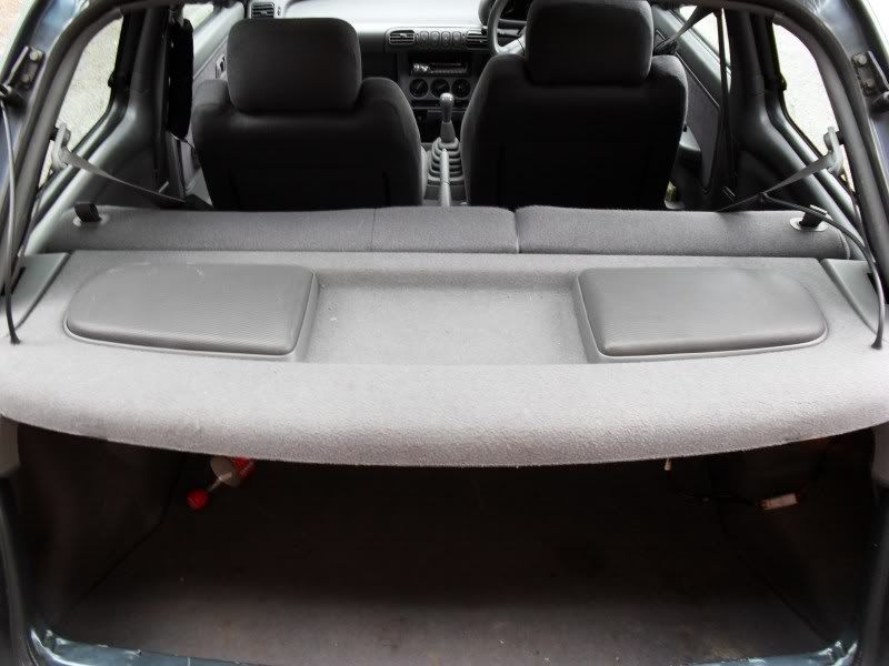

Update 1 of 2 today!
Painted Rear Speaker Grills
Before:

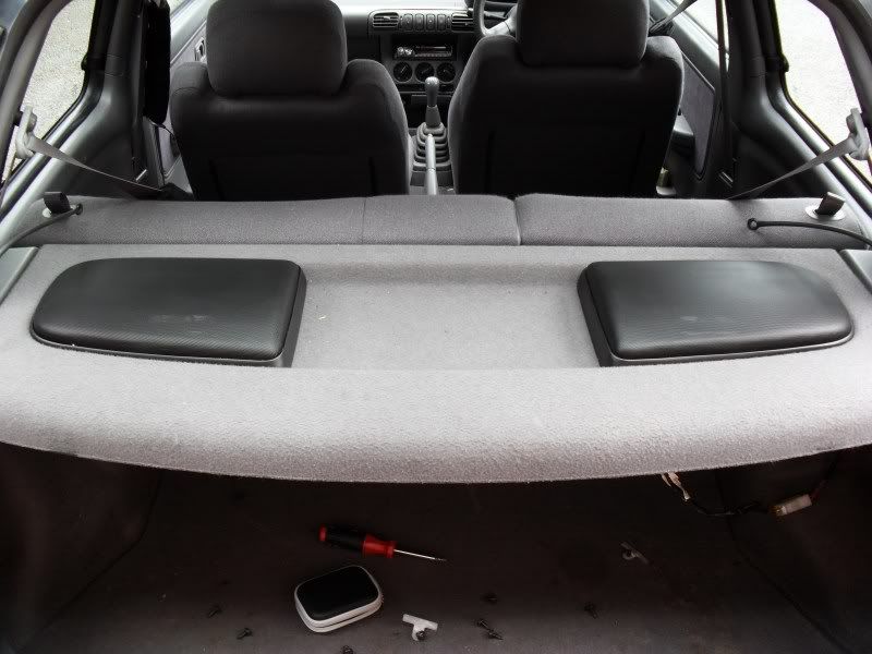

During:
After:
Boot Closed:
Thanks for looking will update again later with yet another improvement! :wasntme:

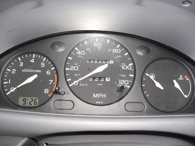

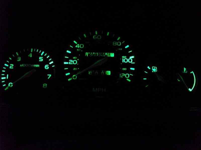

Sorted the car out with some new bulbs as one of them had blown and was annoying me at night!
Daytime:
Night time:
Thankyou for looking. :blush:

sounds most likey to be dried/seized gear selector linkages coupled with usual snapped return spring. take apart the selector link bushes for a good clean/regrease. rehook return spring if snapped. if there's any play in the bushes, i'd replace with a good condition linkage cos worn bushes cause difficulty in selecting 1st/2nd gear and gearstick rattle
Oh dear... i hear the rattle sometimes! :down:

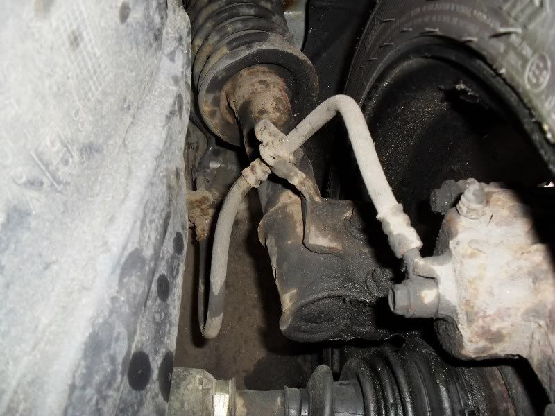

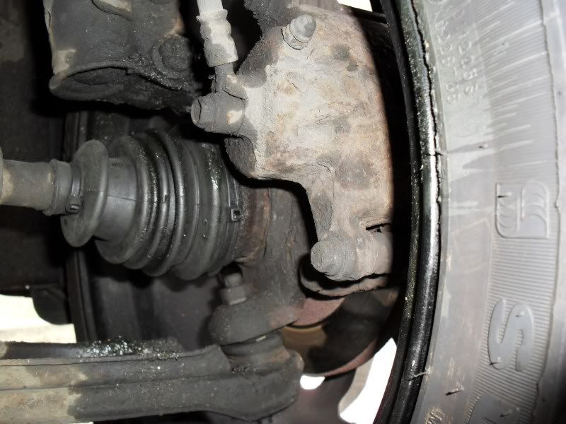

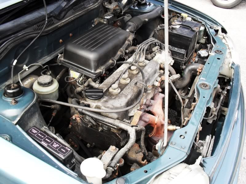

Right went out and took some photos, Led for immobiliser on inside center console doesn't even twitch probably because the alarm etc had been cut. CV boot Mckenziecz is gonna help with. :blush:
Overview:

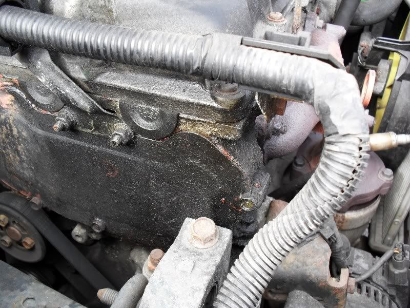

Leak from rocker cover? or inspection cover?

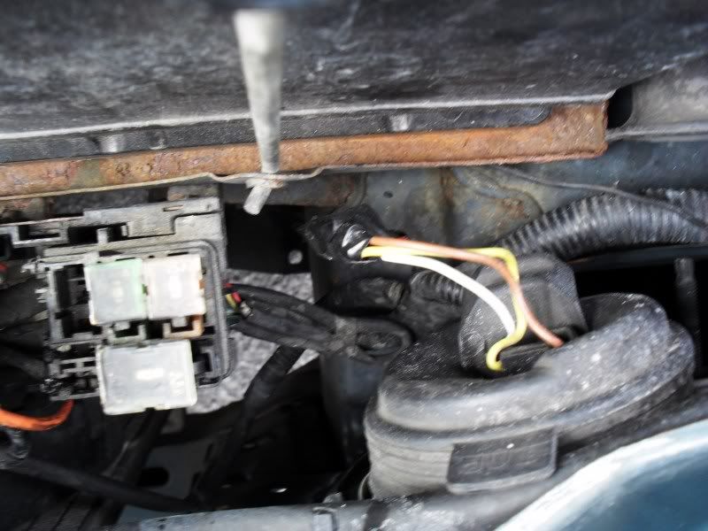

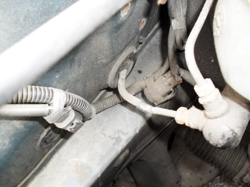

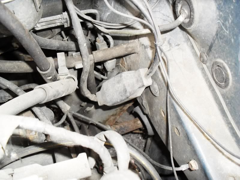

Two connections that go nowhere:

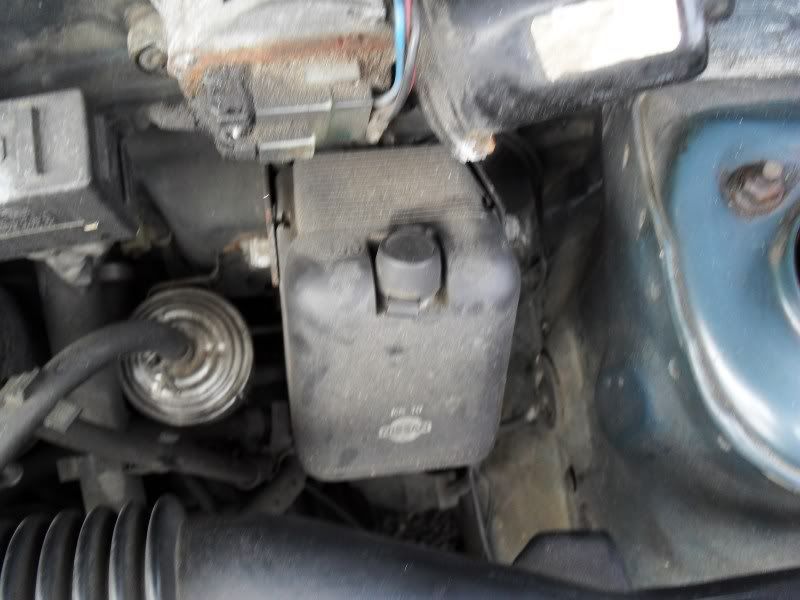

Alarm/immobiliser (not connected - someone had cut it!)
Power for alarm:
Shabby headlight fix:

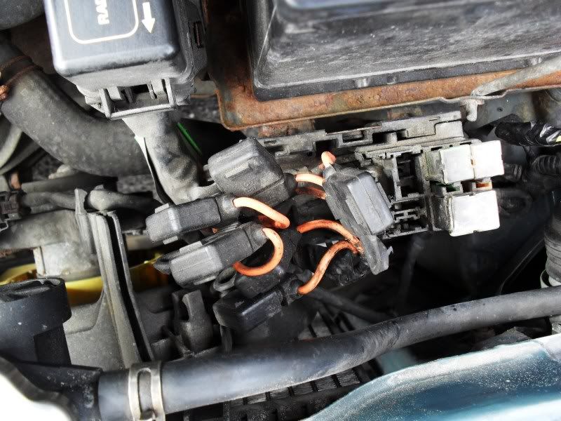

Fried and re-wired fuses (how could i tell which is which?)
CV boot gone:

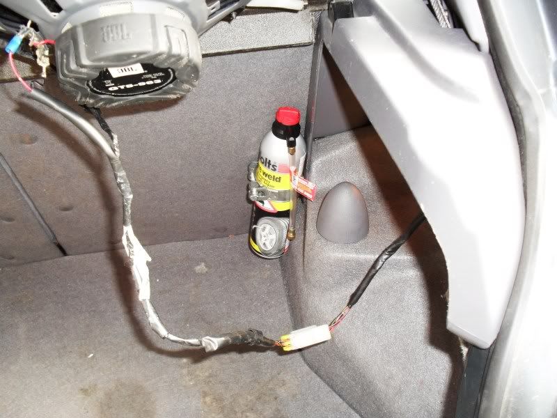

And finally a good bit:
Holts Tyre Weld/Spray Thing! Just in case a nail is unfriendly. Thanks for looking.
those fuses shaun are, top down
injectors
alternator
r/h headlamp
l/h headlamp
and that one connector is the power steering switch aint it
injectors
alternator
r/h headlamp
l/h headlamp
Ah thanks Frank, that would make sense as i don't have it :grinning: so i can leave that be. do you think it would be worth trying to rebuild that fuse block section? it just looks nasty.
someone,s done a proper job there shaun :cool:, i would leave it personally
Ok, do you have any thoughts on the non blinking Led in the car? does it's power come straight from the alarm unit in the bay?
Okay still need some help with the alarm and internal led does anyone think Nissan would be cheap enough for this? lol

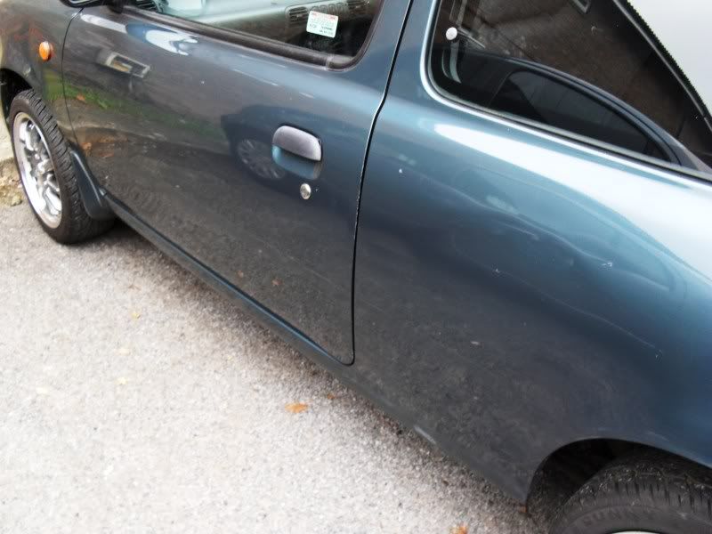

Also took bump strips off yesterday and found nothing works when removing the residue so looks shabby :(

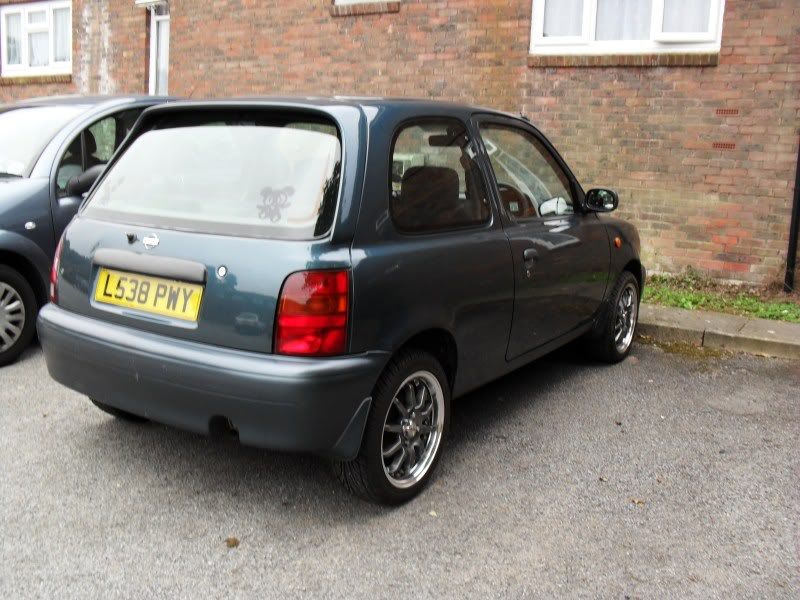

Here's a picture of it after a wash. Only the one as I'm on my iPhone as we don't have any Internet at the moment.
its a retrofit alarm aint it shaun ? if its been disconnected just bin it :p
What do you mean by retrofit? it is Nissan just not connected. would still like an alarm in the future so maybe your right and as it's doing nothing right now might as well bin it :laugh:

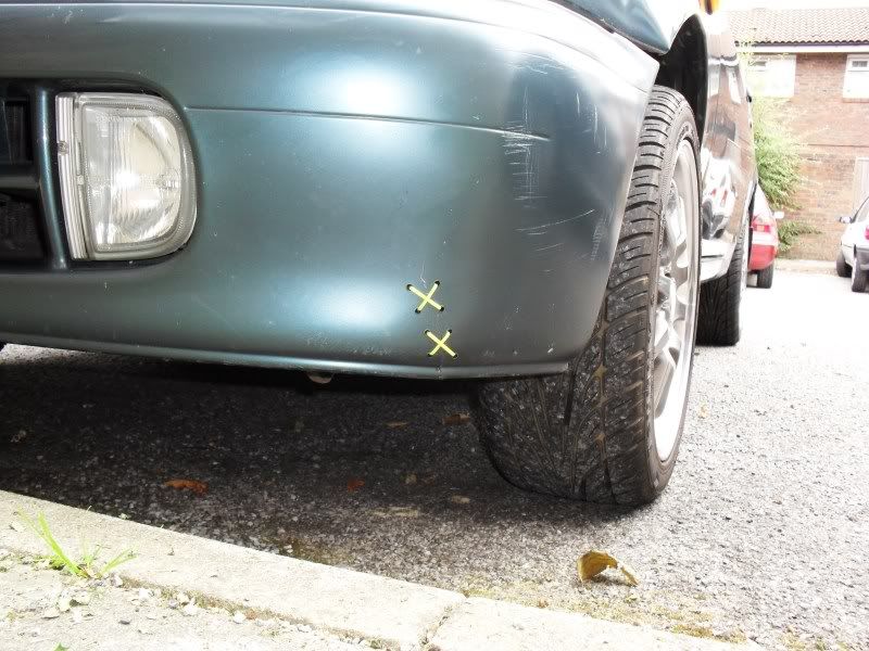

Secured a crack in the front bumper the previous owner(s) had left me:

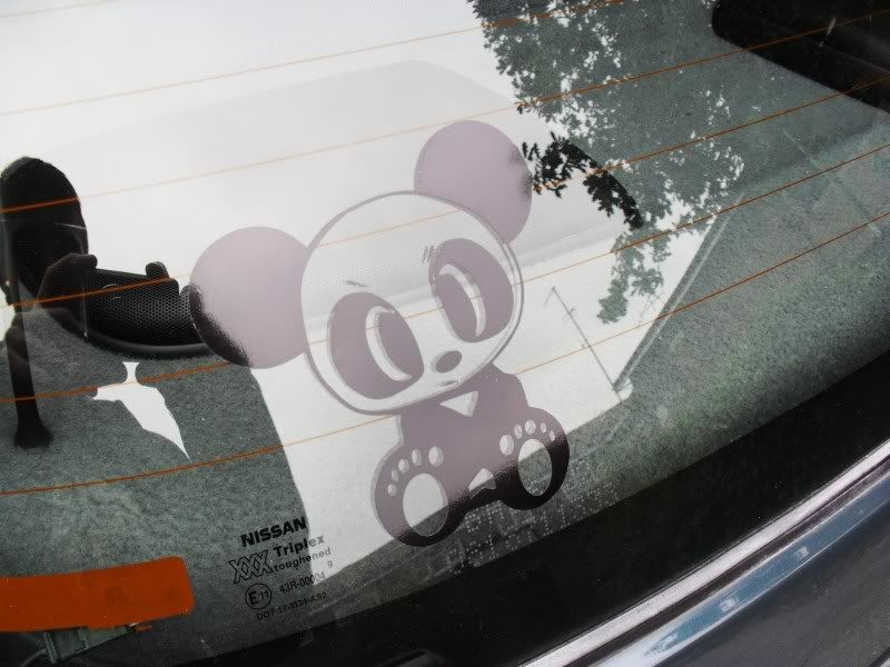

Got a couple of friends on the back of the car:
Removed side strips but am left with a misty clearcoat :(

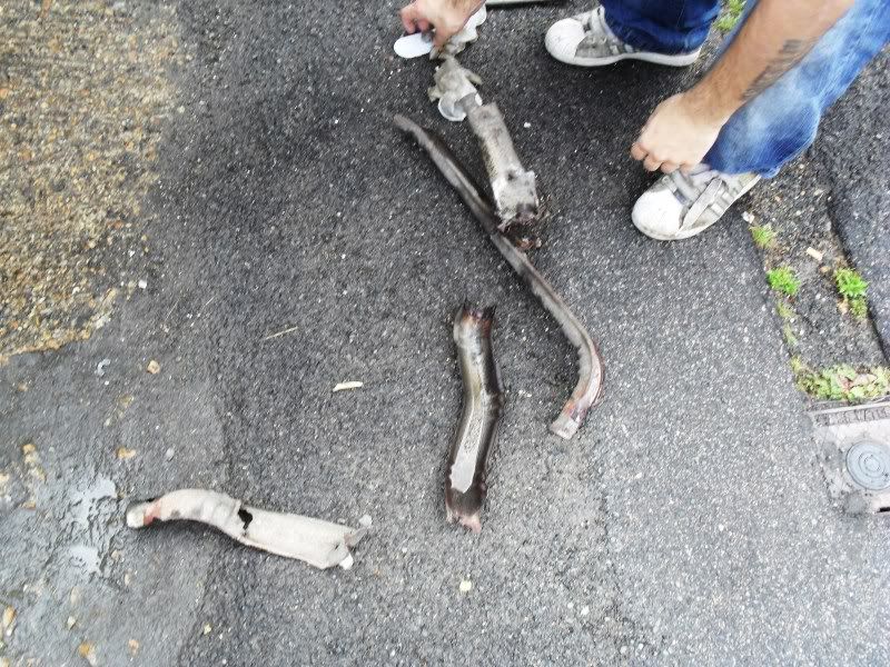

Removed all that bloody heatshielding! rusted as hell 2hrs for one spring!

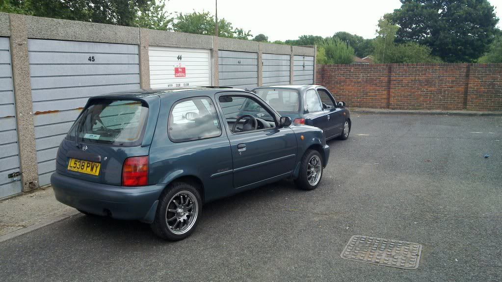

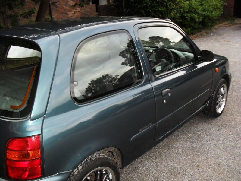

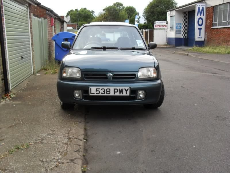

As he stands now:
Got loads planned, but being a little hush right now :p
