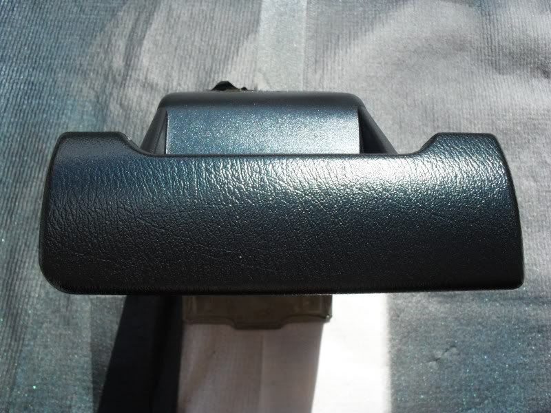

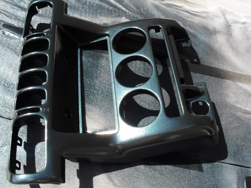

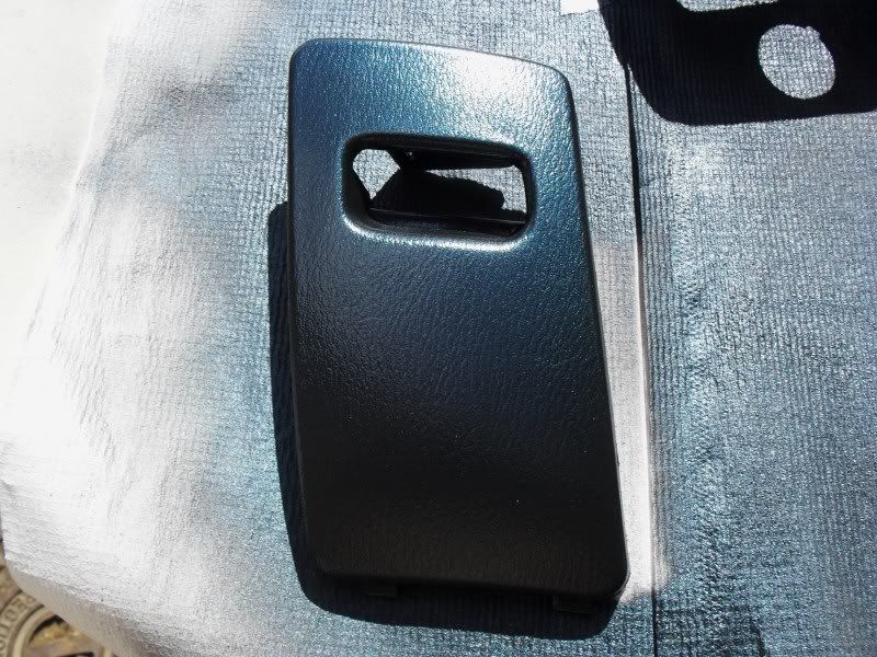

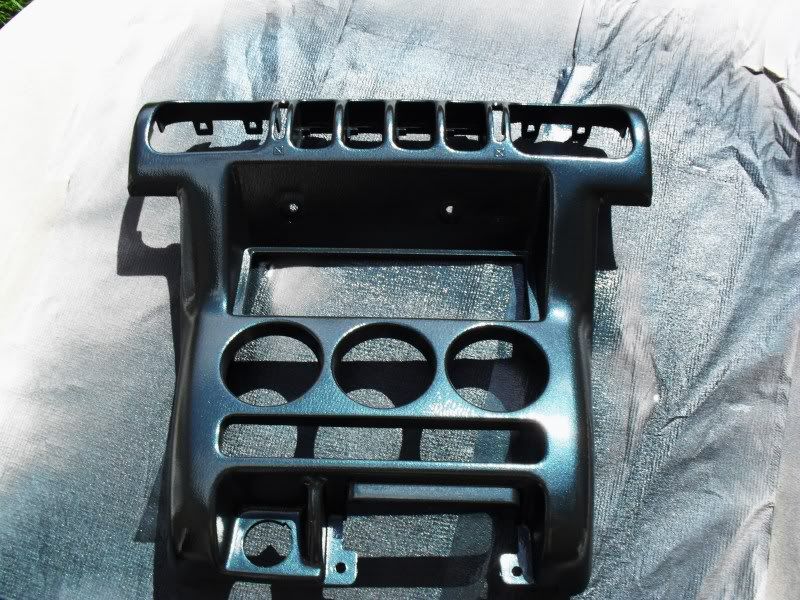

Started Painting Today:
Halfords Paint (with Crappy nozzle!)
Everything Else:
More when fitted

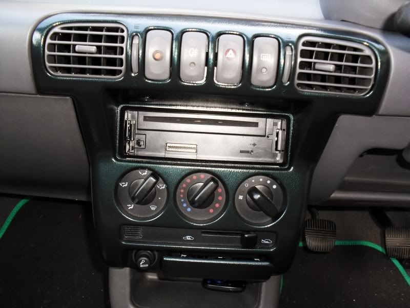

marks out of 10 for the paint please and how much was it?. dont go to crazy with colour coding the interior. keep it up
lol don't worry about the interior i have a plan! :wasntme:
paint is a good match its just darker as i never sanded before laquer because its too fiddly and would end up damaging the paint.
so:
Halfords - £13.99
Absolutely Terrible Nozzle to use on there.
7/10
much appreciated mate, did they find the colour for you or did you have to give them the colour code
I gave them the colour code off of the VIN plate, but they do have a library so they might be able to find it. best bet is the code though.
and No worries

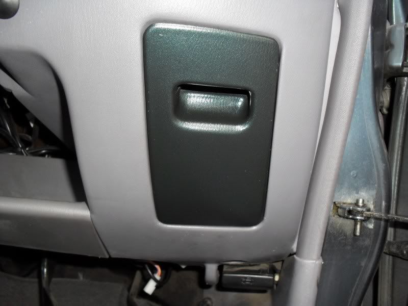

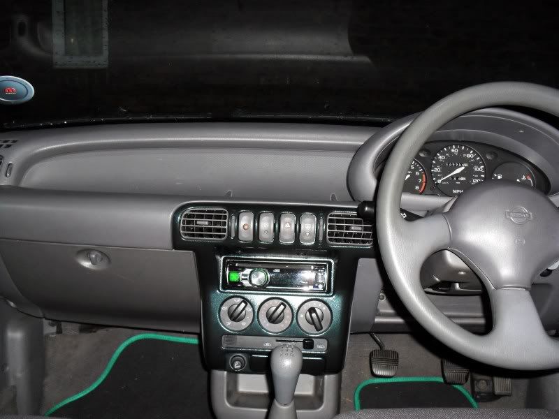

your colors got pearl in it.interior paint looking quality,did you prep with anything in perticuler to get the paint to stik?
:laugh:puling your leg man
I know and as i said i *cough cough* never graffitti'd lol
Cleaned it with soapy water & a scouring pad.
Dried it and left it to air dry properly... (hairdryer)
Primered.
Hairdryer it again.
Then 3 coats, 1 every 15 mins.
Hairdryer.
Laquered it 3 times, 1 every 15 mins.
Hairdryer.
an hour later (touch dry) back in the car.
Should of sanded between paint and laquer but the centre console is quite fiddly so just laquered after as i didn't wanna mess up the actual colour.
Especially at £13.99 a can!
Had to be careful though as you can tell it's still soft.
but just been out and its not fallen off so it's all good :p
Put the aerosol in a pot of hot water for 5 mins before use,you'll find the paint flows much easier..or a hairdyer which is also useful to warm the area being painted..
I've used aerosols from our local automotive paint supplier for small jobs before & found them better to use than Halfords..probably cheaper too.I did the side of an Astra estate years ago which was passable but very thin & not cheap!
i left the can in the sun for a little... :p Shook it like a madman!
Definately need to source other paint suppliers though, Cannot stand the nozzle halfords put on their can!
thats what im thinking to much rub down and loose the dash texture which i realy like.and its made your paintjob look factory done

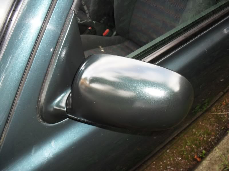

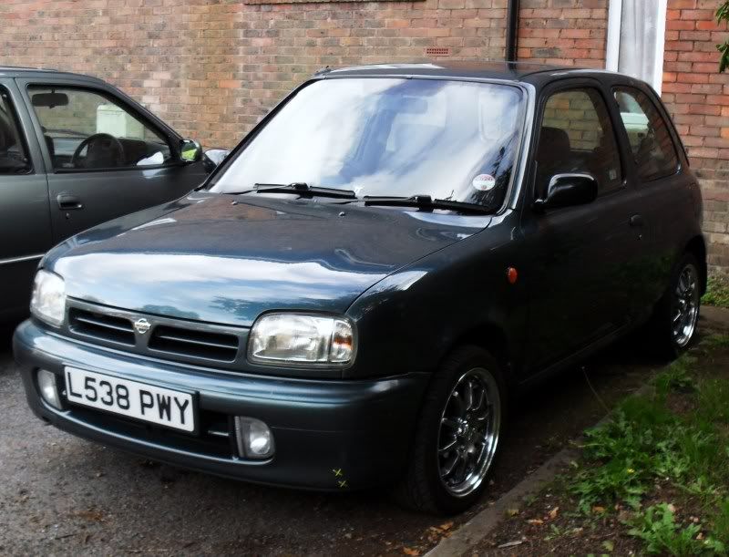

Colour coded my wing mirrors today, no picture unfortunately as i don't really have a camera right now.
colour is off a little too damn halfords, still looks better than one green one black :p
Mirrors:
How He Stands Now:
Off colour slightly but need to loads of painting in the future so will match properly later in life :wasntme:
