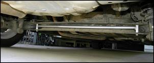

I tried to stick to your advices DaveNice stuff mate, I like the arbs, they should make some difference, is maybe get another clutch, a lot if work to put a worn one in?
For his new ARBs the front is almost 4 times stiffer though! (assuming same length which the pretty much are).If the are both replaced by thicker ones the over steer under steer will remain neutral, just a bit stiffer eh?
think my last post may have been a bit ambiguous, fixed itBloody hell!! I'm just doubling up on rear arb hto create some understeer, see how it handles :-0
Coilovers damping rate adjustable?I meant over steer sorry!!
Why the thicker front ARB Seb? Surely that will increase front weight transfer and therefore understeer??
. Front should always be less than the rear on fwd setups
Its all about roll resistances

Why do they make the fronts thicker? Again fairly simple. There's more weight to transfer on the front so a higher roll resistance is necessary to achieve the same effect as the rear. But the above still applies
Wow! Thats the site where I've found the rear ones, but the front 25 weren't listed for the Micra ! I didn't think about the 100NX ones ! Smart ! Thank your Chris!
