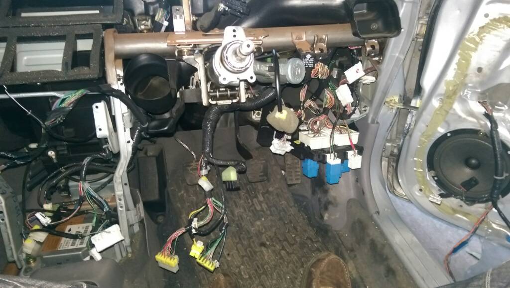

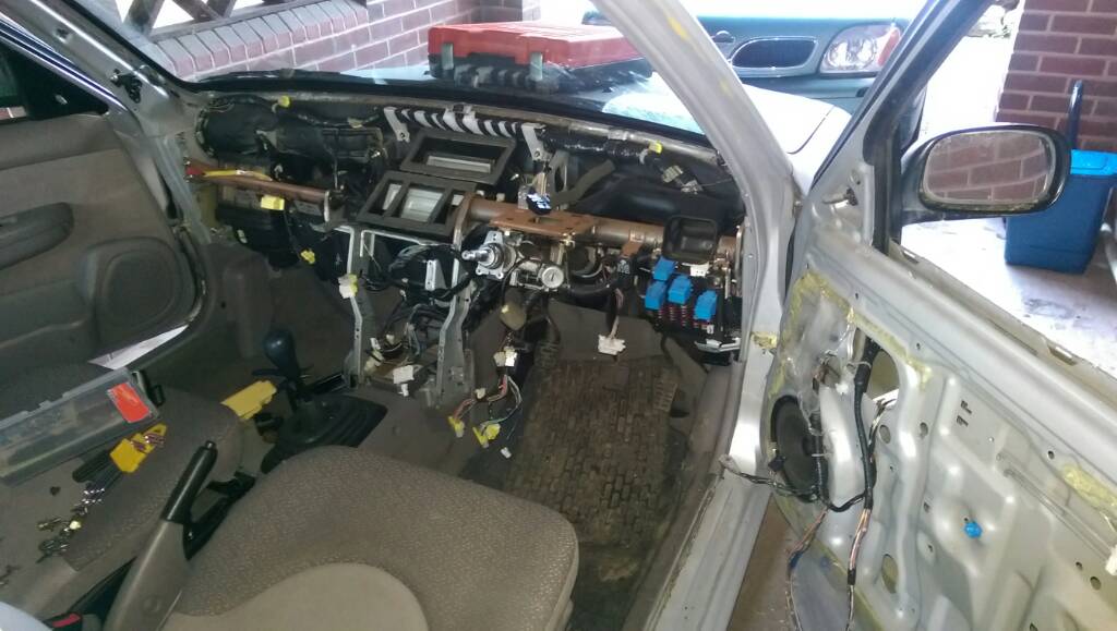

I thought "F*** it" and took apart everything I could in the donor car. Seems that the passenger airbag is part of the whole dash. I wish I knew that, I would have been more careful with scratching it.
One thing that would not come off was that little switch on the ignition barrel. It looks like that's responsible for making the interior light come on when the key is removed. Can it be removed?

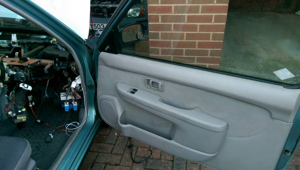

Also. I removed the locking mechanism for the door (the whole thing). Looks like I could transfer all of this stuff over without needing to change the keys. But then there is the NATS problem, and the remote locking problem. Can I take the metal part of the key out from the plastic part?
I took the relay and fuse box out too. Found the wires leading to the door. Got them all out. Now I'm hoping that Cassie has some plugs in the back of the box that these can go into. If that's the case then I'm guessing the window mechanism will swap right over. Though I haven't looked at the passenger door yet.
These are taking up quite some space...

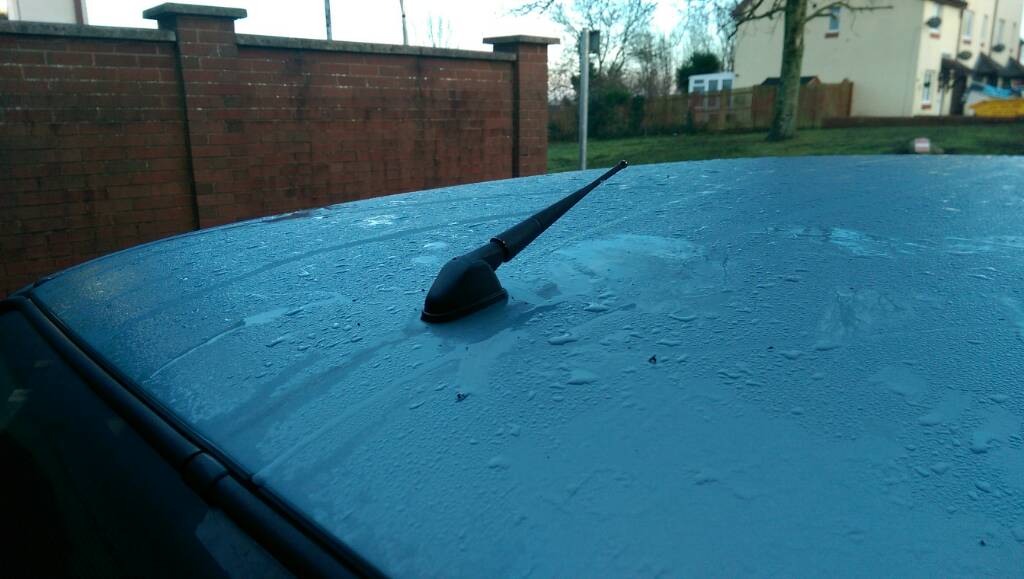

I shall try out the new aerial on the way to work. Cassie's original was one of those huge RC car looking ones that snapped off long ago.

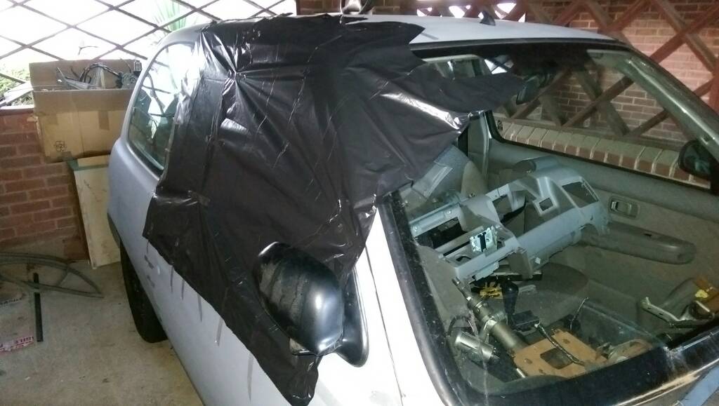

Just taping the door closed and covering the window as I'm going away for Christmas.

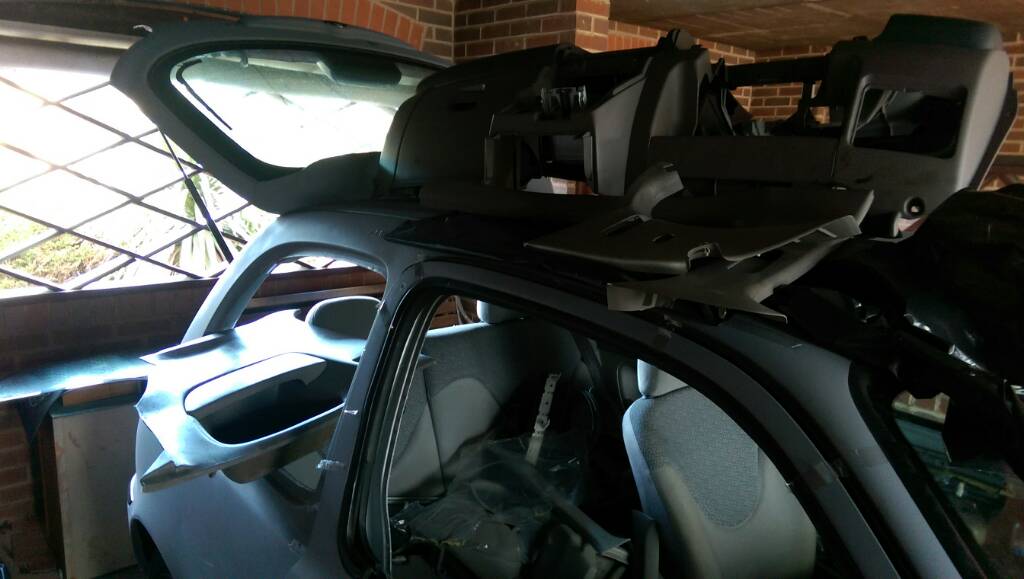

Today I've just been pulling out more and more from the donor car. Removed the rear pop-out windows in hopes to fit them to Cassie but she lacks some bolt holes...
I wanted to get the power windows in too today but there aren't any plugs to go into. So I started pulling out the wiring loom and well... it's a hell of a task.

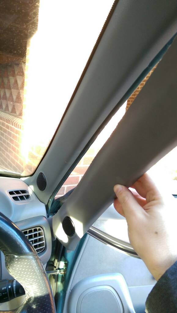

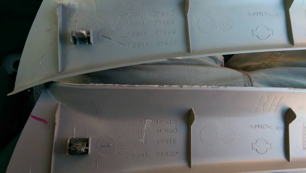

One thing I did do was swap over the A pillar trim, as the donor had the correct colour.
Interesting difference of marking on the back. Must be the colour code or something.

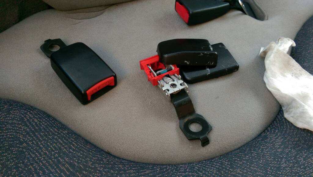

Swapped over the driver side seatbelt buckle, as my old one was heavily marked, and would occasionally fall apart, which was annoying. Now I need to get used to not squeezing it back together when I take my belt off.

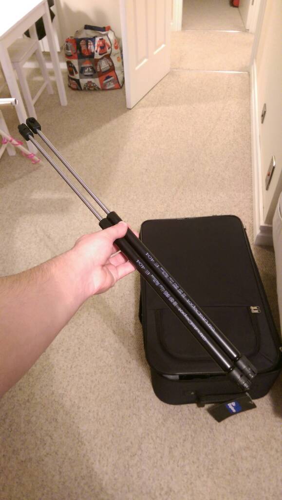

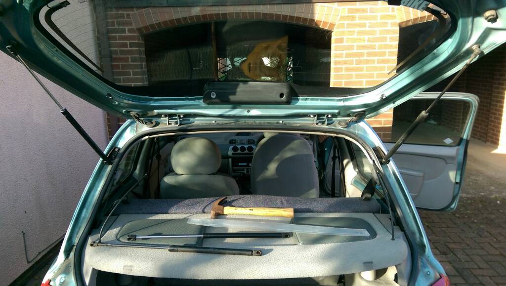

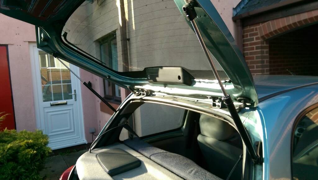

Thought I may as well fit the new boot struts since I've basically failed everything else. Here's with one new one on to show the difference. The old left one fell off one time and slammed the boot, damaging the old tail light. I really didn't want that to happen to my new ones.
Two new boot struts. I was surprised at how easily they went on, they pretty much just popped in.

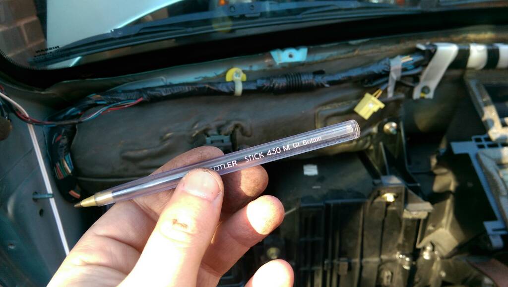

Apparently there was a pen between the dashboard and the windscreen this whole time.

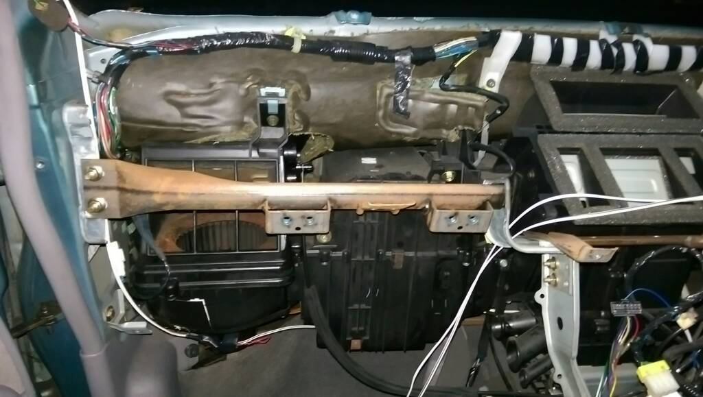

And I did it! I was so "in the zone" that I didn't really take any pictures. But it freaking works! POWER WINDOWS, WOO!
There is a circuit breaker of which the wire comes from the engine bay fusebox. This wire was nowhere to be found so I found it in the fuse box, and made a new wire (that white one) that goes into the right wing. It comes through the rubber seal for the door wires and into the circuit breaker module. This was a bit of a worrying task. The blue wire actually goes only to the white one now as I couldn't get it to go back together. Hopefully (and I've checked the wiring diagrams) this doesn't feed something else. Another worry was that the wire is really thick. Luckily the white wire comes as a double stuck together (really handy actually), so I just used both as one larger one.
Getting dark now, this bracket supports the passenger airbag, which I will take. Curiously there were already two nuts on the right.
Also take a look at my interior fan: Looks like crap. That's probably why it squeaks.

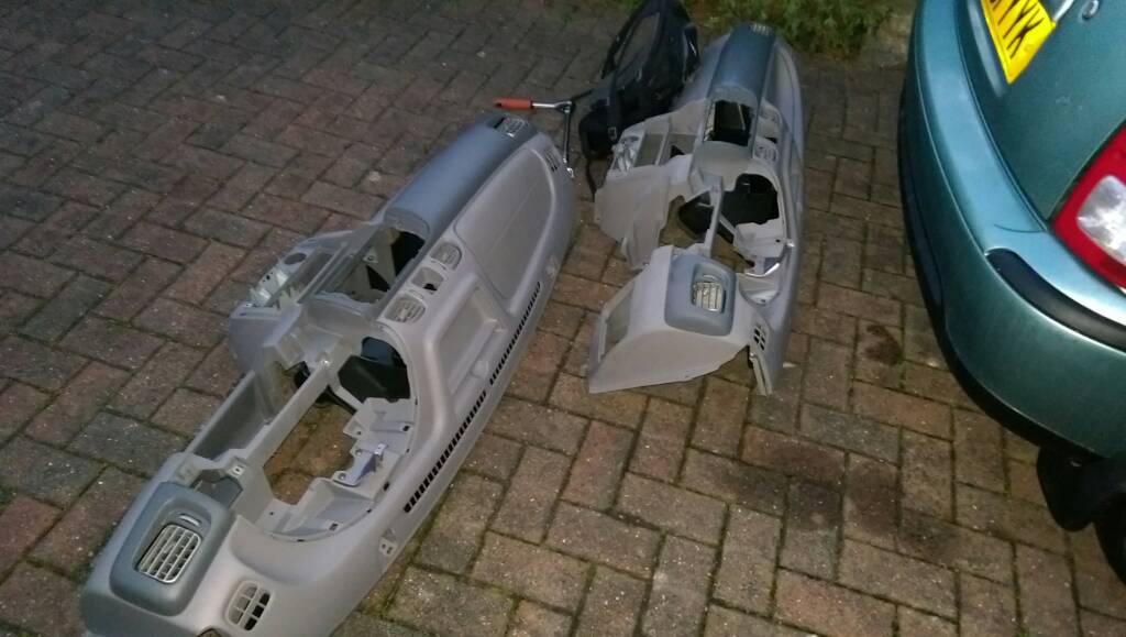

The two dashboards... My original one is much cleaner than the new one but that can be fixed. The new one is a little less scratchy too which is nice. And of course it has the passenger airbag. Luckily the wiring for that is already in place, so I don't think I need to swap over the airbag modules.

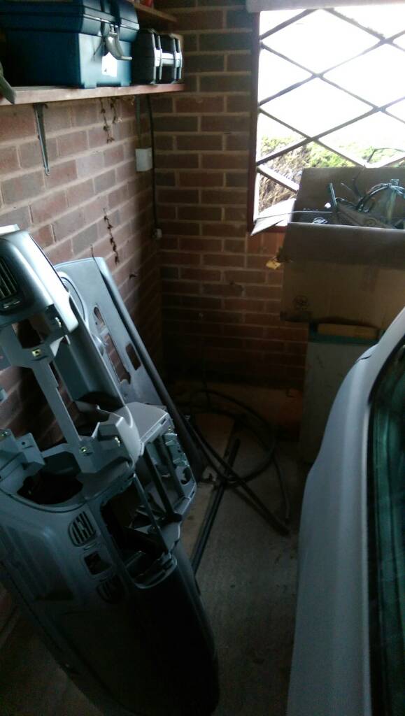

It got too dark so I gave up with fitting the new dashboard. Seems like it's much harder to get one in than out.

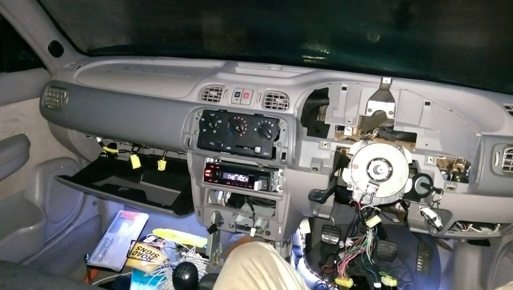

Thought since there is finally light, and no rain or cold, I'd get that clock spring on! Especially as I've had the airbag warning light flashing and my steering wheel not-quite-straight since I last fiddled. Interesting thing: The airbag wires (Micra side only) are silver inside. Huh. Also they didn't match the wiring diagram I use...
Tada! Finally in place. The correct airbag socket, and the infamous radio controls plug that doesn't exist online. Done. Steering wheel should hopefully be straight now too. Will begin looking into the radio controls, already contacted Sony asking about the resistance values and stuff.
I had an issue resetting the SRS though. Put the warning light into diagnostic mode and it gave me code 17, that's 1 long and 7 short flashes.
Seems the issue lies in the passenger module. Looks like I'll have to put the unit in from the donor car and see what happens. For now it's disconnected so I don't get a warning.
