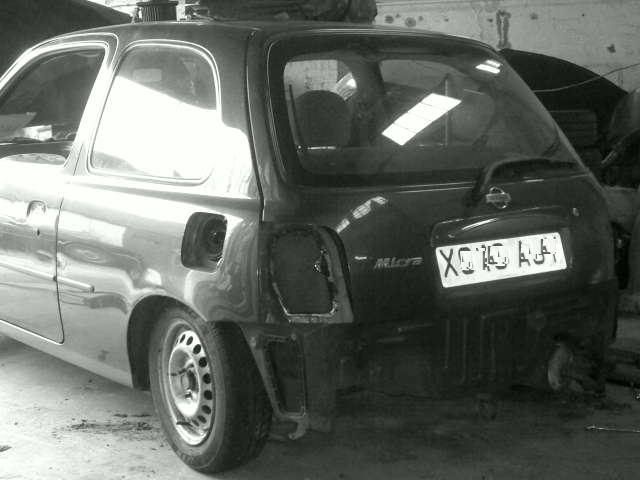

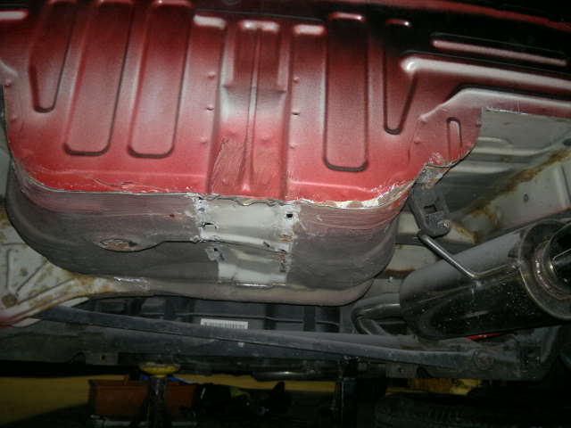

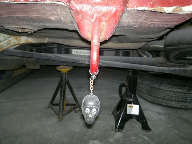

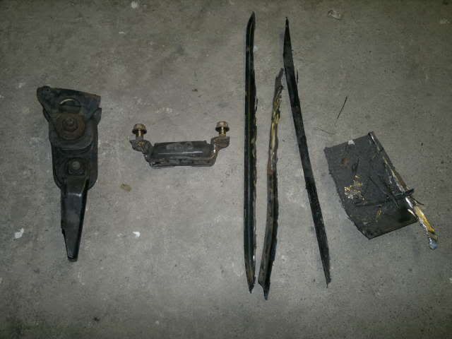

Spied a few more lumps that can go while I was there,rear seat belt fixings,tow eye & bit that fixes it to body,various excess fixings and had a nose at the fuel filler fixtures & fittings to the body that may eventually go..

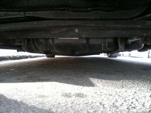

Before...
& After :)

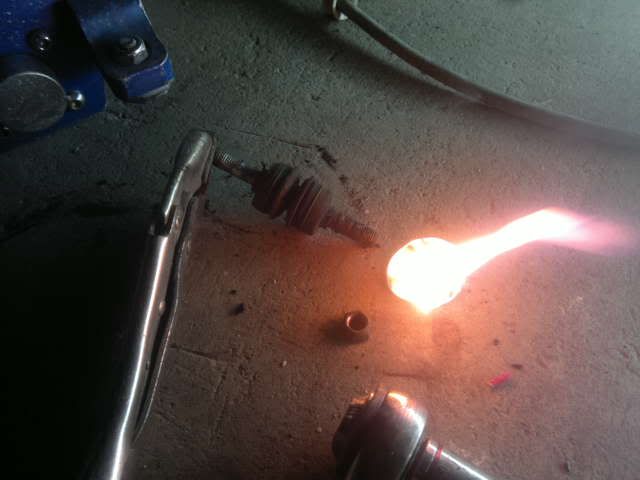

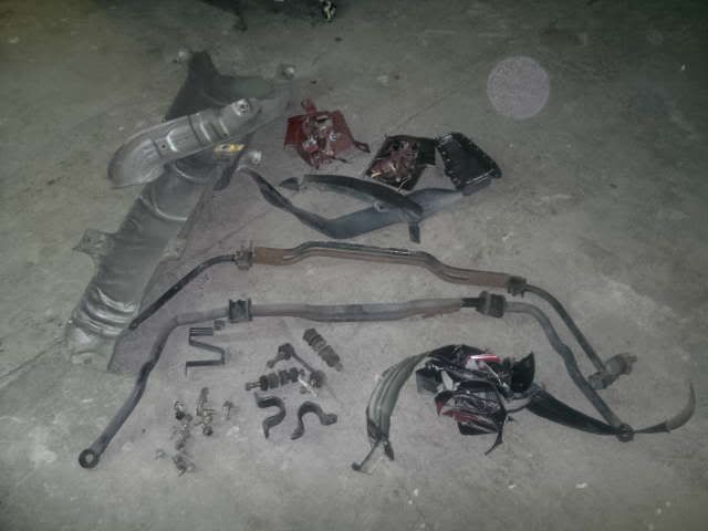

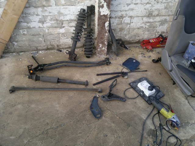

Removed some more unwanted baggage today..Sway bars are gone.One link arm was threaded/rusted on real tight.Draper grips 0.Mole grips & fire.1.Heavy affair they are too..
While the car was in the air I noticed that the heat shields were all still there..now they're not.

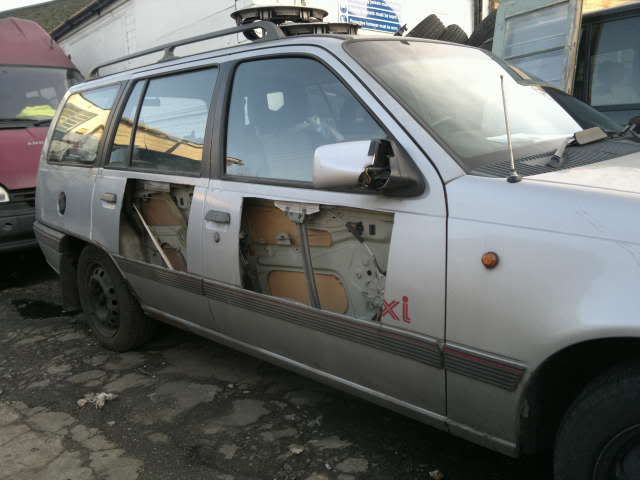

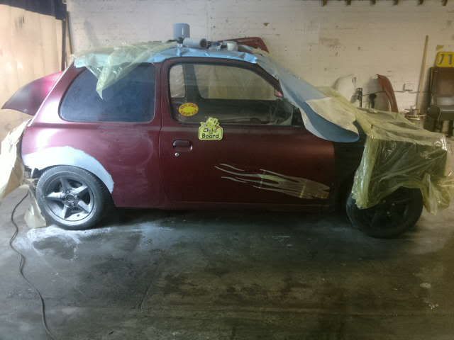

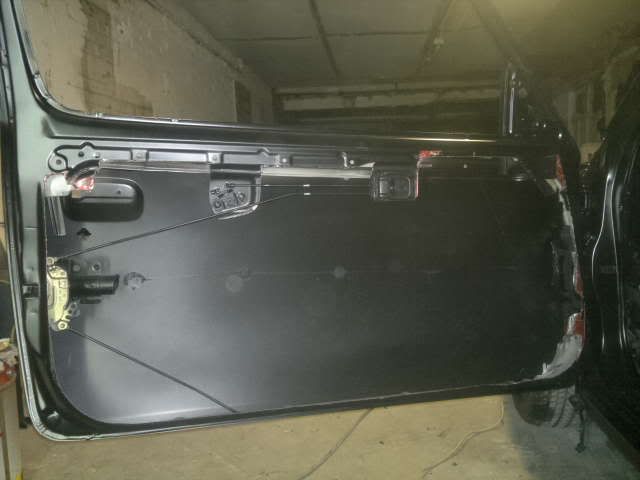

Also had another go at the passenger door with the snips & got a fair amount more off.Needed to use the grinder to remove a bit more structure & the remains of the crash bar,but the Wicked witch from the west was in next door (probably filling her fat face with chocolate eggs) so I resisted the temptation.Try tomorrow.Not going to be able to get much more of,it's feeling very flimsy now.Added benefit it's only now held on with 4 bolts & no stay bar :)

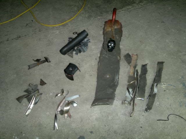

Productive day,with what I removed yesterday from behind rear bumper & todays trophys there must be 3lb of bits & bobs gone plus the heavy roll bars..
Cleansed with fire

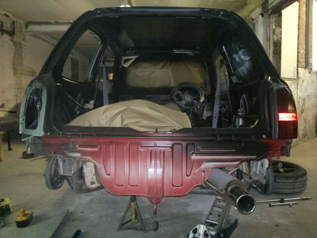

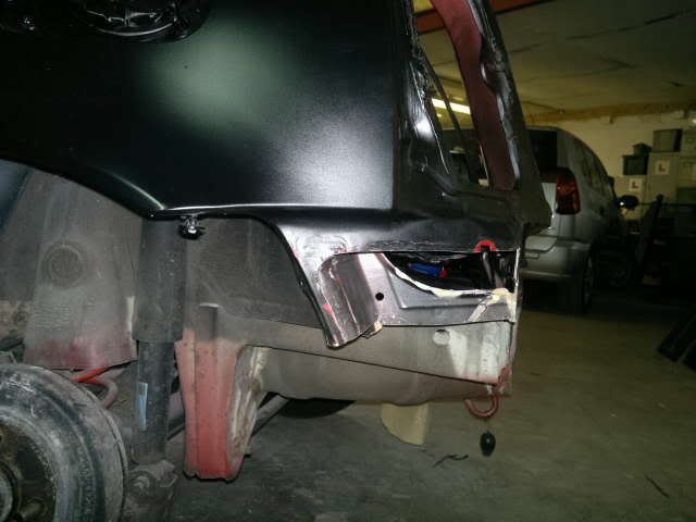

Rear tow hook & body fittings are gone.

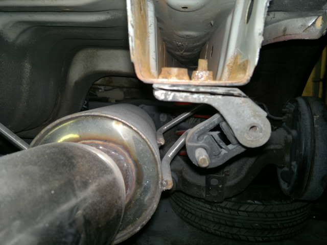

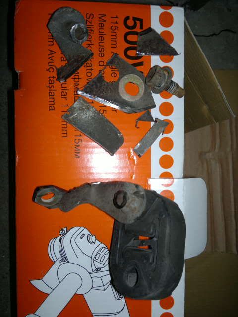

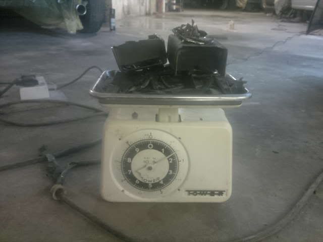

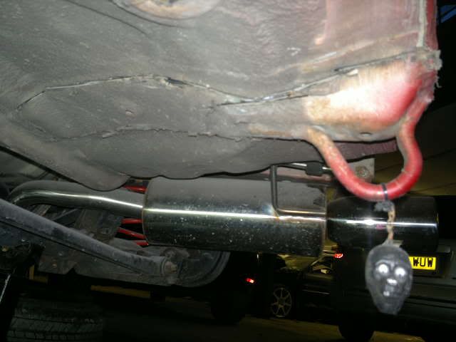

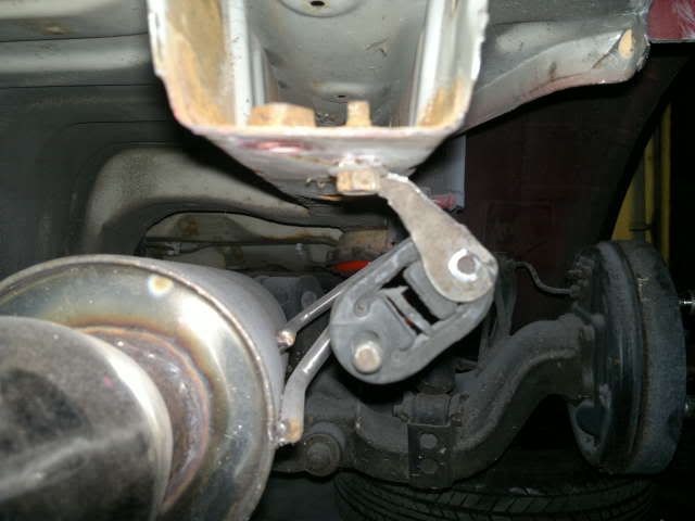

Had a go at the right hand exhaust hanger,took off more than is left.It weighs less than the waste with the rubber attached :D That excess captive nut in the rail is now bothering me tho
Tonights booty,another 1lb gone :rolleyes:

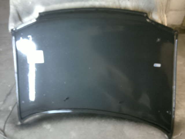

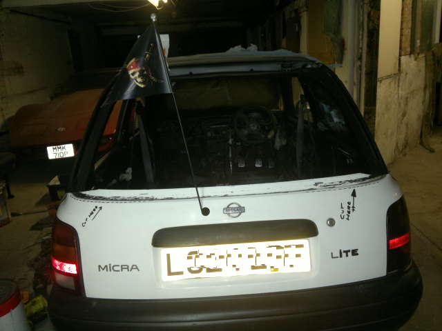

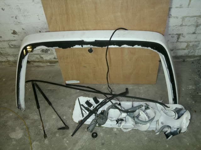

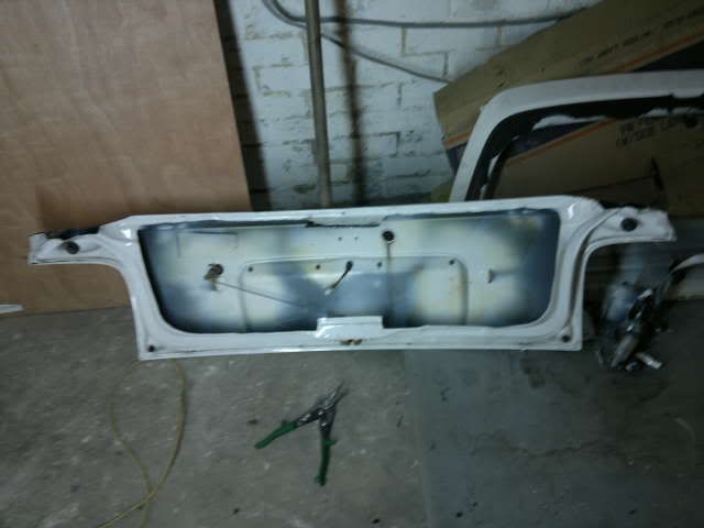

Panel wise I kept bonnet & wings for a future project & an unlucky tailgate :oops:

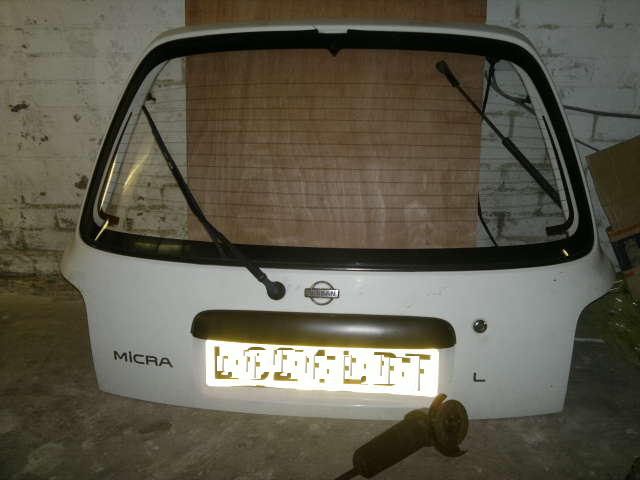

Could not finish chopping the gate up as the new El cheapo grinder could not cope with the pressure & nearly set itself on fire...Get what you pay for..

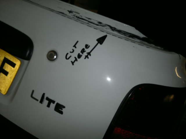

Will look better with the lip at the top chopped off,this may remove too much structure so maybe I'll have to dodge something together to support it.Shivved a load off the back with the snips,it's still fairly sturdy unlike my first tailgate attempt where I got a bit carried away :rolleyes:
Also need to find a way to fix the top so it does not blow off when you open the window whilst driving,tie wraps no doubt.
Anyway that's the basics of my Freelander style sunny weather tailgate,I'll try to get a better grinder tomorrow to tidy it up a bit..

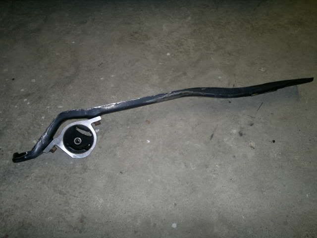

That bar under the engine seems a lot of metal,think it would be ok to lose half the sides & trim out the middle?Looks like the right angle bits will still be very strong..I was surprised how little the engine moves when you take the bar out.I remember you saying in the blue blog that the front mount does not do much...
Spent too much time last couple of days fannying around with the new tailgate but it's done now.Just need to find some number plate lights.Can hold it up with 1 finger :)

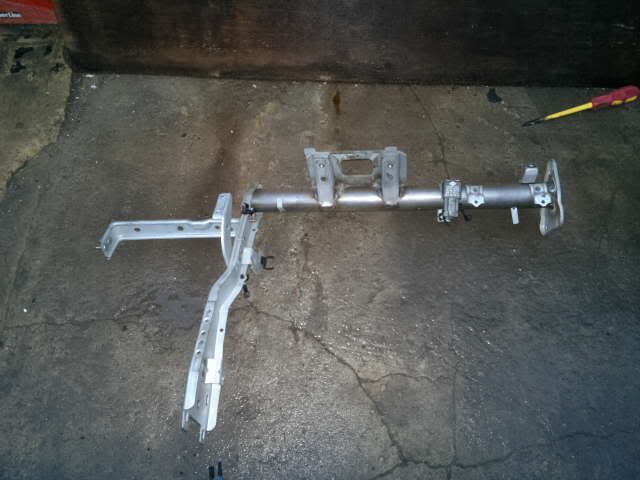

Did manage to shiv a load off the engine support bar tho,impressed with what can be lost.Sides are about 20mm now.By the time you lose the front mount,the thick 100mm-ish panel from underneath & the little very heavy shock absorber thing & bolts I reckon it's lost just under half its weight...Not sure what the shock thing is for or how its removal will affect the ride so will have to see...Car is horrible to drive anyway so doubt it will make much difference but I have a spare bar somewhere..

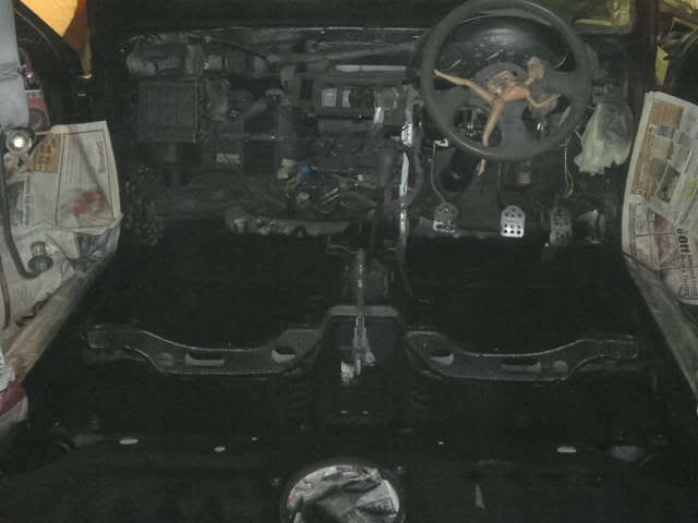

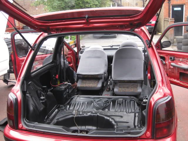

Been plugging away at it...Finally got the interior floor stone chipped tonight.The spare wheel well bottom was tatty after removing the tow eye structure,so thought I would give it a "quick" tidy with the filler.Got carried away with it on Sunday night so finished it tonight.
Liking the darkness inside..Going to put a coat of lacquer over it to seal it,easier to keep clean.
Going to try & get a load of bits done this week & see if i can get the shell painted at the weekend..

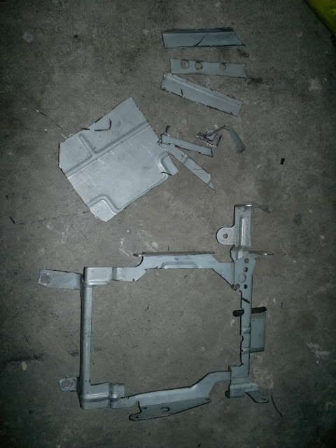

No dramatic progress,had a quiet one last night but attacked the tray the ECU sits on before I went home.
Tonight I tidied up the sharp edges on the inside of the full tailgate with the grinder & set about the battery tray which is behind the passenger seat.Standard Micra tray fixed with 3 self drillers...
Then painted the front wing & trotted off home :)

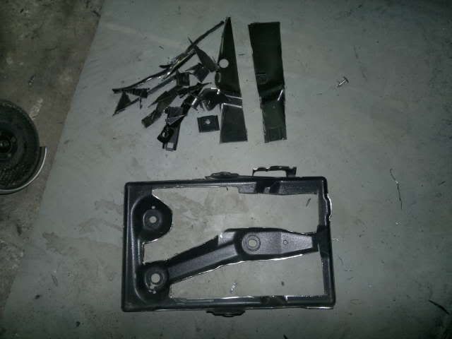

Battery (old pic)
ECU tray

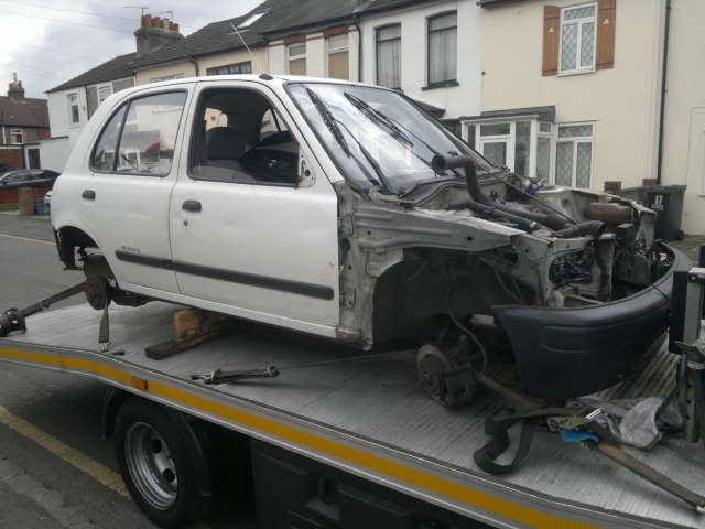

Another unlucky Micra :( Started life as a learner car (Dual control bars hidden away under carpet by some dodgy trader no doubt) & 9 loving previous owners.Good news is I now have a set of 14" wheels & trims to play with... & I killed a Fiesta Zetec today whose cambelt had fallen off that donated a set of alloys with good 185x55x14 tyres...

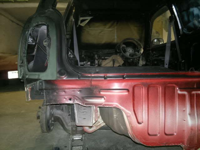

& finished pepping under the arch...
& now it's black as Draculas cape

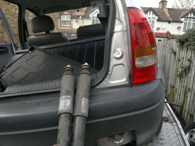

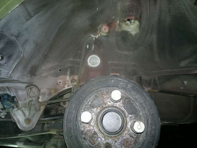

Lil update of the weekends Micra activities..Robbed the rear springs from the blue victim & attacked with the grinder to replace the very hard cut Spax on my car.Had a few attempts & still not happy with the height.Corsa shocks on too...It's back on the ground,let it settle & see how it looks..

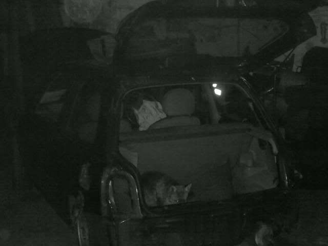

Mingin Passenger in the boot

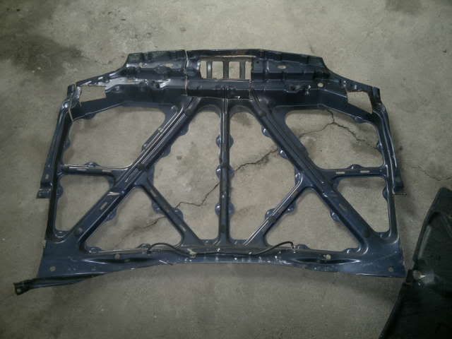

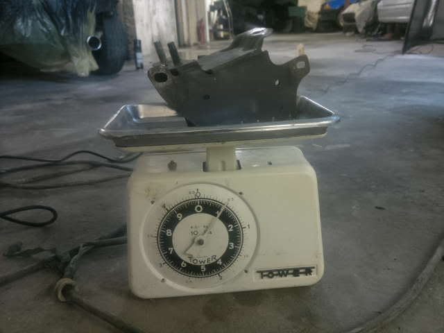

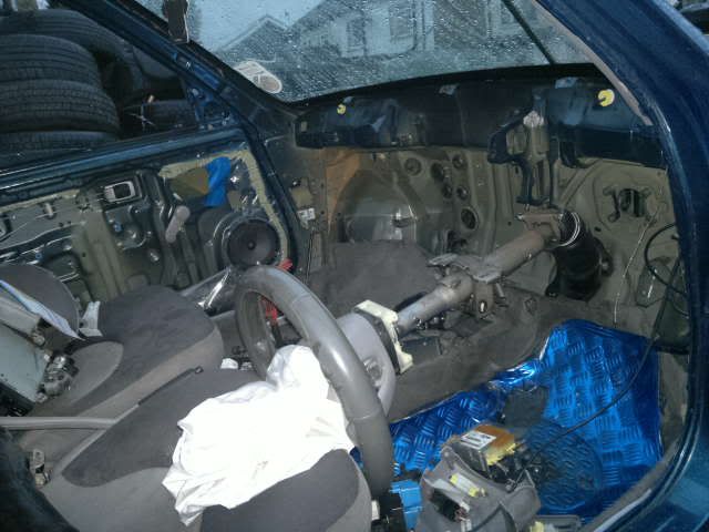

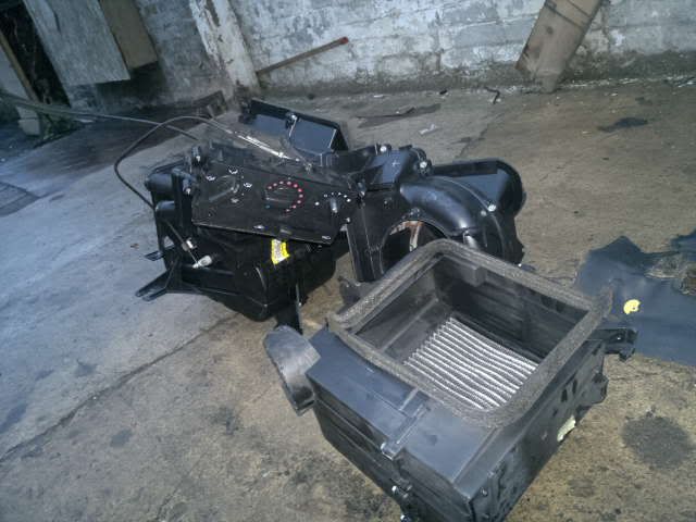

While I was butchering it I took the heater system & firewall padding out for a weight test,surprisingly heavy but I'm still too scared to take the heater out of my car,specially as it's been raining for 2 weeks.(No hosepipes please we're in a drought) Someone suggested looking at heaters for kit cars..another option.
Anyway I like the amount of space created without all the black plastic stuff...
Also removed the pedals & the metalwork that holds up the steering wheel for future projects & the engine & box are just about ready to fall out from underneath..

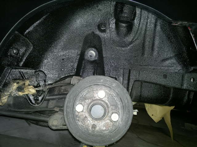

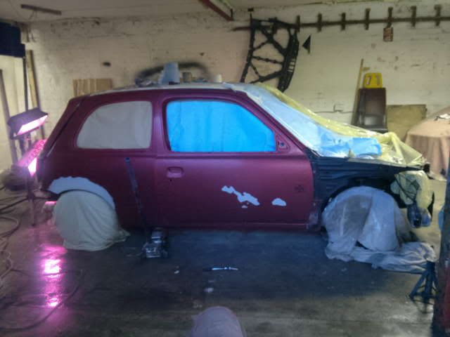

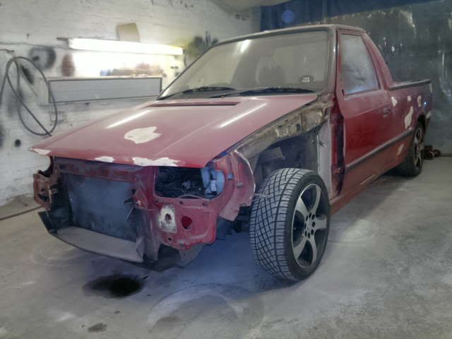

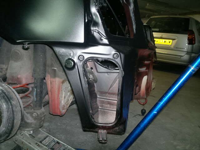

Finally started the paint on the rear bumper & drivers side,not much to do except dig on rear arch & remove repeater I glued in..

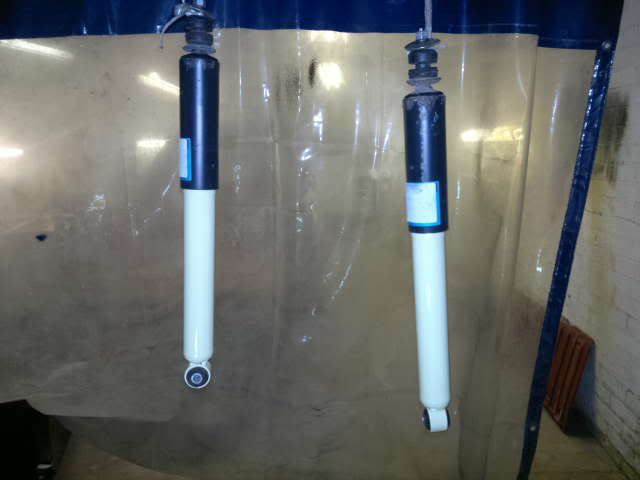

Corsa shocks & mini-Micra springs have settled nicely now,top of tyre level with top of arch & I've doctored the blue cars (RIP) front legs so comfort awaits.Also got the panhard bar for minor adjustment.Came off with the bushes real easy,maybe where I've been knocking the car around while it was getting stripped.

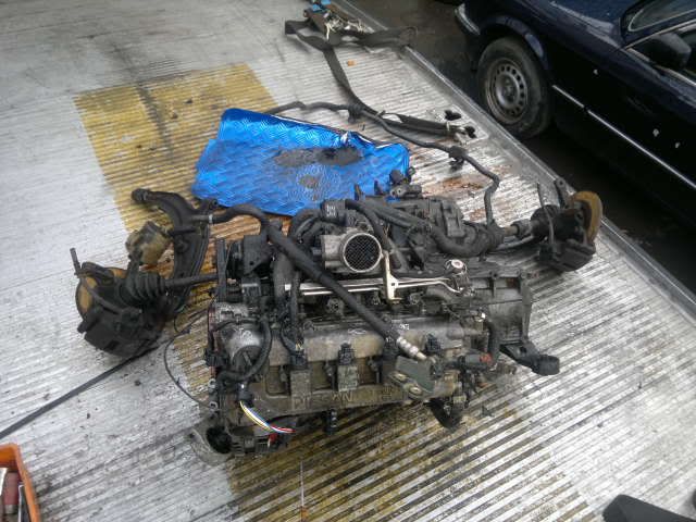

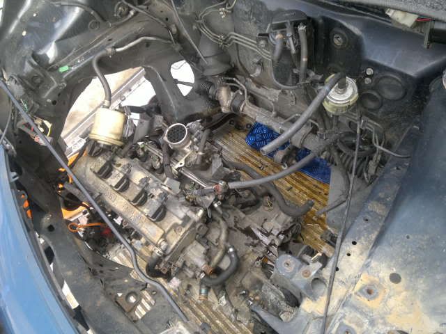

& the blue shell is gone.Undid all the engine & cradle on the truck & the crane lifted the waste away for me leaving an 80k 1.0cc coilpack engine,gearbox,hubs etc. if anyone needs anything..

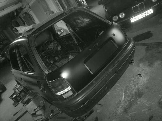

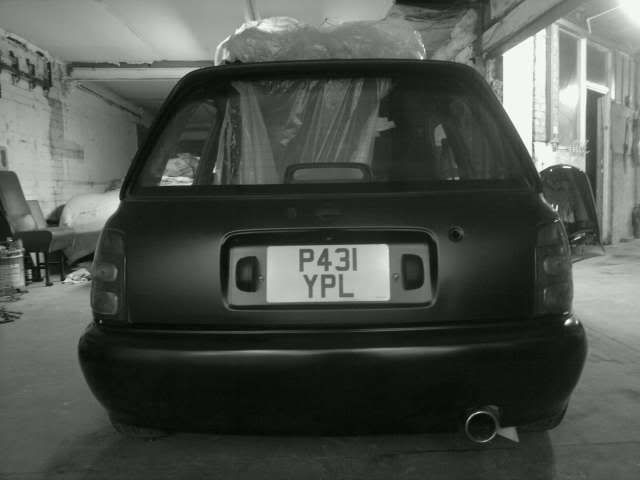

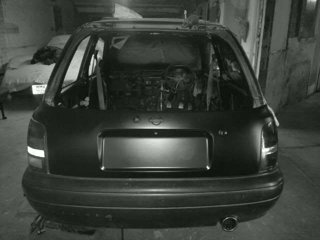

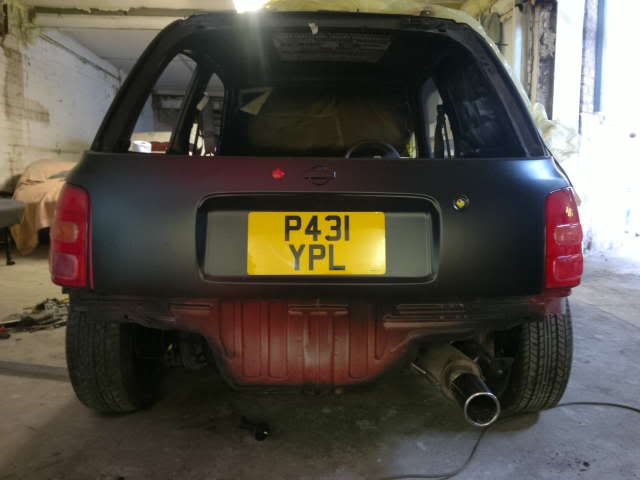

Not been much to show..little jobs but finally got the number plate lights fitted on the summer tailgate..& attacked the bonnet & ripped out the inner structure.Second one I've done,the first attempt (ages ago) was very flimsy & only had 2 bonnet pins in the middle & the G Force lifted the front & put it through the windscreen :confused: Has 4 pins now so happy days..

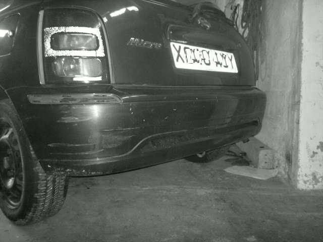

Repaired the scrapes in the back bumper & tried to save the expensive lacquer by using normal lacquer for the first coat..Bad move.Looks like it's got a skin complaint & has dried shiny so got to do again :(

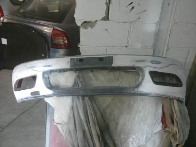

And dug out the front bumper that was probably the cause of me disappearing from here for 2 years & slapped some more filler in it & spent a happy hour rubbing it down..I've now got a cough but It's close to being ready for a gallon of filler-primer at last :eek:
Before
After :D

Drivers side is painted & as it rains pretty much every day & is is cold I've refitted the "winter" tailgate.
Also finally finished the front bumper :confused: Lot of messing around but I'm pleased.Just need to see if I can shiv some stuff out of the back to lighten it up a bit after all the filler that's been slapped in :rolleyes:

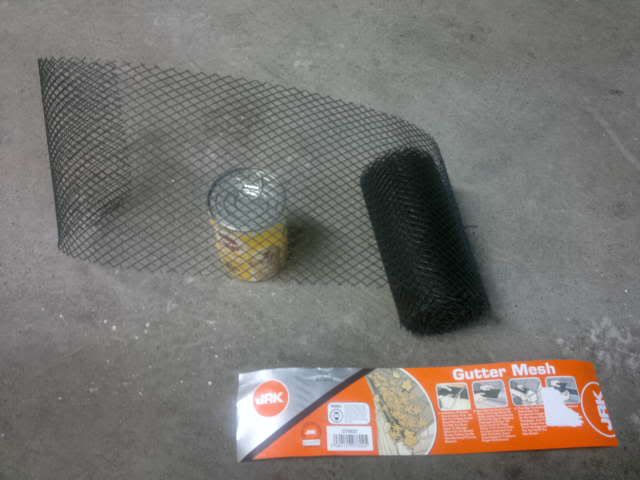

Bought some el-cheapo mesh from the £1 shop & used it in the big hole in the bumper to replace the Escort MK6 plastic one I used before.Was fiddly to fit,dobs of filler to hold quickly then bead of seam sealer...
And shivved half a pound of plastic reinforcing from the back & cut the 2 metal fixing brackets in half saving another 1lb..
Quickly put the front of the car back together,going to alter the top grill which is too high & fit the Laguna splitter tomorrow..

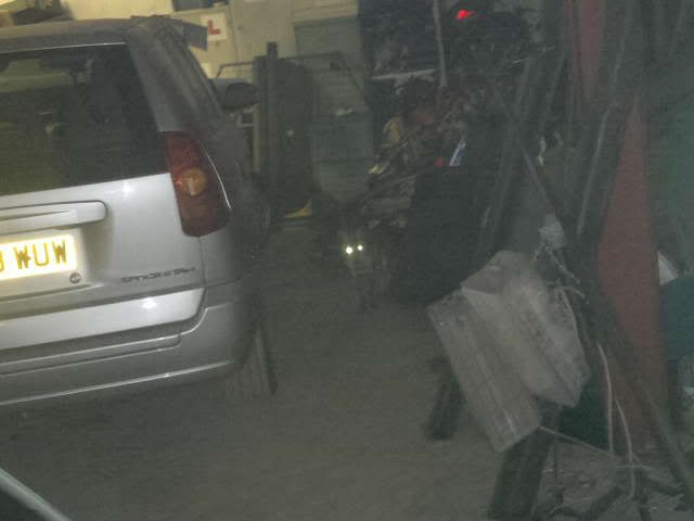

WARNING ...SLEEPER CAMP INTRUSION!!!!!
So later on that thursday my pursuasive starlet turbo fiend sorry friend drags me along in his slip stream to the weekly croydon meet. along with well maintained cars was a corsa ragsing theinards outwards of itself, so might as well leave. left the place thinking sleeper camp is local,but where? I know follow a hungry looking fox to his gates!
Fox had alerted sleeper man and he was out doors waiting for me and lad with. not much of a ambush then.

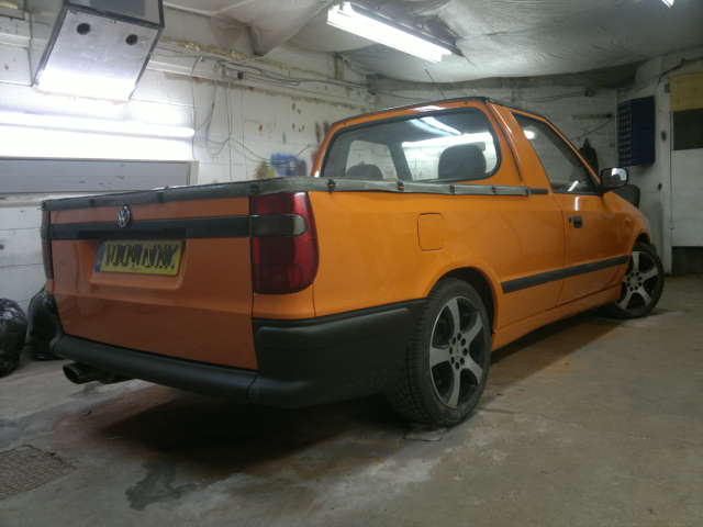

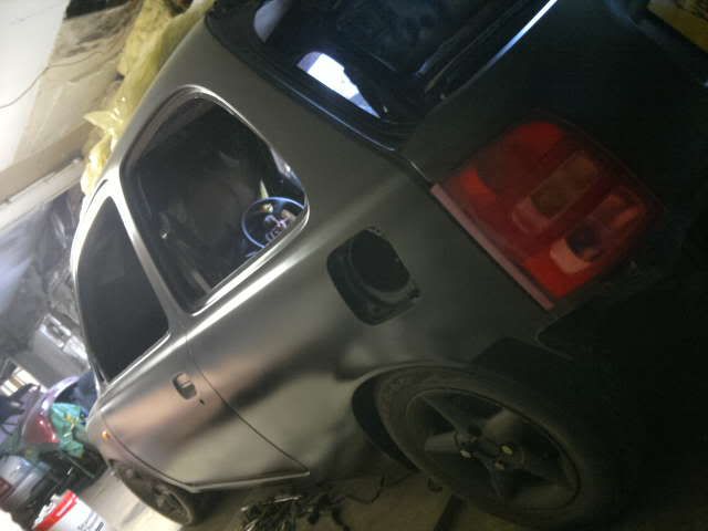

Started putting it back together...& it now has perspex side windows,clear in the front,tints to the rear.
I went & bought a sheet of 6mm big enough to do all the side windows for £50.(3 square meters)The man in the suppliers laughed & asked me how I got on with cutting when I told him I got the last lot from B&Q.He told me It's actually Styrene,not for outdoor use,goes brittle & yellow & you don't cut through it you melt through it & it takes ages :rolleyes: The new stuff is ace,cuts & sands easy..
I've done away with the rubbers on the rear so took a lot of sanding to get right & stuck them in with seam sealer.
Going to tackle the tailgate glass next week..
So I've got some Styrene fronts left over which I'll tint for show purposes,don't think the Feds would approve :eek:
And fitted the winter tailgate as it looks like it's going to be cold & wet forever and wired it up & put the number plate & lights on..

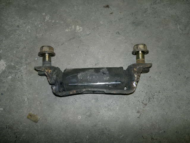

So went to check on the gearbox mount

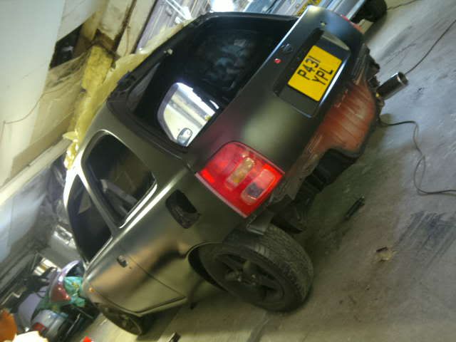

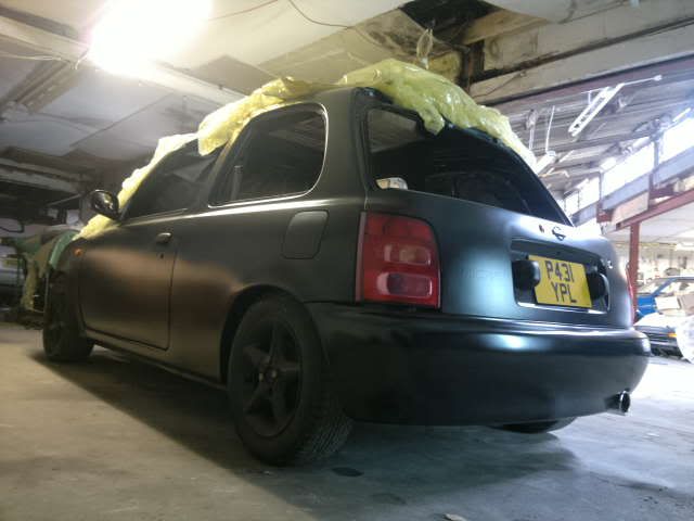

Been finishing bits off,sealing perspex,cutting more stuff off,sorting electrical gremlins,& it has at last now got a drivers seat.
Went to trim the firewall sound deadener & kinda got a bit excited & ripped it all out :rolleyes: well nearly all I've got to pull the heater stuff out the way to get the last bits.Heater MUST stay I tell myself seeing that summer has been cancelled it seems :(
Dispatched a Mazda 323F last week & relieved it of its rear spats,gave them a trim & now could be stuck on.I'll paint them black & see how they look..

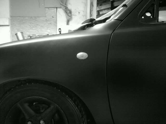

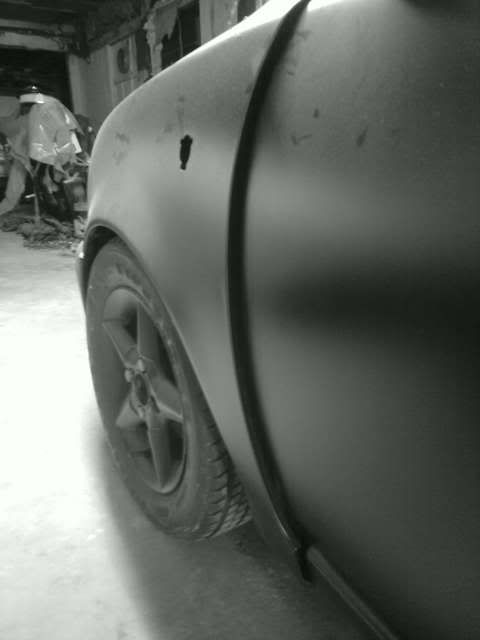

And have been "adjusting" the front wing to give it some flare.Has no splash guards so should help with the aerodynamics :D

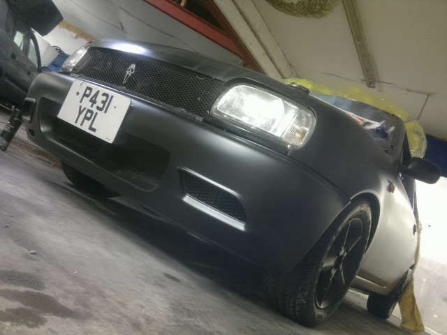

And the Caddy has been Tango'd.Crying out for more lows & bigger rims ;)

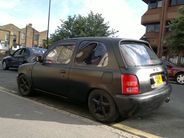

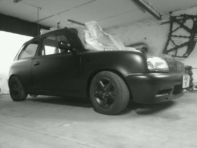

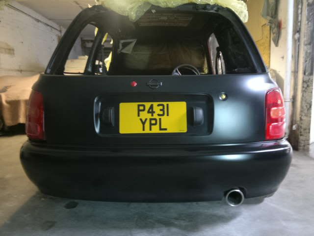

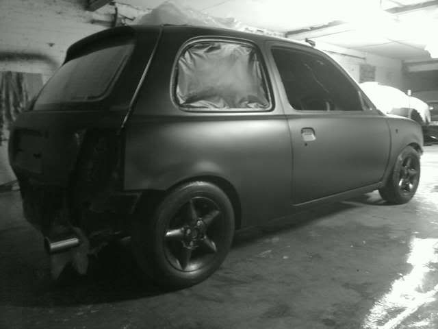

3 months have gone by,move around in the workshop resulted in the car being sheeted up & all my stuff getting mixed up so I lost enthusiasm but I've had a blitz this week and it is finally a road going car again!
Just in from refitting the exhaust,finally sorted the exhaust/axle noise with the assistance of tie wraps to strengthen the rubbers on the back box..
Had the auto sparks down this morning to wire the facelift rear lights & March plastic headlights & sort out the long standing bodged headlight wiring so now everything works.

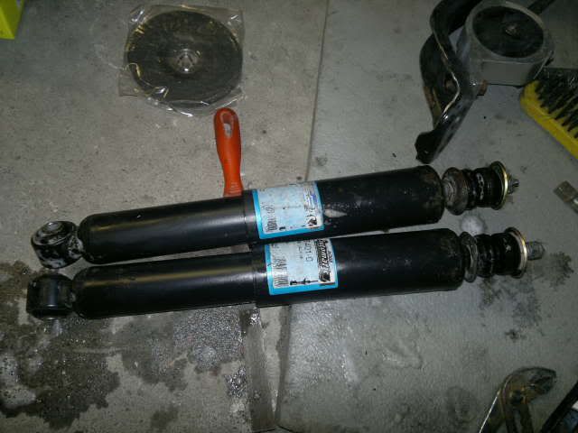

Last job I remember messing around with before going AWOL was the rear springs & Corsa shocks.I removed the cut spax from the rear & used Micra ones,thought I'd got a bit carried away with the grinder but as it is now 100mm ish lower than standard it has actually stopped any arch/tyre scraping as the tyre is now right up inside the arch.Need to watch the fuel tank on speed humps,might have a fish for a racing tank inside the car..

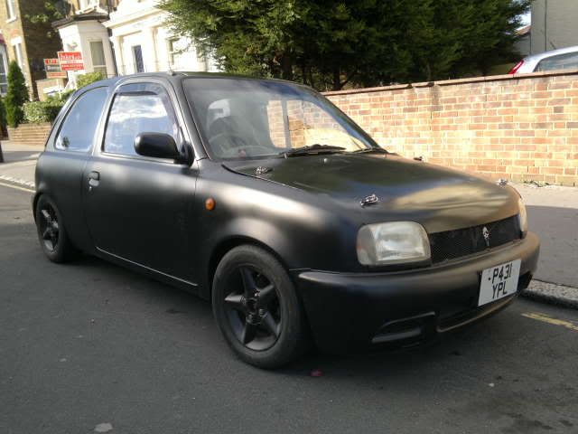

Great fun to drive,the recent weight loss has made a big difference.Weighbridge beckons..And a lot of people stare & browse when it's parked in the street.

Liking the lows, good job on the matt too. Not too keen on the wheels though :(
oooooooof is that your petrol tank near the floor ??? :)
Yeah it's dangerously close to speedhumps,have a choice,racing fuel tank inside the car or go up to 14's which I have prepared for paint but accidentally sold the tyres robbed from a stricken Fiesta.I'll suffer it for now...
