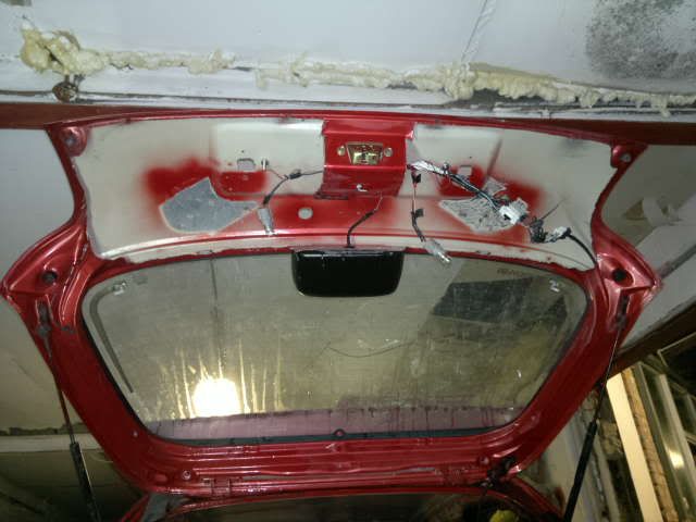

what happend here? looks a tidy seamless weld on the seal

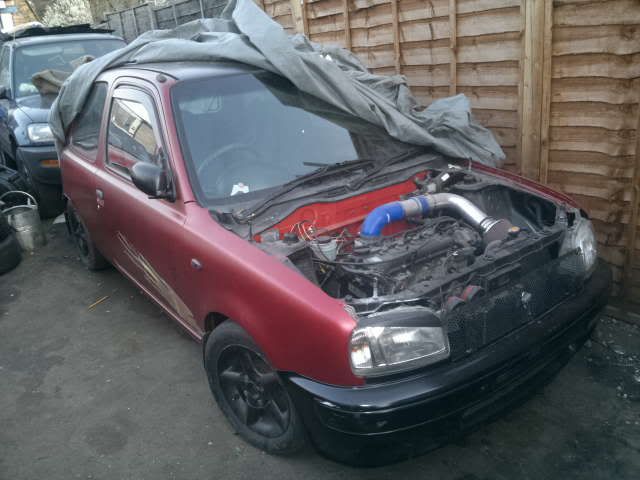

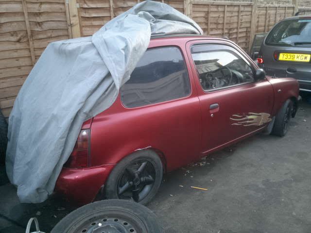

Hi all...Mini update...my blog had gone AWOL till I logged in again :eek:
The car has been sat around for ages,moved workshops twice,it's been sitting with a cover over since September & had become a dumping ground for old tyres/parts etc.Looked very sad...
Last time I used it was funny for about 10 minutes.Over fueling badly so kept cutting out,exhaust hits the body & the suspension is stupidly hard.So I changed the throttle body last night & now at least runs fine.
I robbed a Matiz of its front suspension a while ago so will get them fitted & get the car on the road again...

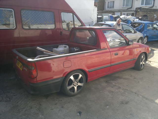

My current ride,now condemned due to tax expiring.Never driven such a smelly car,tin of cat food exploded in the hatch a few weeks ago.I've kinda grown to like its distinctive aroma but was slightly embarresed when I had to collect a potential car sale victim & his totty girlfriend up from the station..:oops:
So now need another small easy to park works vehicle a bit urgent so I'm hoping to get the Rat in the workshop this weekend & get things moving again.Sadly not great for collecting people due to the meagre seating arrangements ;)

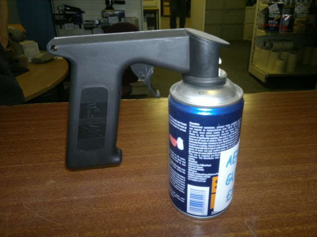

I remember seeing an attachment in the paint suppliers that fits on the top of aerosols that throws the paint out faster to avoid the "streaking" effect.I'll ask when I go there for supplies...

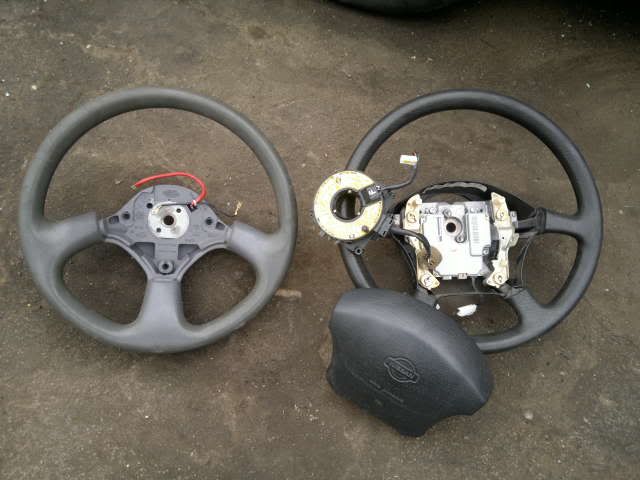

Also fitted a Super S steering wheel doing away with the heavy airbag system.Big difference in weight,must get some bathroom scales!
Had to put the horn on a redundant switch from a failed lambda sensor project due to lack of steering wheel centre bit & horn assembly :eek:

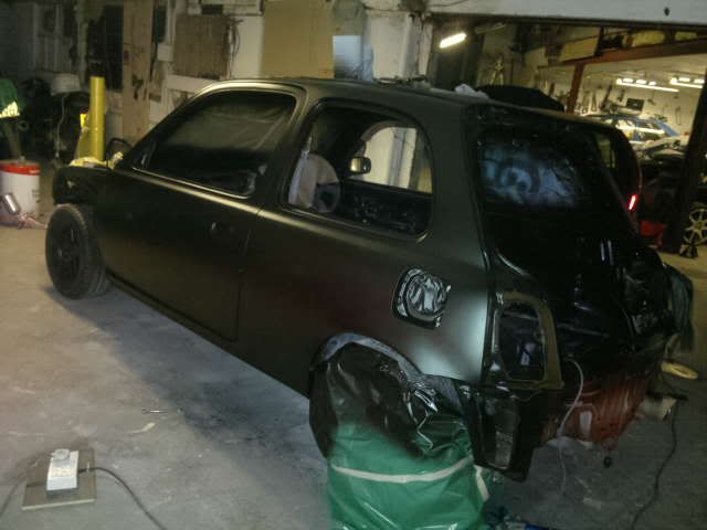

We had a shuffle around in the yard so the Micra has now made it inside.Flatted the stonechip on the nearside rear quarter & sill & finished prepping the panels & door shut.Ready for primer now..
Removed the front wing to paint off the car,will help to have it out the way to swap the front legs & springs as soon as I can find the spring compressors..

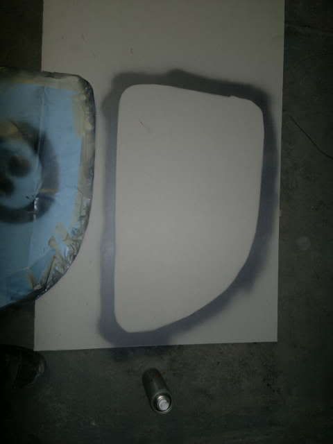

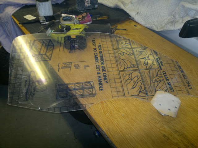

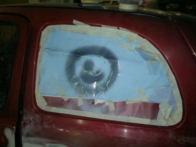

Also took rear window out & had a think about the best way to make template for perspex replacement.On the other side I have done away with the rubber but it was a bad fit so I had to dodge it up with a load of seam sealer.Not happy with it so I'll replace it as soon as I get the fit right on the nearside.
I made a template for the tailgate glass at the last workshop,having a lot of trouble finding stuff after moving.The search continues...

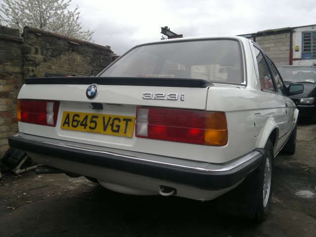

Lovely old Beemer,done 40000 miles.Had a few bits of paint

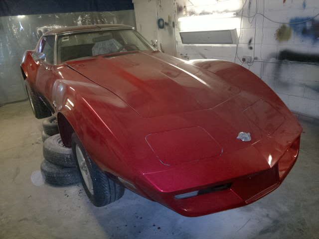

My mates Corvette.Being fitted up after paint.

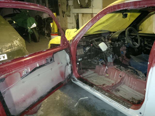

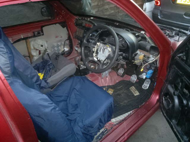

Also tidied out the clutter that had accumulated inside the car,getting ready to paint it all black & get rid of the nasty reddy pink.

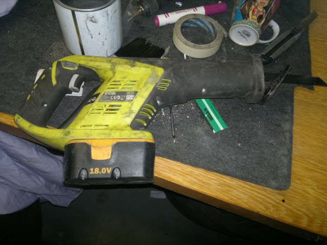

The weapon of choice for the perspex.I hate cutting this stuff,you end up melting your way through it.Much faster than a jigsaw.Sanded all the edges with some course paper...

Template 1.
Template 2. I now have Mercury grey fingernails.Nice

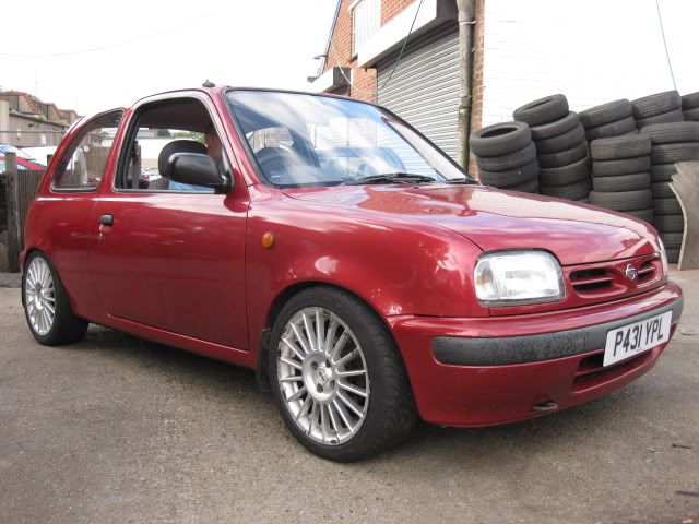

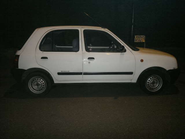

Took this K11 1996 3 dr 1.0 Vibe in part ex a while ago,I used it as a runabout in standard form for a while & kinda got attached to it then started fiddling..
As it arrived after a wash.
Running on standard Super S alloys in satin black with 185 60 13's.The 16"s in top picture are being restored,painted & need 2 tyres.Should be back on soon..
Stripped out the interior & finished in black.Battery & cut-out switch fitted to rear.
Far too much red,bring on the darkness.
Induction kit fitted kindly donated & adapted from a poorly Pug 206.De-catted the Micra too.Still using the standard back box,got to sort this soon as the wasp noise which was funny at first is now driving me mad.

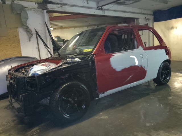

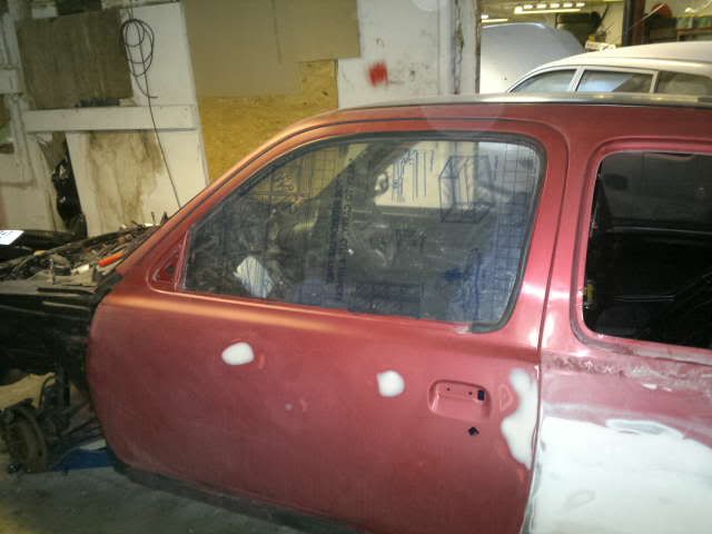

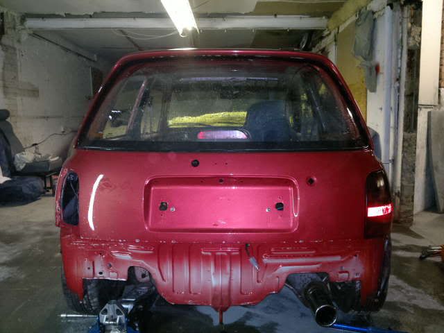

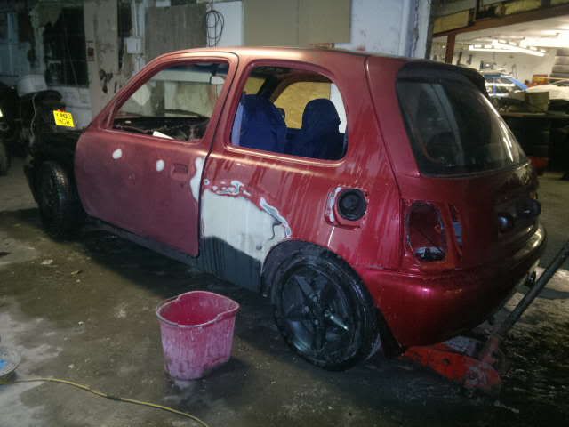

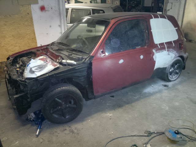

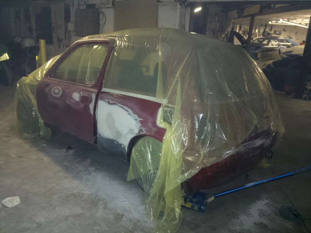

Did a late one & finally managed to prime the nearside(3 years later)I've been thinking about putting a racing tank behind the drivers seat so I could do away with the petrol tank & filler assembly & weld a plate in the hole but that will have to wait for another day.(Another 3 years)Big tank tempts me to cart too much fuel around...
Did a few repairs on the rear bumper,more yard damage :( So the preparation is nearly done.This week I want to get the interior & under the bonnet blacked out before I finish the shell..
Long weekend ahead innit...

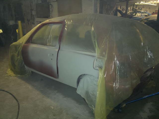

Tired...Was naughty & got involved in some primer flatting when I eventually rocked into work...which put me under pressure work wise for the rest of the day.Did what I had to do,then finished flatting,prepped tailgate (Inside is dangerous job,many sharp edges.Grinder action required) Removed tailgate,passenger seat,tidied out more clutter & cleaned car/work area.
Pondered on possibilities of making a lightweight stable door type tailgate like Land Rover Freelanders have what with summer on the horizon..Not secure,but nothing in the car anyway.Have not come across the tailgate glass template yet.
Here's the progress pics,and goodnight o_O

Cheers for the quick reply, Sleeper. Is that device on top of the spray can in that picture, what you were telling me about? I think my local Poundland does them!
Got the inside painted with a mixture of blacks I had,Jaguar Anthracite & BMW Swartz no less. Left the floor which scratched up quickly last time so I'll do that in stone chip..Was still earlyish & I'm inpatient so I painted the side without cleaning the floor properly & got a few lumps which will brush off when It's dry but then the lid on the gun was not on properly so got a lovely drip on the rear post :( so was a waste of lacquer basically @ £40 a litre!
I'm going to experiment & see whether you can do the first sticky coat with cheap laquer..
Anyway I like the finish better than the satin gloss but I'll have to do the rear quarter again...
