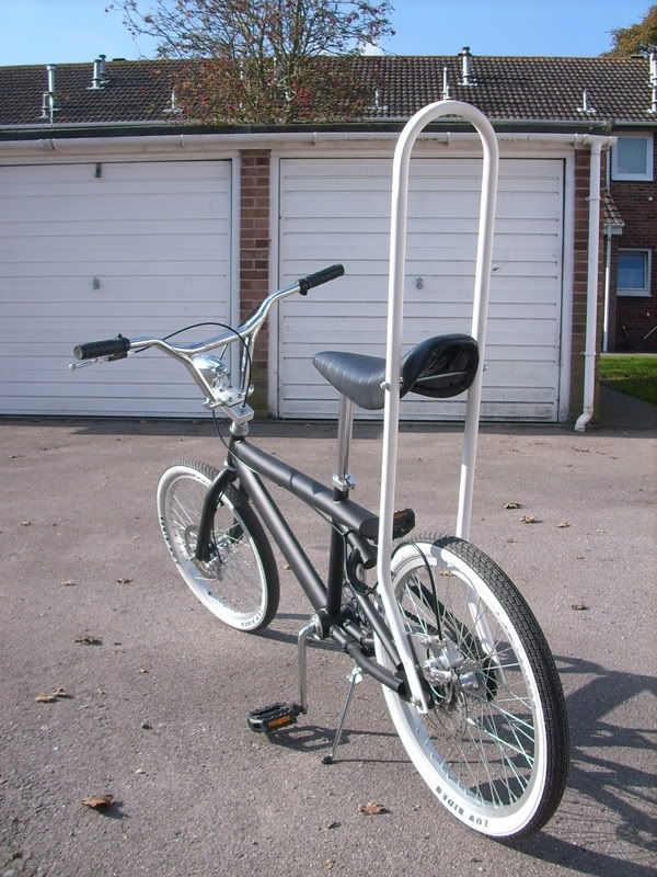

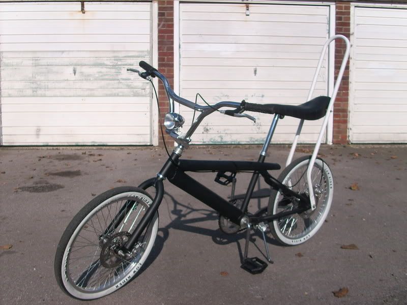

I was going to stick the bike up in the "into cycling" thread, but as I'm not actually that much of a cyclist I thought I'd put it here. The rest is some other tat that i've cobbled together over the years.

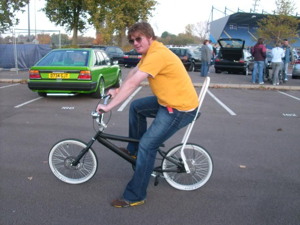

BMX Based Chopper, layed back stem tube, extended rear stays, home made sissybar.

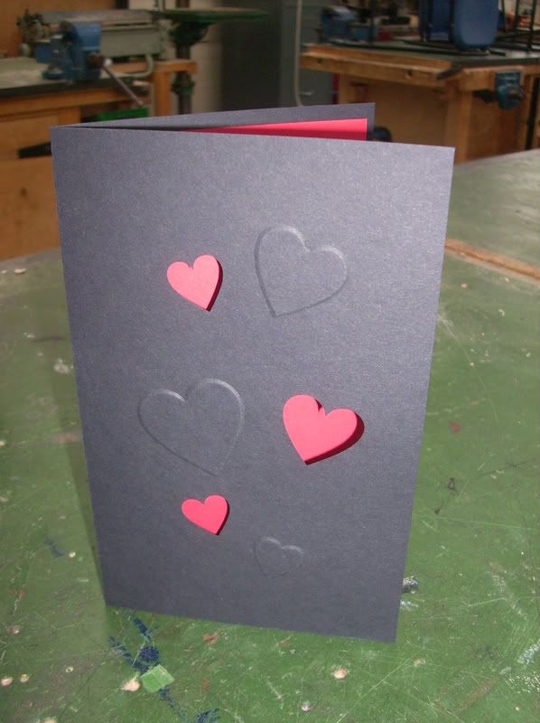

Embossded valentines card
Laser cut 1mm acrylic sheet for the press tool, which was used after the had been laser cut.

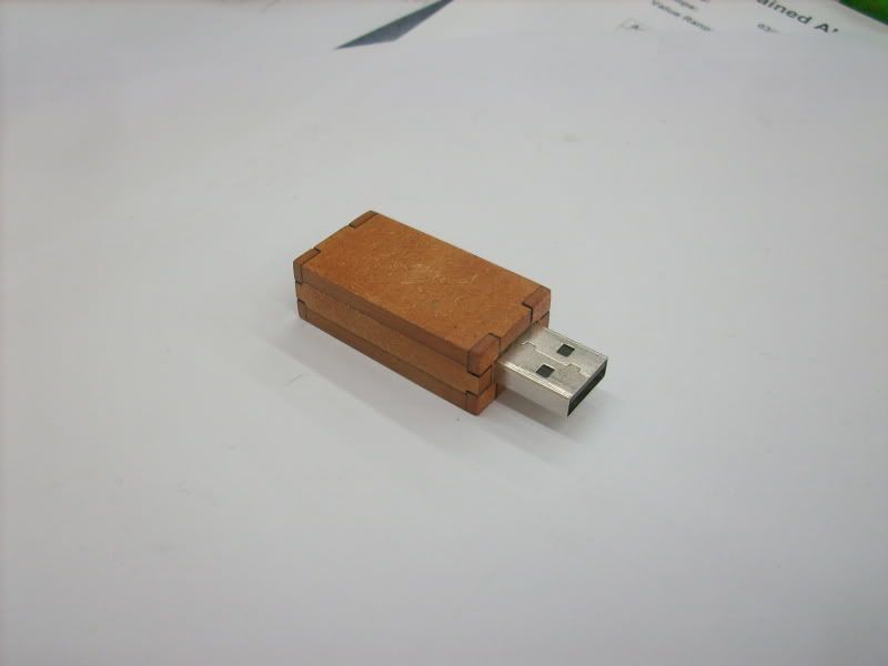

Laser Cut MDF memory stick case.

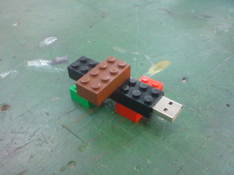

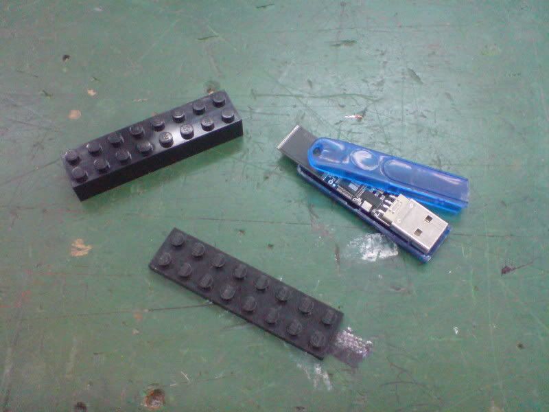

Lego brick memory stick case.

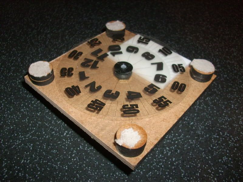

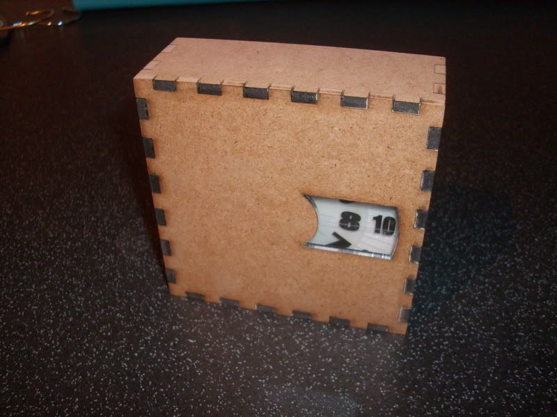

Jump Hour clock, laser cut MDF case.

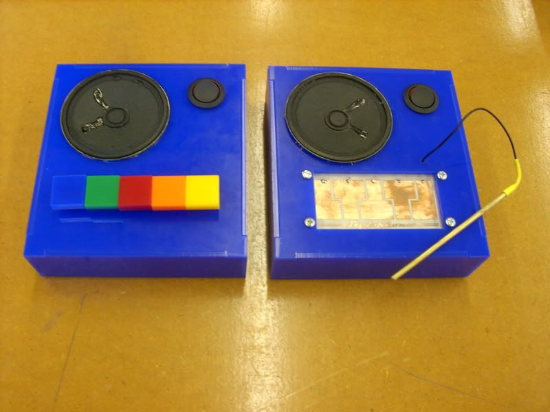

Five note Keyboard and Stylophone, 555 osscilator circuit, laser cut acrylic case.

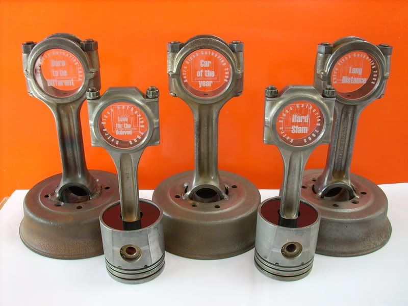

Trophies for Retro-Rides Gathering 2008.

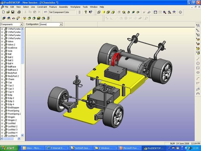

3D CAD model of Mardave V12 RC car.

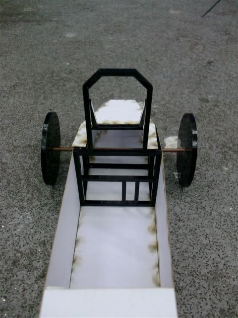

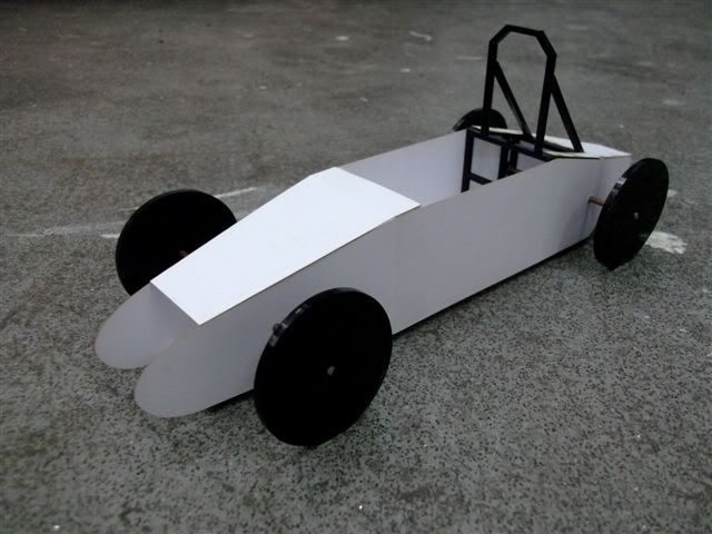

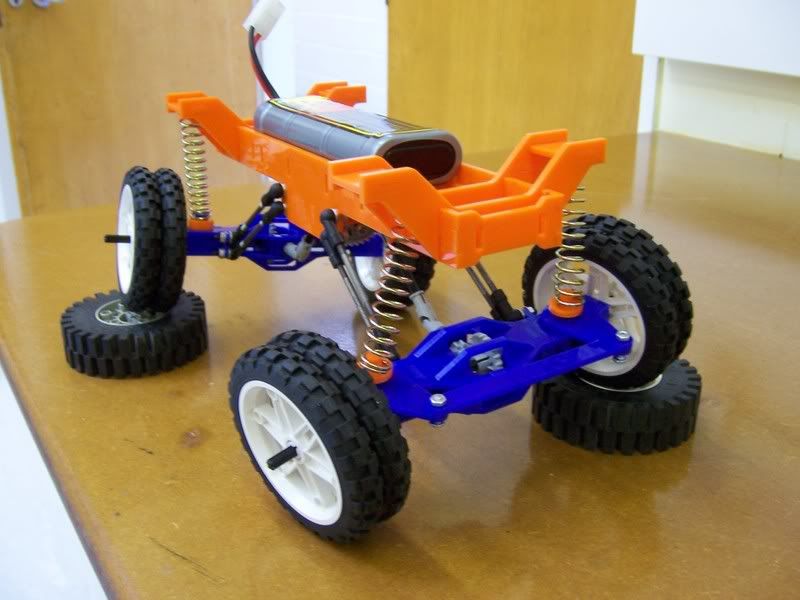

Laser cut acrylic chassis, as an example of what might be achieved for the 4x4 in schools challenge.

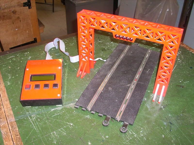

PICAXE PIC Scalextric lap counting and timer setup, uni project.

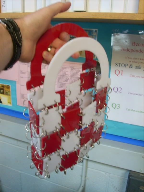

Pop Art Hand Bag, as an example of how resistant materials can be used in textiles.

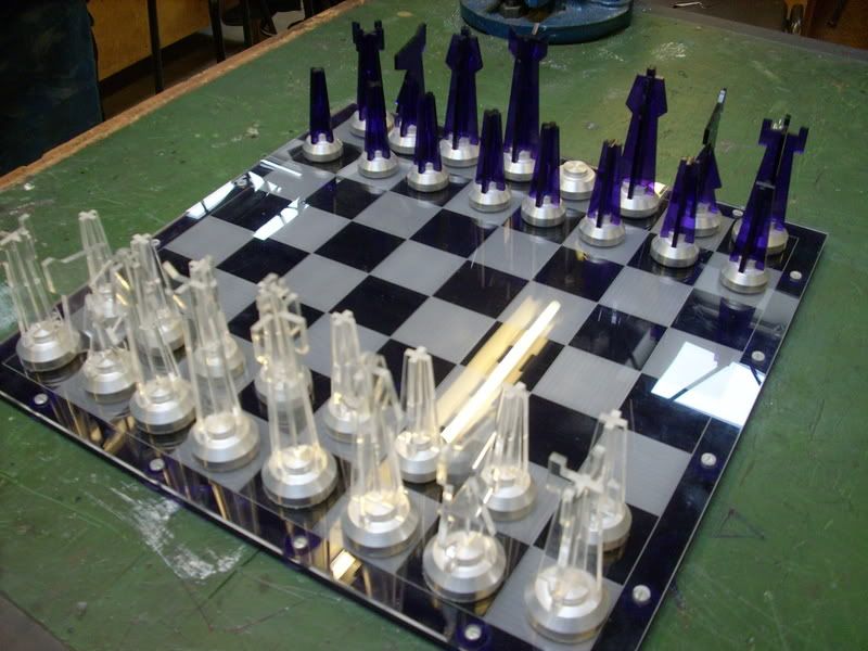

Chess Set, laser cut acrylic and CNC turned bases. Another Uni project.

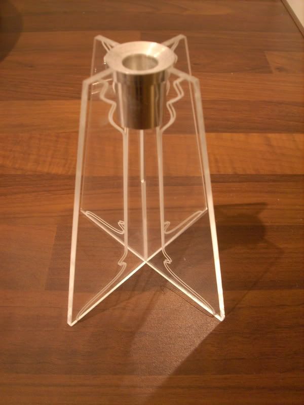

Candle Stick, acrylic and turned aluminium.

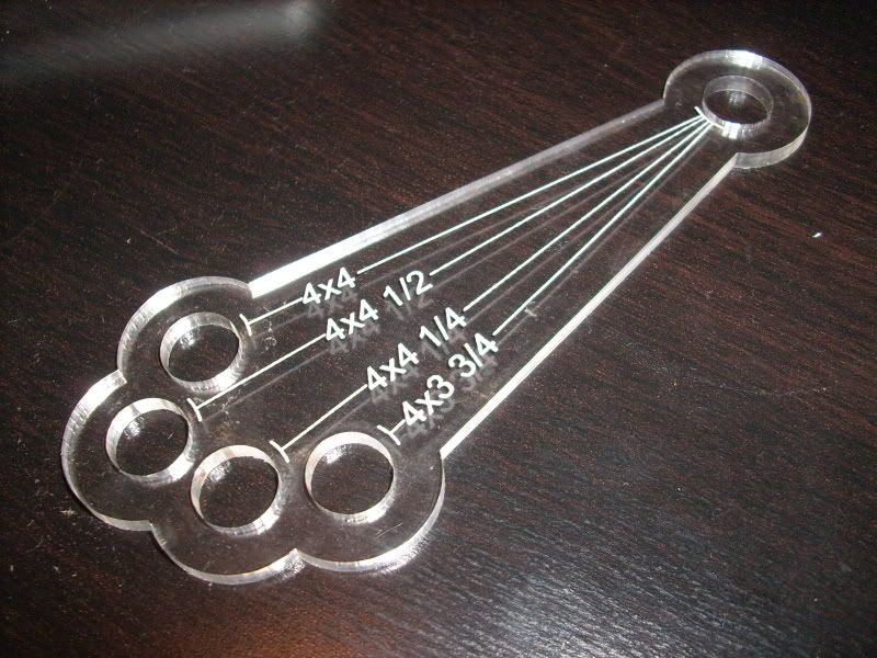

EasyPCD's, laser cut acrylic PCD checking tool.

mark love the bmx! im bust making 3 atm, im going for the chopper (motobike) look on one, hopeing to get the same lenth too, just haveing trouble with the front forks (getting the lenth) any ideas

Micras, maybe find some tube with an inside diameter the same as the outside diameter as the fork tubes and sleeve it over with a weld at each end, or turn down a peice of bar of the same outside diameter as the fork tubs so that there is an insert into the fork tube and weld it in (probably best for a short increase) or find some tube the same as the fork tubes and butt weld it in. I wouldn't do the last one because it relys on the weld rather than any mechanical means, and I know my welding isn't that good!
Theres a build thread for the bike
here.

I actually really like your chopper, was thinking about doing something similar for my A2 project but didn't in the end :(

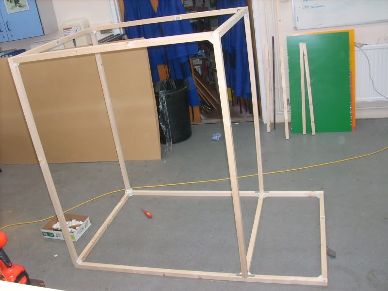

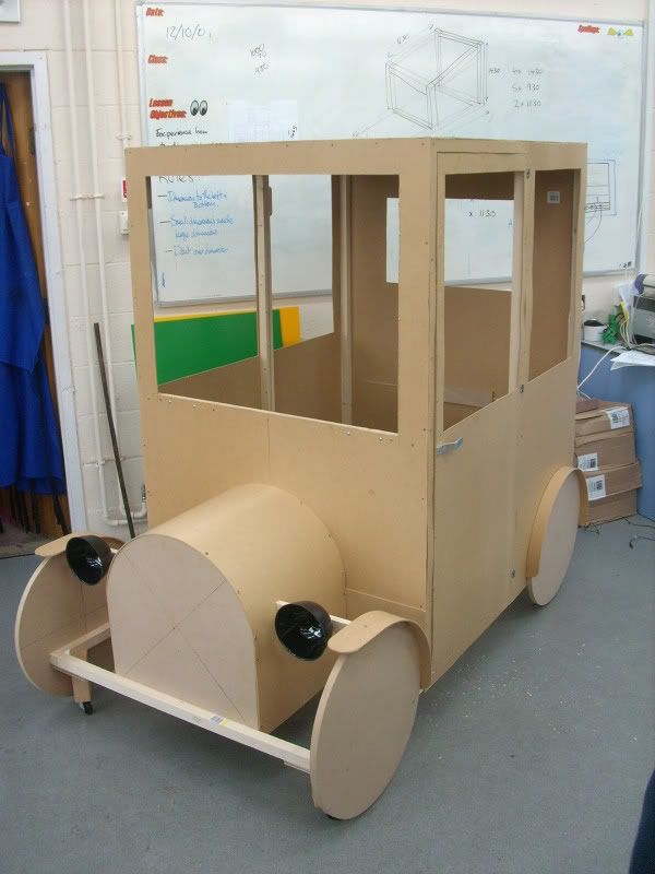

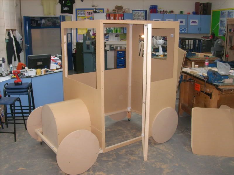

Bugsy and Dandy Dan's cars
Every year I get roped into set construction by the drama department for their yearly whole school production. This year Its Bugsy Malone. Unfortunately the drama department know someone from another school who has done it and are borrowing the Splurge Guns that I was hoping I'd get to make.
They have asked me to make them some cars though for the Bugsey/Dandy Dan chase scene . So I set about comming up with a plan. I settled on a flintstones style car, rolling on castors rather than the actual wheels, to ease constuction and manouverability. The cars are assembled from a frame work of 32mm square spruce spar clad in hardboard.
I spent a day in school last week (it's half term!) getting the first part of the building done, I had four kids helping and another teacher. It was harder work keeping everybody else involved than it would have been to do it myself but the kids need to do some set construction as part of their BTEC course.

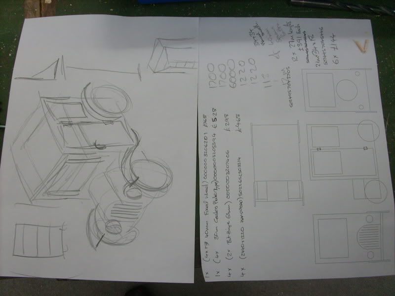

I started with some drawings, CAD and the old school sort.
Planned out the frame,

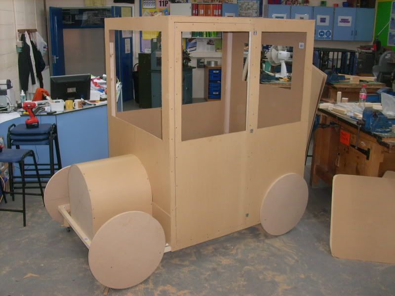

Then got building.

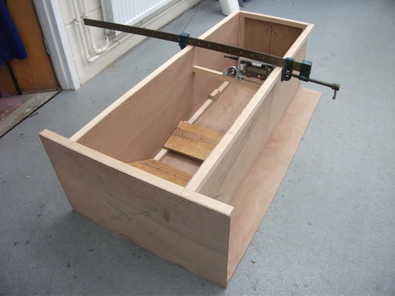

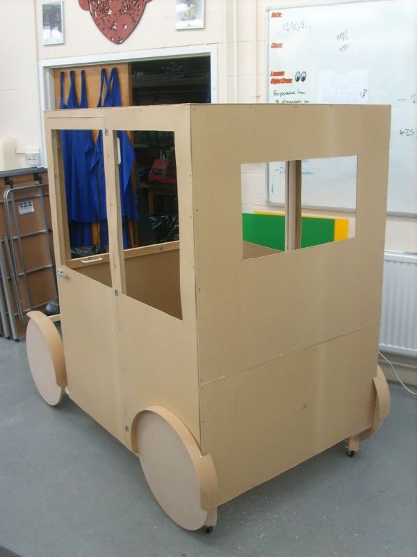

The basic frame,
Nearly Finished
There's a door on each side,
I just need to add some fenders and head lamps. The plan for the headlamps is to use a small pyrex bowl as a vacuum forming former, and make the headlamp bowls from thin plastic sheet. I might use some clear acrylic as a lense.
Day 2:
Got the first car finished this morning, fenders and headlamps. If the drama dept want I'll put lenses in the bowls, but as the material is expensive I've left them out for now.
I'm pleased with how much like the original sketch it looks. I'll grab a couple of pics when its in paint. Some year 8's (12-13 y/o's) are painting it.
Onto the 8"x4" flats with doors, then the other car.[/quote]

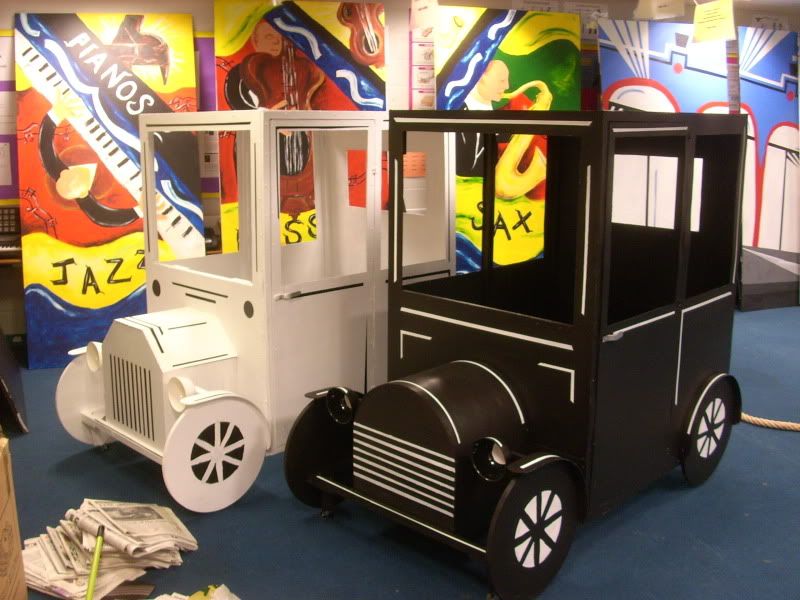

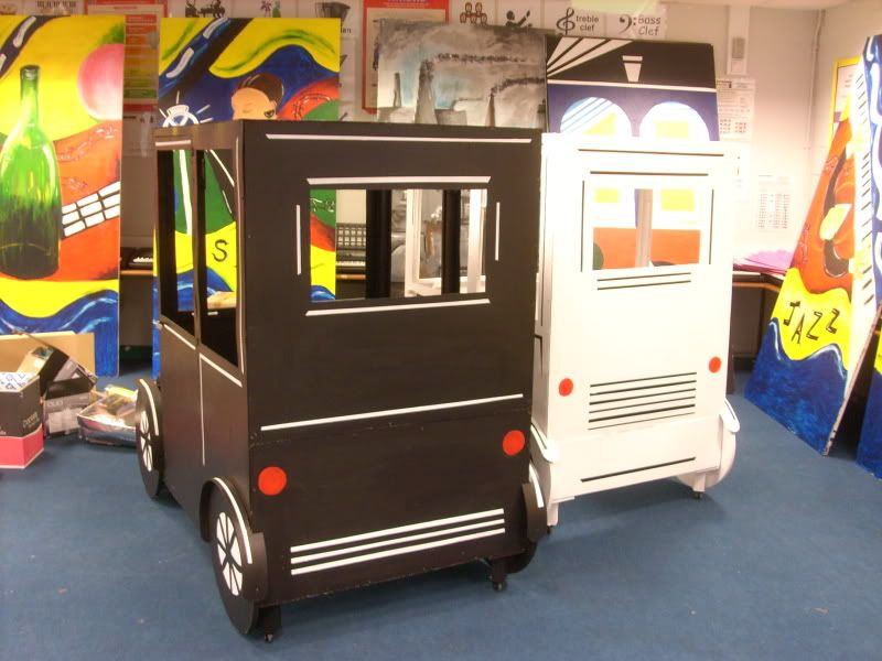

Here's what I've been up to over the last week or so,
Well I got the second car finished eventually, they are now in paint, I'm a bit dissapointed by them but the art department are massively hard pressed for time, and reliable kids. Getting the rest of the props, the flats (8x4 sheets for the background) and of course their normal teaching has meant the jobs were a bit rushed.
There's not be much teacing going on in my room for the last week and a half!

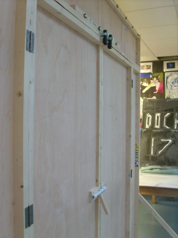

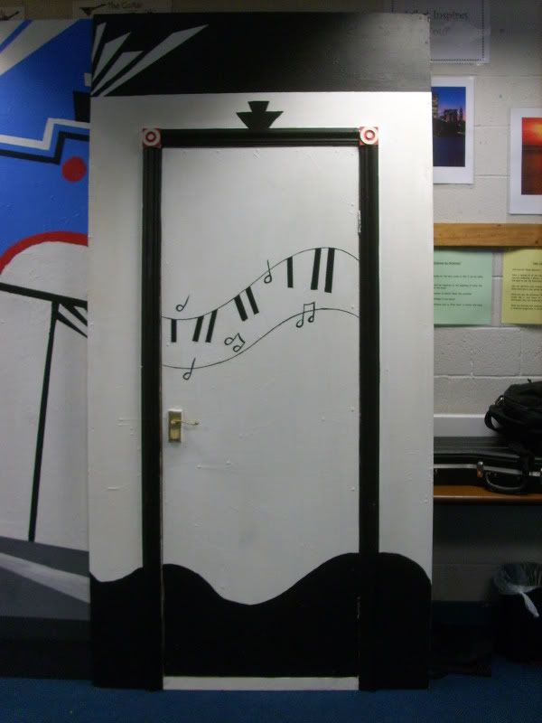

Between finishing the cars I made two (working - not painted on!)doorways in 8x4 flats. On finishing the cars I got given to make two A-board signs, and an 8x8 secret doorway bookcase. This I've had to design so that it comes apart for moving around the school, but is still strong enough to be free standing, and light enough for the kids to use.
Here's the cars:
The door ways, both much the same, but right and left handed.

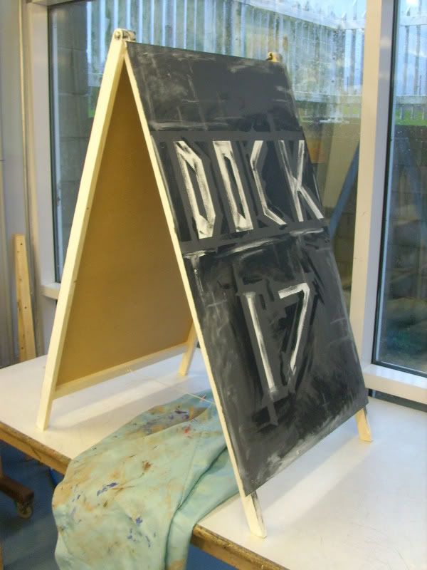

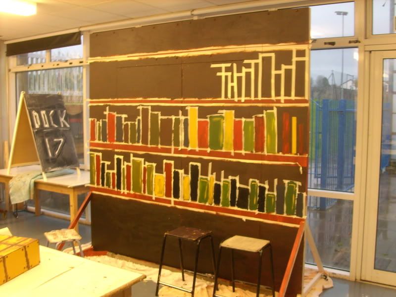

A-board signs, looked great bare, look a bit rubbish in paint. Bloomin' kids.
Credit to the kids painting it, the secret doorway bookcase is looking awesome!

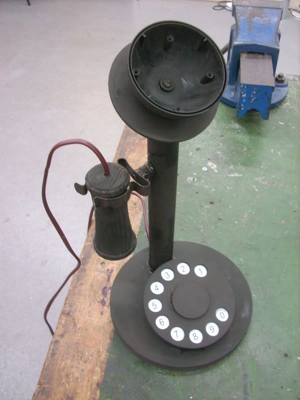

After all the big stuff I thought I'd done, but after an hour and quarter long production meeting last night - god can these theatrical types go on! - I sort of got volunteered for a candle stick phone, traditional cone megaphone and some trunchoens.
The phone came together rather nicely today, bit of old dowel, some lazy cuttered MDF, a raid of the scrap bin and a bit of wood turning resulted in this;

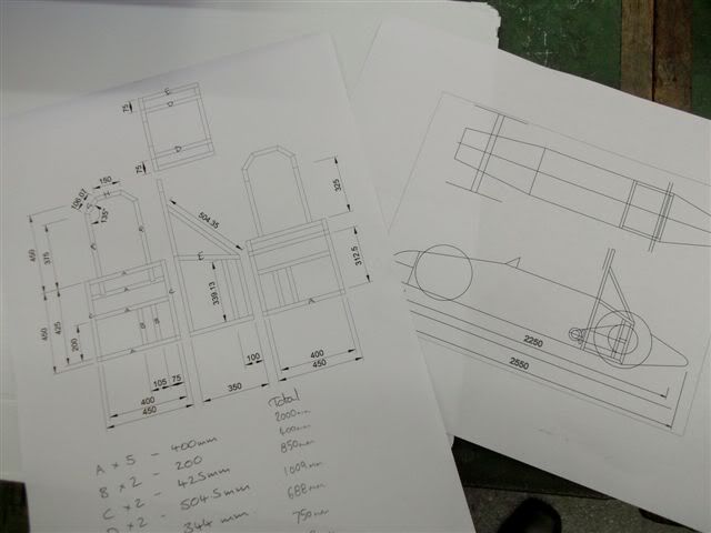

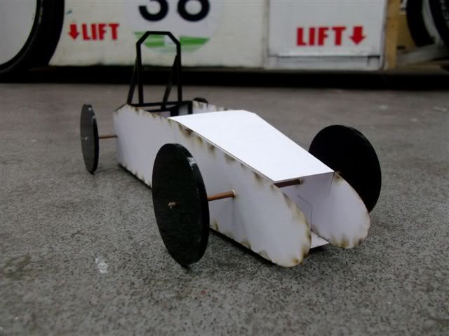

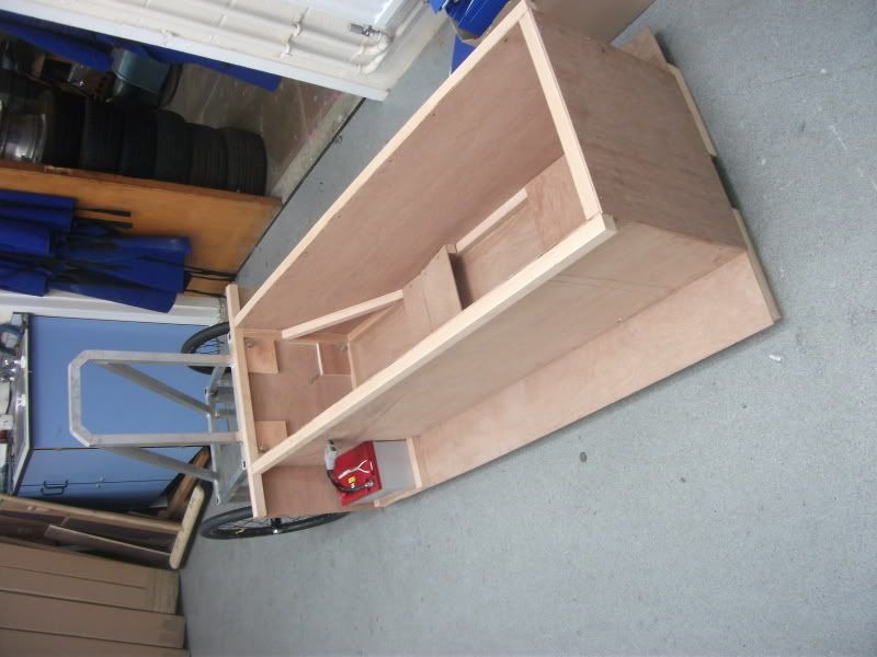

As some of you guys probably know I teach D&T/Engineering in a secondary school, for the last couple of years I have run an extra-curricular club to enter the Greenpower Formula 24 competition to work with a group of students to design and build an electric racing car. I put up a thread on RR for the 2010 car here but never really finished the thread. The same might happen with this one for the 2011 car however we are a lot further through this season.
The cars run on 24V, using motors and batteries supplied by GreenPower, there are a set of build regs to which all cars must comply. As long as the regulations are met design and constructin methods and materials are free.
Before any of these photo's were taken there were some lengthy periods of three blokes stood round a white board drawing things and talking about them - while trying to explain what it was all about to a small group of increasingly bewildered engineering students. The broad design is mine, as is the majority of the fabrication with the students helping with the prep, cutting to size (before I then mark it out again and cut it to the correct size etc).

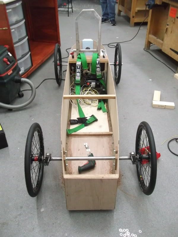

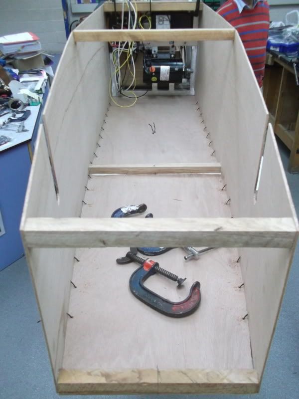

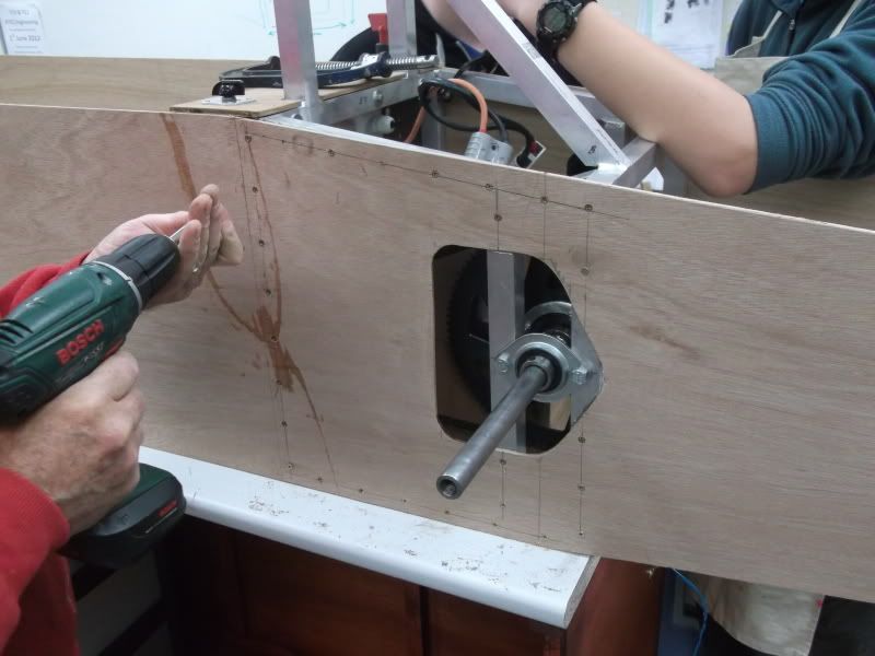

Once a general design had been decided on - semi monocoque construction from 4mm ply, with a framework to the rear supporing the motor and drive train I set to work ordering the components.

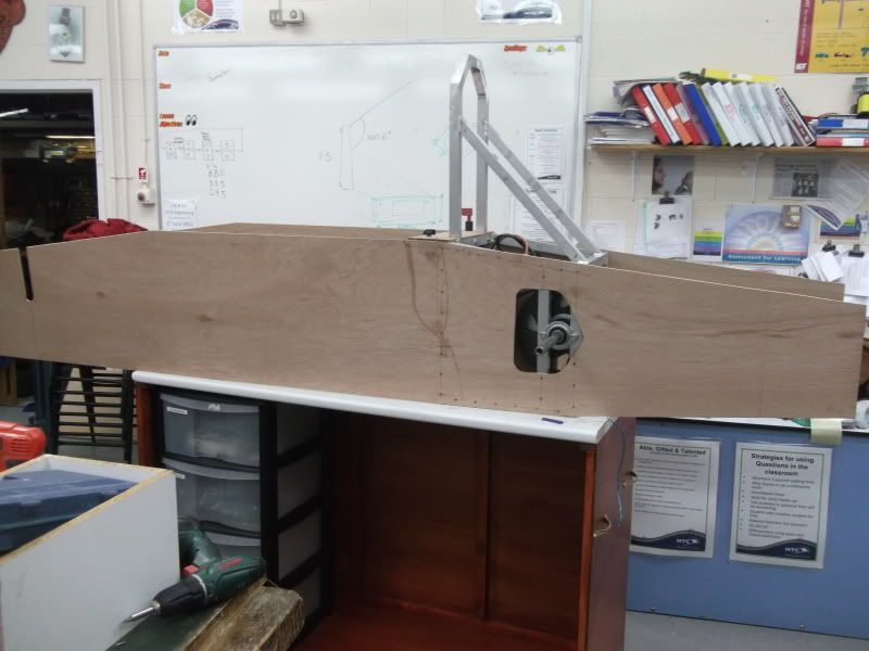

Then the build began.....

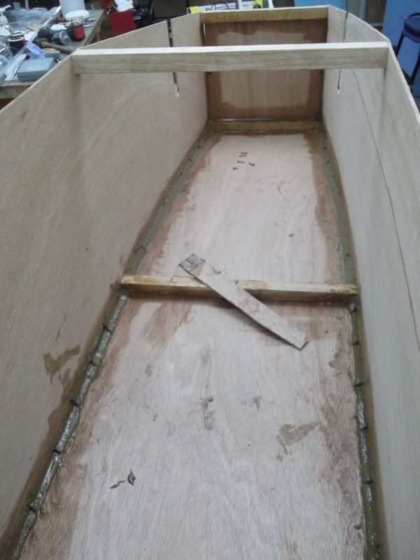

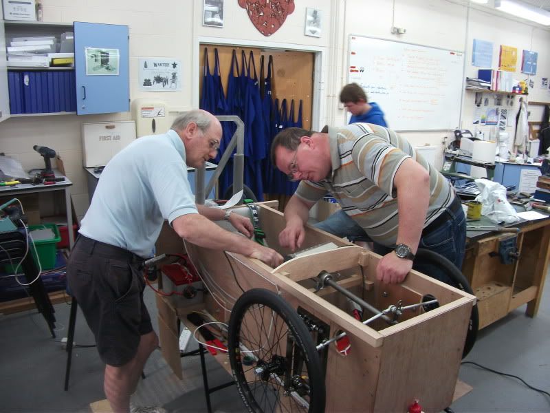

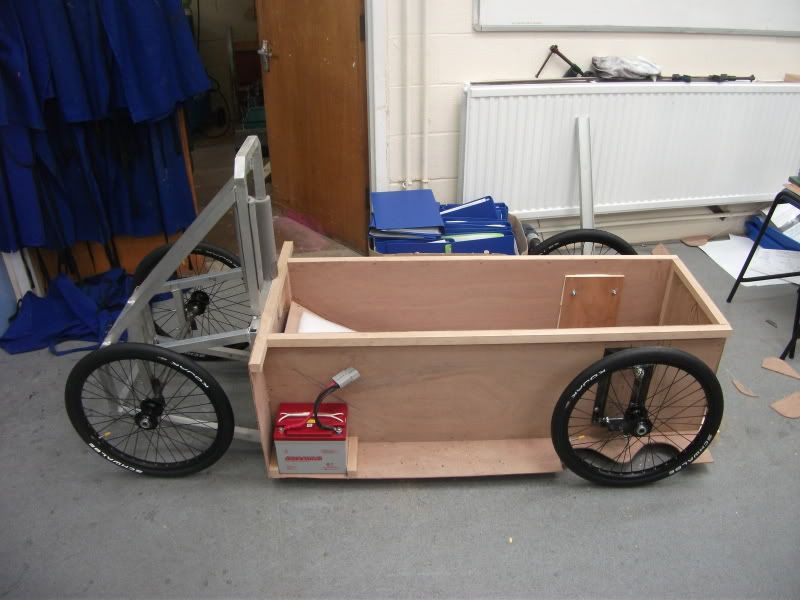

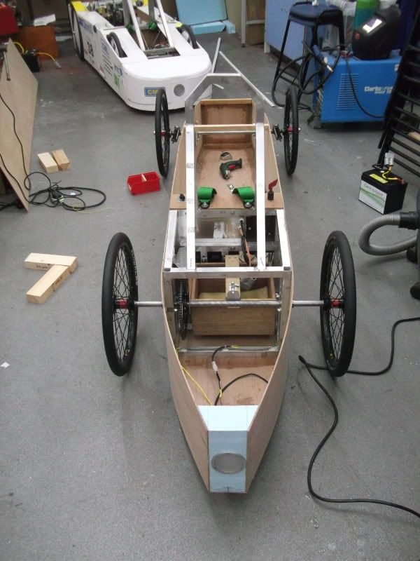

The tub starting to take shape, 4mm marine ply with 25mm square beach strip joining the corners. The four mounting points for the rear subframe can be seen on the rear panel, these from 12mm ply.

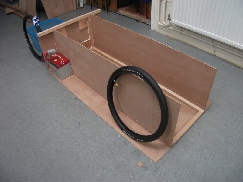

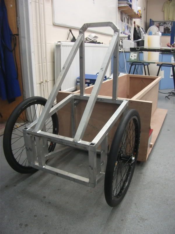

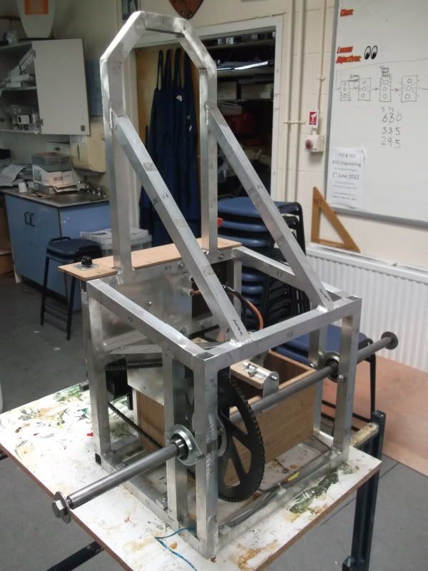

Setting out some of the other components to see the design in real life,

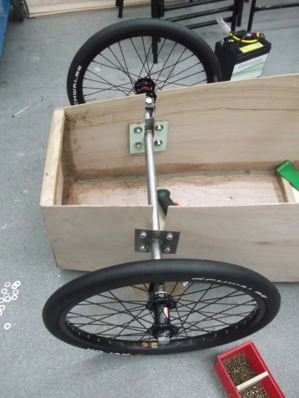

Steeing columb crossmember mocked up,

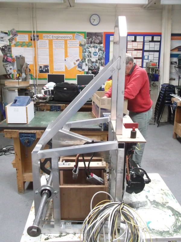

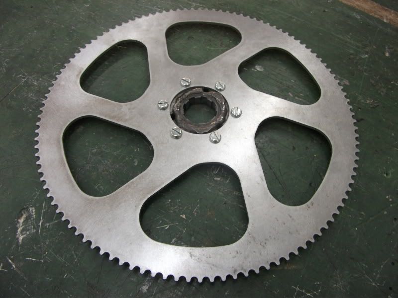

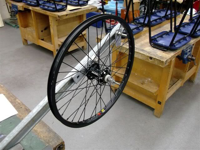

Rear sub fram arrives - built to our design by a friend of one of the other guys.

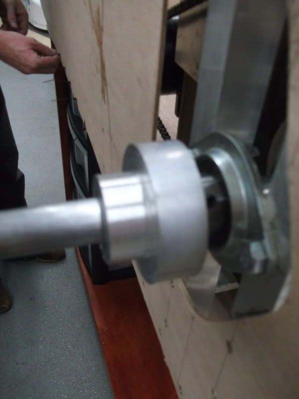

Soon after the axle got mounted,

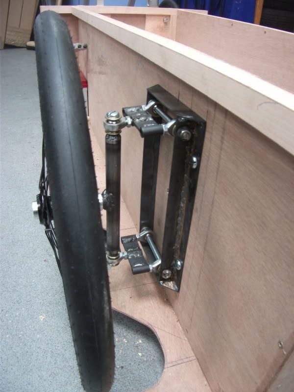

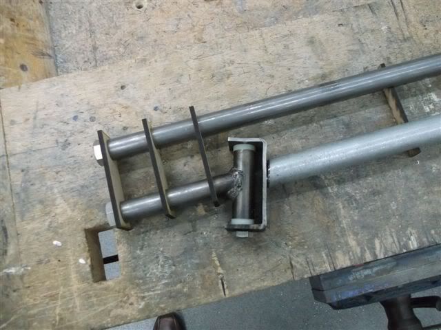

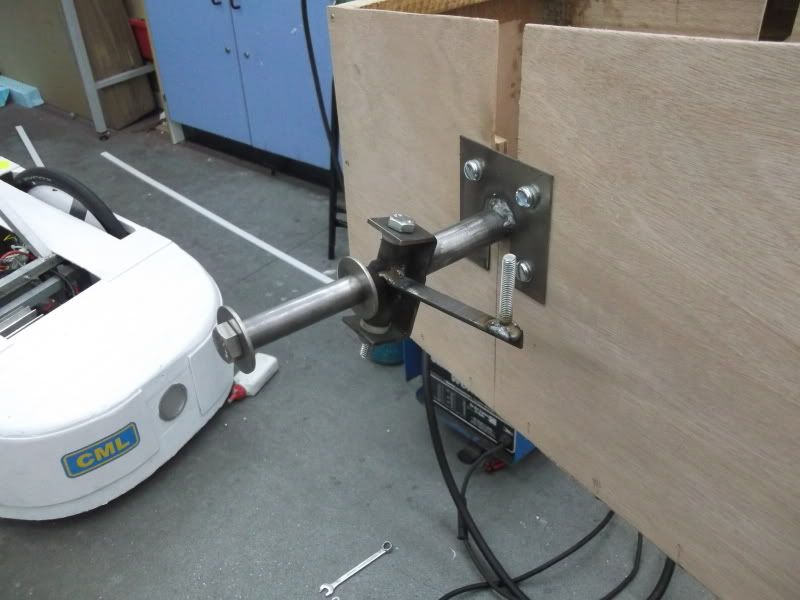

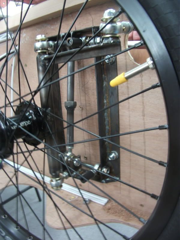

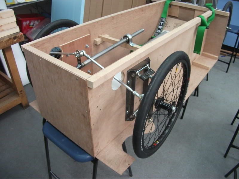

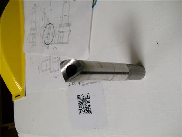

The front end is suspended from a double whishbone type set up, with rigid joints where you might expect to see coilovers. These turnbuckles can be used to adjust the ride height, the rose joints to set camber and then the whole wishbone shimmed forward or back to set castor.
Each of the threaded section on the wishbone was tuned and the thread cut by the students, along with the spacer peices cut from flat bar. I made a jig then (badly) welded the parts together.
Standing on its own four wheels for the first time,

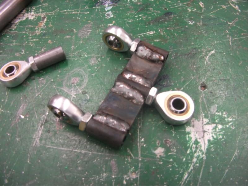

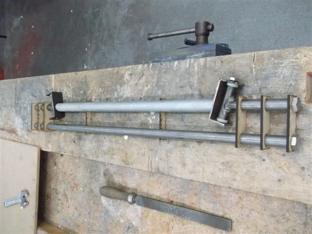

The steering is much like a go cart, but with the bell crank on top of the steering columb, for leg clearance for the driver, and to bring the track rods in front of the axle line, again to aid clearence for the driver.

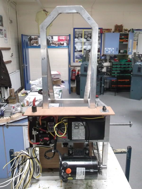

Control wiring going in, and the data logging and instant display computer.
Dennis and Laurence handle the technical stuff, calculations and electrickery. The car has a 4AD speed controller and fixed gearing using 8mm pitch industrial chain. The pinion gears were comercially available parts, the spur gears were laser cut from 4mm steel plate using plot paths that I produced.

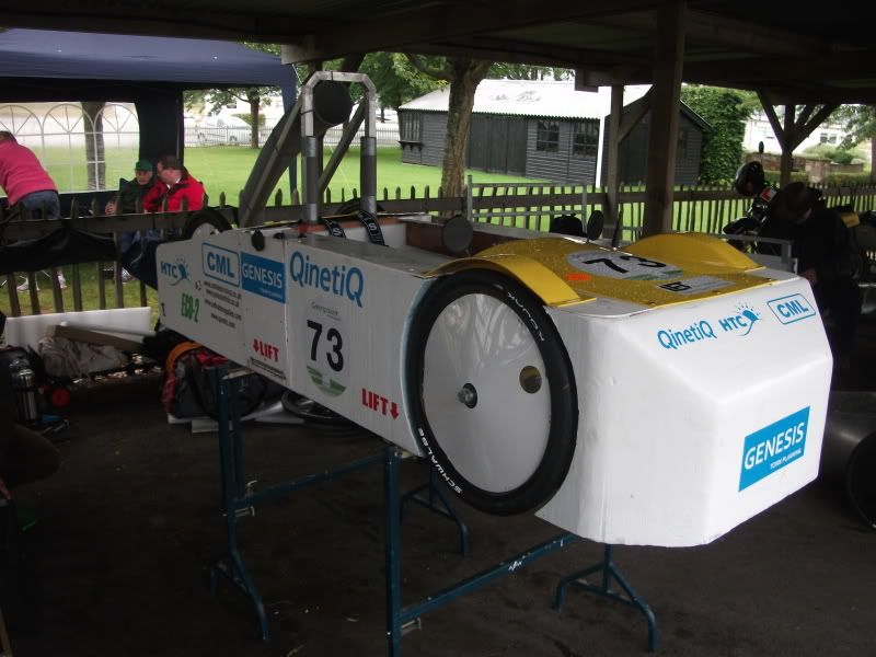

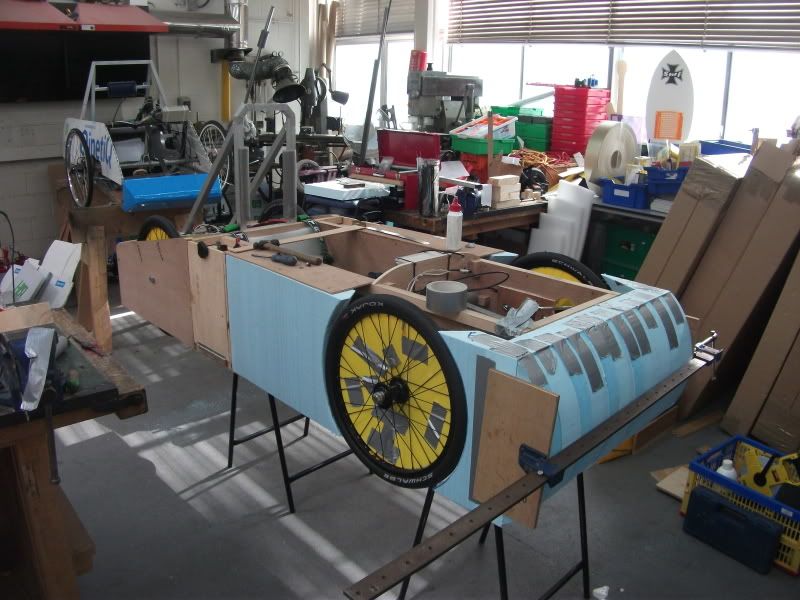

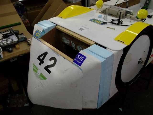

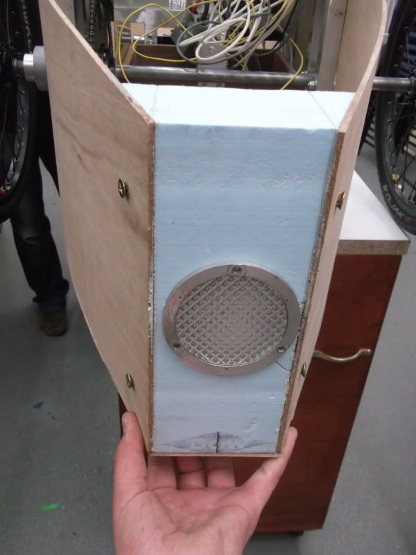

The chassis starts to get filled out using styrofoam and a removable rear section was made to enclose the rear wheels - inspired by the 80's Jaguar Le Mans cars.

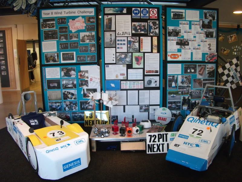

Lots of white emulsion paint get spread arrouind my classroom, some stickers got made and we carted the whole lot down to Goodwood for the regional heat.
The team performed well on raceday, though it has since been calculated that we only used about 2/3 capacity in two of the three sets of batteries. We might have done just enough to qualify for the national final in September.

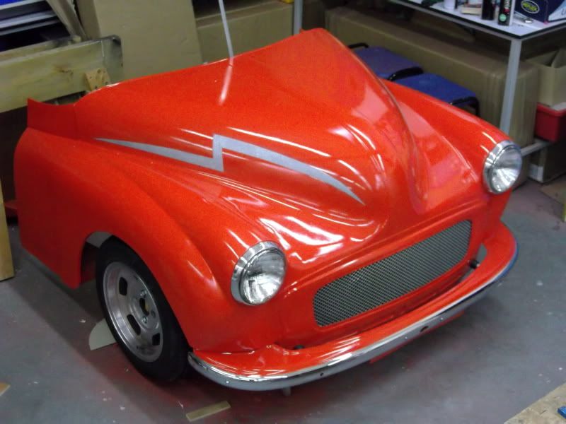

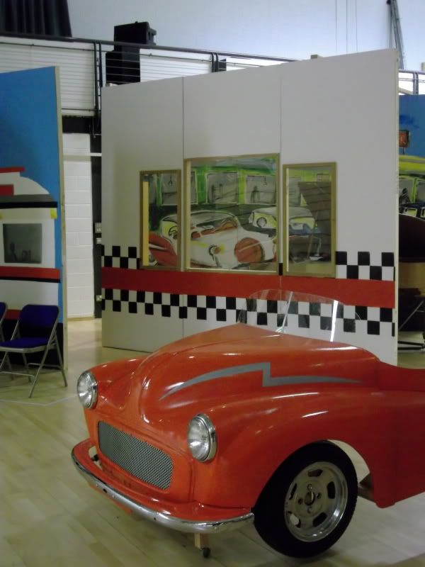

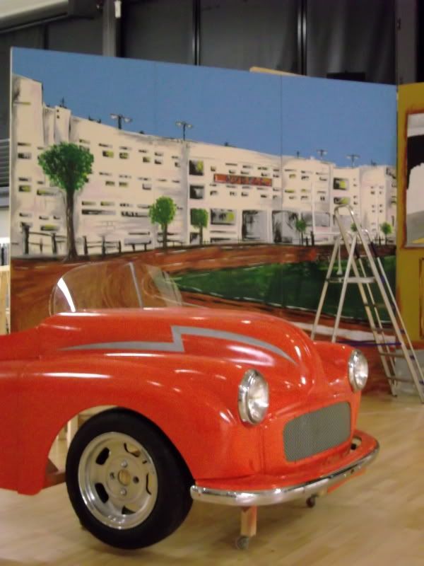

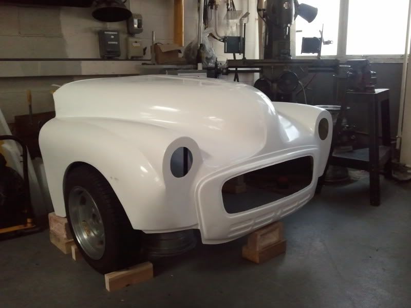

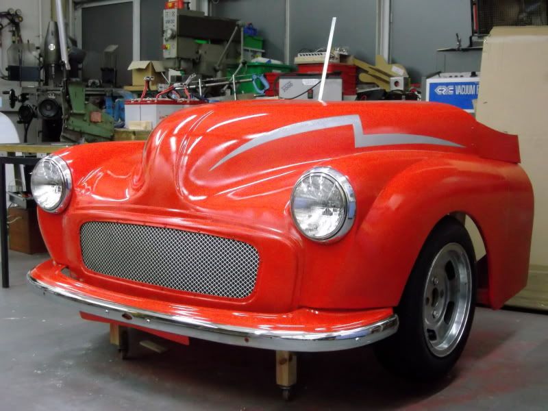

It's the time of year that I get roped into set building again. This year the production is Grease, and I was asked if I'd like to make the front half of a car. Yeah OK. Thoughts along the line of fabricating something from scratch were dismissed when I discovered that a full GRP flip front from Honeybourn mouldings was actually reasonably priced - just under £250, other now fronts had been loads more. I couldn't find a second hand one anywhere.
So one Morris Minor flip front purchased - it is afterall a 2/3 scale 40's yank! and a couple of 5.5 slots and I have the bare bones of the project.
I'll be extending the "doors" with flexible MDF. the whole thing will be mountyed on a frame on castors so that it can be move around the set. Some sort of Duvall style windscreen will be created.
I'll keep the updates comming as more progress is made.
Part 2.

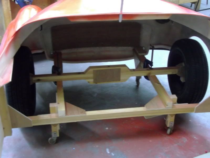

The set centre peice has been coming on. The front is now mounted on a wooden frame and the body extensions have been made, they are not very long but I worked around the material I had - 4mm flexi-ply. It got fitted up with a Minor bumper and headlights, kindly loaned by my dad (yes he does know I've got them).
Some of my Y9 students have had a go at polishing the slots, which haven't come out too bad.
The grill is a peice of DIY store mesh that was in the store, backed with black painted ply to hold it in place.
The windscreen centre post is in position, this will be cut down to the correct length one I have cut the clear acylic for the windscreen.
I did have pics of various stages, but I accedentaly deleted them from my camera ::)
Here it is.....

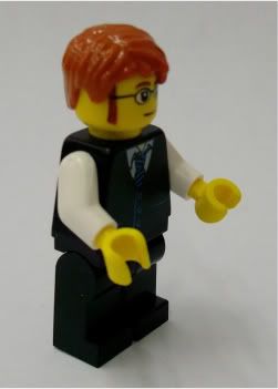

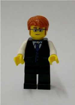

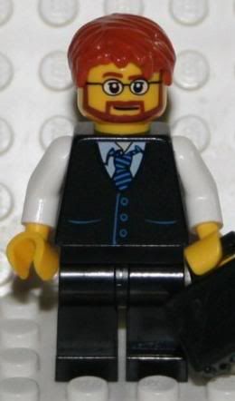

Today I made a Lego me, to accompany another little project I'm working on.
I've not really done a great deal, I started with this chap, who is somewhat hairier than me.....
With a little careful use of Brasso and some gentle scraping with a scalple I have.....
And from the opening post in this thread, this is me....
What a likeness :)

hey some clever stuff there fellas........the only things av made...well was a joint effort with wor lass was me four young lads.....;)
We ended up completing last years (GreenPower F24) final with a car running, in position 37. We were pretty pleased with ourselves, but also a little disappointed, another lap, lost when a driver decided we needed a random extra pit stop in the closing stages probably cost us quite a few places.
So on to 2012....
At the begining of March there was a test day at Goodwood so in preparation for this we began work on prepping and modifying Eco-2.
It seems our drivers have got taller since last year, the first job was to extend the body tub by 200mm, so we didn't have to chop their feet off.
The gearing was also altered and special ceramic bearings installed, that apparently have 30% lower resistance.
At the test day the cars performance was very promising. If it had run as well in the 2011 final we would have been in the top 20.

We have been discussing ideas for the car for a while, but obviously it was time to get something down on paper. I produced some drawings over the weekend and yesterday afternoon a couple of the team and I cobbled together a 1/10 model of what will become Eco-3.
It's going to be constructed in a similar fashion to Eco-2 but will be an open wheeled design, reducing frontal area, and will have the plywood tub formed into a more aerodynamic shape.
More as the materials arrive and the build starts....

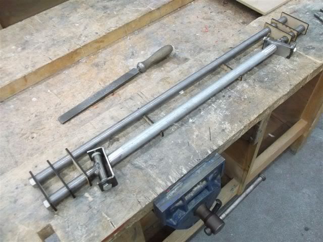

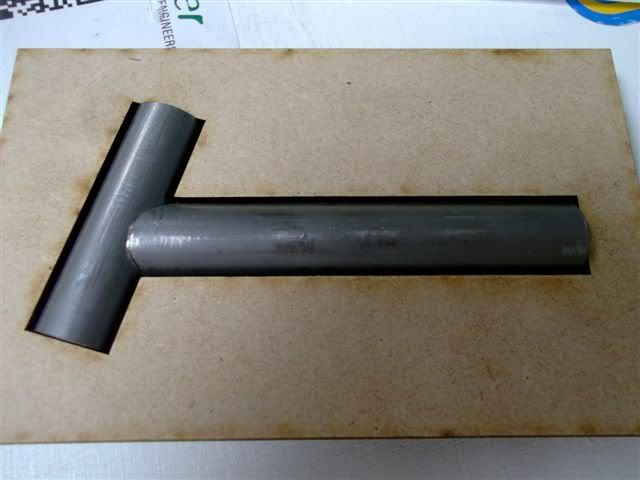

One of the lads fish-mouthed the stub axles, Dennis and I set up the mill with a 20mm end cutter, then a student did the machining.
Which then got turned down to size and the bore taking out to 12mm (for an M14 thread), so that they would fit in the jig which holds them at the correct angle for welding to the king pin tubes.
These were tacked and then popped out for the rest of the welding. The jig is four layers of 4mm thick MDF cut on the laser cutter.
A tool which also came in handy jigging up the rest of the front axle. The rear axle acts as a backbone, with the stub axles located parallel with MDF cut outs slotted over the ends, and bolted through the wheel bolt holes. The front axle tube sits in half height saddle pieces to keep it parallel to the rear axle. The U brackets are bolted through the kingpin tubes to keep them in the correct position.
Again, these were tacked in place and then stripped down to weld up properly. No close up pics, it's not pretty.

Wheel truer knocked up for the job.
Next up will be the tub - but that will have to wait 'till Wednesday. The subframe should be assembled by then with the motor mounted and rear axle in position.
Subframe arrived with Dennis over the weekend, so he got that fitted up with the electrickery, and drive train.
The mounting boss for the freewheel needed welding to the axle so it was all stripped down for that. While the axle was getting dismantled I got on with cutting out the body tub parts.
Here's one side bing fitted, epoxy adhesive and lots of screws...
Once both sides were on the base was cut to shape,
Then stitched together with cable ties, ready for a fillet of epoxy adhesive/filler to be applied,
The rear tapers in to where the brake light is mounted,
One of the lads also got on with machining the disk brake mounting boss',
They will be drilled and fitted to the axle with roll pins.
I'm heading back in in the morning to fit the front axle and steering. Then all the kids are back in again on friday for finishing off and practice for race day. It'll be tight for getting it up and running!
We got a bit more done this morning. Not as much as I'd hoped, but I slowed us down a bit first thing by knocking the argoshield bottle over and smashing the gauge on the regulator. A fair bit of gas escaped, but fortunately the bottle was fairly full. Once one of the guys had been out to get a new regulator we were back in action again.
The front axle was clamped in position with the load spreading mounting plates and tacked in place, before removal for welding fully.
I also attached the steering arms to the kingpin tubes, another mdf template cut on the laser cutter got them positioned correctly.
Finally the car was able to stand on it's own four wheels for the first time.
