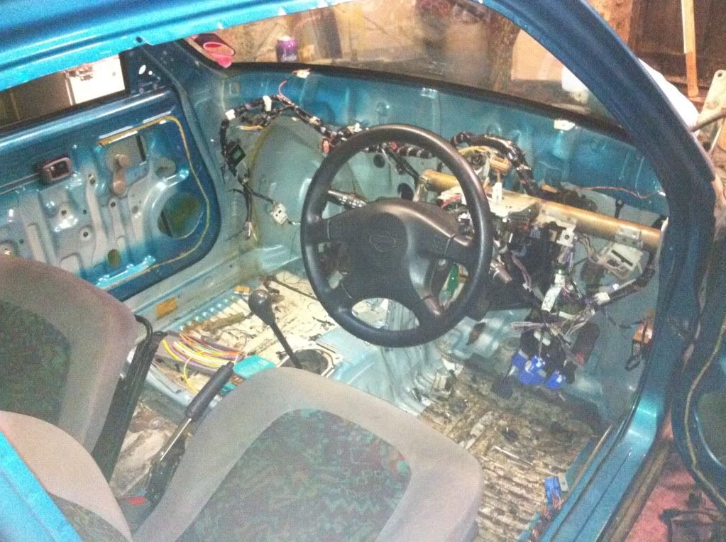

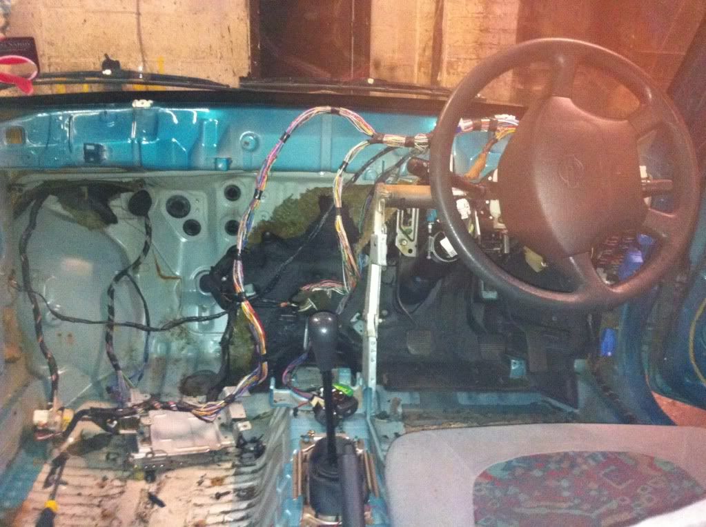

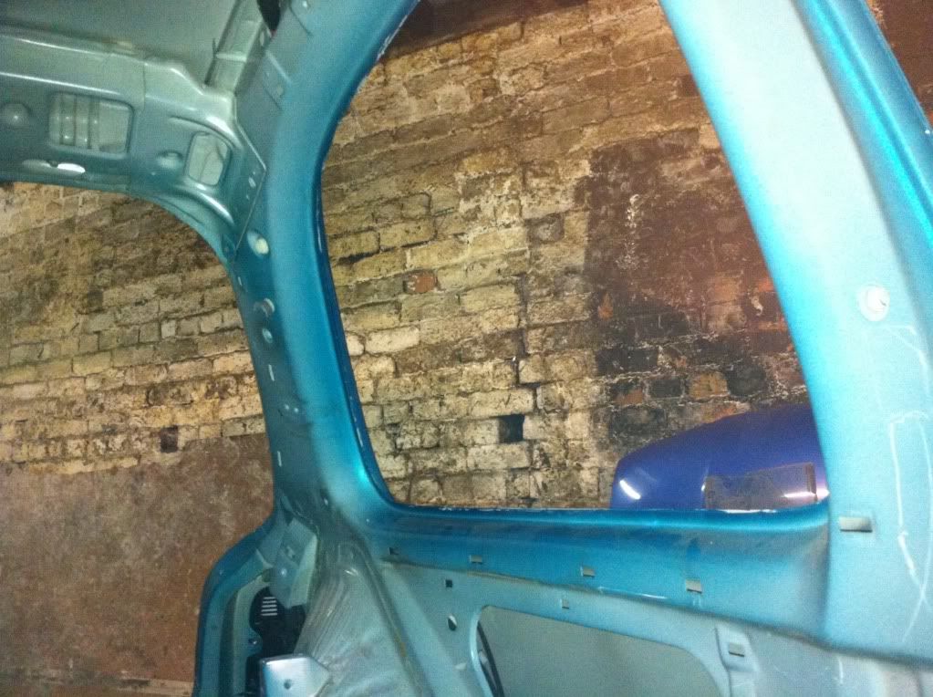

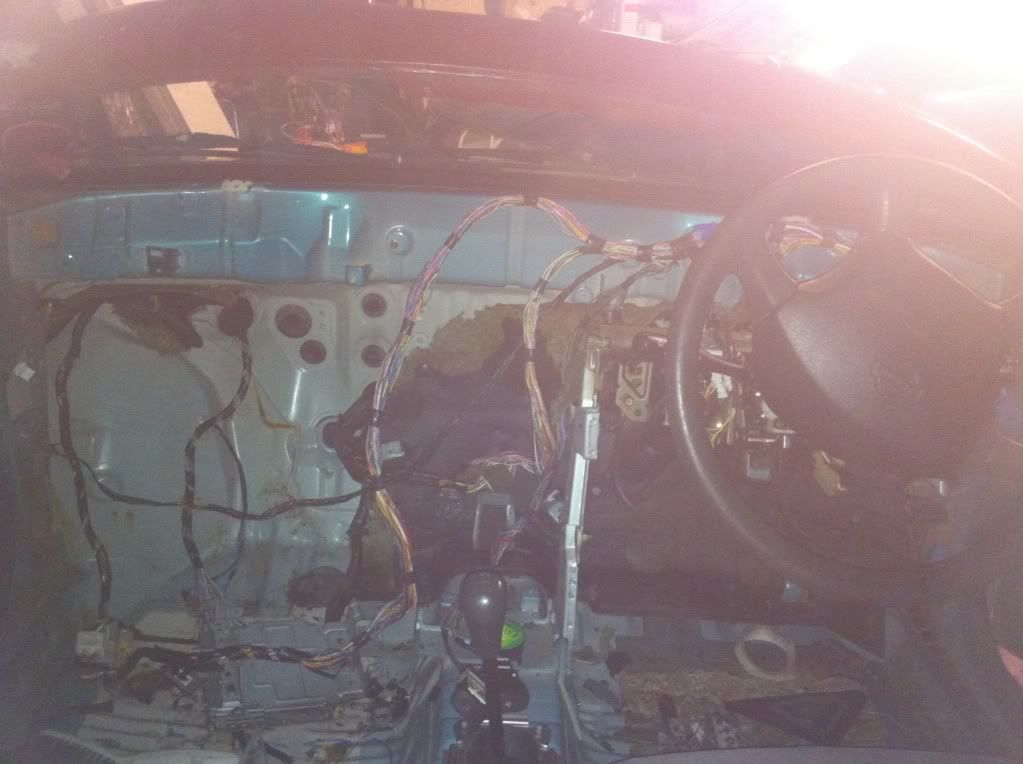

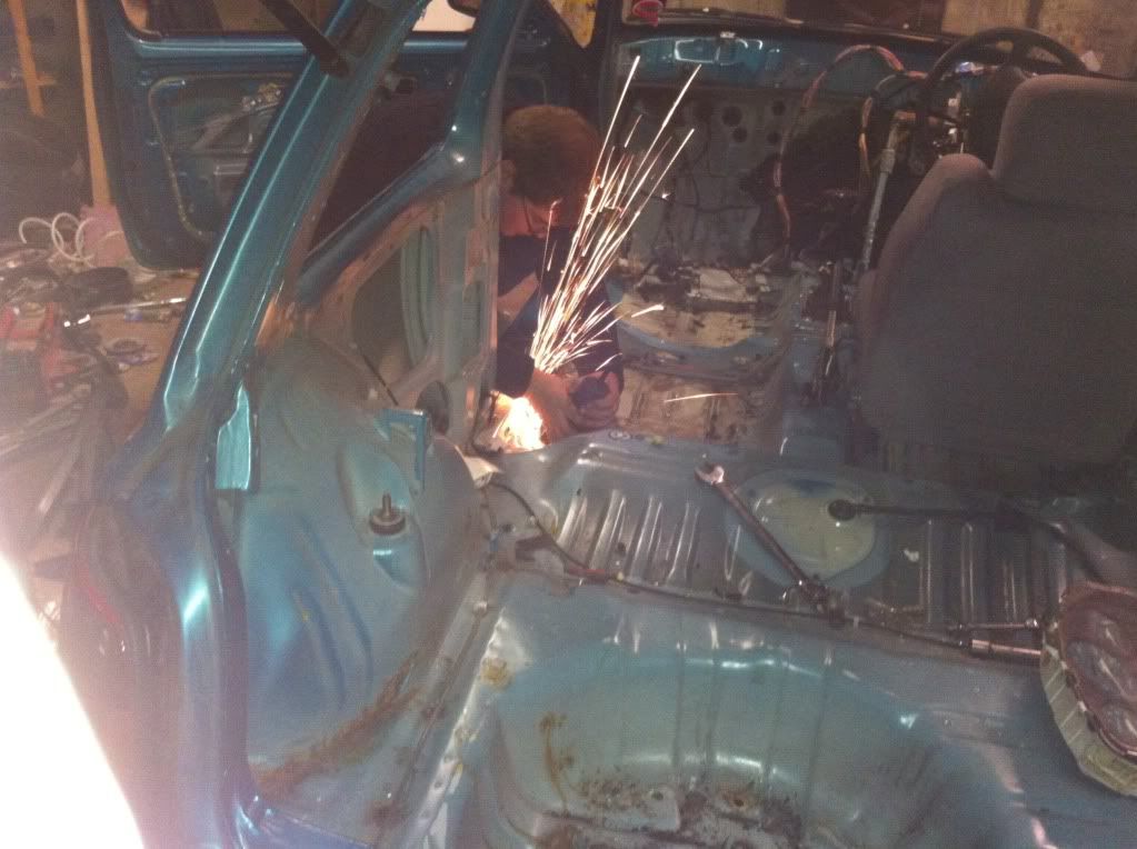

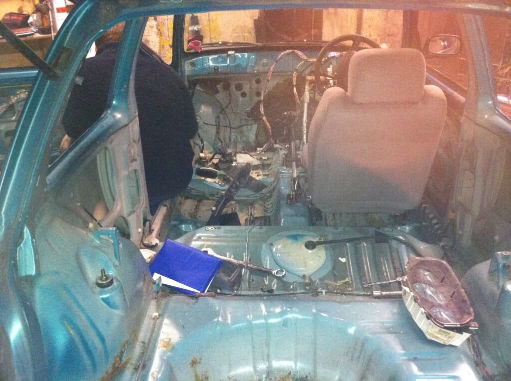

So far we have removed the whole interior. Seats, carpets, headliner etc.

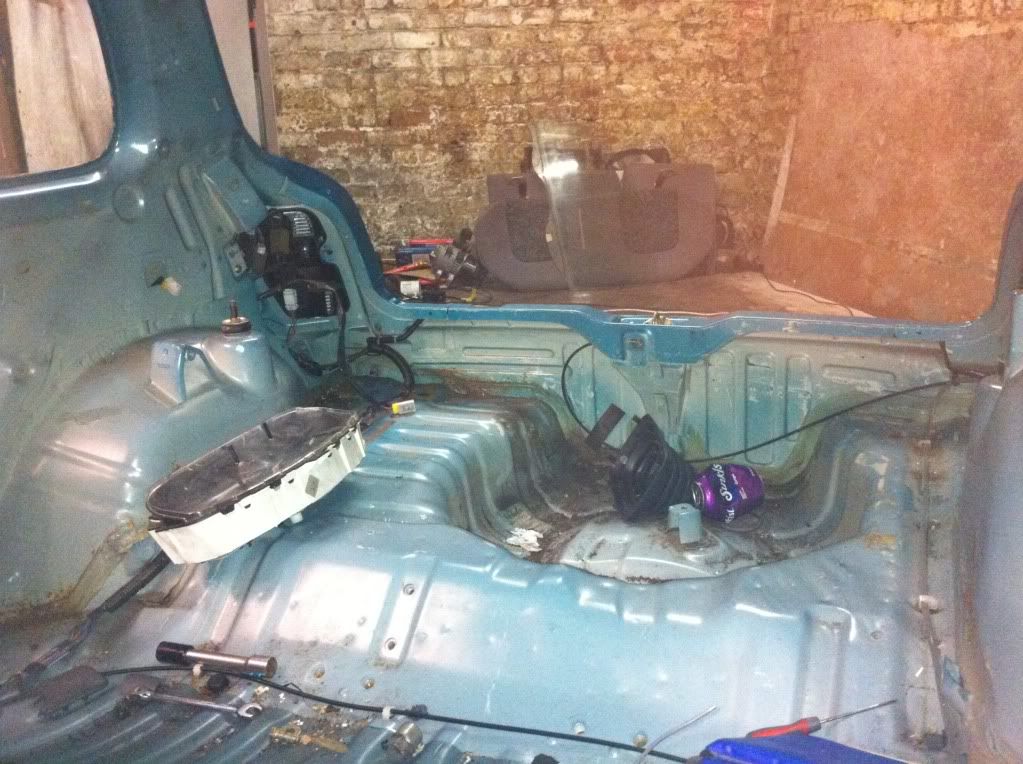

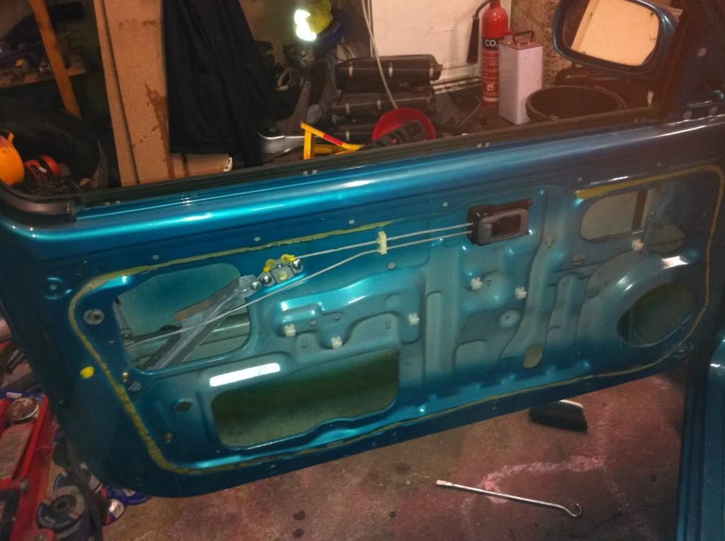

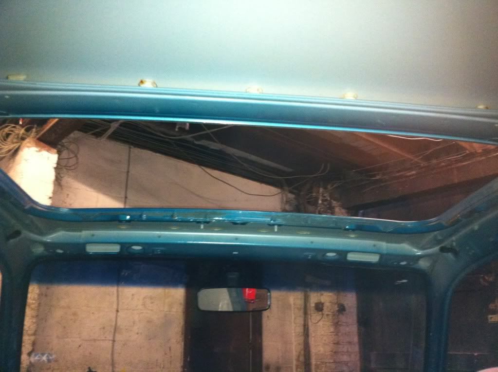

We have also removed rear windows and sunroof which will be replaced with plastic windows. The front electric windows have now been changed for manual ones to save weight. All sound deadening in the car has been ripped out for weight saving. All the dashboard and heaters etc has been removed. and alot of wires that arent needed have been removed.

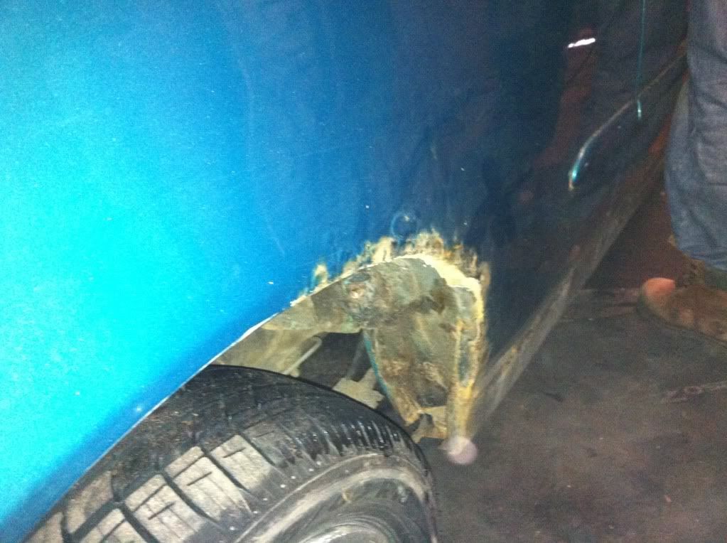

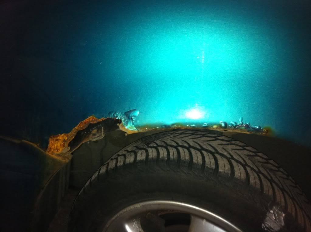

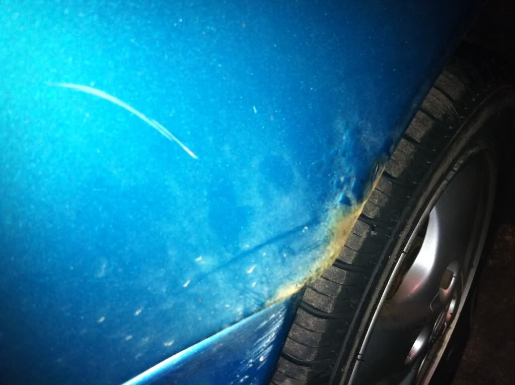

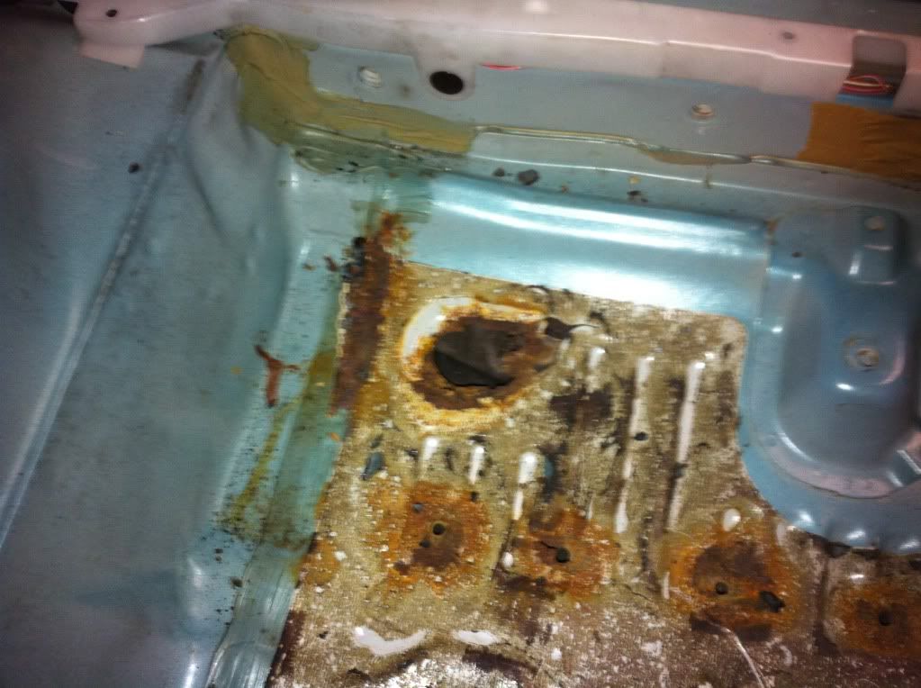

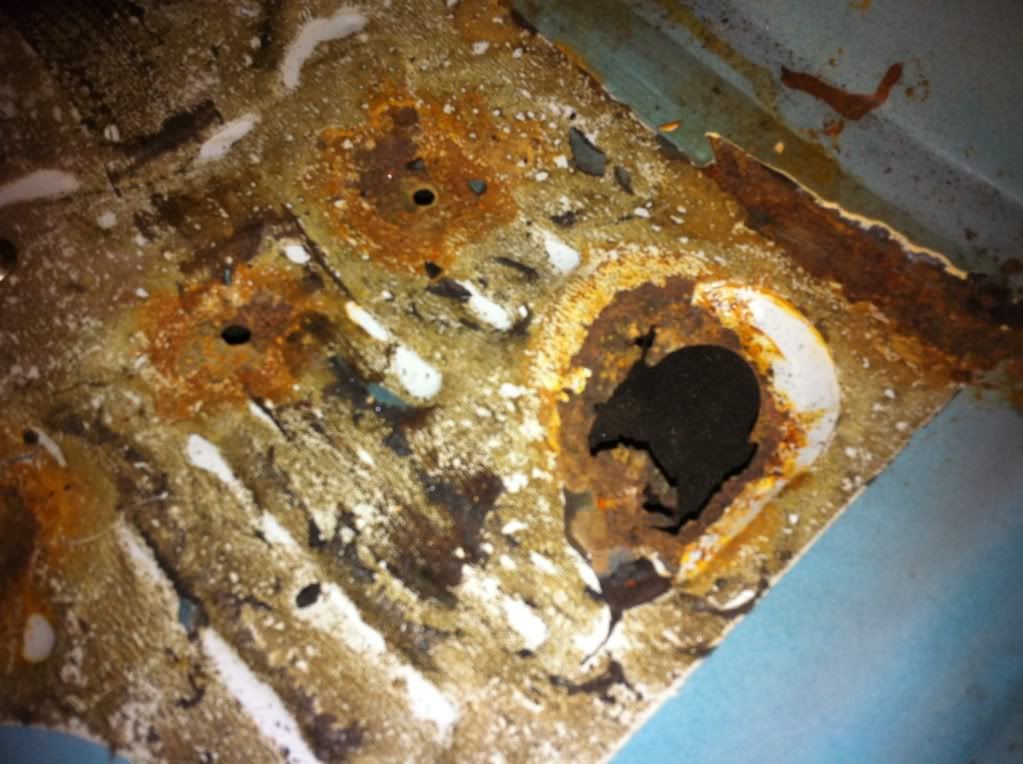

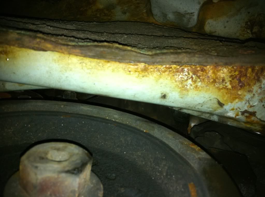

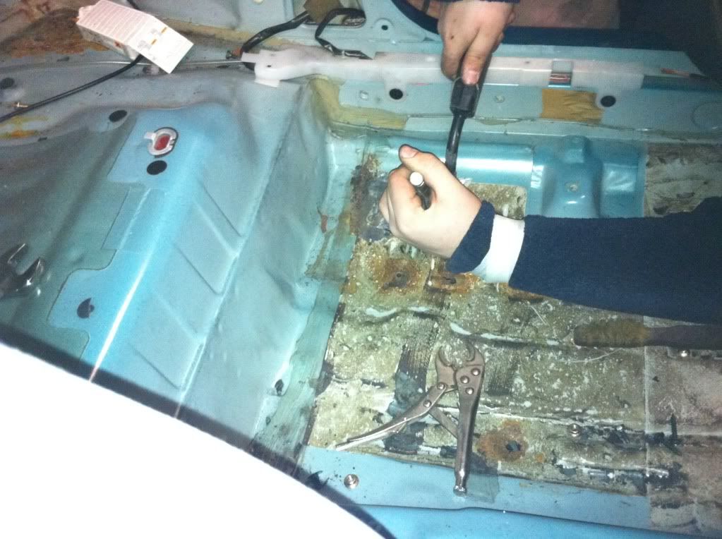

Along the way, alot of rust has been found on the floorpan, inner arches, outer arches and the front crossmember (main causes of MOT failure)

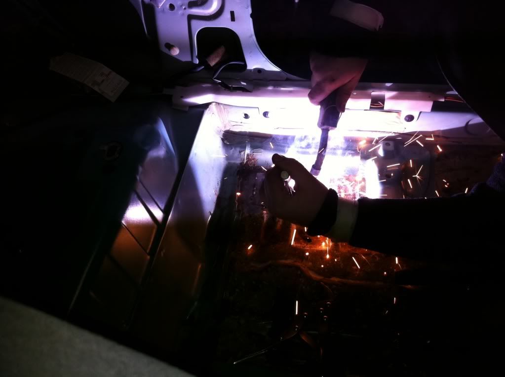

So we started on removing that :

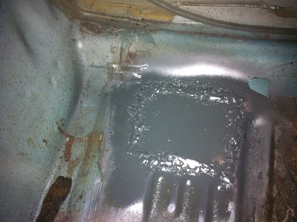

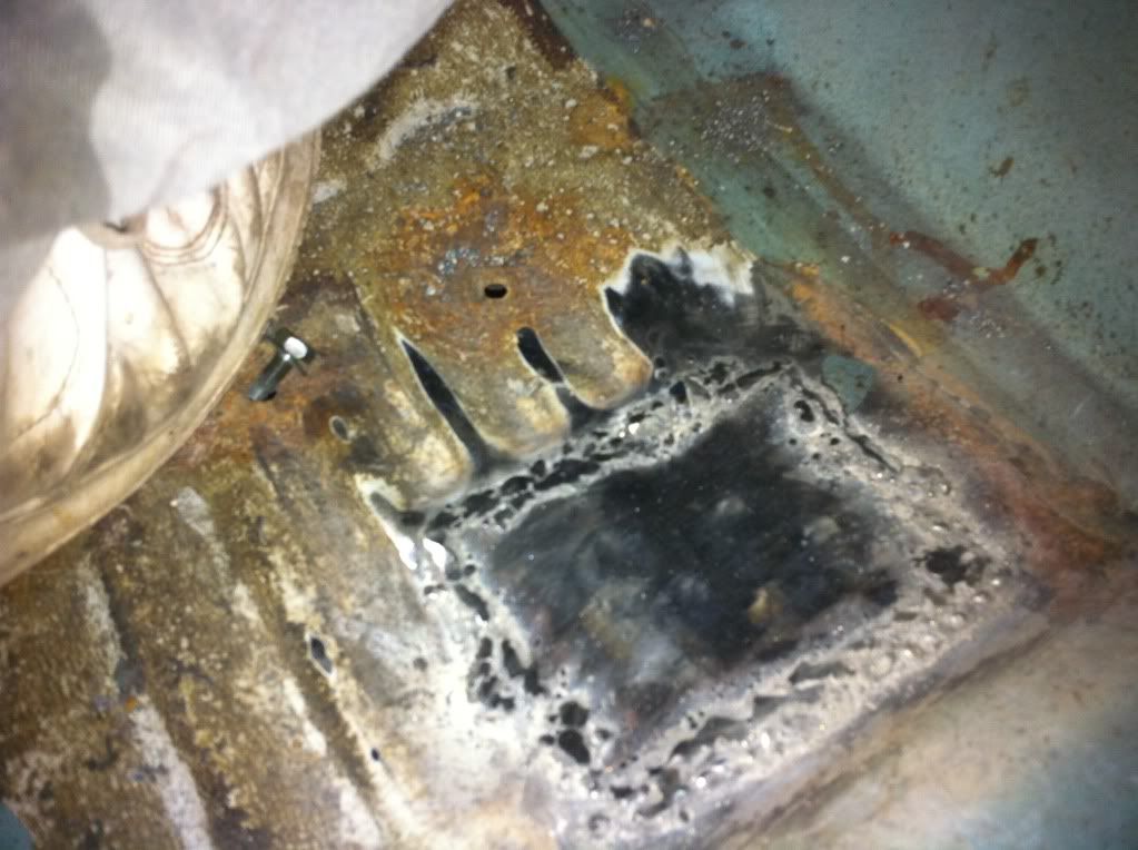

Hole on floor pan cut, welded and coated in zinc primer!
Still alot more welding and rust removal still to go.

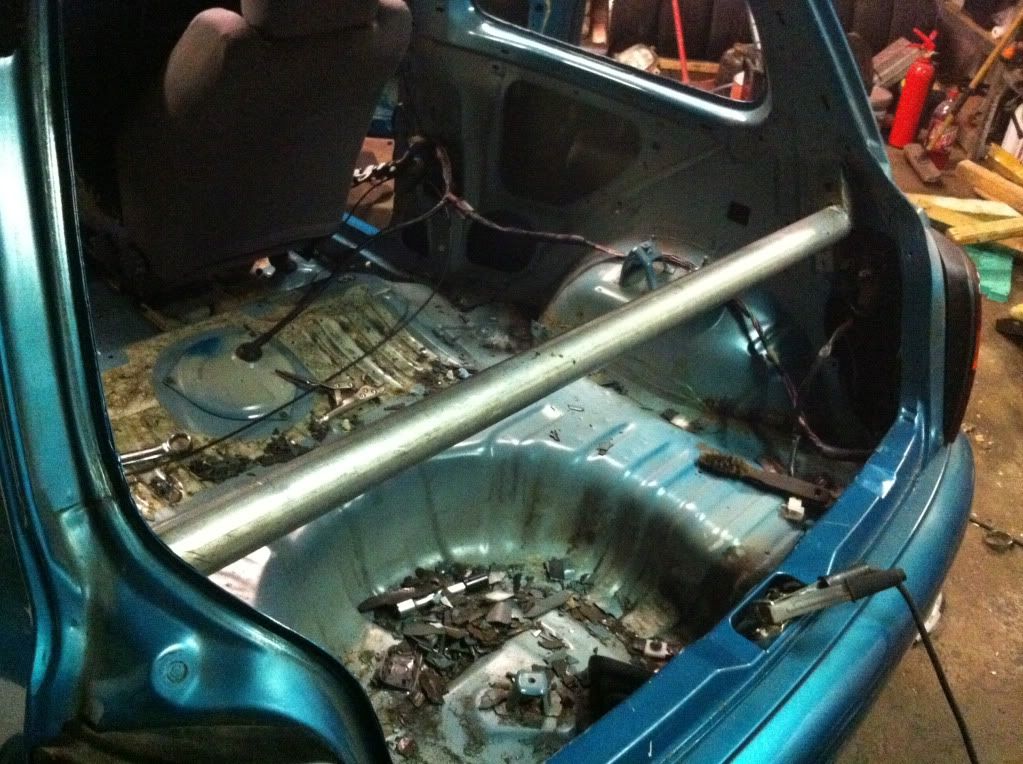

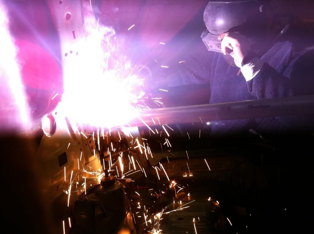

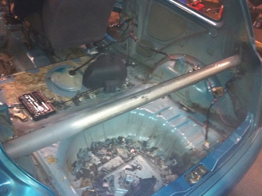

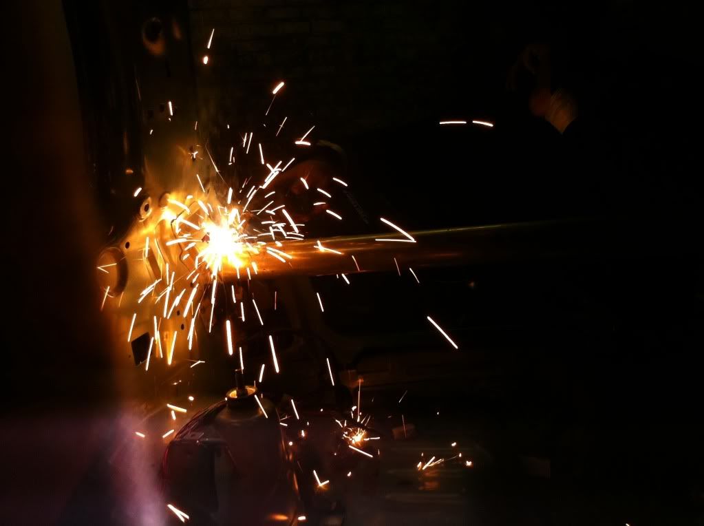

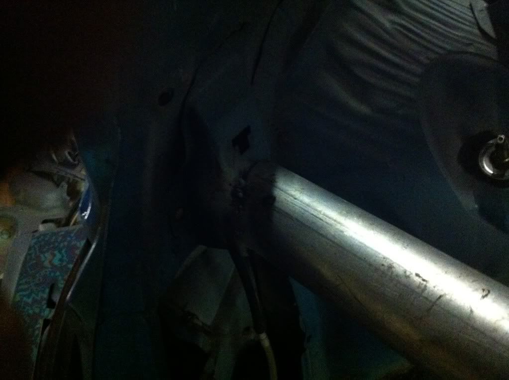

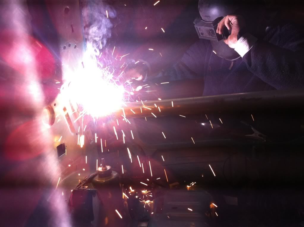

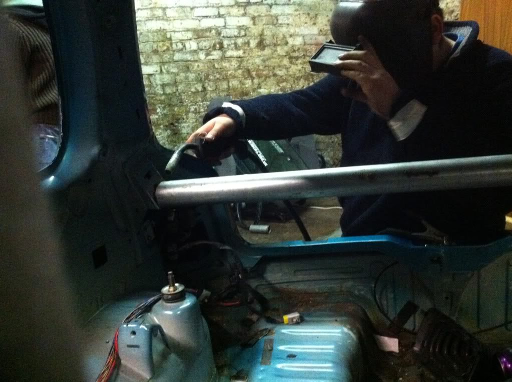

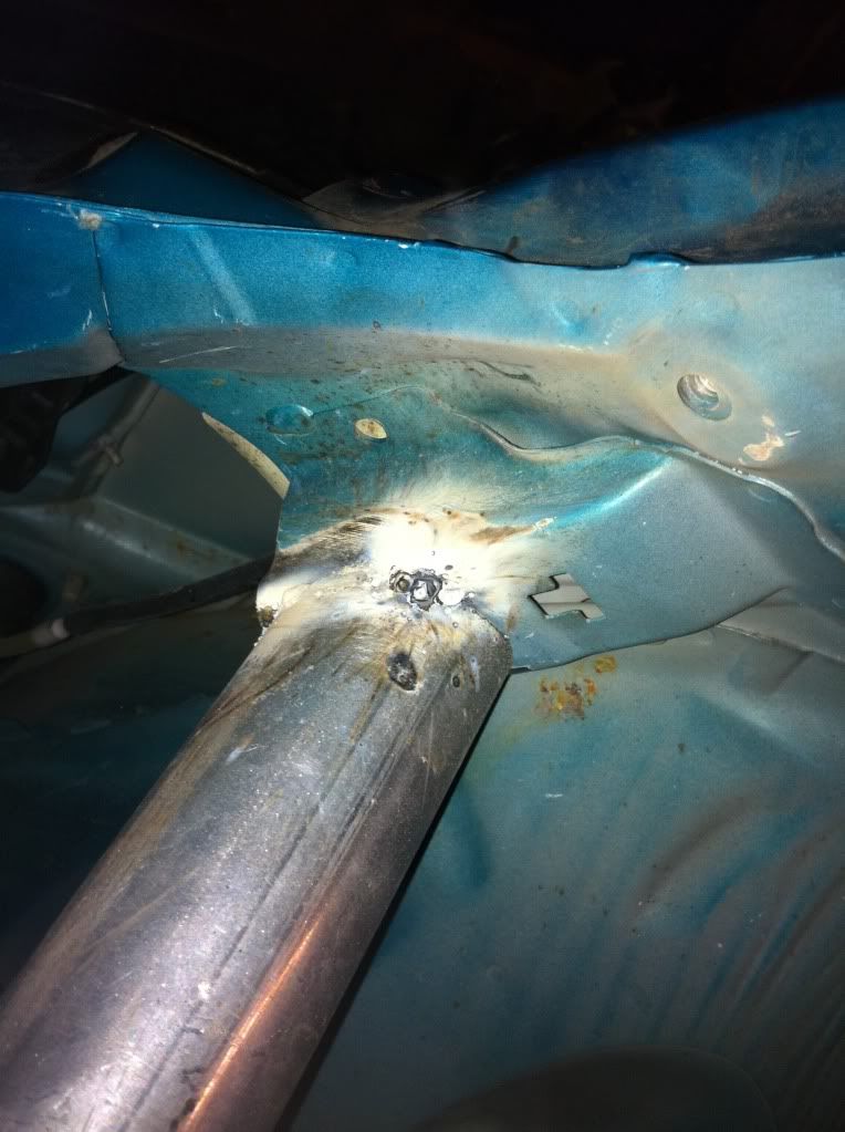

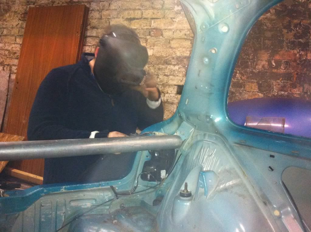

We then started on extra chassis bracing. With some spare 2" exhaust pole lying around a welder we started on the rear.
The rear seatbelt brackets has had the pole welded between them and we will probably just fabricate our own rollcage kinda thing.

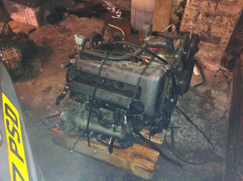

And also the SR20 has been paid for and courier paid so it should be with us soon and then the real fun begins.

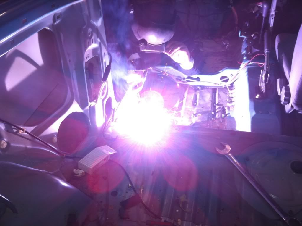

Just as an aside, I'd turn the voltage on the MIG welder up a smidge, the welds look a bit patchy :). Fantastic project by the way.
Probably not. Dont particularly want to be taking massive chunks from the chassis and the welder we have is pretty sh#te.
With the SR20, we hope to have it running down at 600kg or thereabouts so it will be about 270hp / Ton. Which will be alot of fun.
Its a cheap welder so were not expecting amazing result lol but thanks for the advice (Y)
Looking awesome quite a similar colour to mine :D So what's happening with all the parts you have taken out like the leccy windows?
the welder only has two power settings, 75 and 90amps. those welds were at 75amps
its quite terrible tbh lol.

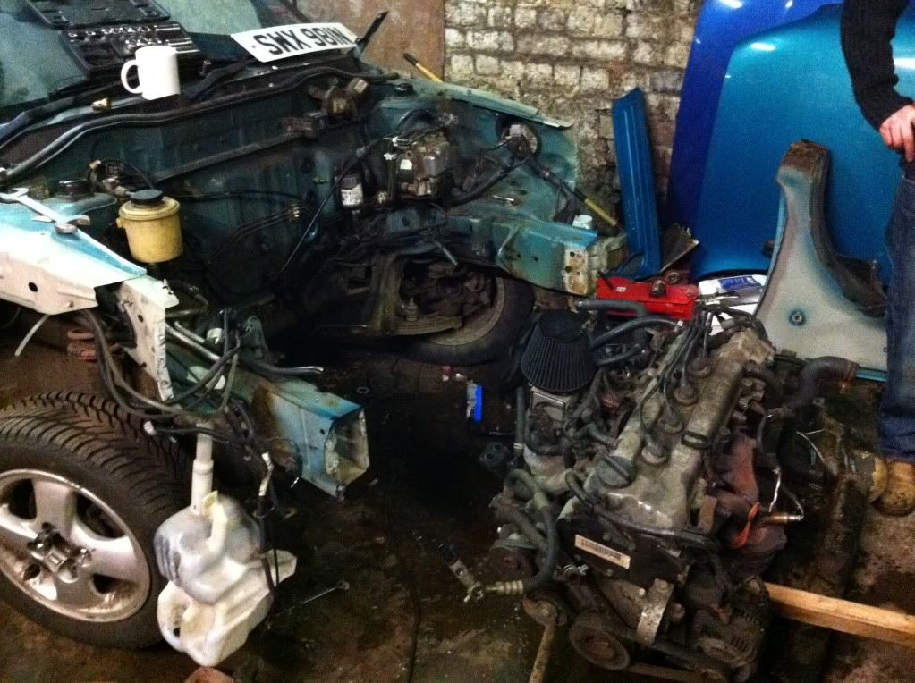

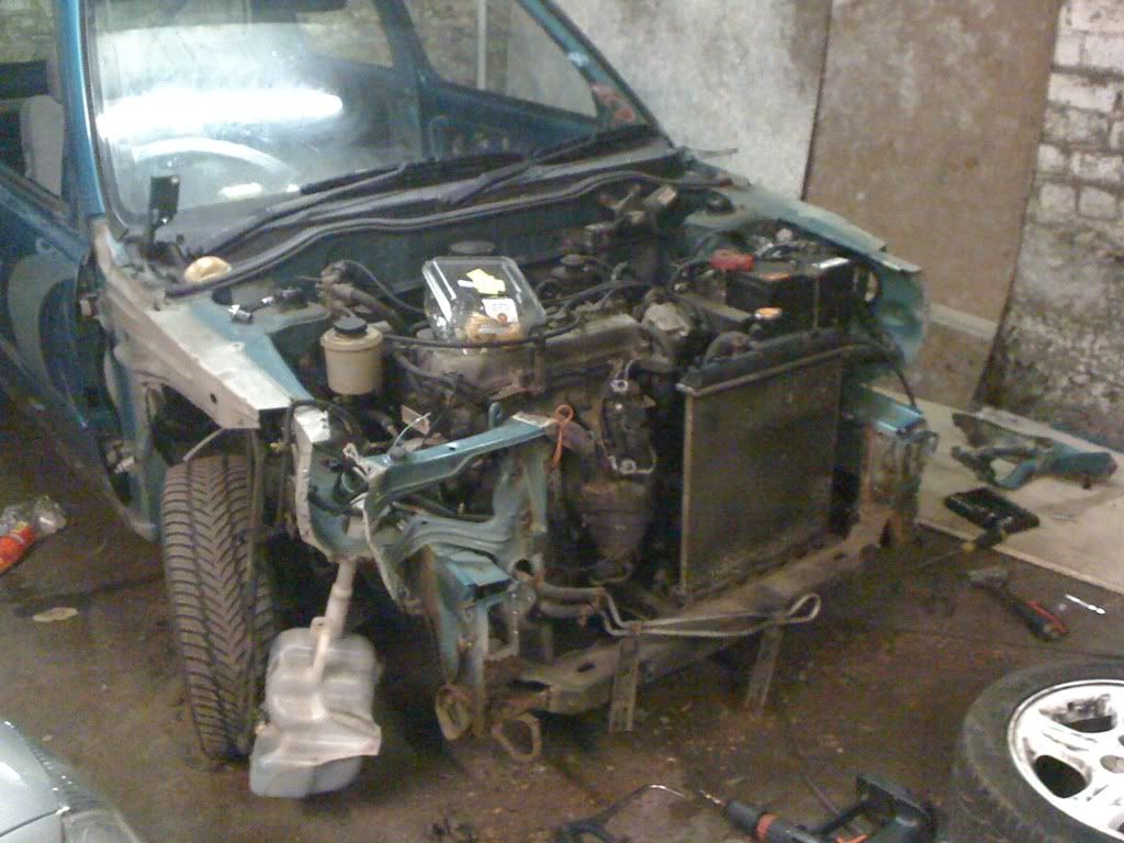

Front crossmember getting taken off so a new, non-rusty one can be fitted (Y)
Bit of a setback.
Engine was all ready for collection, courier came to pick it up...
Driver apparently said " aw its bigger than i thought it would be" and ######ed off.
An email to paisley freight and the reason was...it was leaking oil and there was nothing there to lift it onto the truck with. Which is a load of rubbish as the engine was drained of all oil and there was a forklift present....

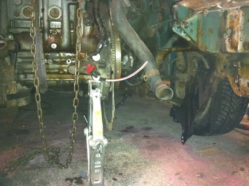

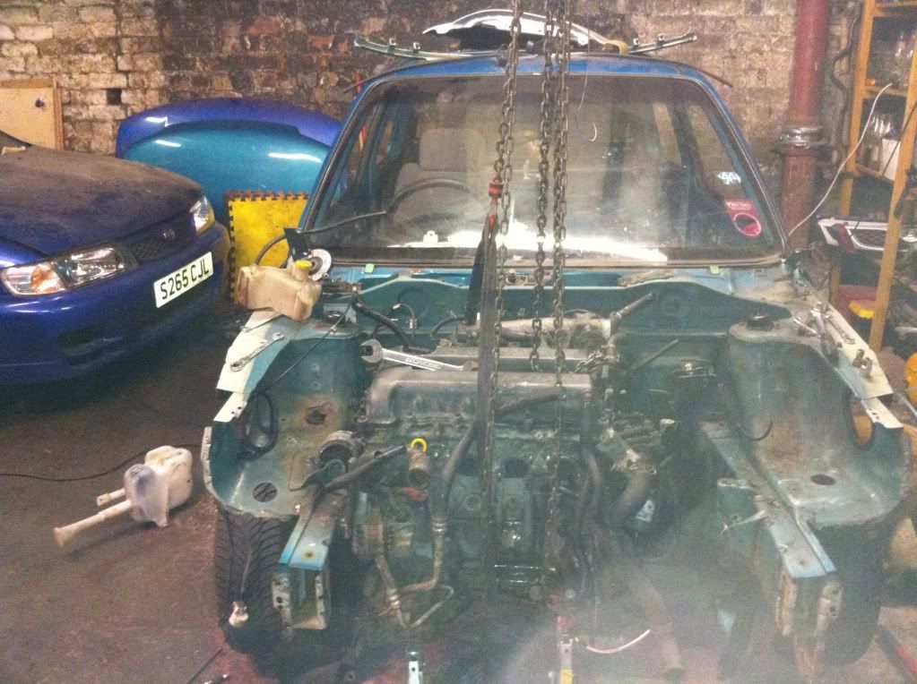

A productive day i would say :)

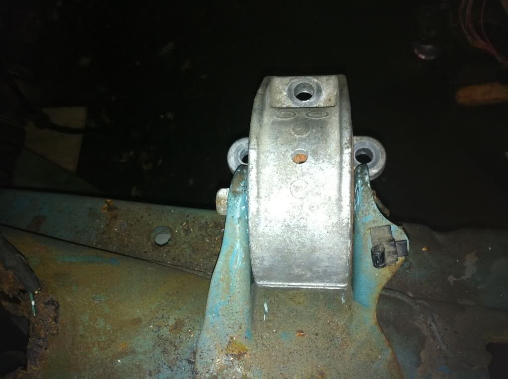

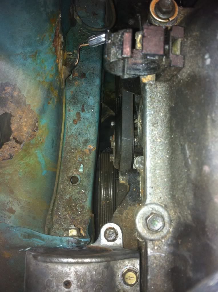

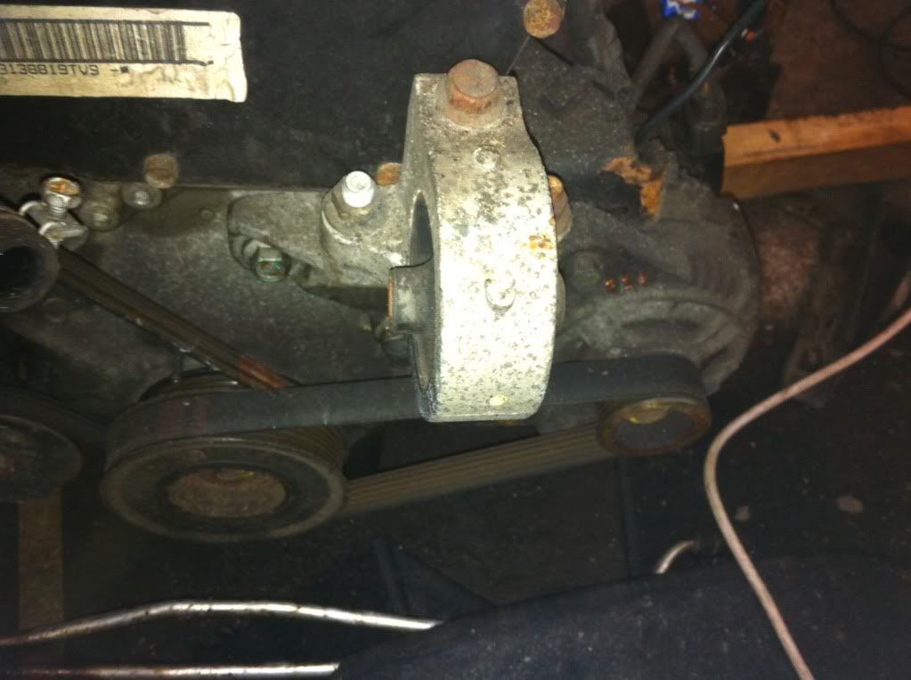

So we started off with an Almera GTi driver side engine mount, which was then grinded down so it would fit into the current space of the micra mount.
As you can see the Almera mount is alot bigger than the Micra one.

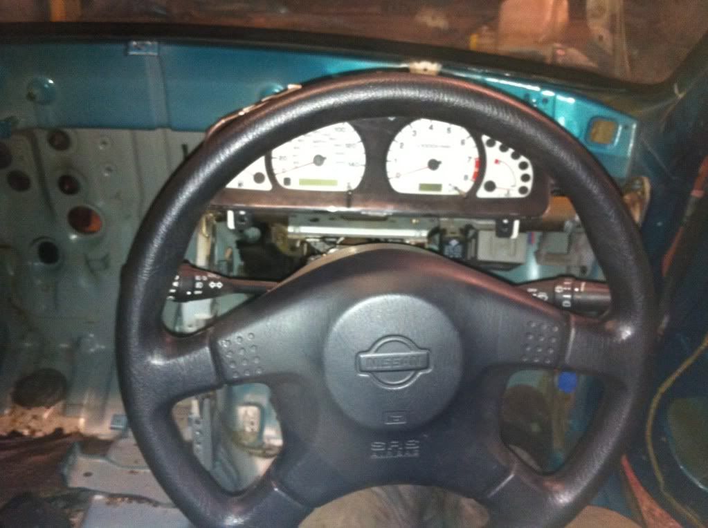

After that was done, the micra steering wheel and indicators were replaced with ones from an Almera, along with some GTi clocks.

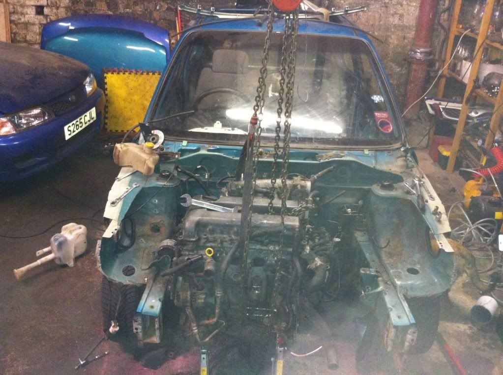

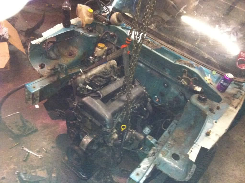

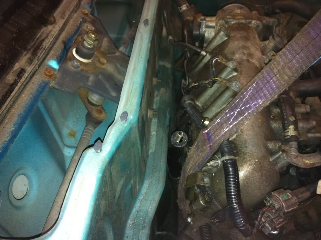

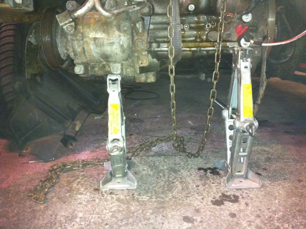

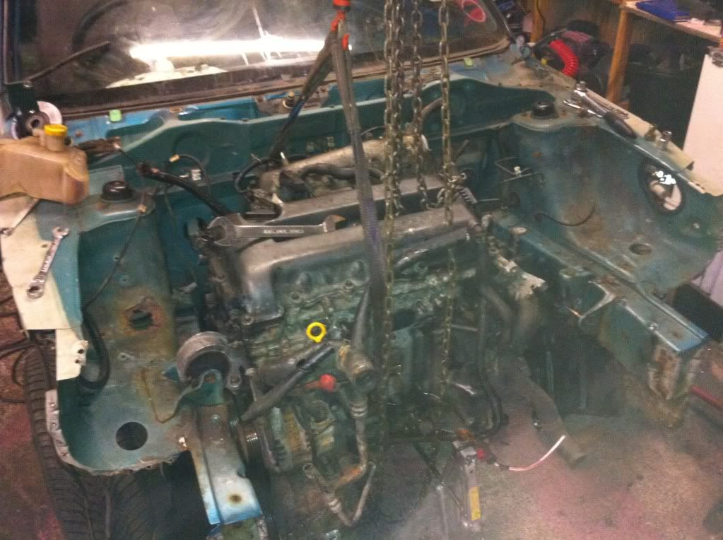

Then the fun began, The engine pallet was pushed into the engine bay just to get it out of the way but then was lifted up into place and bolted onto the car (Y)
It was then jacked up into the right height.

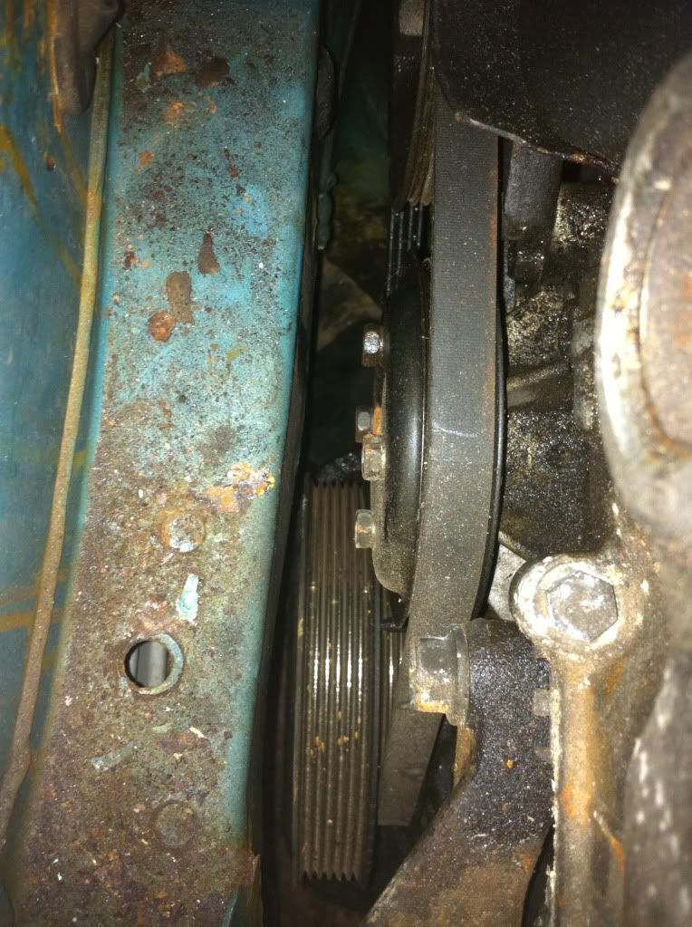

Its a veerrryyy tight fit on the drivers side with all the pullys, maybe a bit of hammering should get some more clearence.
And clearence of the plenum,

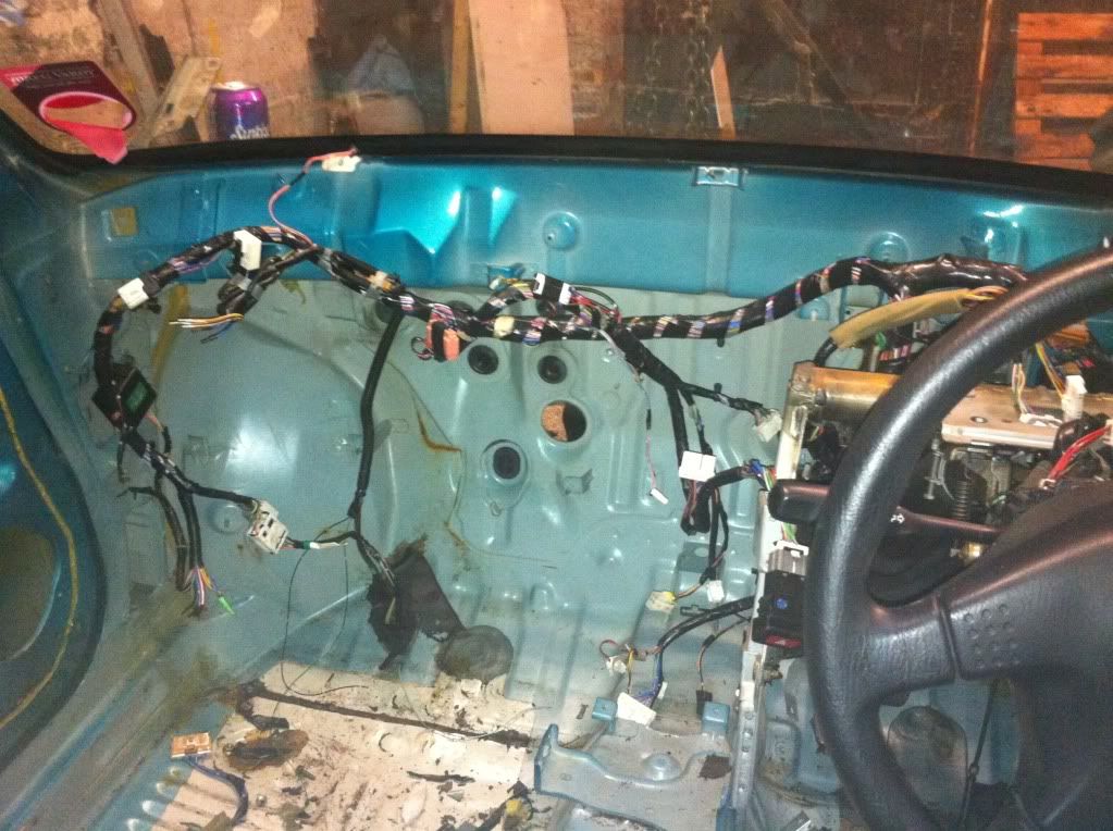

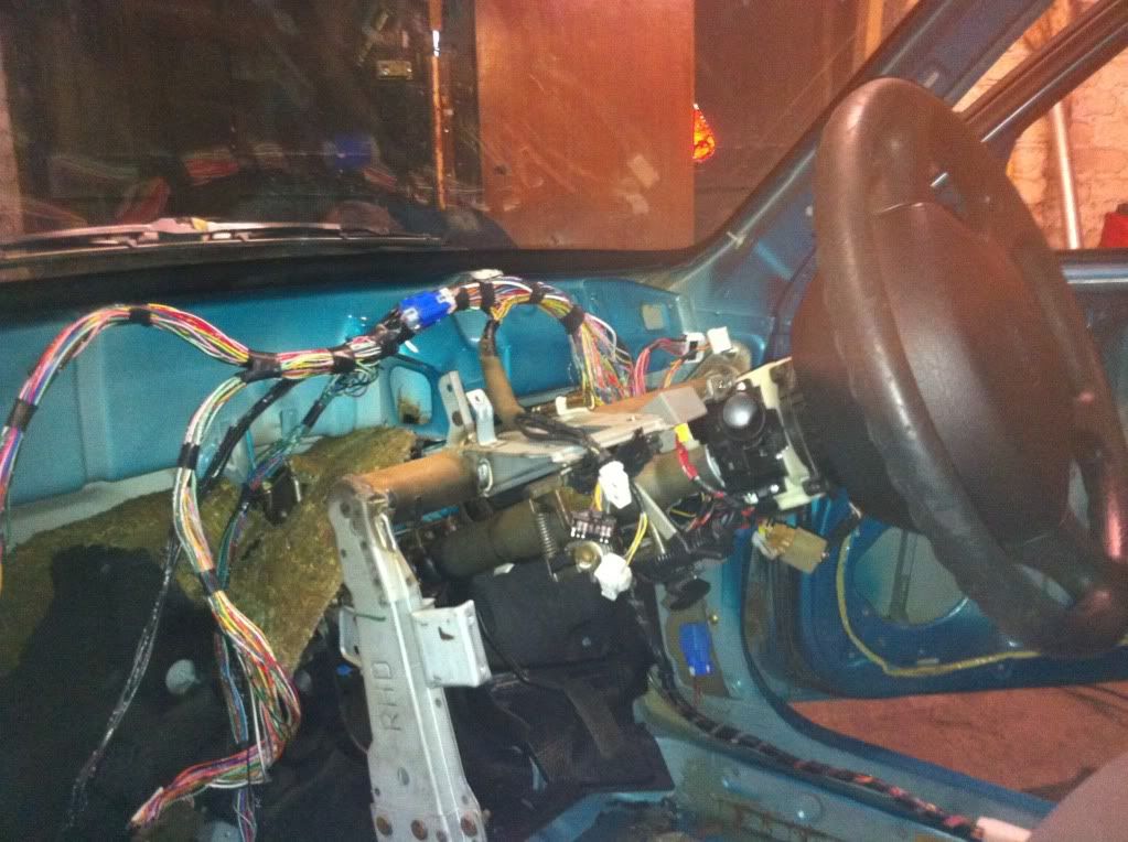

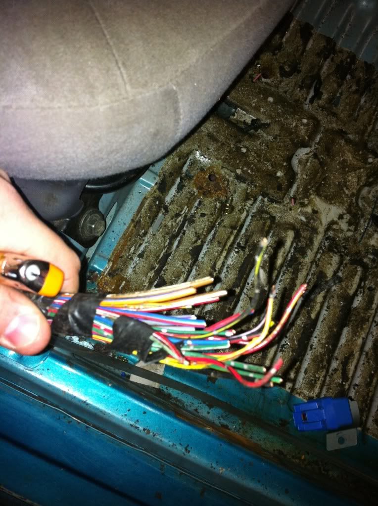

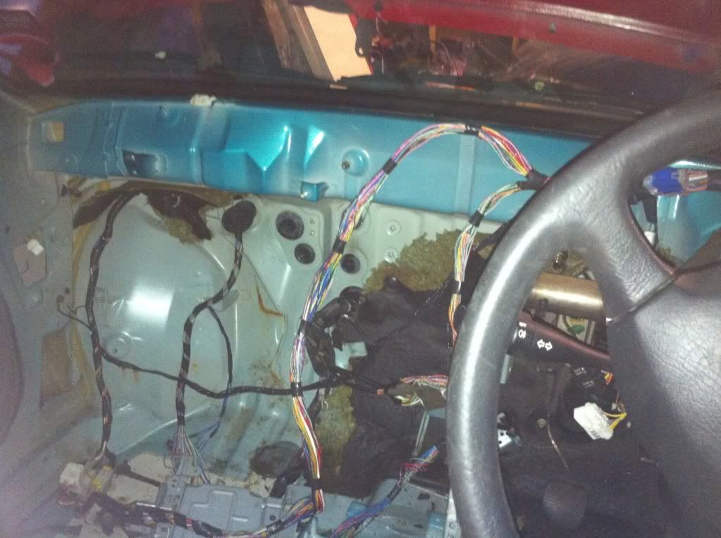

I also started on removing the wiring loom from the donor car, the blue one you can see sitting in the background. Its fate is to be scrapped with parts going towards getting the micra running.
R.I.P S265CJL. 18.0 seconds to 14.9 in your lifetime. along with 4 engines.
We have decided to use the Almera engine loom, and interior loom and just splice into the loom that runs the stuff backwards of the dash (lights, fuel pump etc...)
When the gearbox was roughly put into place, we realised that the gearbox side mount would be needed some fabrication doing.
So far the conversion is going well,

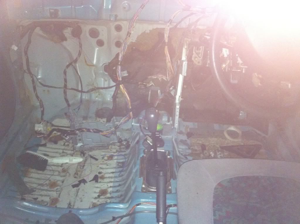

Ok update time.
All necessary wiring was removed from the Almera today and inserted into the micra. Everything was put into place. Really all that needs done now is to connect to an engine loom and join it to the back wires and it should start when required....

We also hit a snag today regarding the brake master cylinder. The Almera one fits fine without an engine in there. But with the engine in that place ^^^ it fouls on the whole unit. The Almera Brake master cylinder sits a good 2.5 inched further forward than the Micra one. So weve decided to swap to a non-ABS setup from a Micra.
