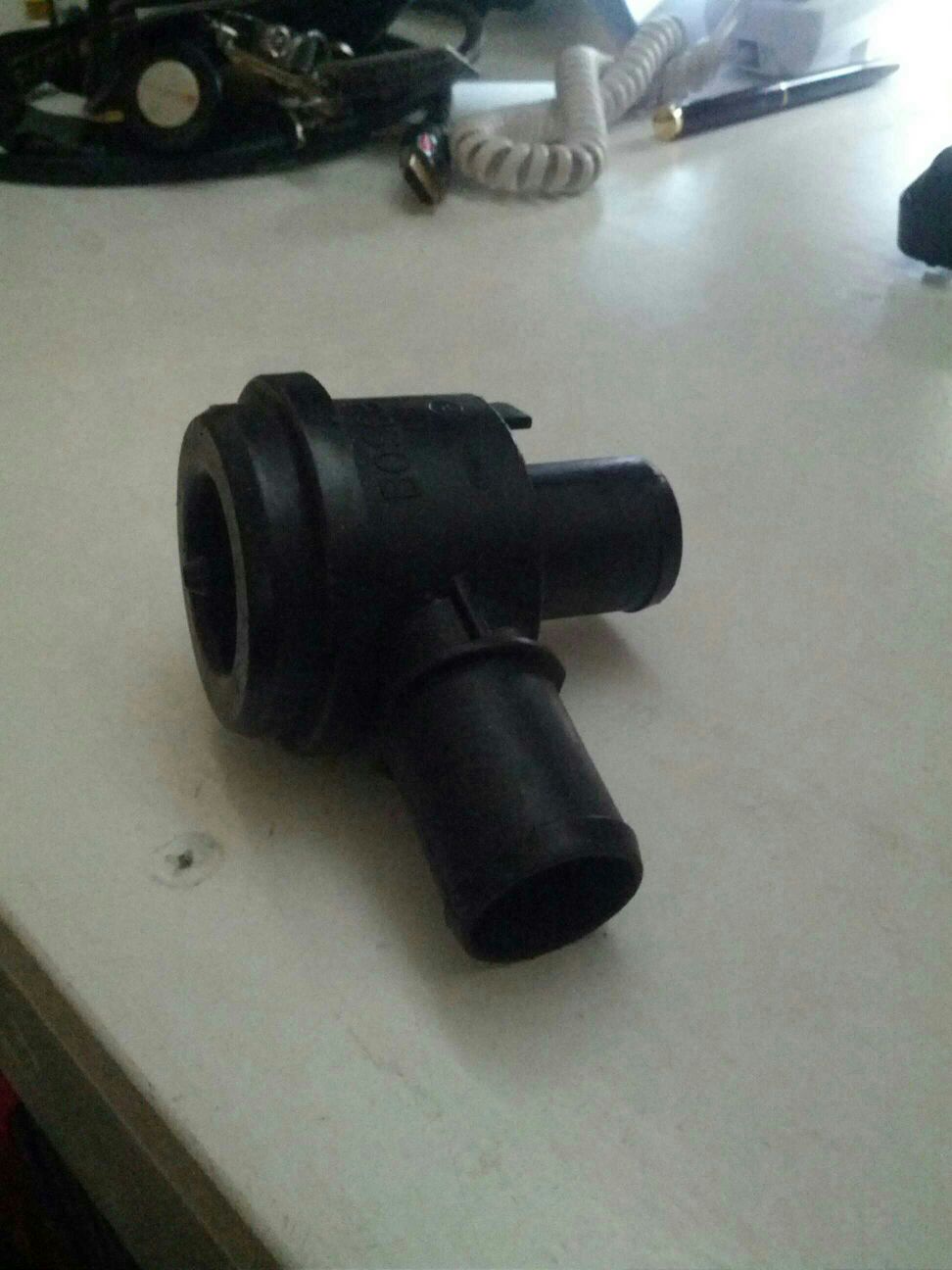

Do you have any pics this one your offering kind sir?
mine,s just a diesel recirc valve tom, works the same as a dump
