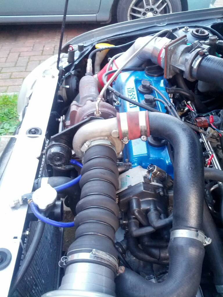

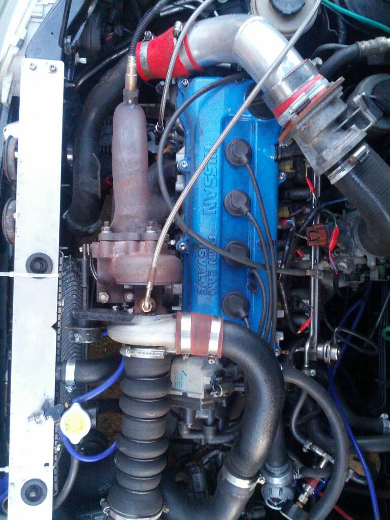

sounds like a vacuum one mate, and there,s no pipe fitting on the alloy compressor housing eh, my 1st two tubby,s were vacuum ones tom, i just fitted a + pressure actuator and repositioned the arm (i had to move the arm on most of mine, after clocking the turbo anyway) :)
No theres no pipe fitting on the compresser housing mate, so must be a vacuum one?
Ill have a look for a positive pressure actuator on ebay
By repositioning the arm you mean the one on the compresser housing? Or the actual current w/g arm?
Love you chris :)
the w/g arm mate, wait till you have positioned where you want the w/g facing, and the compressor outlet facing, then decide where you want to fit the actuator etc
everything ends up being custom made, thats why everybody has loads of leftover intercooler fittings and pipes :D
I cant change the way the w/g faces can I? Its all part of 'A' the manifold and 'B' the compresser housing there not bolted there forged into the housings.
Think ill be going for a high set up like Mr Chris :)
But on that note ill make up some manifold drawings.
Been looking at intercoolers on ebay guessing one for a starlet will be about the right size. Piping ill sort last once I know where im fitting everything.
the core is the only bit that HAS to be in a certain position eh tom (oil feed @ 12 o,clock, and oil return @ 6 o,clock) and the turbine and compressor housings can both be rotated to anywhere you want :)
and i cut and welded the w/g arm to the angle that i wanted (last job)
Im with you on that one, like I said ill be looking at having the same style as chris seems the turbo would be happier that way in its current form.
And the core only needs rotating about 10 degrees in this position.
If I were to follow the way you have mounted its almost 45 degrees.
I dont really want to cut the compresser arm :( its pretty haha :p
the w/g arm is 180 deg out if its a vacuum operated one anyway tho tom :)

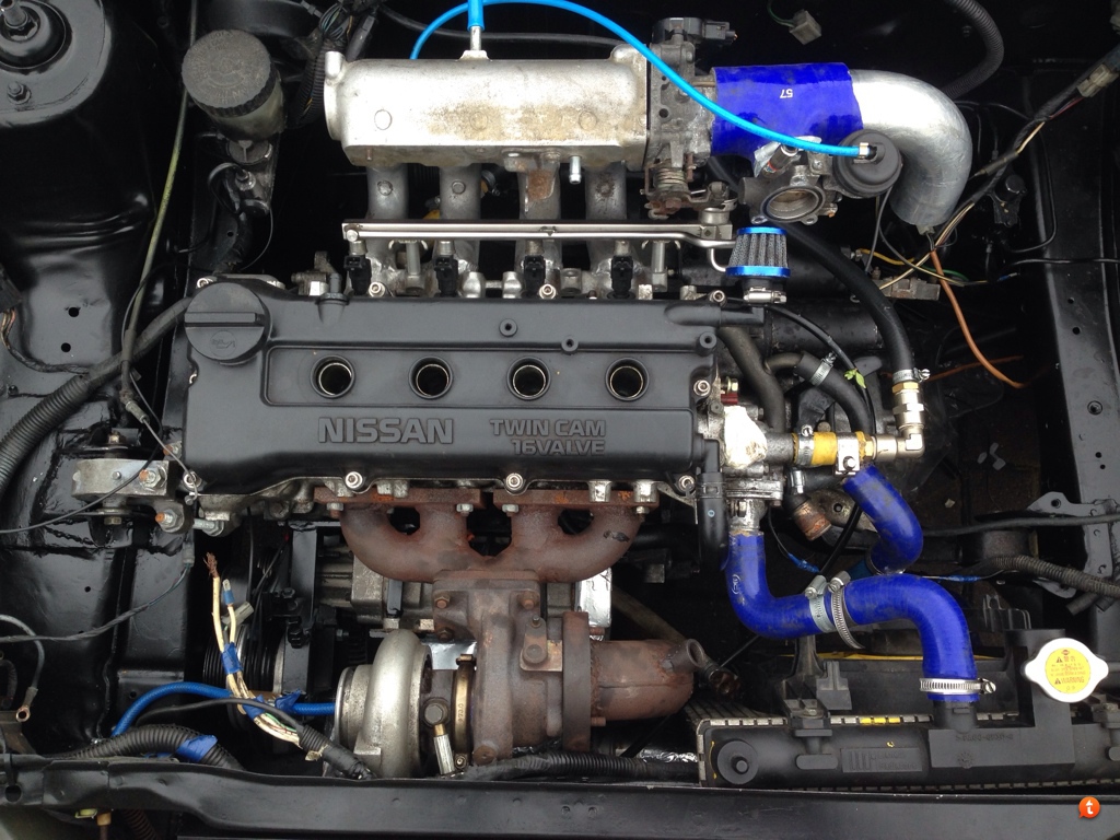

So to make sure im getting the correct signals from the engine, new temp sensors arrived today :)
Along with a much needed Valve cover gastet as mine is leaking oil all down the block and over the gear box... looks pleasant.
You dont need a picture really but because im nice :)
