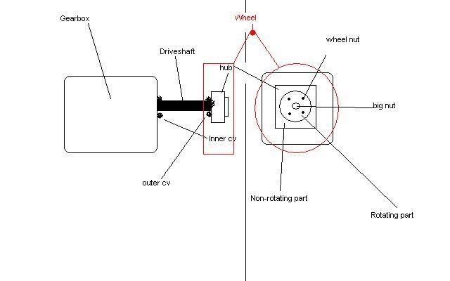

No im not english,but my fiance is and ma cousin is,im lebanese duno if have you heard of lebanon..how about the driveshaft wot have you used? pulsar one.primera? do u get them shorteen?
We've used Almera GTi driveshafts as they were a direct fit between the Primera Box and Pulsar hubs, there was some shortening required. I'd consider carbon fibre shafts if i ever did something like this again, as they can be developed from scratch and have a far greater rotational strength than steel (and are obviously lighter).
Here is a very accurate technical drawing:
hopefully it makes some sense...
