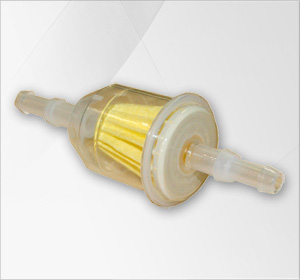

The other people have used is a fuel filter with the element removed which then acts as a small reservoir and dampens the pulses.
Like this
Both work well from what I've read
