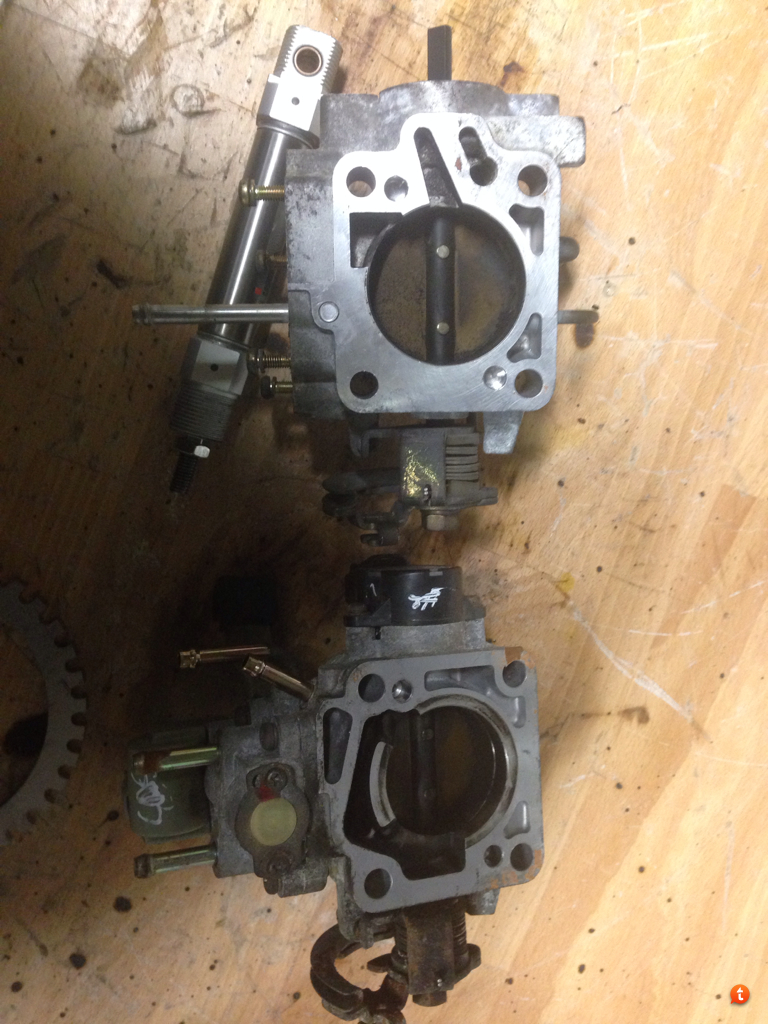

Got it from bloke of the starlet siteThat TB is for a corrola and you manifold is for a starlet

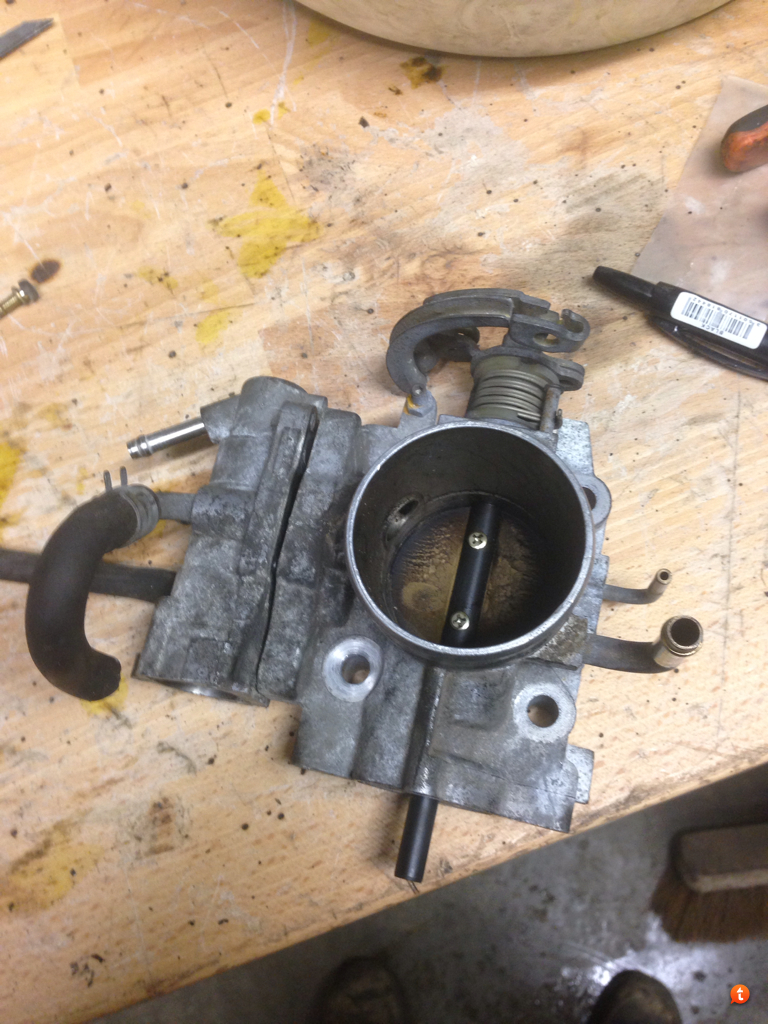

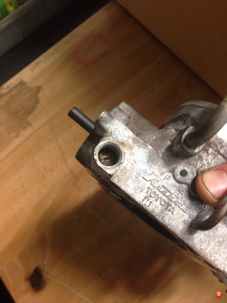

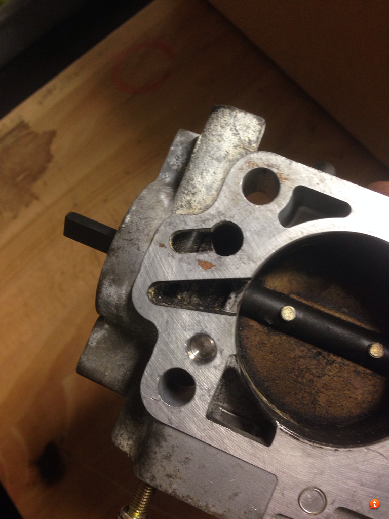

the butterfly bumpstop screw is pretty crude for idle setting, but would sufficeThere's a little grub on the cable guide bit, would that be ok to set the idle? (Opening the butterfly a smidge) like on my carbs?

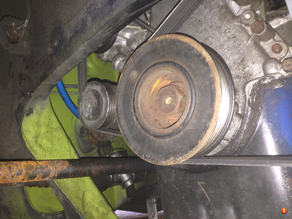

where does the missing tooth part go in relation to the pulley
all 4 pistons will be half way up the bore @ 90 btdc neilThis was a pic I sent earlier to trigger wheels to help choose wheel, beings I have no idea where tdc is right now , does the spot on the pulley tell m anything

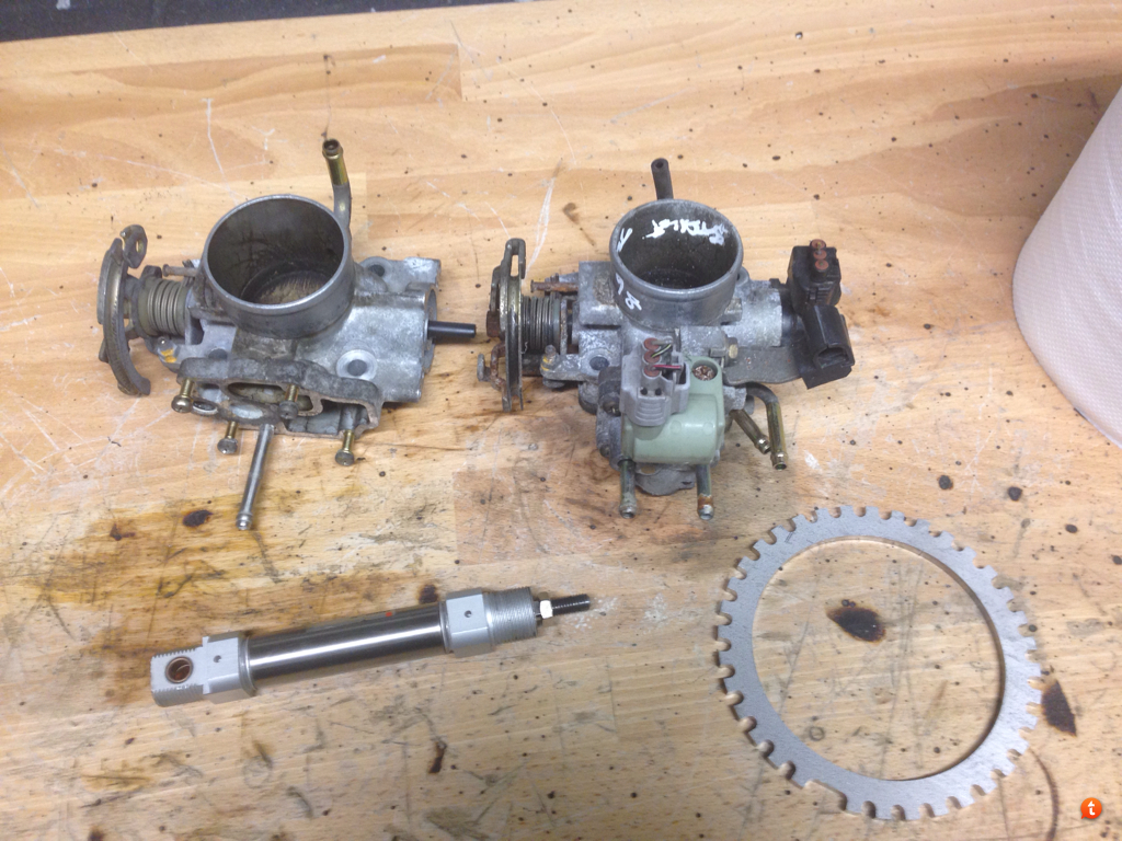

Still don't wanna go down the reed valve route eh?Found the right TB, also found an pneumatic actuator and got my trigger wheel thru
Difference between the 2 , correct one on bottom , also came with the tps
Plan with trigger wheel is to cut recess into the pulley and weld it on, not a lot off room to just bolt on the wheel.

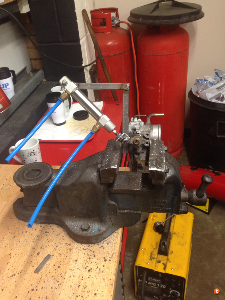

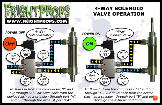

And the actuator will operate the old TB. (Havnt decided how yet) which will replace my homemade (leaky) valve
oooooor you could use a reed valve and let me have the TB to replace my broken one![]()
If the bypass valve is open there will be little to no pressure though?
