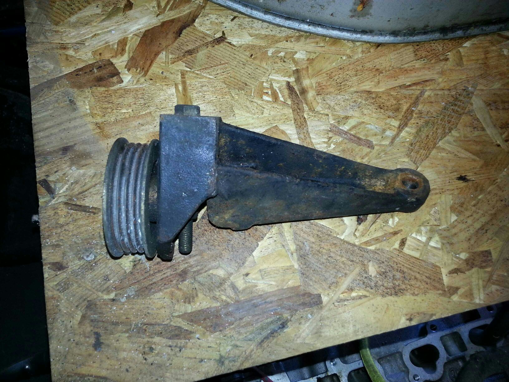

thats a p/s pump bracket on the back neil, and i use a 4pk613 belt (my 6pk610 one was too slack for some reason, and cooked an engineI need a cg10 flywheel! Can't move on without it
