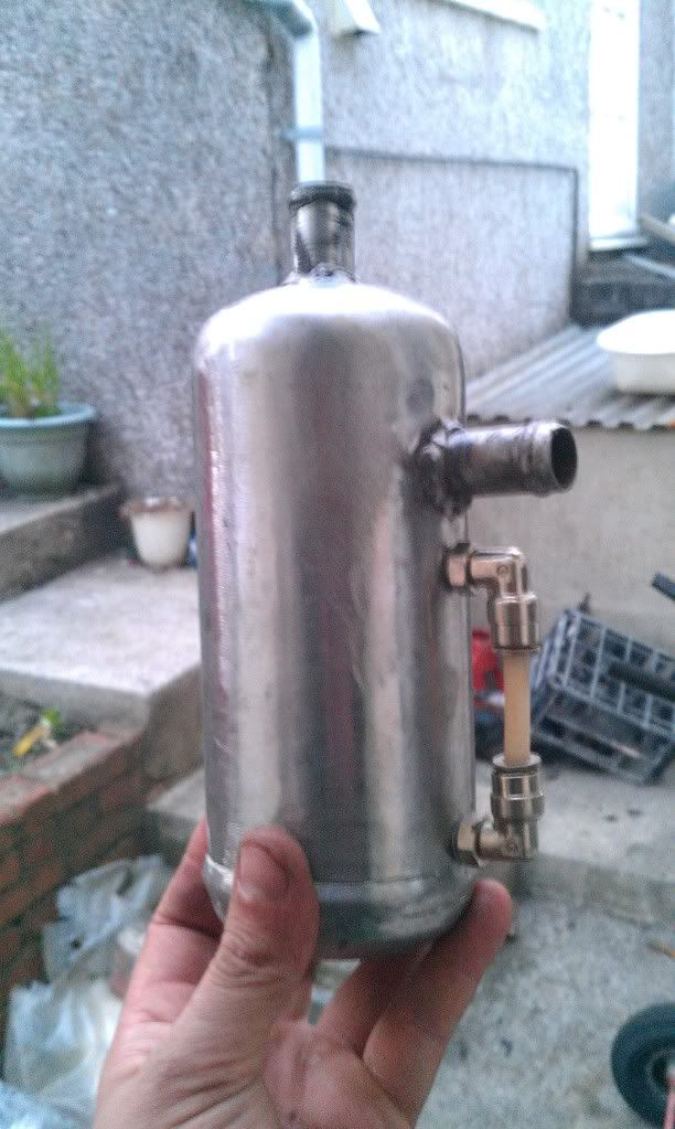

after tiring drive home, checked the catch can and it caught 45ml of goop after 1500 miles

this catch can hose near the dizzy has split abit so no good for the PCV flow, simple cut & reclamped.

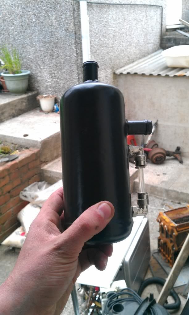

reprinted the catch can with afew improvements.
lengthened the sealing lip to fit tighter in the jar to reduce leaking.
now I can make my own custom size reinforcement tubes and this allows me to enlarge all the plumbing for less restrictions
old 8mm bore copper pipe vs new 11mm bore custom pipe
we'll see if it works better over the days

fitted the new catch can top and even with a brief drive around town it now condenses soo much more water vapour now :)
aligned the beams using my laser level. all spot on now :cool:
I noticed some oil vapour have always been leaking out the catch can screw lid down the side of the enclosure, maybe it's not fully screwing down (cos the screw top is also used to clamp the enclosure down) so the 3d printed top ain't fully sealed against the jar and leaking.
the new design is definately catching alot
after 200 miles the new catch can design has condensed 50ml of vapour from the crankcase pipe
the engine cover pipe only emits during boost but even this side has caught abit more than usual.
I'll need to enlarge the enclosure hole slightly so the catch can lid fully seals up and then find another way to secure the enclosure
It turned out that the enclosure was abit too tall & rubbing on the chassis, so I trimmed it down and the catch can top can screw down fully now. Will see if it leaks again soon

the catch can lid was still leaking some oil after trimming the enclosure, so I fitted an elastic band to seal against the glass jar
and it's stopped leaking
after another tank of fuel, 230 miles commuting, it's collected another 55ml of vapour. that's bout 240ml per 1000 miles.
the only time it caught upto 330ml/1000miles was when it's crammed behind the front grill with chilled rain & air blasting through it but that was always hard to access.
the catchcan location behind the headlight's performing well now and easy to access.

after doing 206 miles, the catchcan has caught another 50ml of vapour (243ml per 1000miles)
curiously found the gas canister is the same diameter as the glass jar.
since steel is over 40x conductive than glass, gonna see how I can machine it into a catchcan container
