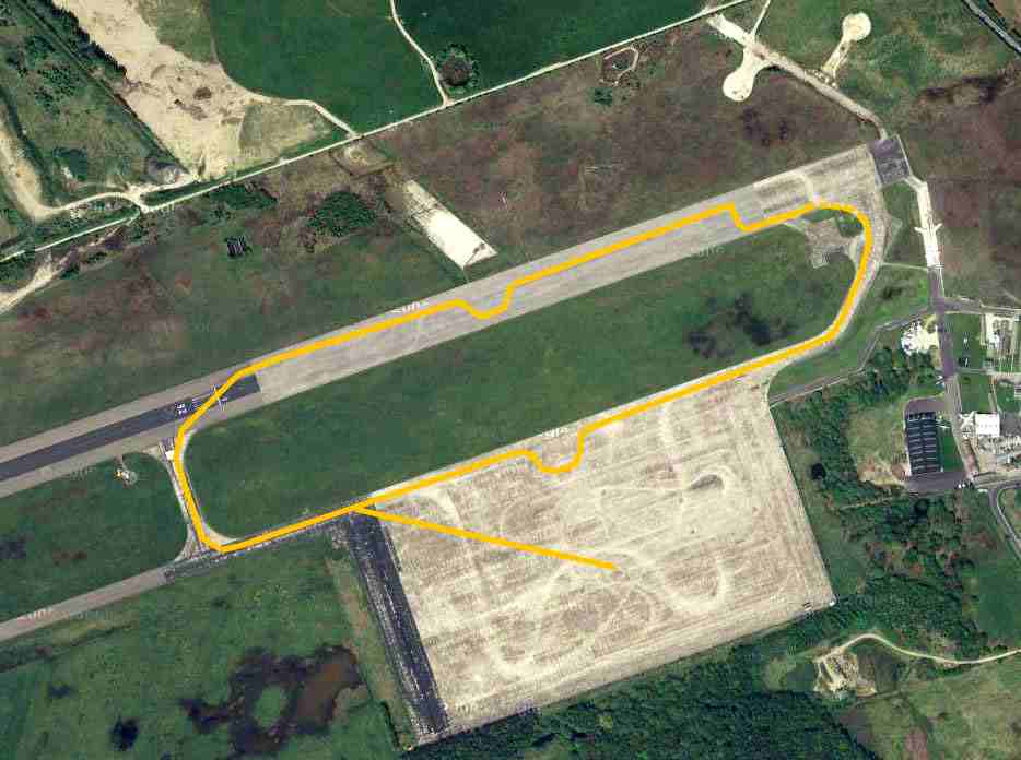

also been looking at trackdays and the cheapest & nearest one I've decided to goto is Elvington Airfield in Yorkshire Jan 19th Sunday £99 open-pit all day.
anyone wanna join?
holy moly just googled the track and it was where hammond had his massive crash :eek:
anyone wanna join?
Can I join ? Also can I bring any car up ?
I believe any spectators can come along.
If organisers allow, I think extra passengers can register on the day at £5 plus £20 helmet
here's footage of what to expect on a driving experience day at that track.
