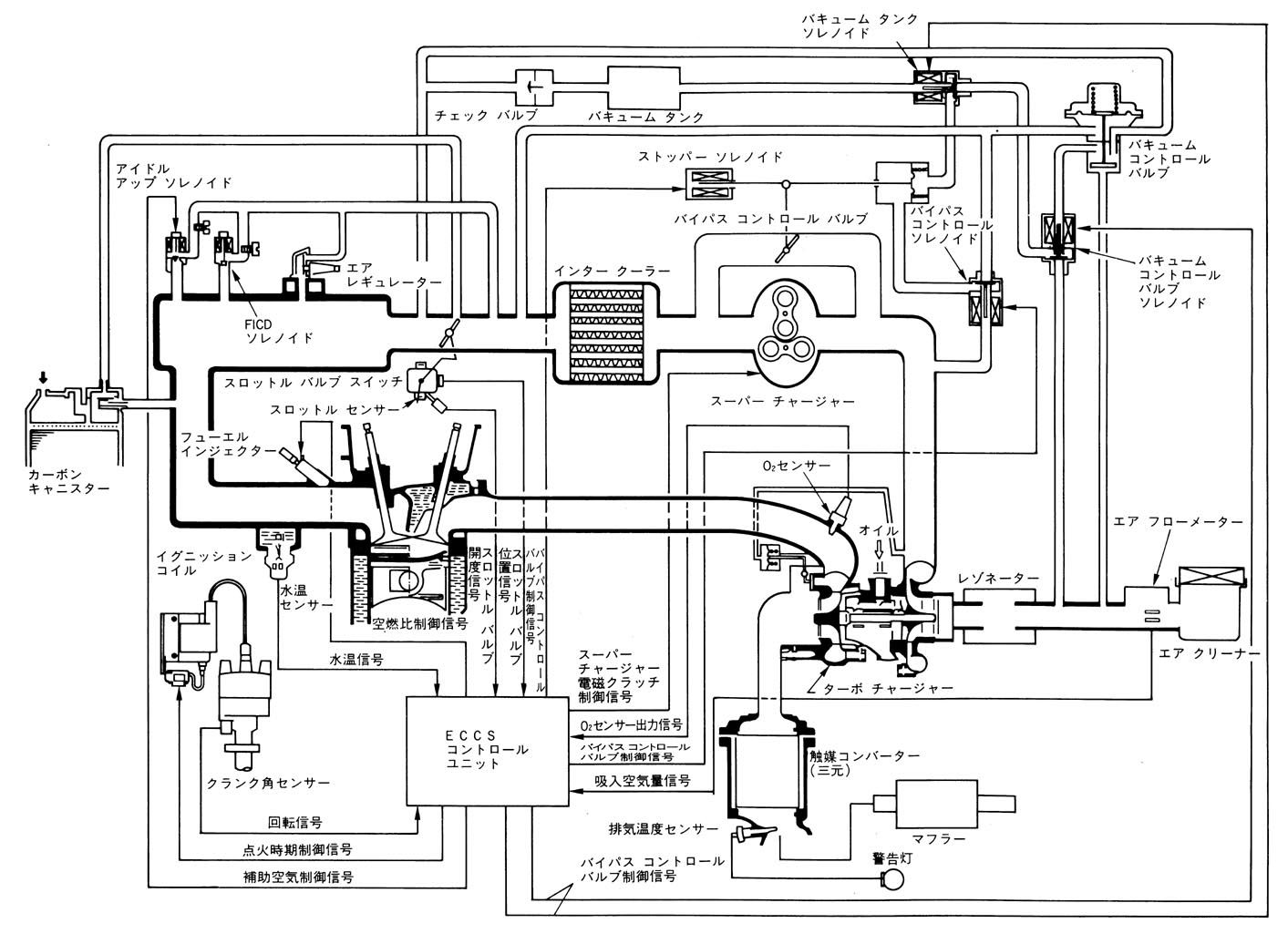

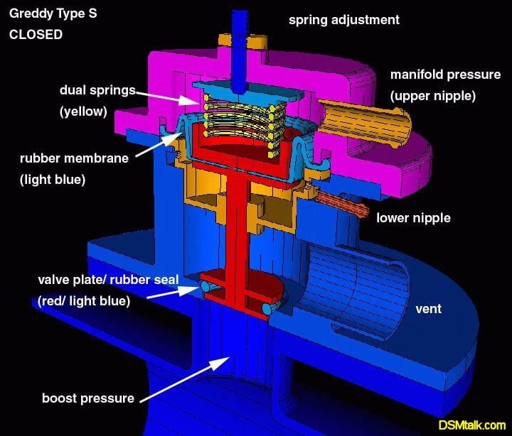

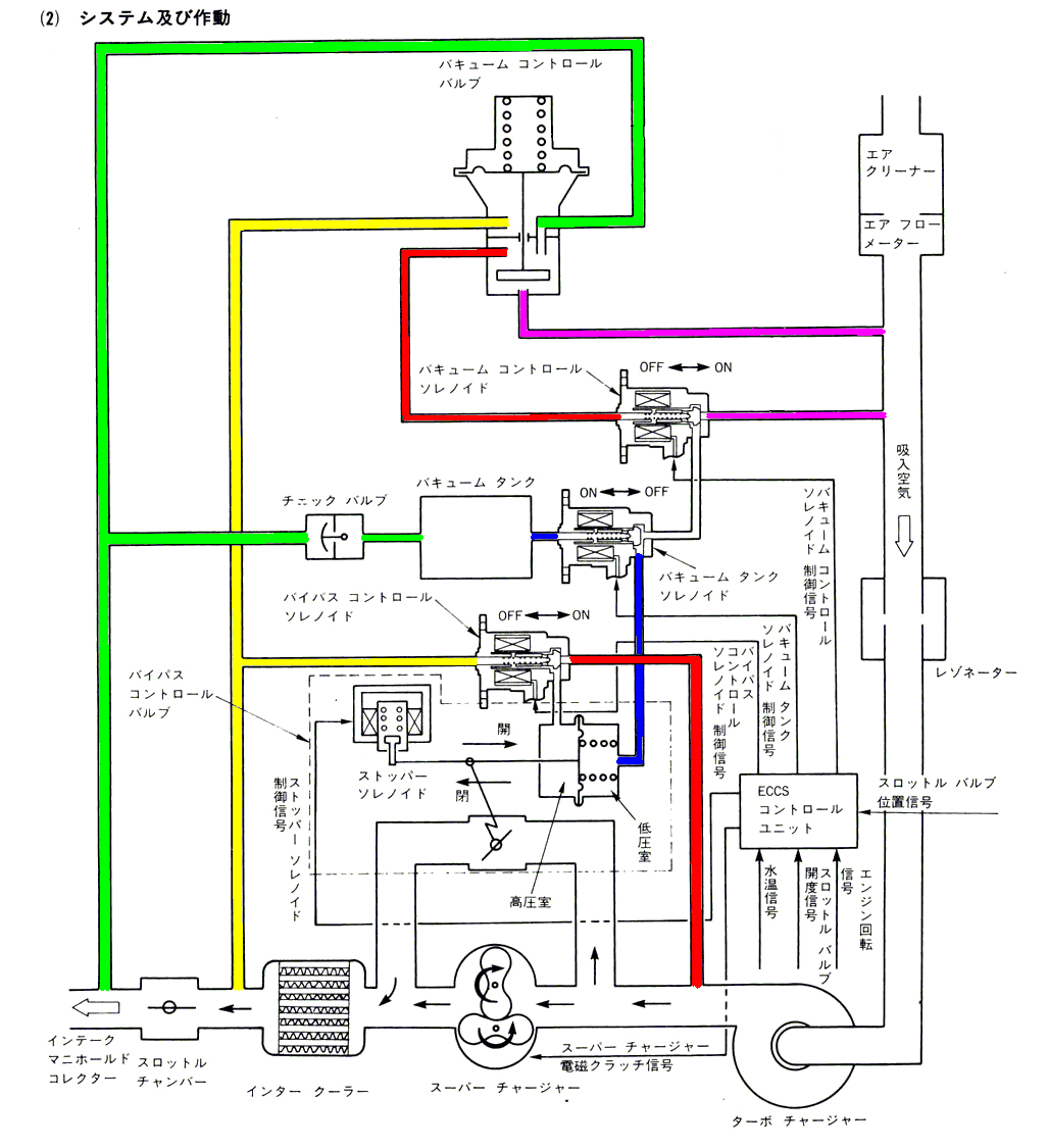

I have had this diagram of the Super Turbo operation (pictured below) floating around on my hard drive since I was like 15 back in the States. I then moved to Japan about 3 years ago and finally spotted a Super Turbo at a used car dealer. I took the car for a test drive but couldn't afford it at the time, so I had to pass on it. I regretted it ever since. So I kept searching and a few examples would pop up from time to time but none of them were ever as clean as the one that I test drove. Then finally it popped up again in Osaka! So I jumped on it like crazy! Which brings me to here, haha.
Picture from HD that I've had for the past 10 years (it's made it through like 35 windows reinstalls).

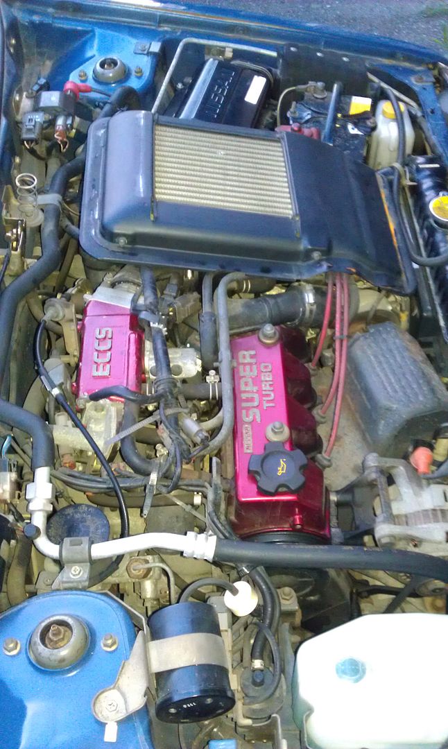

And here the car is!
When I took the test drive I only pushed on it slightly, I never realized how much go these little things have in them! It's an absolute blast to drive!

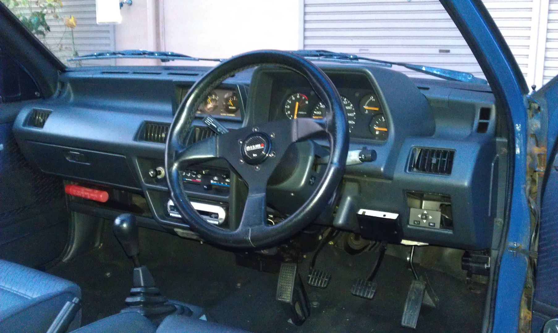

The interior is so minty fresh it makes an Altoids can want to take a shower. In other words, it looks brand new inside! There's a little bit of sun-fade on the door handles and window crank handles, but some paint will fix those so quick it's a wonder why I haven't done it yet.

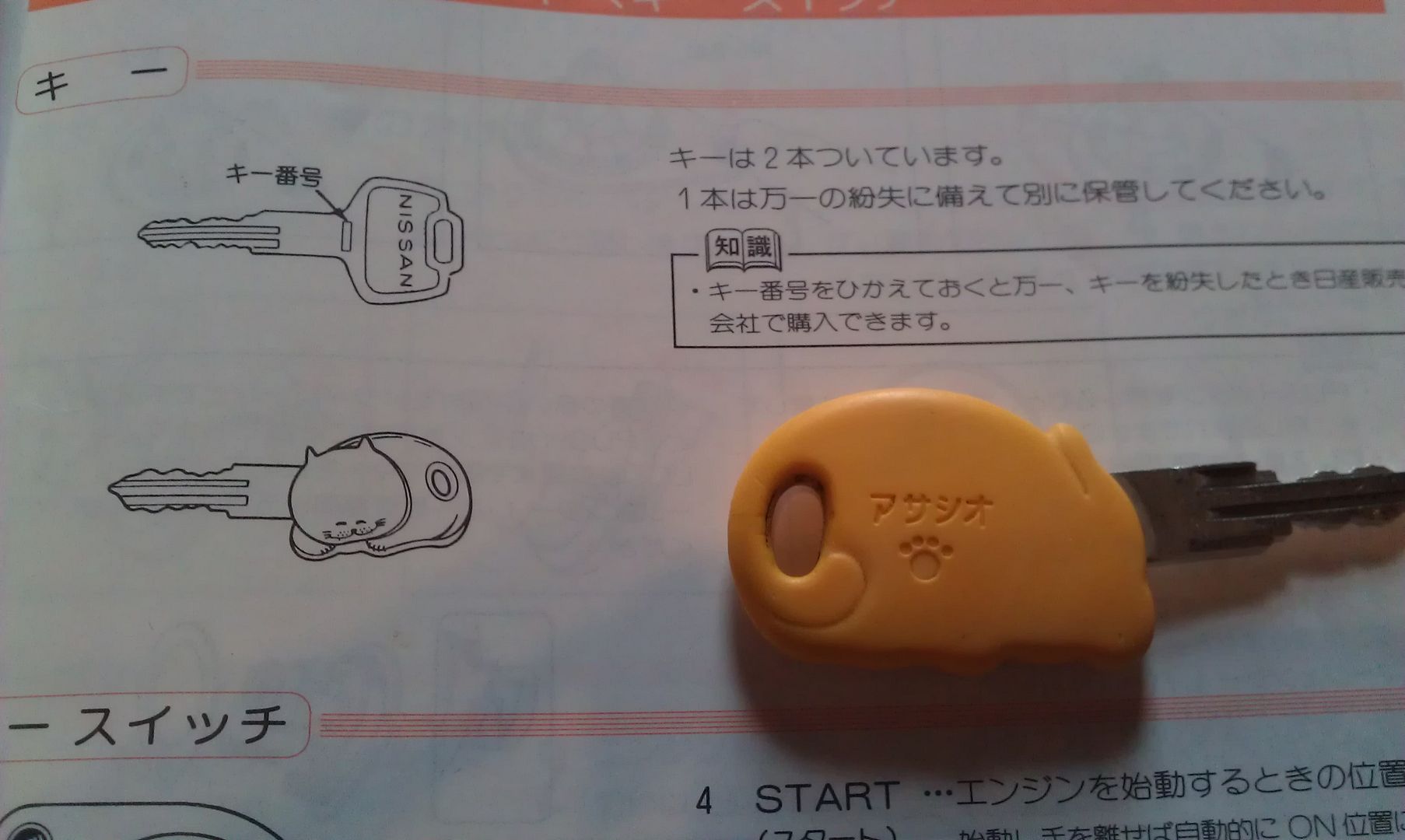

When I got the car I received two keys, a spare that was cut into a generic buy off the shelf at the hardware store key and some weird key with a cat on it. I gave the cat key no thought and just tossed it on my desk thinking it was someone personalized key they got at a key shop or something. I was actually really upset that I didn't get the original key. Then I was flipping through the owner's manual and stumbled across this page showing the cat key. The cat key IS the original key!

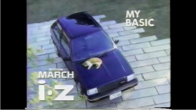

Apparently the cat's name is Asashio. It was featured in a bunch of commercials here in Japan as the unofficial mascot of the March.
And the youtube links to the above videos:
http://www.youtube.com/watch?v=EFI87OZxd24
http://www.youtube.com/watch?v=ByQwKo29fZQ

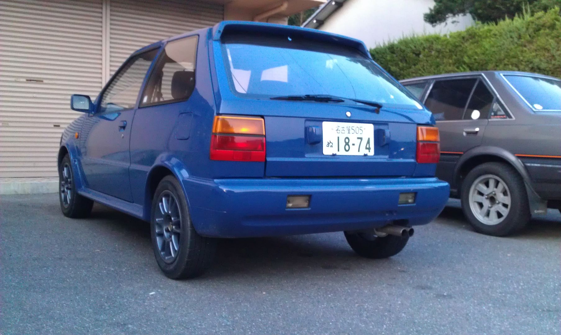

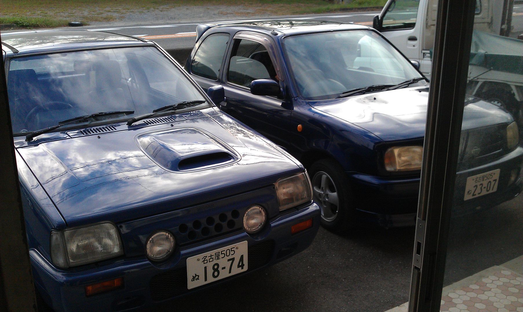

The car is epically small!
Here's the car next to my impossibly small Mitsubishi and the roof line is actually slightly lower and the wheelbase is only marginally longer! Sure it's like one and a half times as wide, but still, that's tiny!
I couldn't help but get my two babies out for a quick "family" photo.

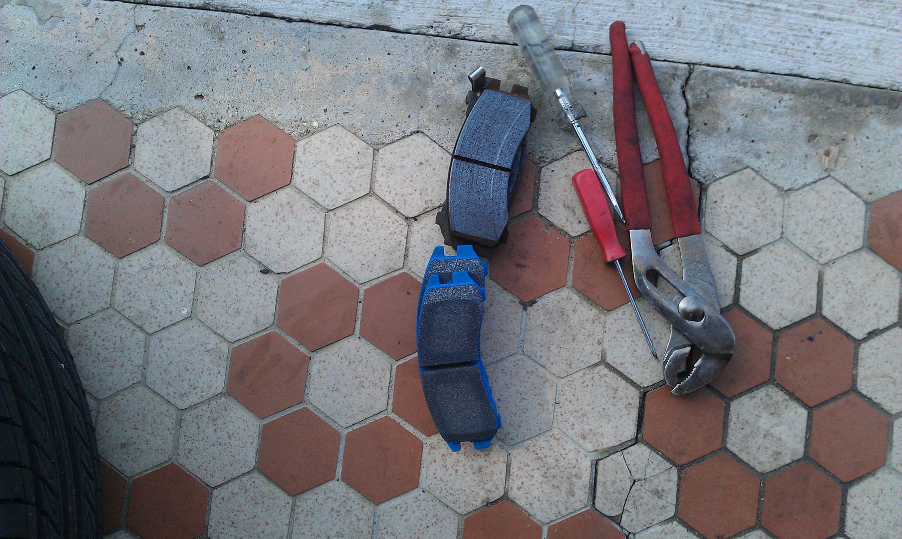

Alright, so I live pretty close to a book store here called Takahara Shouten. They have tons of great books hidden away in that place. My car had the original Owner's Manual and Service Record book in it already, so after a quick run up to Takahara, I managed to get my hands on all the Super Turbo specific service manuals!

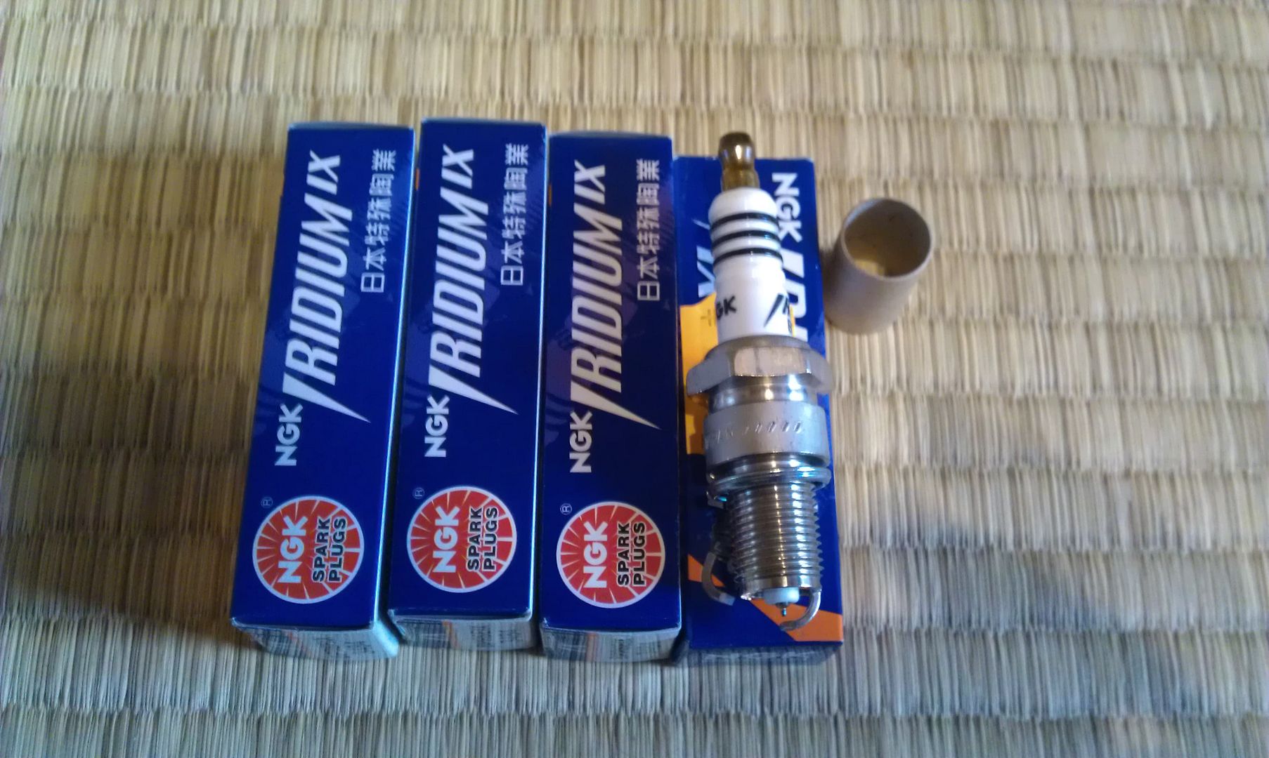

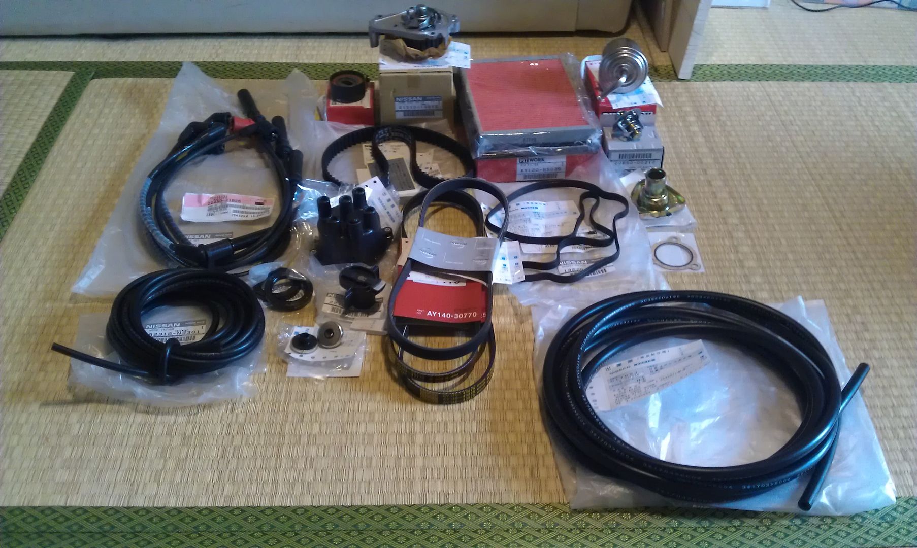

Then I went out and bought some nice spark plugs (from a motorcycle shop to boot, haha).

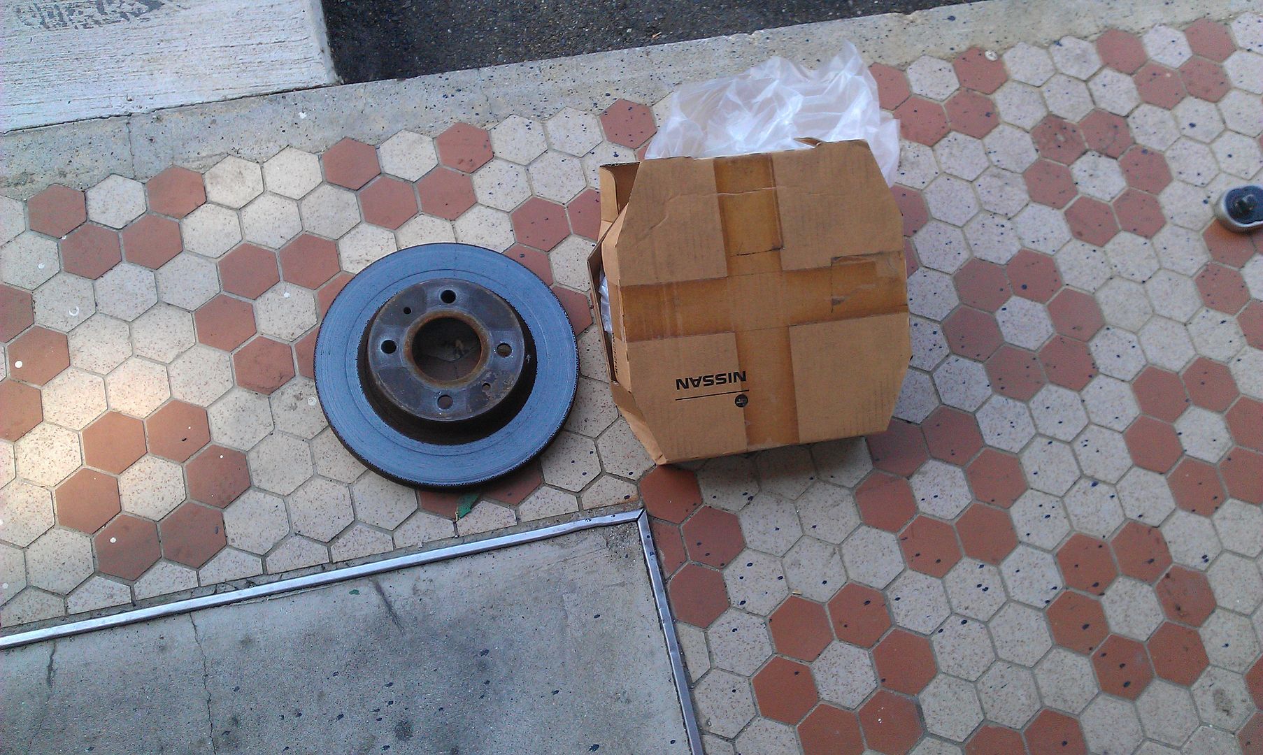

But then I decided that saving money was for chumps and I went to the Nissan dealer and ordered all of this!

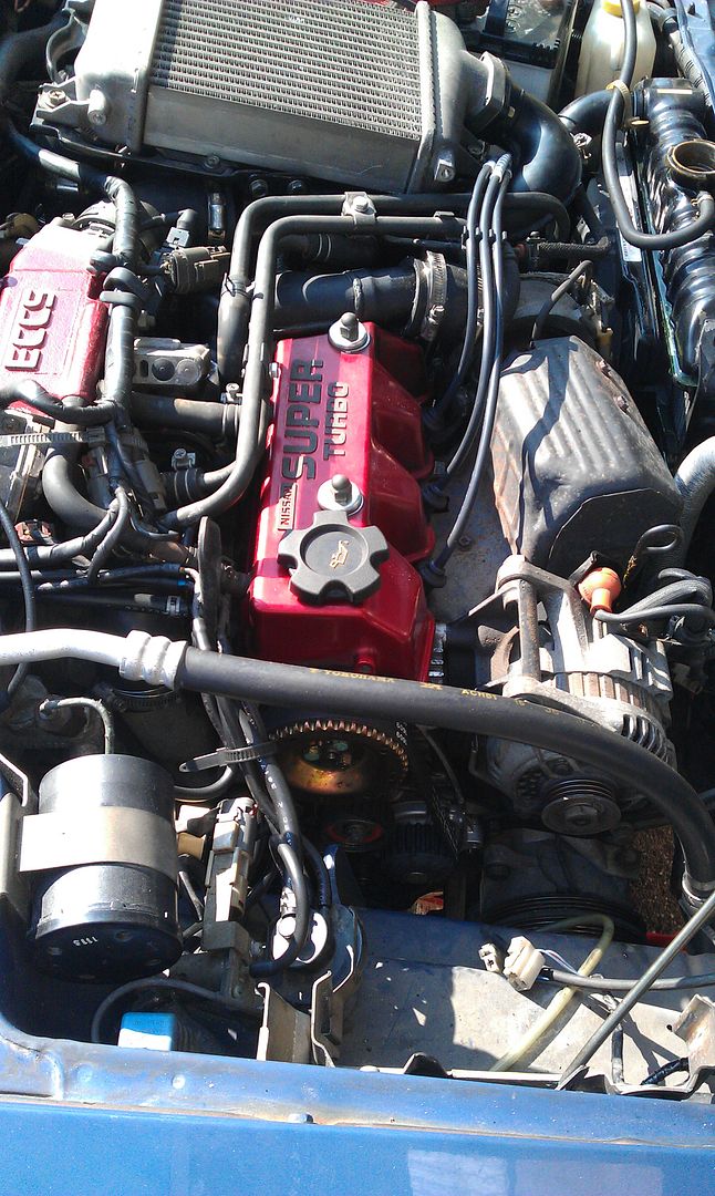

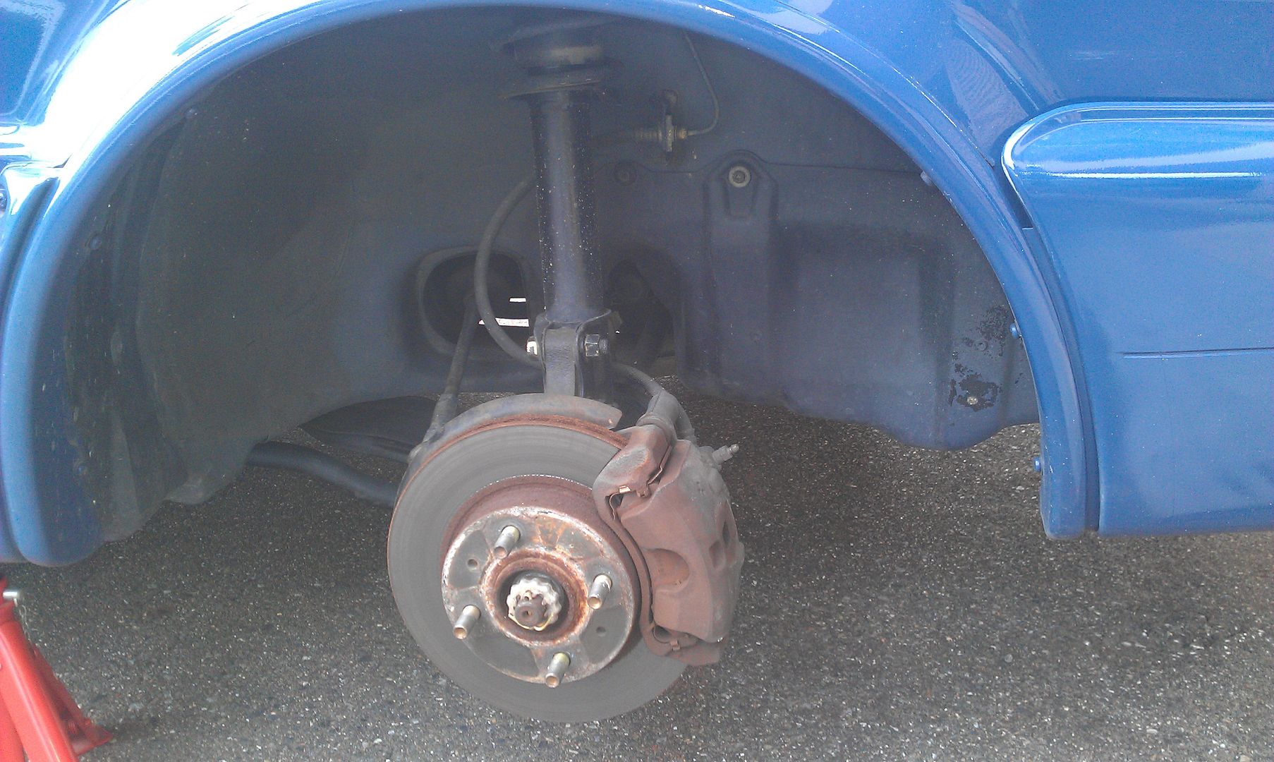

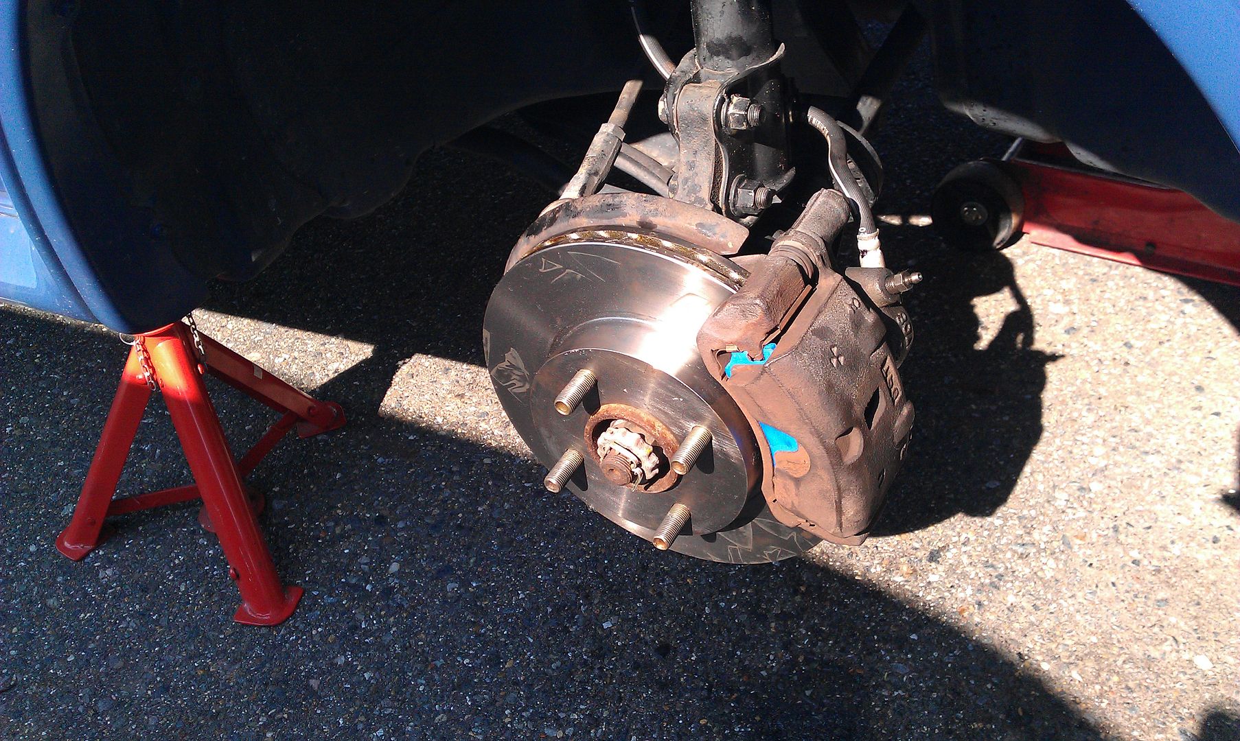

The first step of course is pulling that front wheel off. The adventure begins!

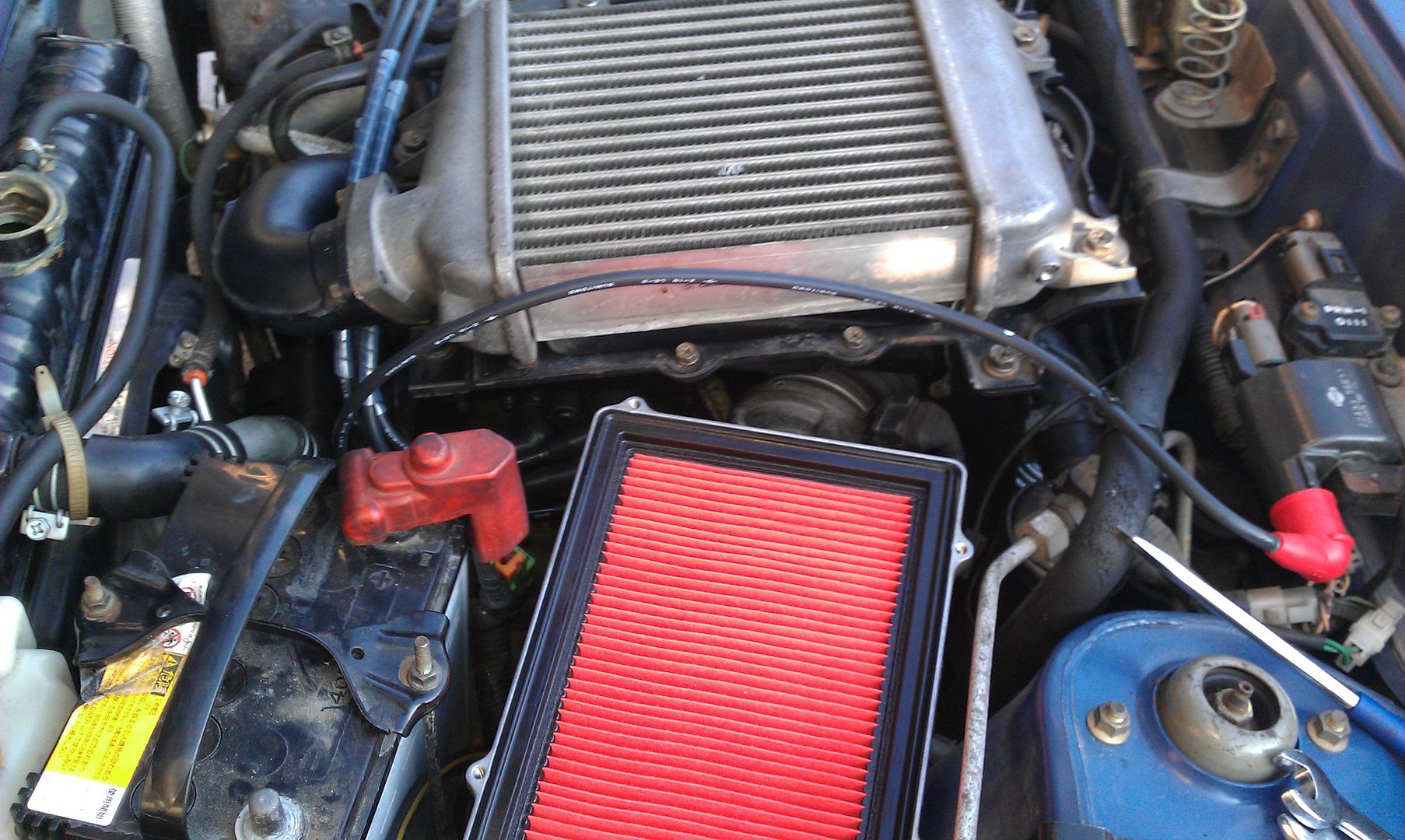

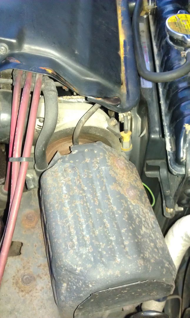

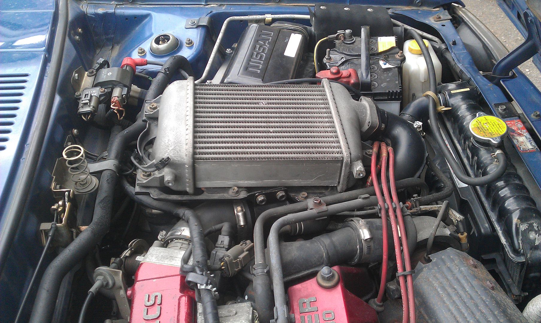

Before you can do anything in the engine bay the intercooler has to come out. That's like the first step to everything, including a simple spark plug change!

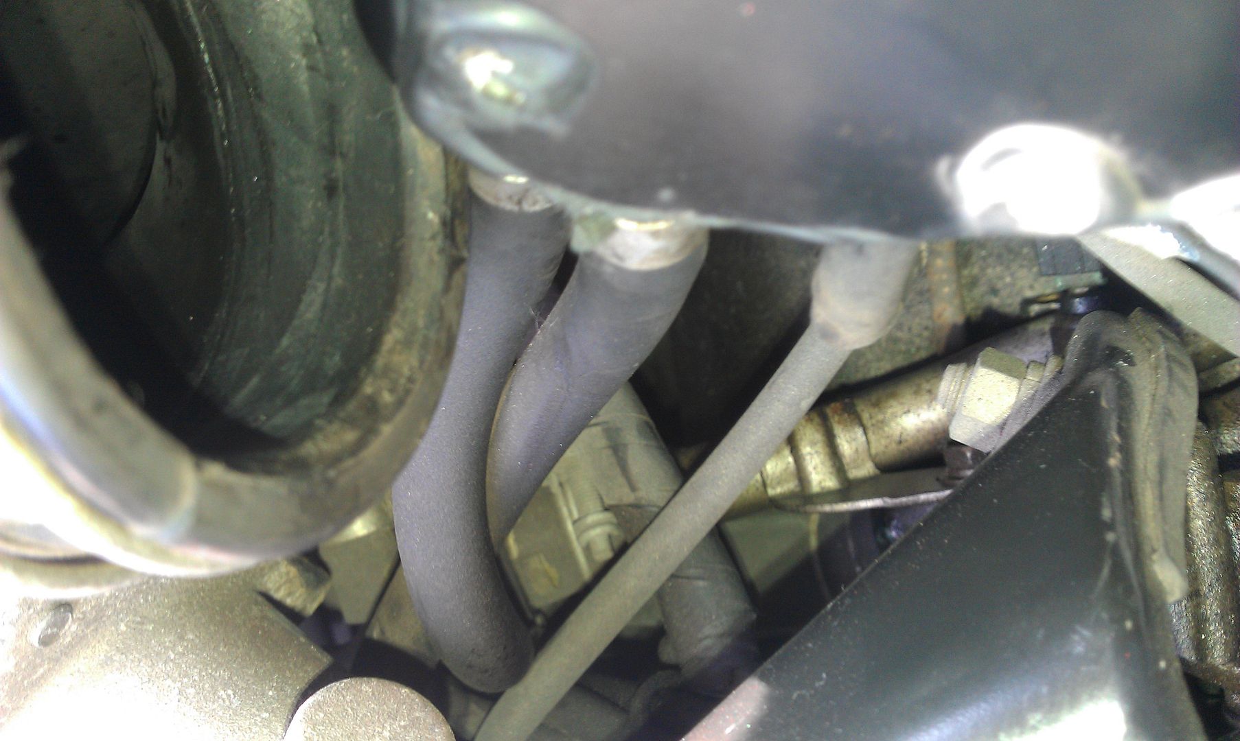

With the intercooler out you can see this weird resonator thing in the section of pipe that leads to the turbo. This part sees no boost and has three vacuum lines leading to it. Little would I know just how important this piece is, haha.
The three lines that run to the underside of the resonator.

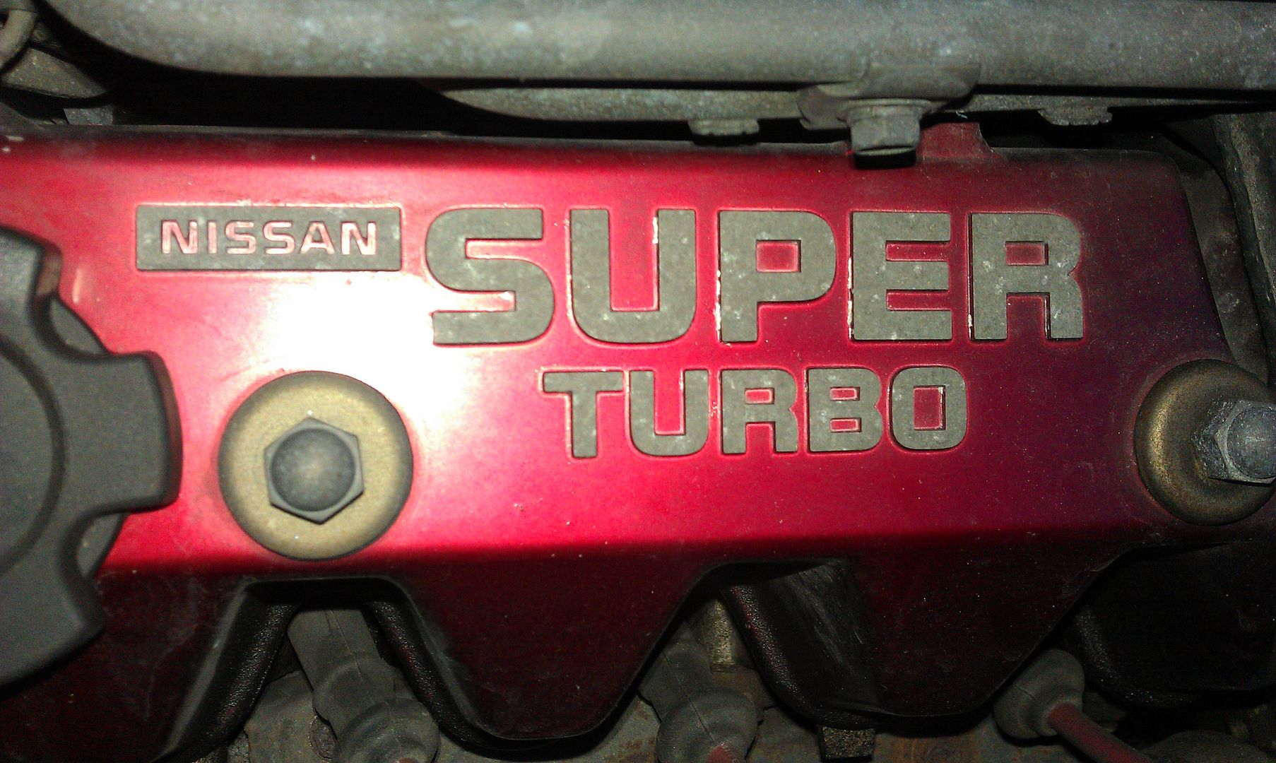

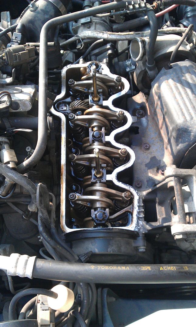

My goal here was to get the valve cover off to put a new gasket on it as it was failing to keep the oil where it belongs (ie. not around my #4 spark plug, haha). This was no easy task! All those steel vacuum lines had to move out of the way. Only one of those steel lines is the water line for the turbo! So, after loosening the banjo bolt up I got closer.
The charge pipe that comes out of the turbo splits just after the valve cover with one half running straight to the bypass valve and the other half heading in between the block and the intake manifold before finally snaking down to the super charger. This pipe obviously has to come out as well.
Victory at last!

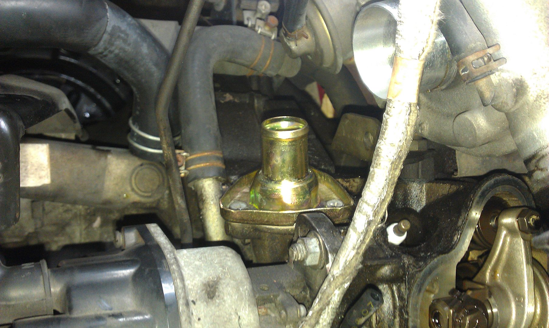

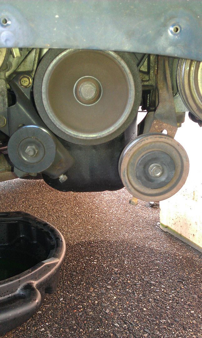

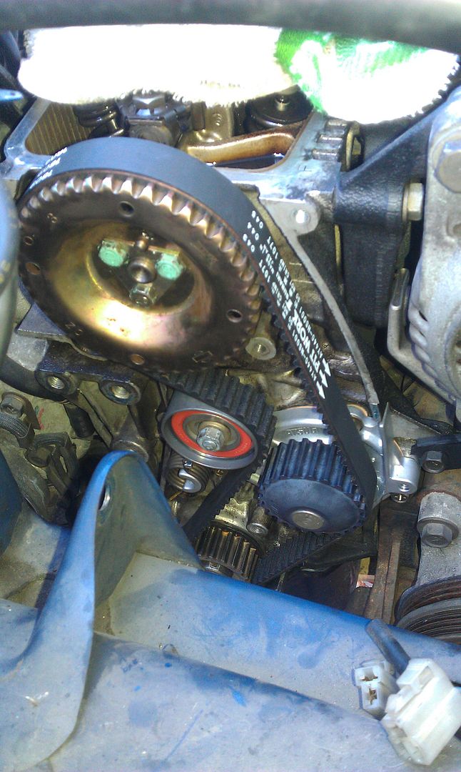

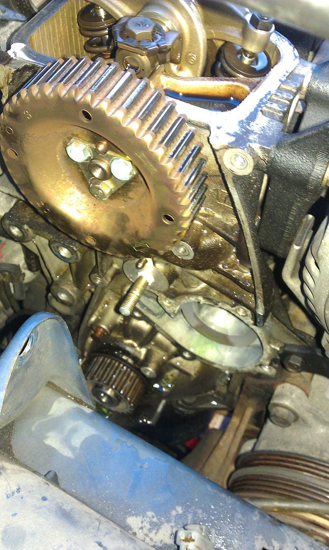

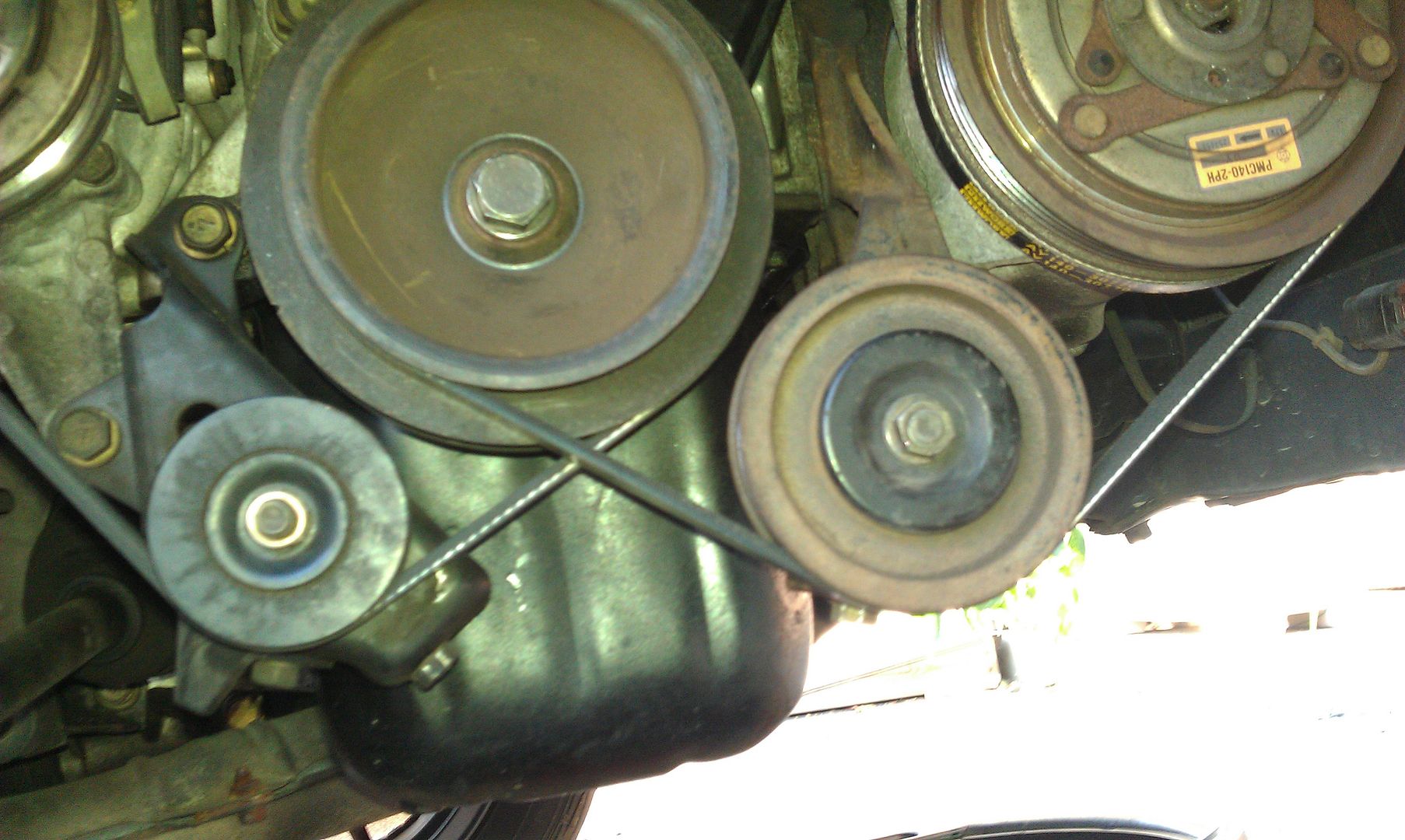

Popped all of the belts off. This thing is really hilarious, you can grab the main pulley and just turn the engine over by hand now problem, I managed to do two full revolutions like that trying to make it to TDC.

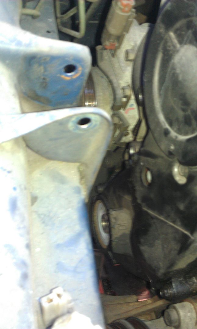

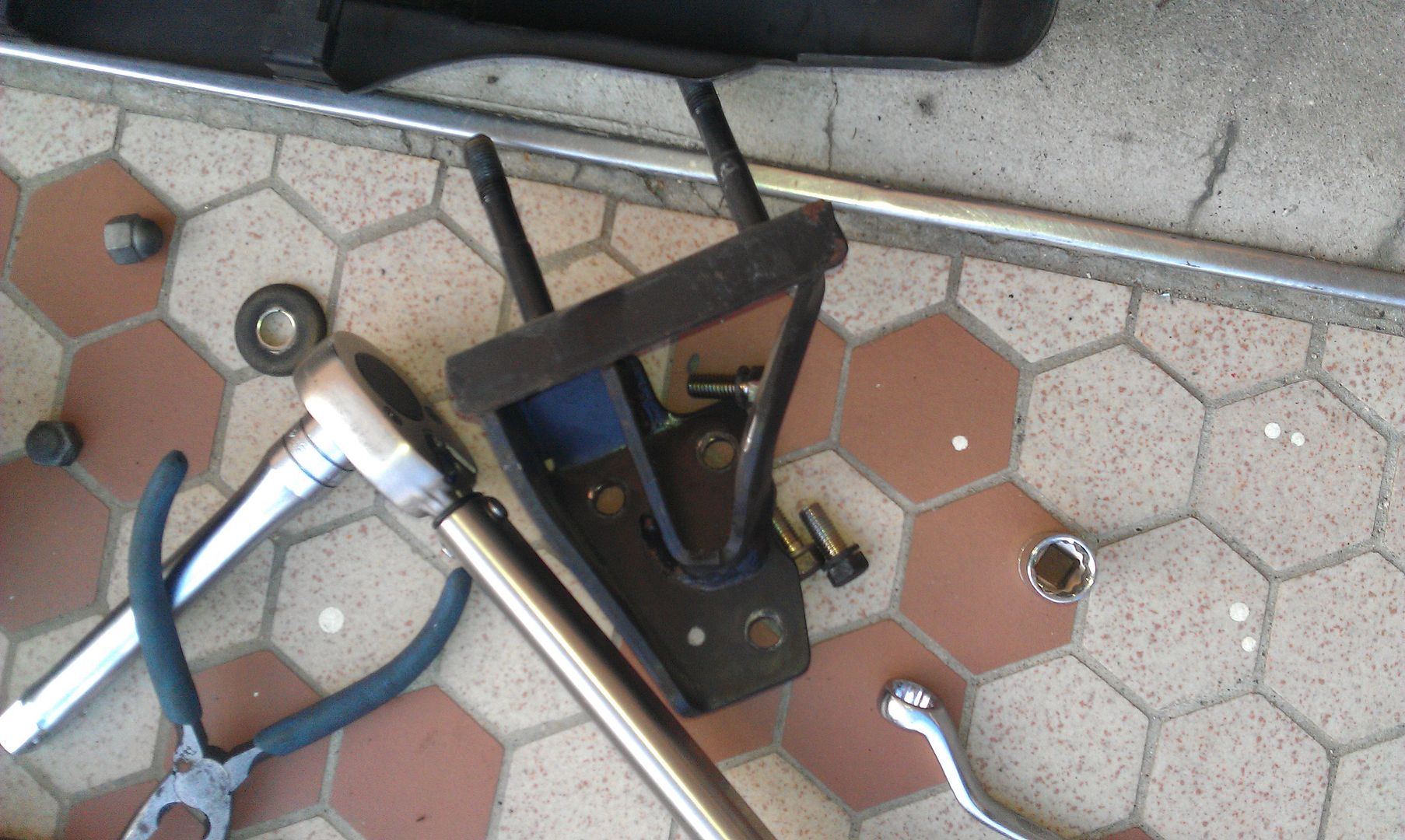

On the front of the engine, before you can get the timing belt covers off you have to take off this bracket. There's like zero room though! I was convinced that this was going to be the hardest part of the whole thing! It wasn't, but it was still a pain, haha.
Where the bracket used to live.
Timing belt off!
You can actually see the timing marks on the crank pulley and crankcase in this picture really well!

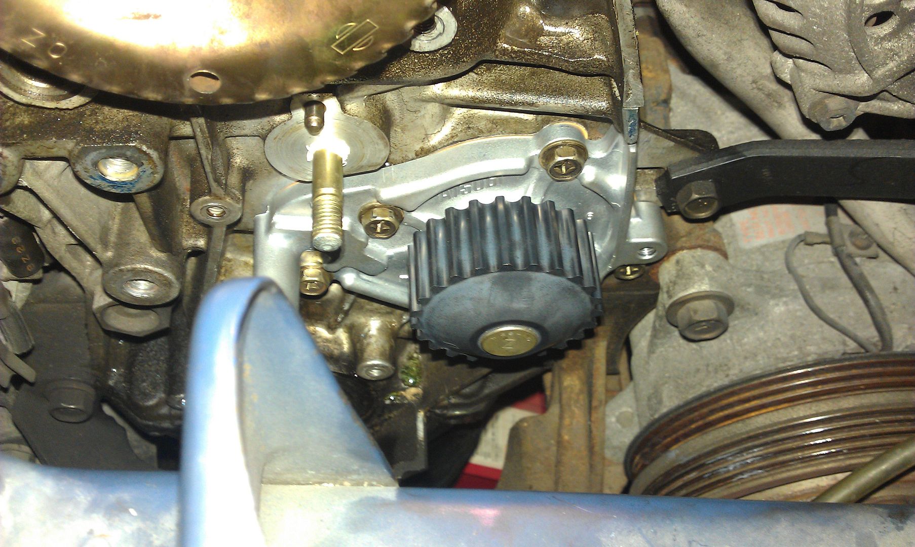

I wanted to get the water pump on but figured I'd start with something easier and went for the thermostat and housing. First new parts to go on!
Turned out I didn't need to worry as the water pump was a cinch!

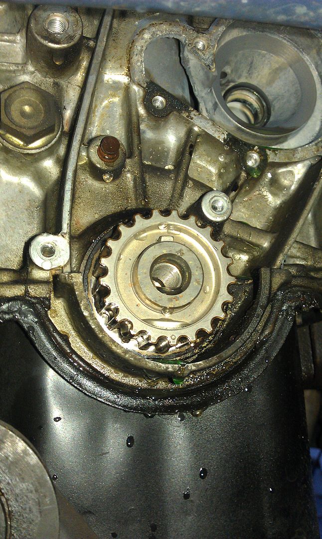

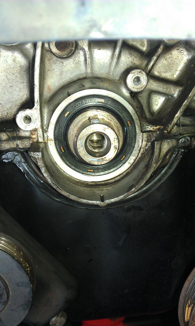

Last thing for the night was to instal new cam and crank seals. This actually took three of us to accomplish, but don't be fooled, it wasn't because it was a difficult job. No, it was because prior to this, a good old bbq and some Mexican beers had suddenly appeared in my garage and none of us trusted our own judgement, so we all triple checked everything, haha. That would also be why I only remembered to take a picture of one of the new seals, haha.

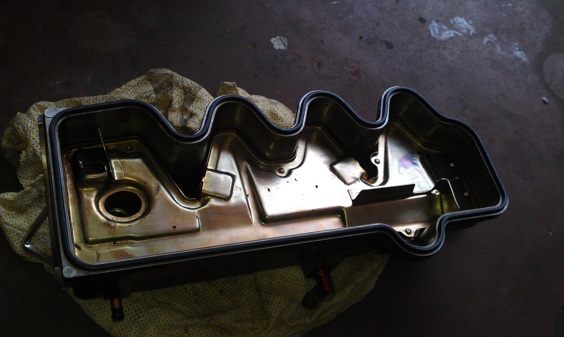

Then I pulled the old fuel filter out and the brown nastiness that flowed out of it was slightly disturbing. I don't think that the fuel filter had been replaced once in the last 20 years! New filter in and shiny looking!
New gasket on the valve cover!

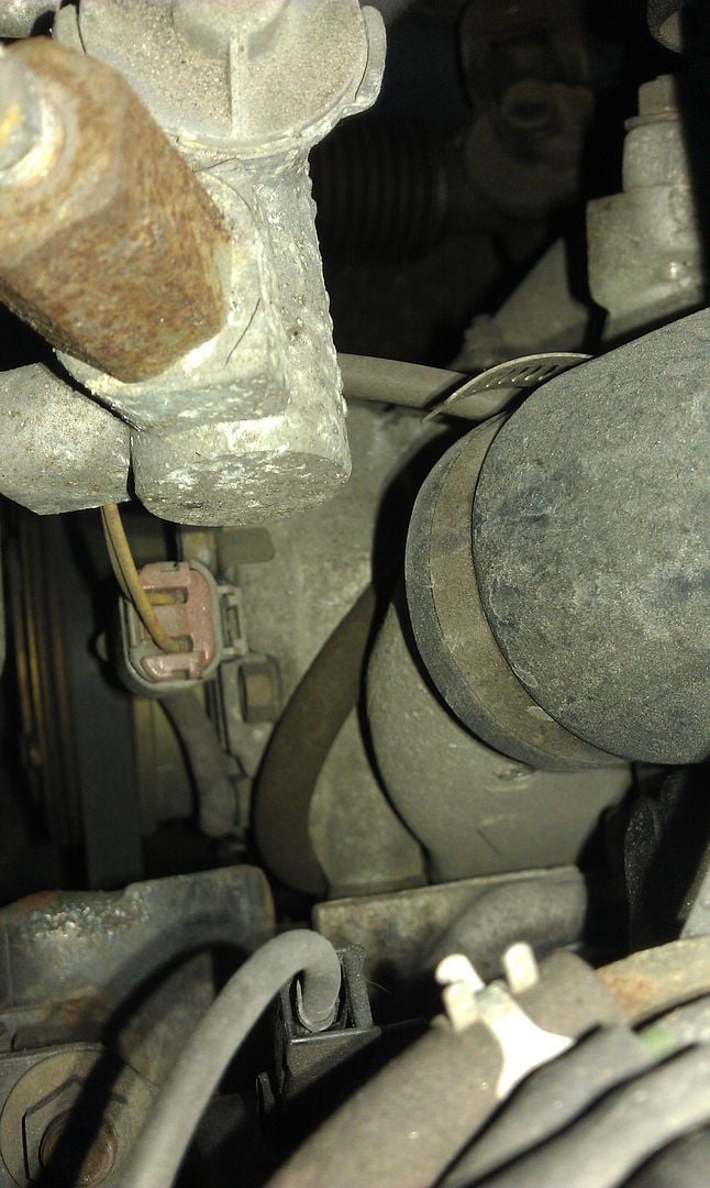

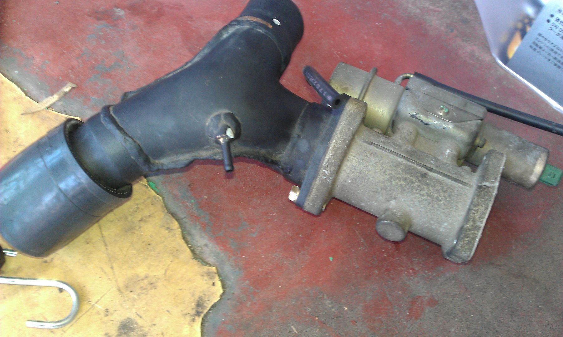

While I was inside I started looking at the bypass valve. This thing is interesting. It naturally rests with the butterfly valve half cracked open. then vacuum and boost cause it to open to regulate supercharger boost pressure and ultimately let the turbo charger take over. It's a crazy piece of engineering.
Got a buddy of mine to make sweet love to the vacuum hose for this picture, haha.

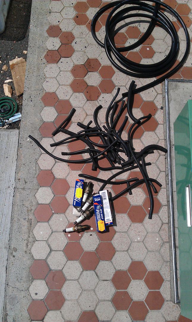

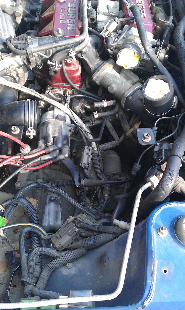

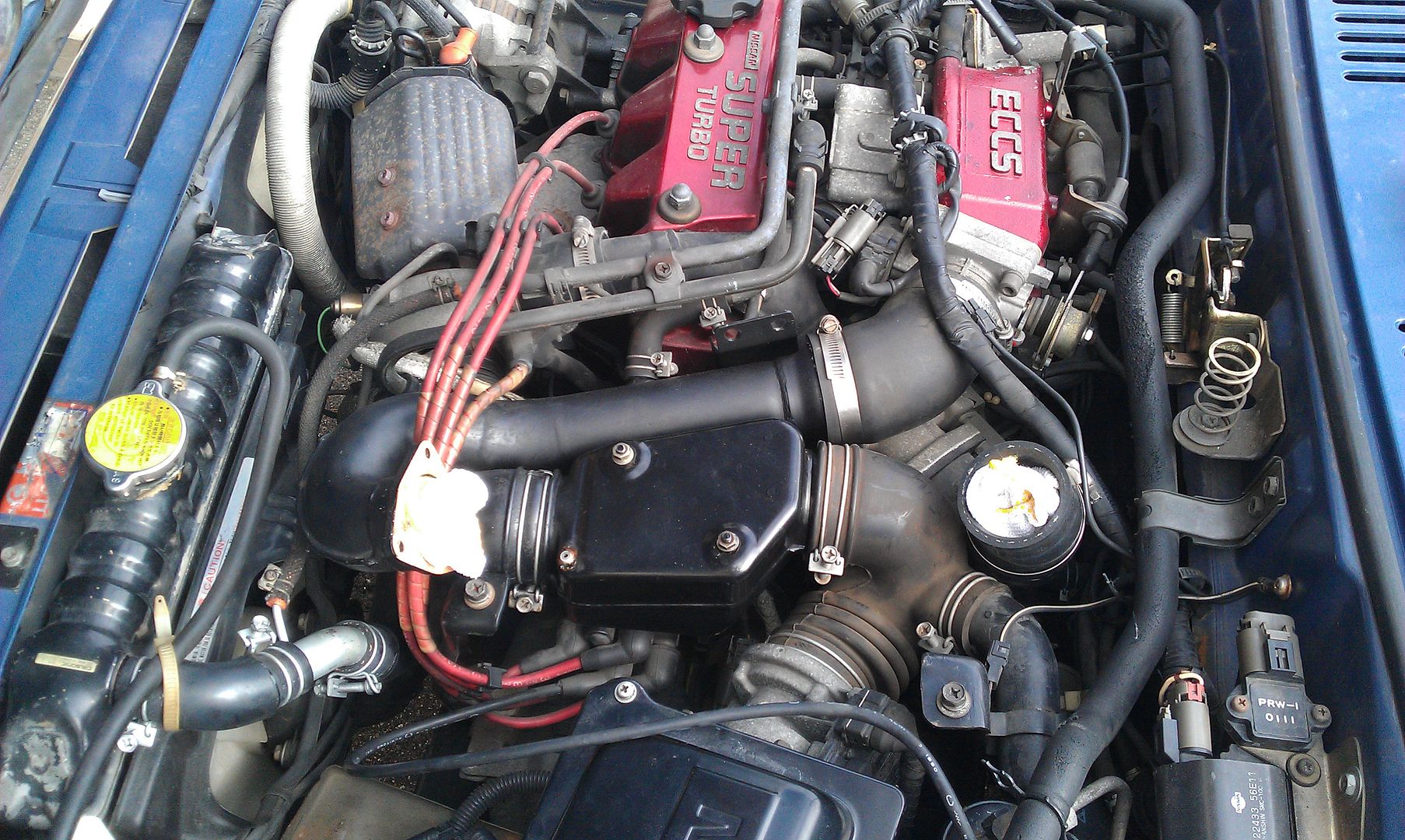

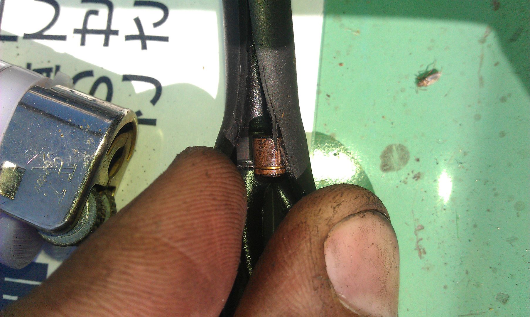

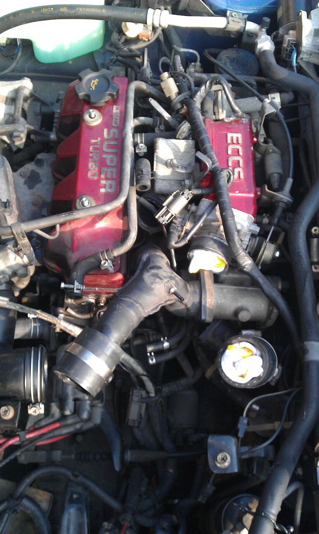

Then I started the ever so daunting task of replacing the majority of the vacuum hoses, which was a good idea as most of them were cracked! This was the most difficult thing I've ever done on a car! My hands look like I got in a fist fight with a cougar and lost. I couldn't type on the computer for an entire day after I got done! This is just a small portion of the hoses.
One of those hoses in the picture above actually had a restricter in it (although I have no clue for what reason). So I snapped a picture of the restricter before pushing it into a new hose and installing it.
The majority of the old hoses.

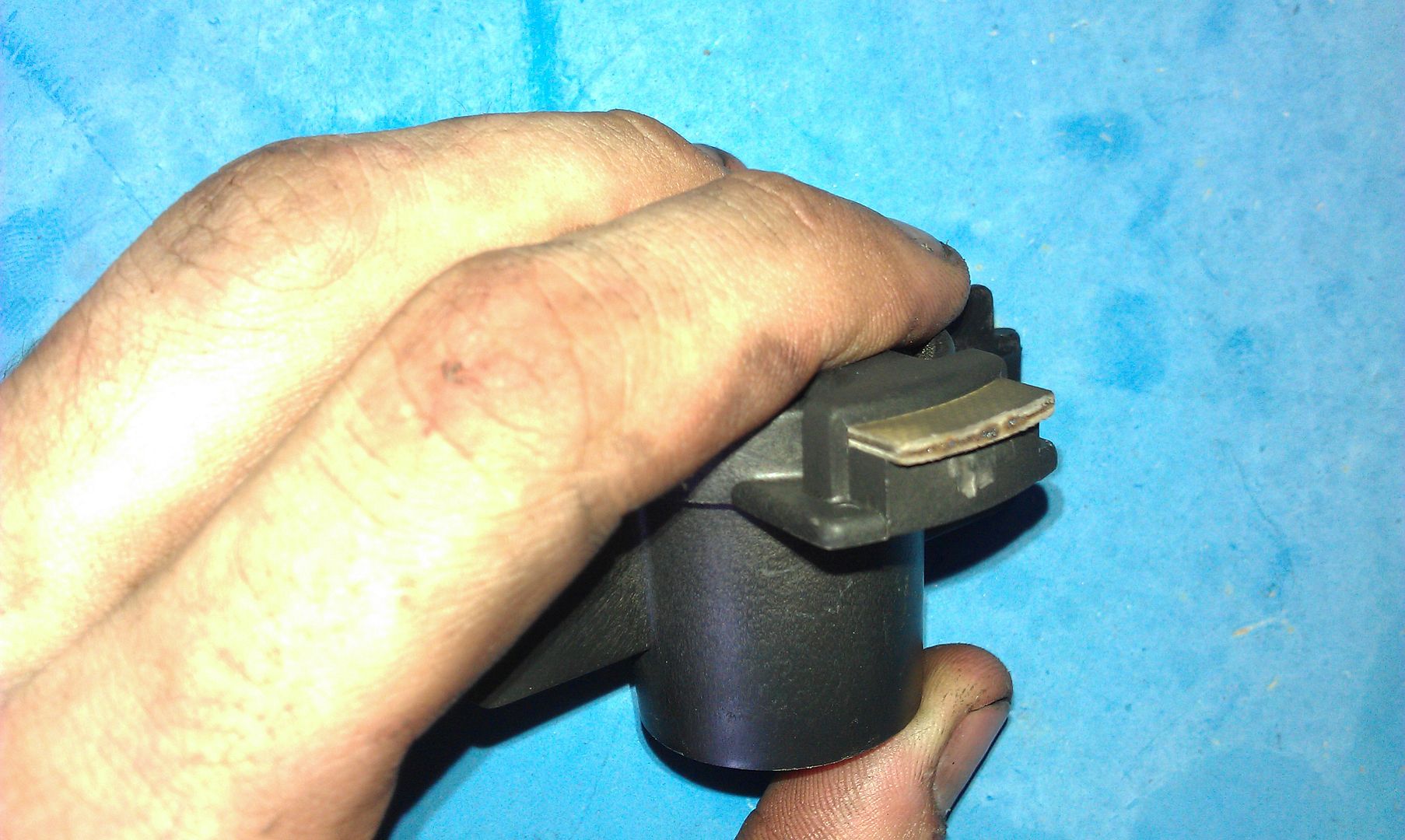

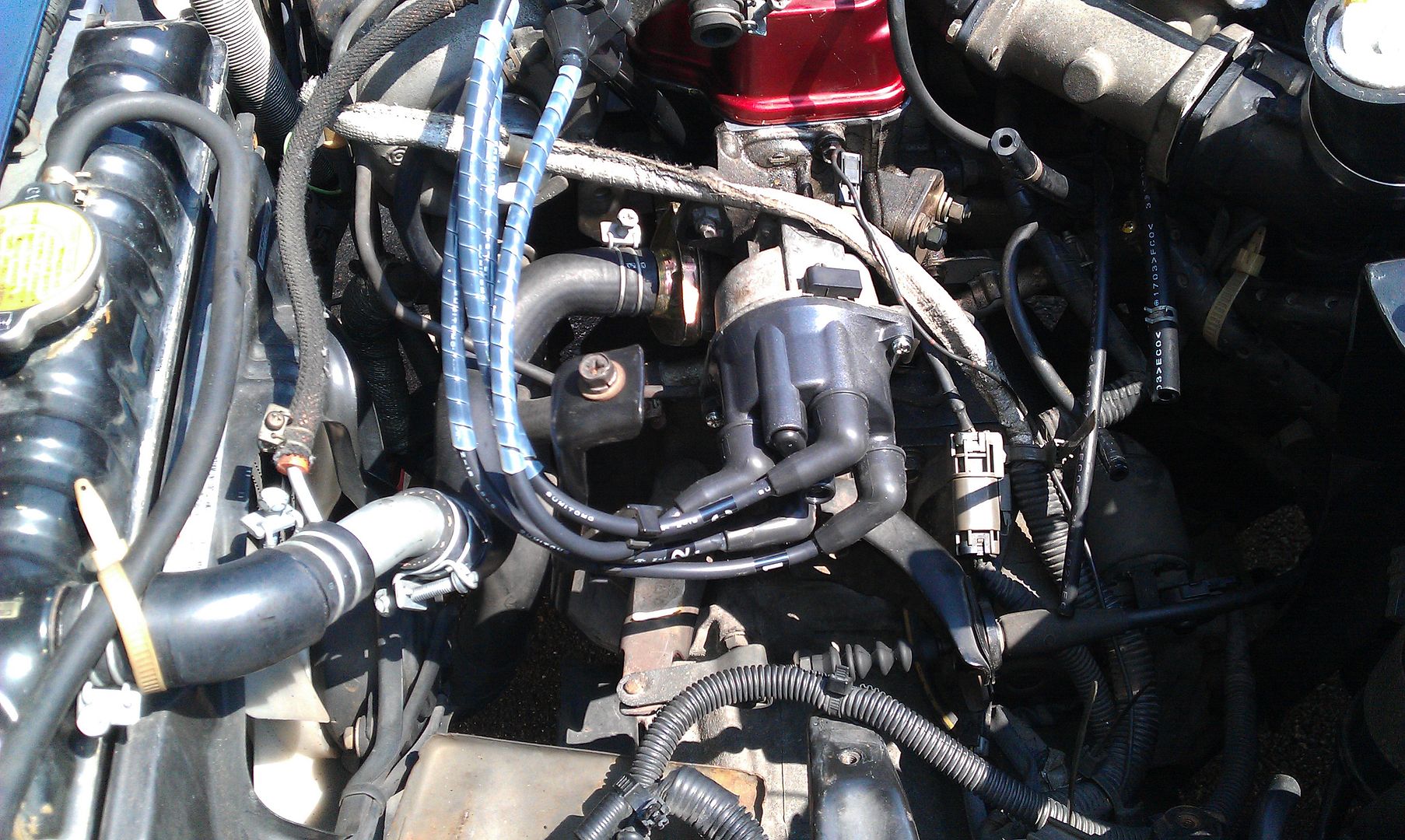

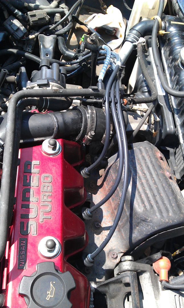

With all the vacuum hoses replace I got to work on the ignition system. New cap, rotor, wires and plugs!
Turns out this was a good thing as the old rotor looked like it had seen better days!
That was all the new parts so I plugged everything back together except the motor mount, belt covers and drive belts and started her up hoping for hte best. She started and purred like a kitten, smoother than I could have hoped for. After a little happy dance and some quick revs to make sure nothing was going to suddenly explode I shut her down for final assembly.
Drive belts on and new air filter in!

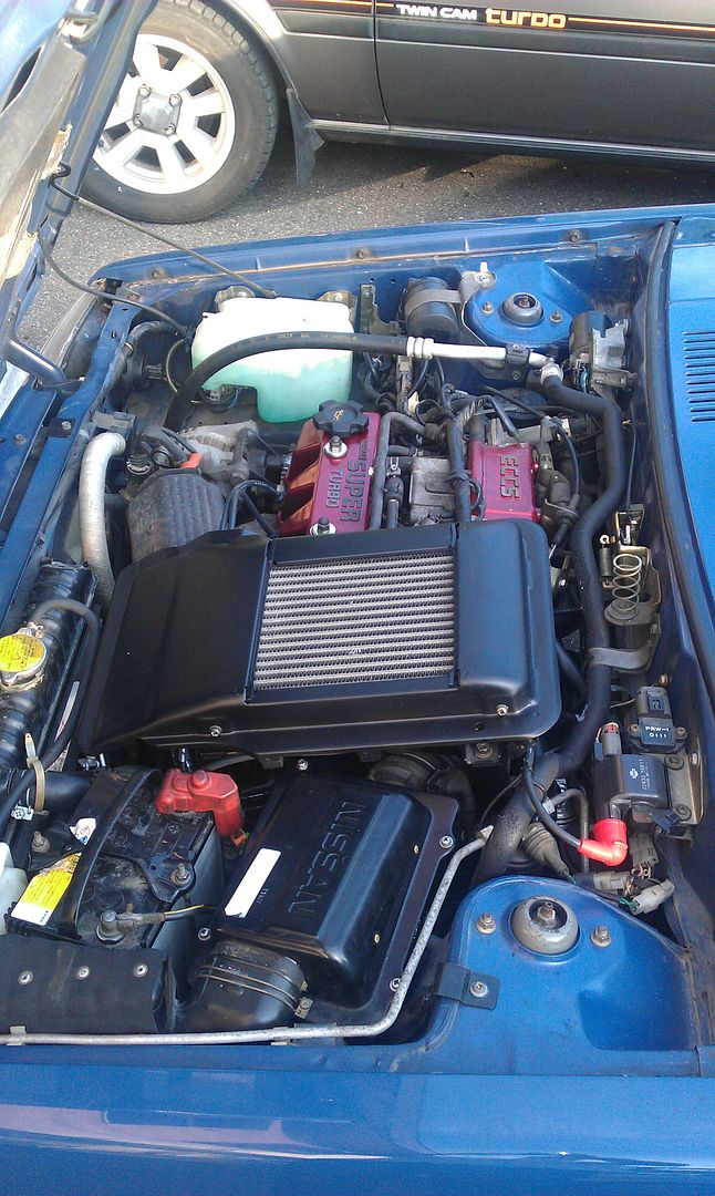

Final step was tossing the intercooler shroud back on after I hit it with some sandpaper and paint!

Also the boost flucuation is caused the bypass control valve or UFO As we call it, its pictured in one of your photos, its on the drivers side beside the washer jet water tank, looks like a UFO with One 6mm vac line and 3 x 3-4mm lines underneath. This is the cause on the flucuation, only way to cure this is to buy a brand new one

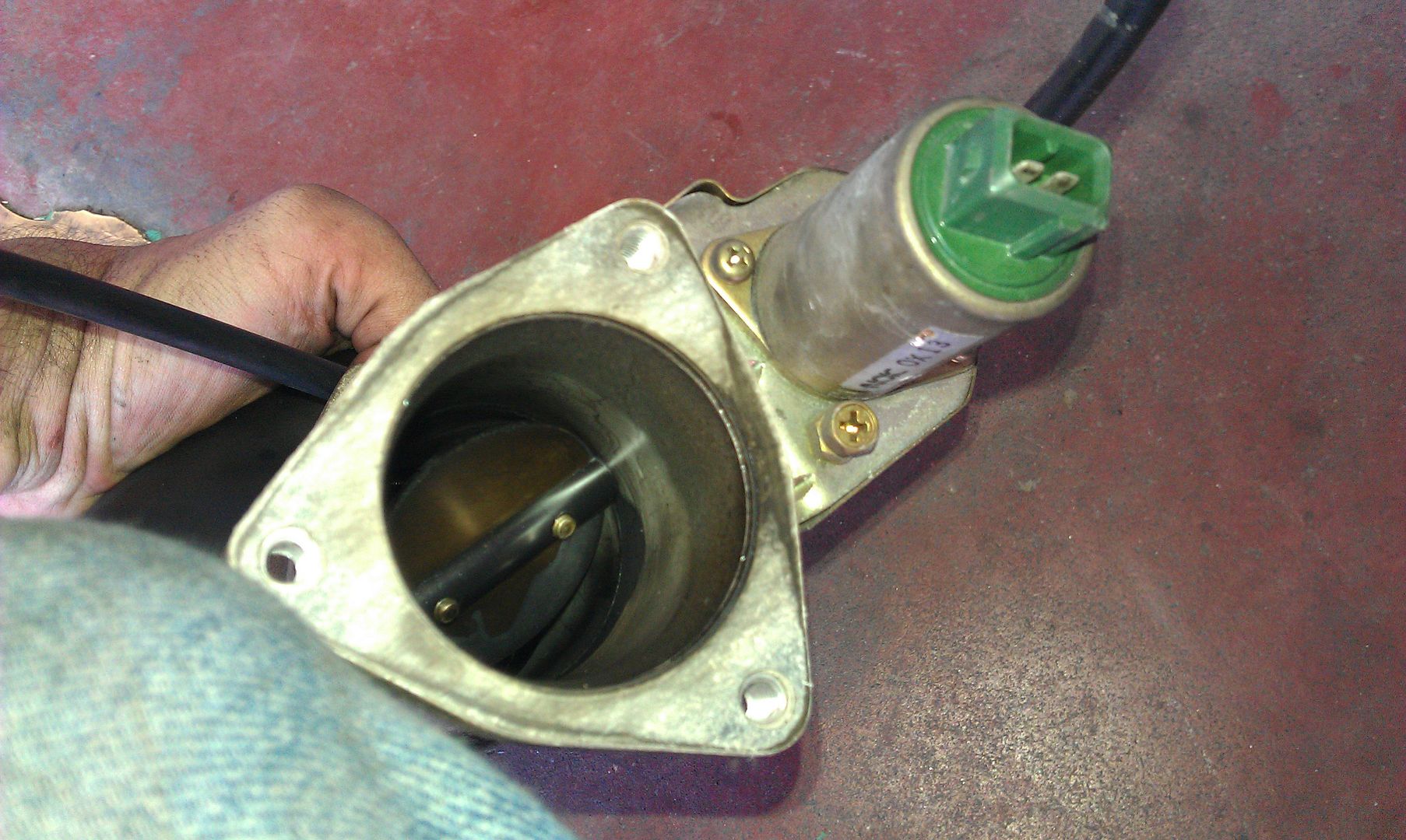

On the UFO topic, this seems to be a pretty widespread issue. I've been mulling over how to fix this and I think with a little ghetto engineering (and copious use of a welder) I've got an idea. After looking at the only diagram of the guts of one I can find it appears that aside from the four inputs it's exceedingly similar to a bov. I think, with some backyard engineering on a bov to create a third small chamber below the valve (where it feeds in to the intake pipe normally) with one nipple, two nipples in the exhaust port of it, and a third nipple just below the diaphragm, we should have something that gets pretty close. This probably sounds like crazy talk at the moment, but I think with a good adjustable bov and some proper welding and effort we can start making adjustable replicas.
I'll draw some pictures and spew some more ideas on this in the near future!

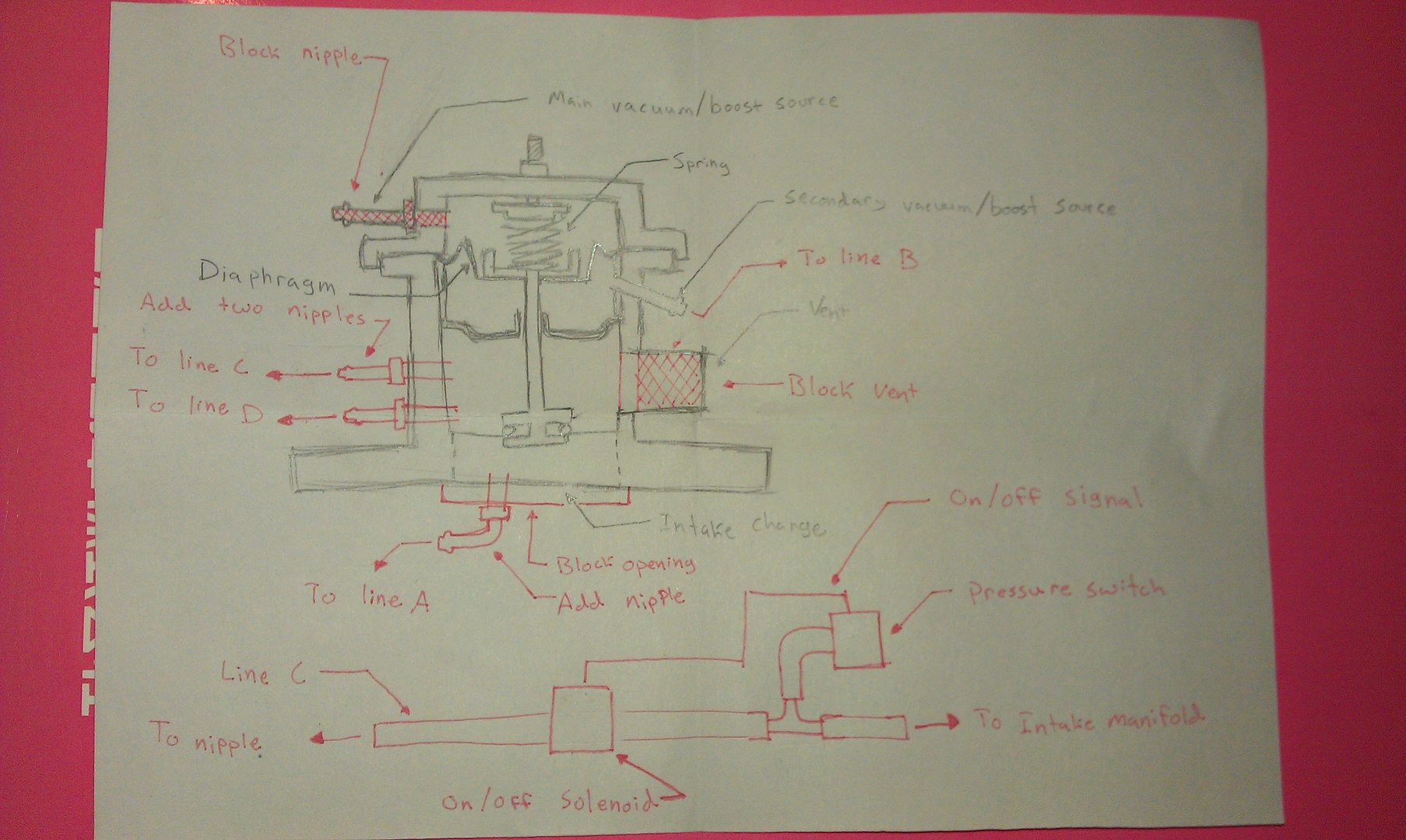

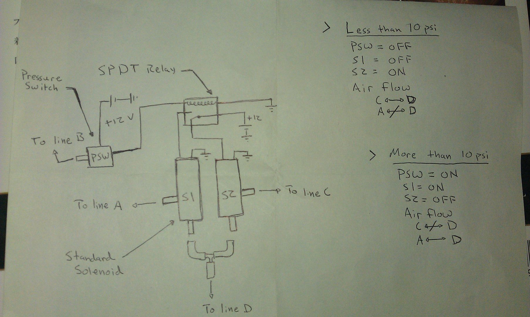

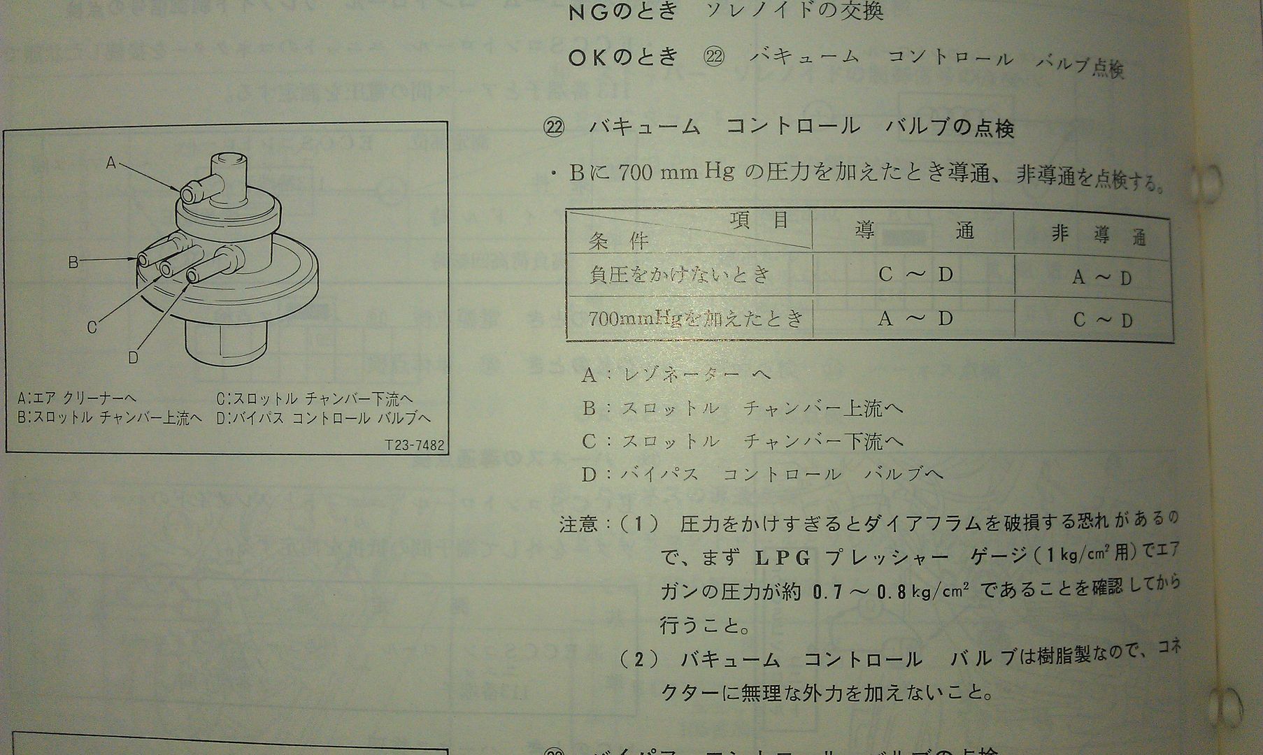

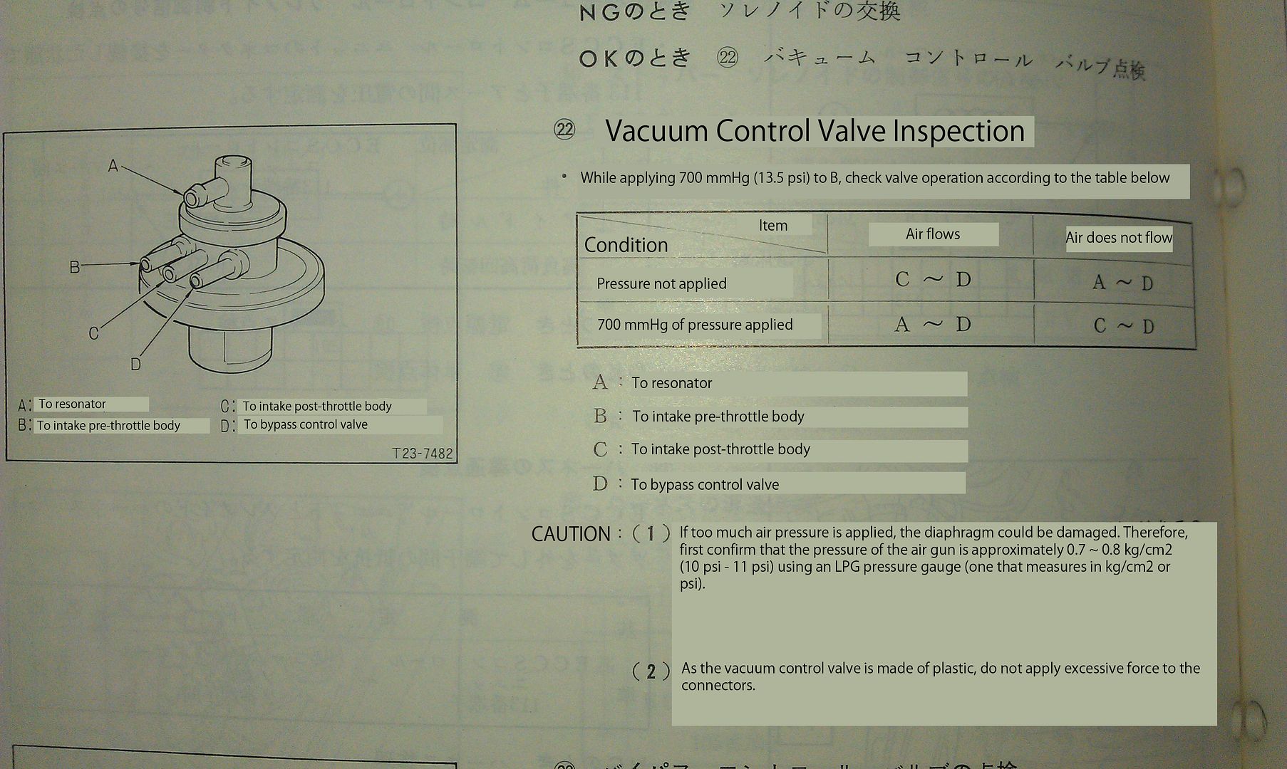

I've been really thinking about this UFO thing, and I might have come up with a workable solution. Let's see if I can get the spaghetti of thoughts in my head onto paper!
Starts with the repair manual. In Japanese, which is fine, but not overly helpful...
Ah, translated by yours truly! Much better!
Okay, now lets post up my favorite diagram again to get an idea of what each line does on the inside of the valve.
Alrighty, some explanation of the colors in relation to the repair manual.
Magenta = Line A
Yellow = Line B
Green = Line c
Red = Line D
Okay, according to the RM, when there is no pressure applied to B, air flows between C and D but not between A and D. When pressure is applied to B, air flows between A and D but not between C and D. This must mean that when the diaphragm pulls up, it blocks off Line C (green). This particular characteristic is a pain to implement. However, I think I might have a solution.
First let's look at a Greddy Type S BOV.
Alright, a couple important things to note here. Firstly, there's already a nipple on the bottom side of the diaphragm, this is good news. Second is, the overall design is very similar to the UFO. The spring is also adjustable, allowing you to fine tune when exactly it opens. Not sure what the spring pressure on it is, but if need be, the Greddy Type S can be dismantled and the springs swapped.
So here's my proposed modifications to the Greddy Type S to make a UFO.
Alright, so first things first, we eliminate the nipple we don't need and seal up the vent on the side as well as the intake charge inlet on the bottom. Then we put two nipples in the side and one more on the bottom. Line C is the hard one to deal with as it's the one that closes off when the diaphragm opens up. I figure if I can find out what pressure the diaphragm opens (bike pump anyone?) I can then buy a pressure switch and run a T off of Line C to read the pressure. Set the switch for the same pressure as the diaphragm and when it clicks on it'll hit a solenoid in between it and the BOV that essentially closes the line.
I'm sure I missed something completely, but this looks to me like it pretty accurately emulates the UFO. Best of all, I'm fairly certain I can package all of this into the same location as the UFO with little problem. What do you guys think? What am I missing?
Cheers
David
Are you not over looking the fact that your valve is probably working, its just not being damped correctly? Have you considered what may be wrong before trying to discard it? Try putting a very small restrictor with a filter on line 'b' to dampen the effect of the diaphragm. Consider what is actually happening under the conditions of mechanical oscillation and try and think what would efficiently resolve it.
Haha, I should have prefaced my last post with "I was procrastinating at work and...".
I'm definitely not discarding my UFO, the car drives great aside from the oscillations. I was just merely tossing out an idea that I had at work while I was actively trying to ignore work, haha. On the topic of trying to dampen the effect of the diaphragm, Line B already has a pill like restrictor in it (from the factory I believe).

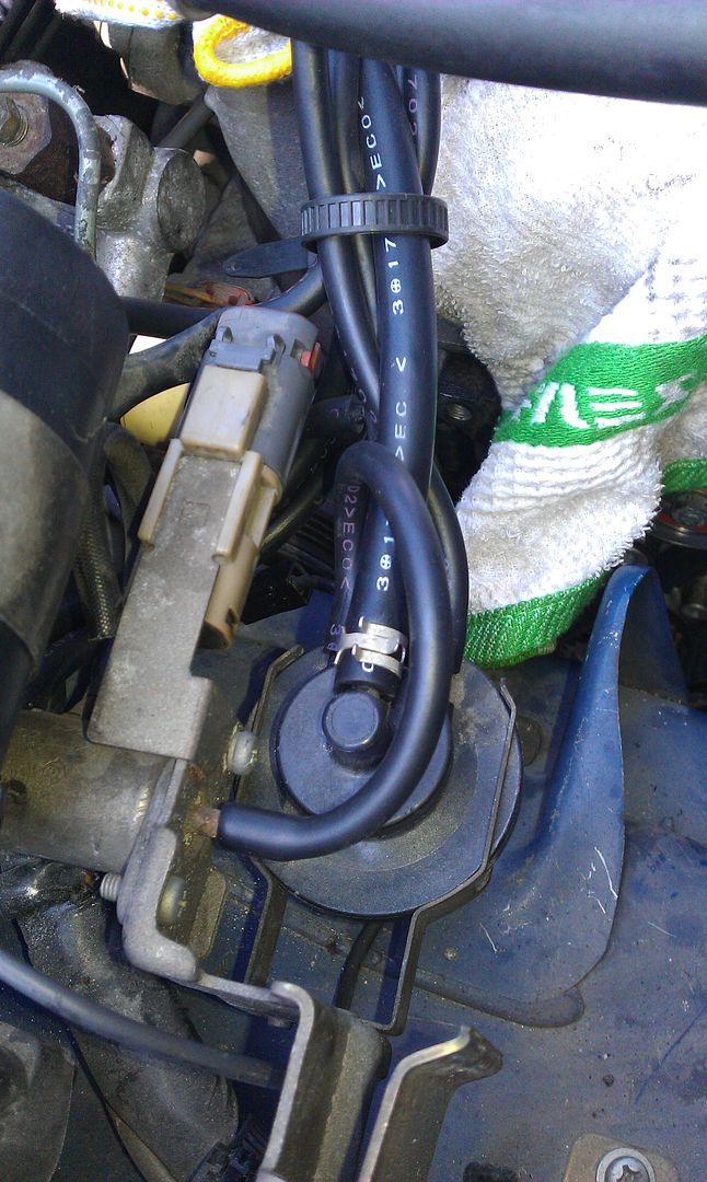

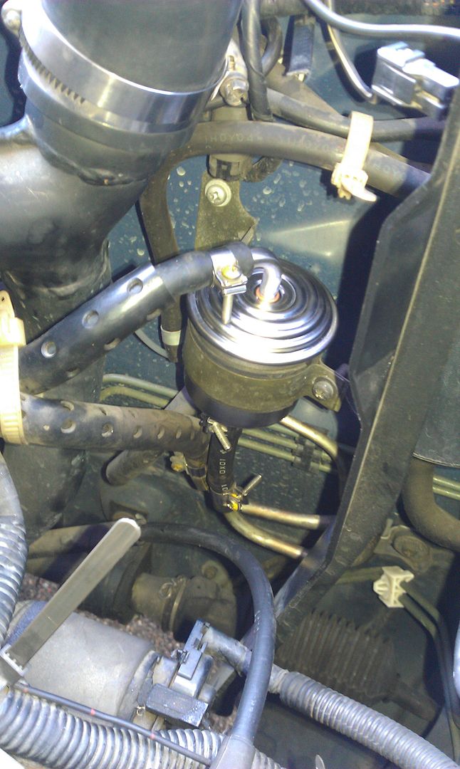

Here we go, I snapped a picture of it when I was replacing vacuum lines.
Should I double up on restrictors? What exactly causes the oscillations? Best that I can work out is, based on the characteristics of the oscillations, it has to do with the bypass valve not opening quick enough, causing a small spike in supercharger boost and then opening too far to compensate for it. However, since the turbocharger isn't producing boost yet it doesn't maintain enough positive pressure on the under side of the diaphragm to keep the diaphragm open and it starts to close the bypass valve, dropping boost down. Then it opens the valve again to bring in more boost, repeating the process over and over again. This would also explain why above 3000 rpm the oscillations start to smooth out before the turbo takes over.
Another restirctor would help keep positive pressure on the under side of the diaphragm, helping to keep it open and maybe smooth out the oscillations, but wouldn't it also cause the pressure on the under side of the diaphragm to build slower, possibly giving a larger spike in supercharger boost pressure (and maybe even ultimately exasperating the problem)?
Sorry, I suddenly hit you with a game of 20 questions, haha. I just want to reiterate, I'm not trying to suggest that anybody do the BOV modification I outlined above, I'm merely trying to bounce ideas off of fellow members. Hopefully then we can all get a better, stronger grasp of what is causing these oscillations and then, as a group, I'm certain we can come up with a cost effective solution (as this seems to be a problem that plagues more than just myself)!
But, it was just a thought, if my crazy brainstorming and hand drawn pictures aren't welcome, I apologize and will try to keep my brain spaghetti to myself in the future.

I can't stop thinking about this UFO thing, haha (mostly I really like procrastinating at work). I tried to think of a simpler way to control it and then I started thinking how you could do most of the electronically. So I came up with this design:
It actually seems a little too simple to me, but I can't figure out what I'm missing (if anything). So the way it works is you have 2 standard vacuum solenoids, a single pole double throw relay an a pressure sensor. When the pressure swich has less than 10 psi, S1 is off blocking air from flowing between A and D and S2 is on allowing air to flow between C and D. When 10 psi hits, the relay switches poles and S1 kicks on, letting air flow between A and D and S2 turns off, blocking air from flowing between C and D. Near as I can tell this satisfies all the requirements of the UFO.
Now, what I'm worried about is getting to a point where it's constantly oscillating between say 9.5 psi and 10.5 psi. This could happen because the change is so immediate, it would see 10+ psi, crack open and the bypass valve would scream open at full blast, causing boost pressure to fall off. It would drop to 9.5 psi and snap the bypass valve closed, causing it to rip the boost up again. The reason I think that a (good) UFO doesn't do this is because the progression between off and on in a diaphragm system is much smoother and a diaphragm has the capability of finding an equilibrium. Which makes me think I need to rework my BOV idea a bit to eliminate the pressure switch as this would just cause the same problem.
Although I may be entirely off on how precise control of the bypass valve works and the solenoid idea may do the trick. I'll keep brainstorming ideas!

Nakazoto, only thing you are missing is that the turbo assists the supercharger even when by itself it has not reached boost threshold yet.
So at say 3500 rpm the turbo may be producing half a bar, that means that the supercharger only needs to assist with the rest, thus its workload is reduced.
Don't forget that the supercharger increases exhaust gasses which in turn make the turbo spool sooner.
You can see this working if you put two boost gauges on the car one after the turbo and another after the supercharger.In the most simplistic form your trying to get a smooth transition from SC to Turbo, this can only happen when the turbo is self sufficient.
The trouble is there are many variables to this. The electric solenoid on the bypass valve for example is there to allow air to bypass the supercharger at idle and all light throttle loads where the demand for the supercharger is not met, this increases engine efficiency reduces wear etc on the supercharger (since it wont be spinning). This is also assisted with the vacuum tank which under these conditions will hold open the actuator, and thus butterfly valve on the bypass control valve.
The whole point of Nissans system is to allow a progressive transition from one to the other. The other interesting thing is how the ecu defines load since its only inputs to control the solenoids are throttle position and airflow. Its interesting to note that the ecu and electronics actually have no idea of boost level at all.

A whole lot of ghetto wiring! Also, full throttle switch, master switch, override switch and potentiometer back in place on the board.
Alright, testing! Kicks the little light on and off at adjustable intervals with the override switch and master switch both on, just as planned.
Override switch off, but full throttle switch pressed gets the light flashing as well!
The only visual change inside the car. Ignore the green wire falling down in the back, I hadn't hooked it up fully yet, haha.
Full throttle switch.
Board mounted to the inside of the dash, still reachable from the drivers seat so you can adjust the on off timing, but completely invisible unless you're a serious contortionist! Also to note, I used double side tape for everything as I wanted nothing permanent and no holes, so I could rip it all out in a matter of minutes if I got sick of it. Not sure if this will backfire on me and have the full throttle switch falling off. We'll see. I may upgrade to zip ties on the full throttle switch in the future.

Before I shut everything down for the night, I got a picture of my buddies Evo 5 parked next to its much much older grandad, haha.

And Oranje, your pictures of the UFO when you took it apart have also been helpful, but I couldn't really see the guts of the UFO. What I want to know most is how the pipe routing inside works, mostly, how it cuts off flow from one pipe when the diaphragm moves.

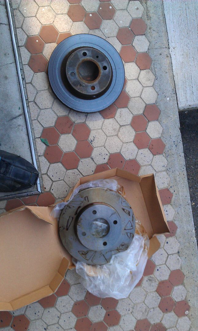

The front brakes looked like they were made entirely of rust, so I bought some pads, discs, shoes and brake lines for a full brake overhaul! Unfortunately, I purchased the wrong discs and the rear shoes had so much life on them it would have been a waste to replace them, haha.
After a quick trip to Nissan and a huge sum of money later, OEM brake discs!
New hotness!
New pads are endless carbon cermaic!
All on and ready to rock!
After a few quick burn in sessions I decided to do some emergency braking to see how it did. First things first, the car is a completely different beast, tires are what's letting me down now. A good set of stickies and this thing will stop damned fast! Small problem though in that the passenger rear locks first and throws the car into a very entertaining slide, haha. Found that one out the fun way! I think some new tires will remedy that though.

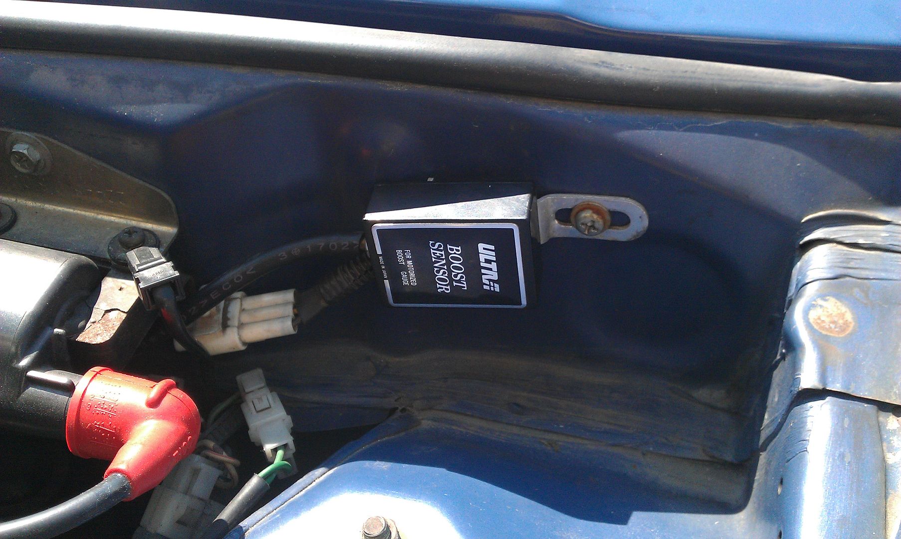

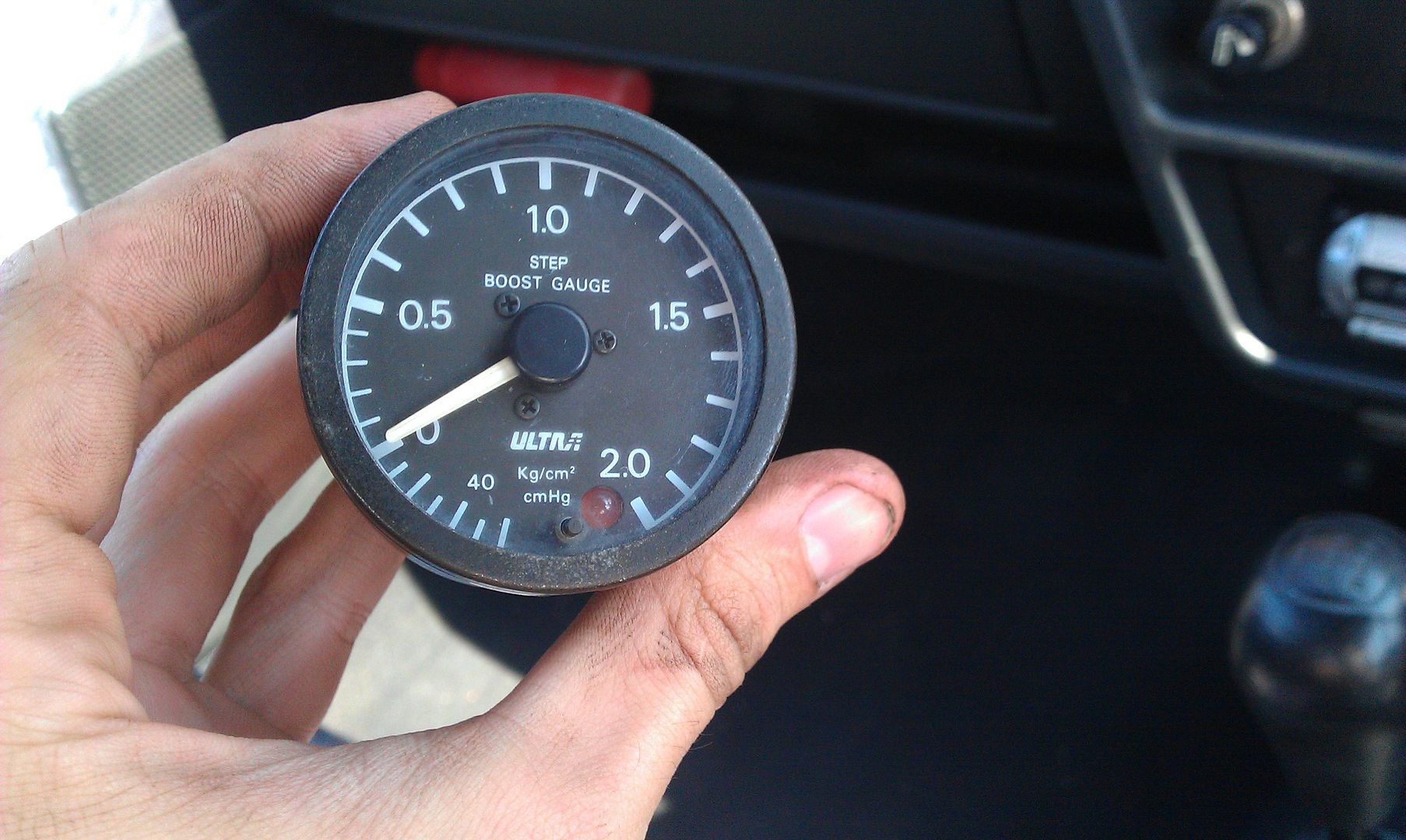

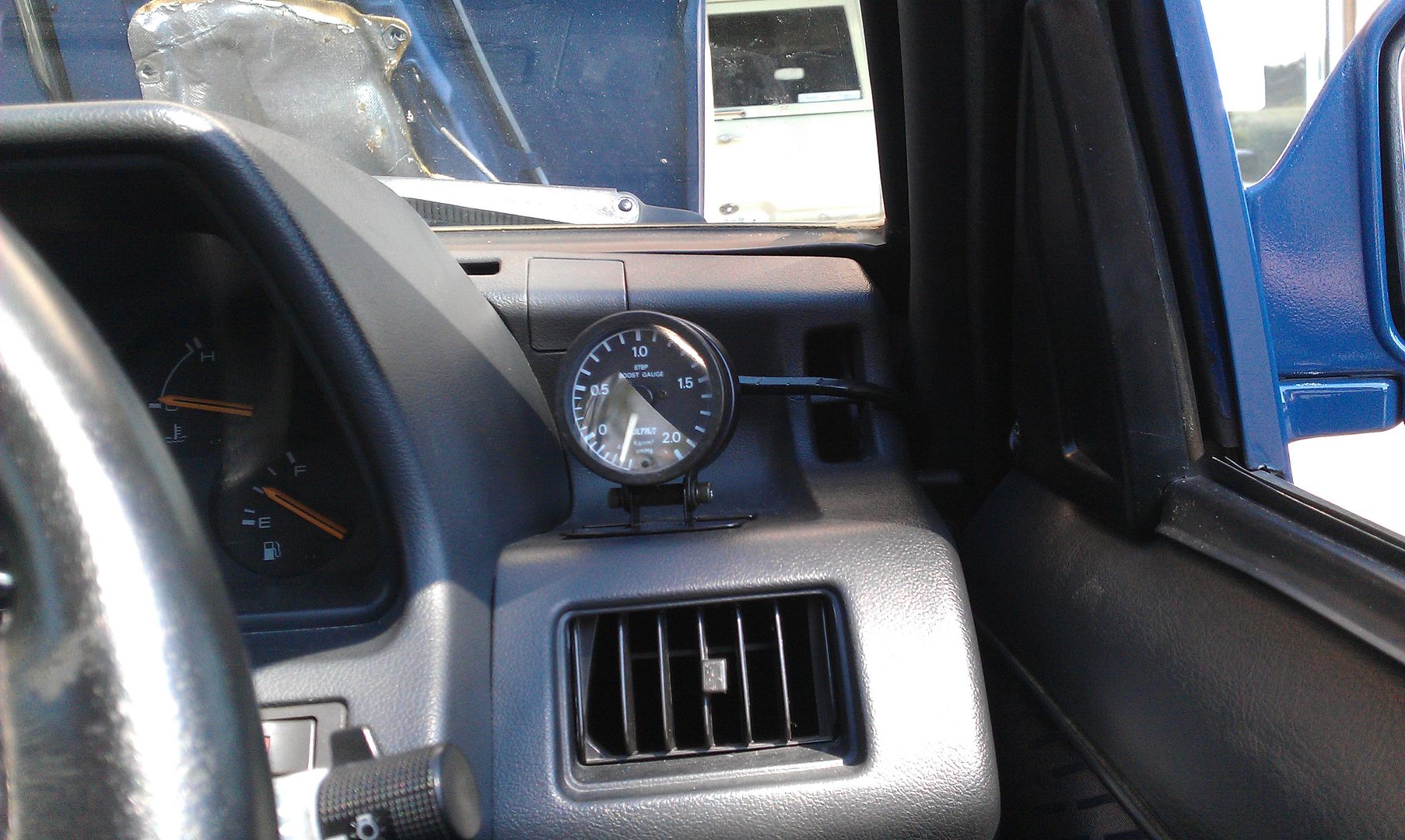

I also ordered a new boost gauge on Yahoo Auctions. I somehow managed to find an almost period correct Ultra boost gauge, I was so stoke and it looks absolutely fantastic!
I temporarily mounted the sensor here. I'm pretty sure it's supposed to be kept vertical and I will remedy that soon enough but for now it works like a charm.
Right at home!
More to come soon as I think I have a pretty solid idea on how to fix this boost wobble issue! Just waiting on more Yahoo Auction parts!
