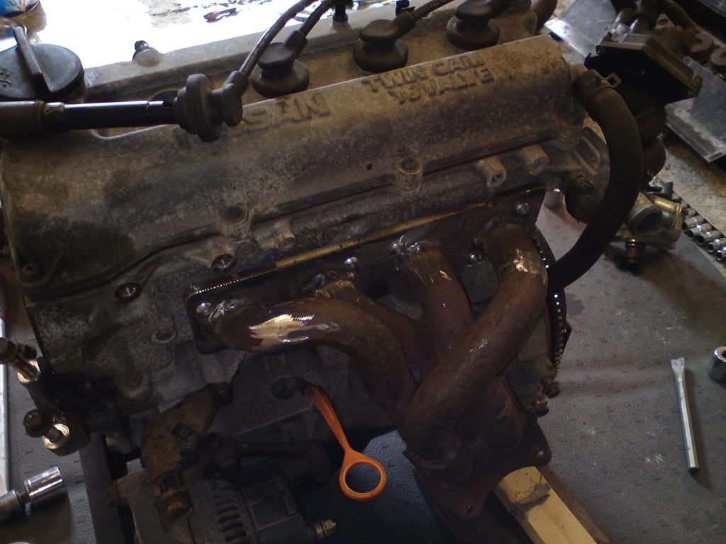

Inspired by a picture in bigchief36s DET mini thread, when I got the engine I also got myself a manifold and downpipe off a Rover 25.
So here's a 'how I dunnit'

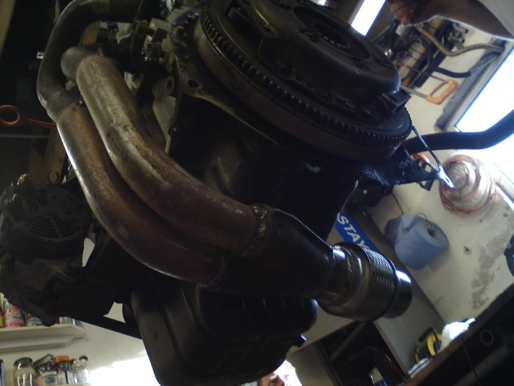

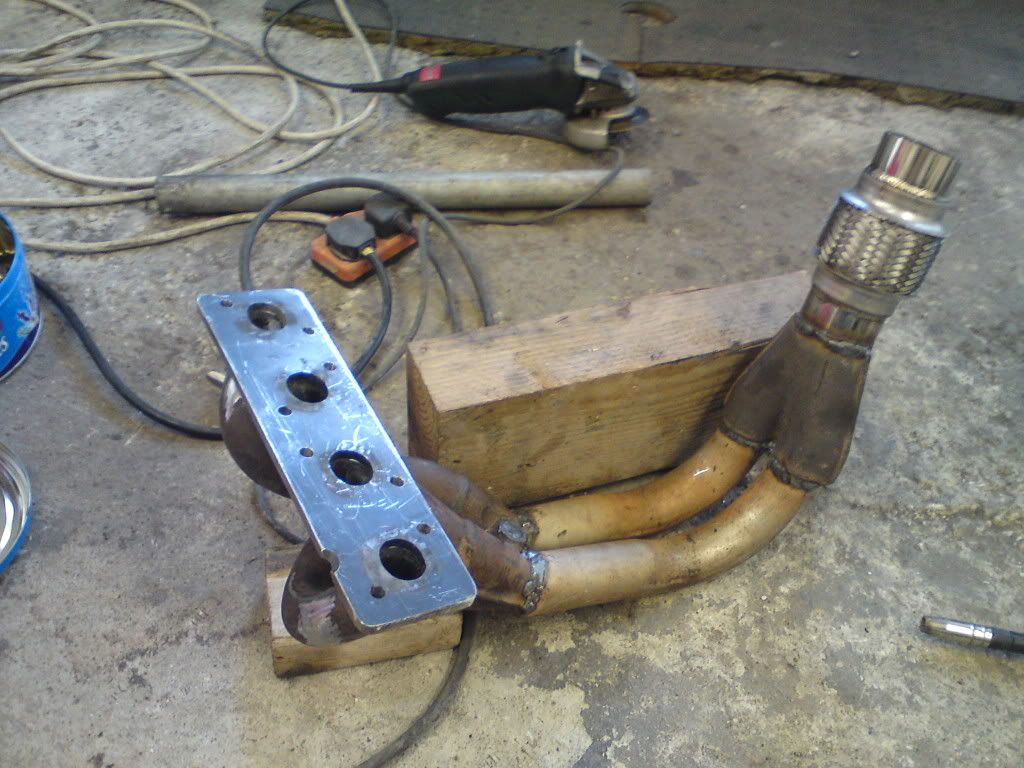

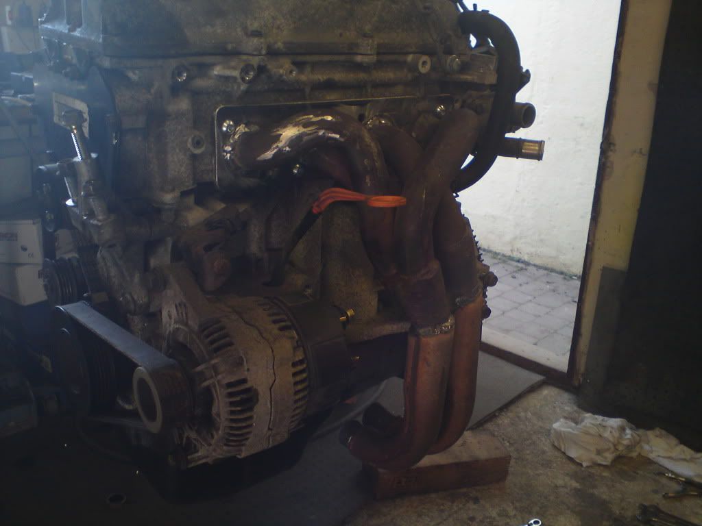

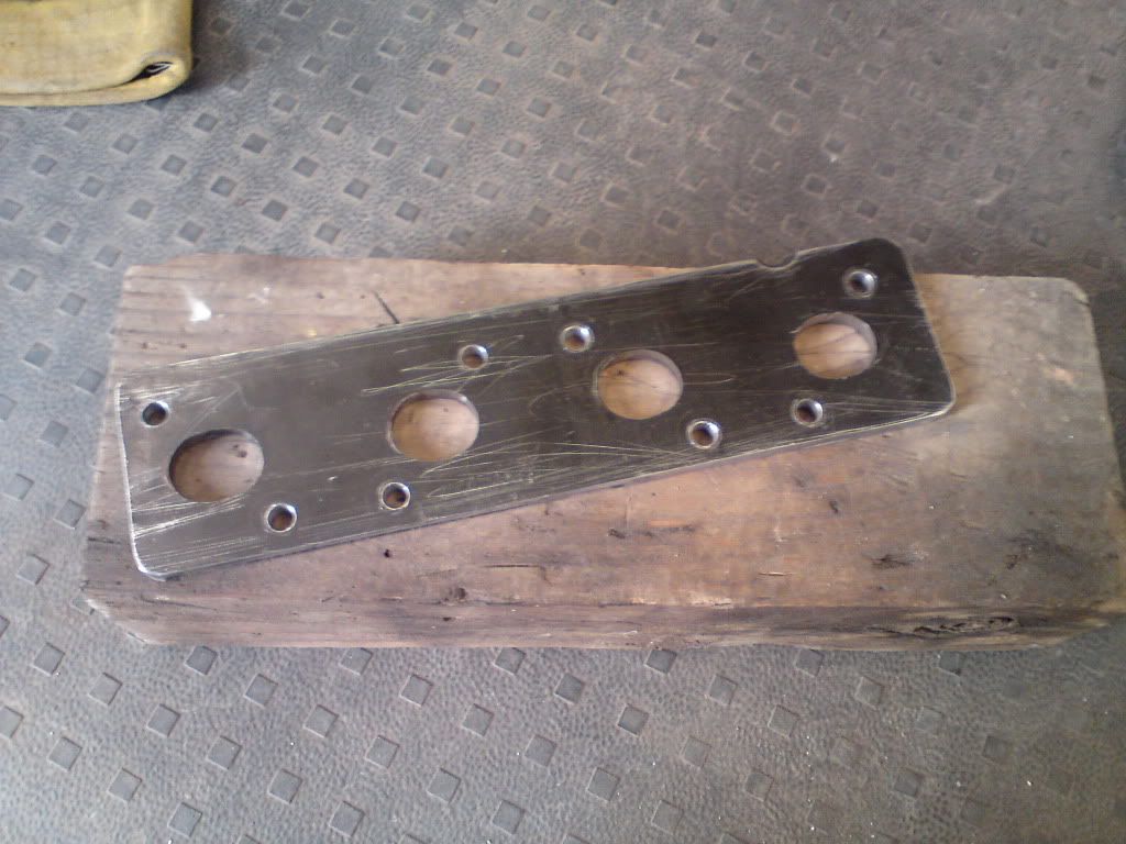

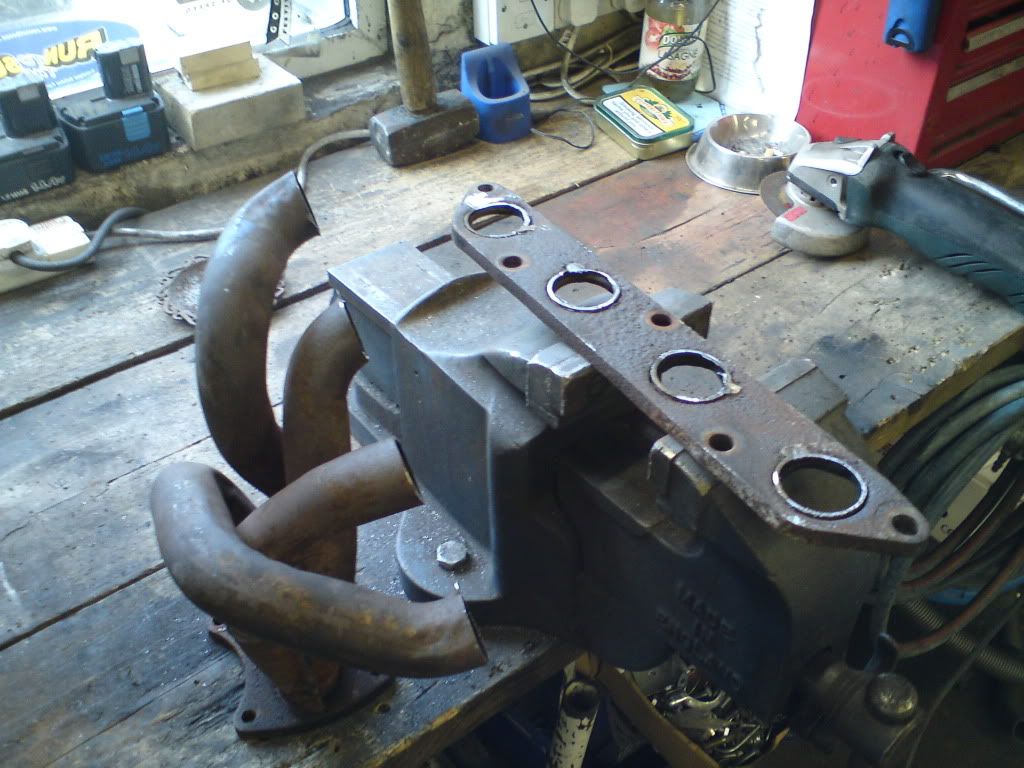

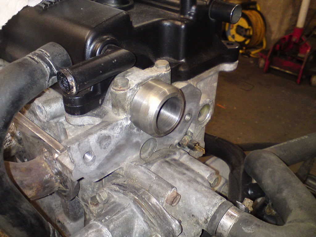

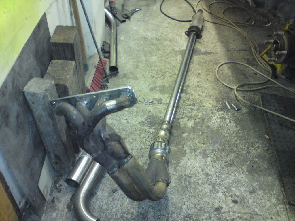

Cut off the original flange
Make a new CG flange out of 10mm plate

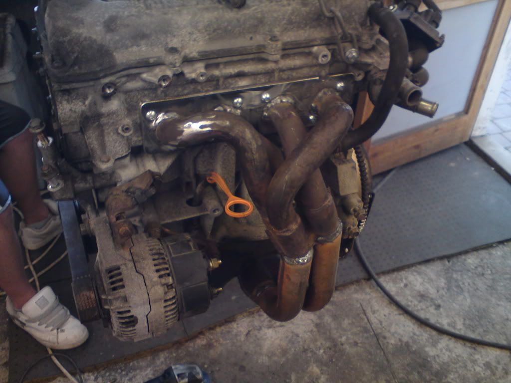

Chop the outside 2 pipes about to make them fit the CG port spacing and attach to flange

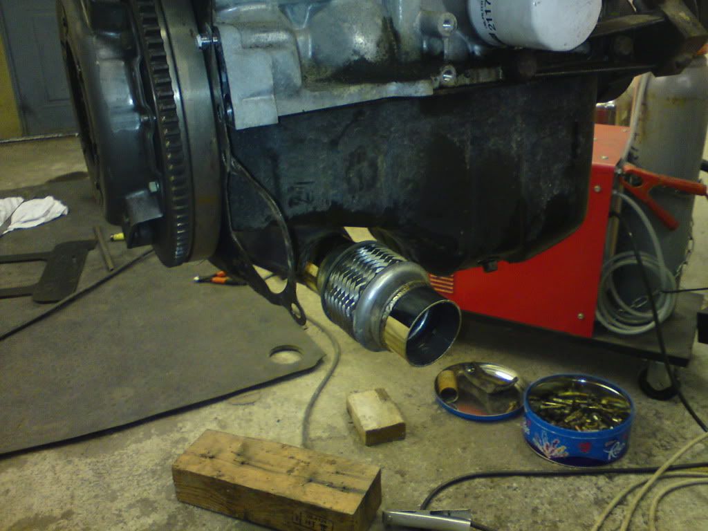

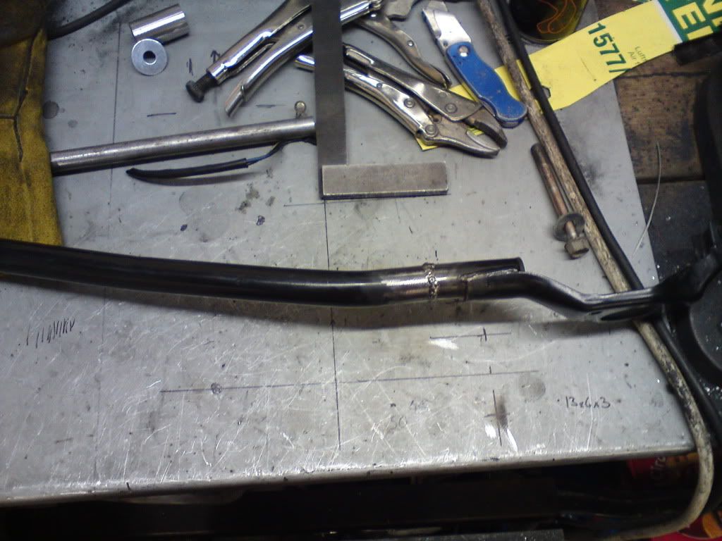

Remove downpipe flanges and modify downpipes to follow the sump shape, weld inner and outer pipes to manifold
And add accumulator and stainless flexi that's been kicking around in the garage
Bolt back onto engine

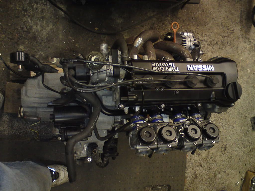

More progress (Y)
Picked up the collar Monday night, seen here in situ
Took the dizzy to work Tuesday, guy that was meant to be doing it forgot to do it. Nevermind as SWMBO picked up the special order exhaust bends for me from the local factors. Came home all excited expecting to be building my inlet manifold only to find that they'd ordered the wrong size. Spent the evening in the garage rebuilding the garage computer instead.
Today was better, got the bends ordered through work, they'll be here tomorrow. :grinning: Guy at work did the dizzy :grinning:
My hybrid dizzy

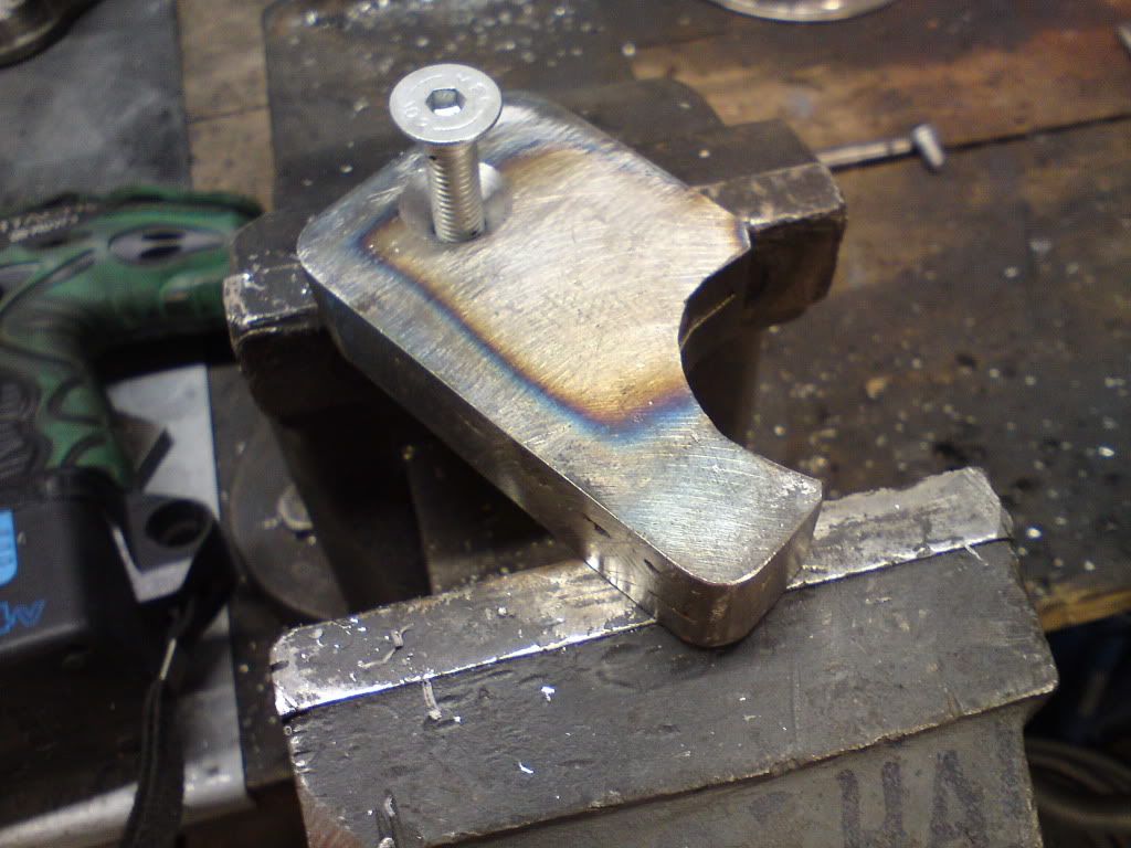

Now all I needed to do was make the section for the dizzy to bolt to.
The spacer needs to be 20mm thick, I'd only got 10mm so 2 bits were welded together and angle grindered into the right shape, hole drilled for mounting bolt.
Welded onto the collar, welds smoothed, hole drilled and tapped to hold the dizzy into it, painted and fitted(Y)
Well pleased with that. Inlet manifold tomorrow (Y)

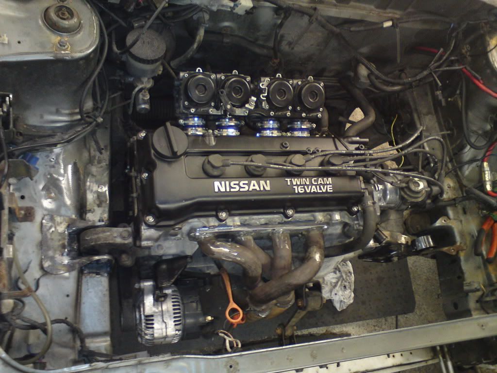

MORE PROGRESS!! :D

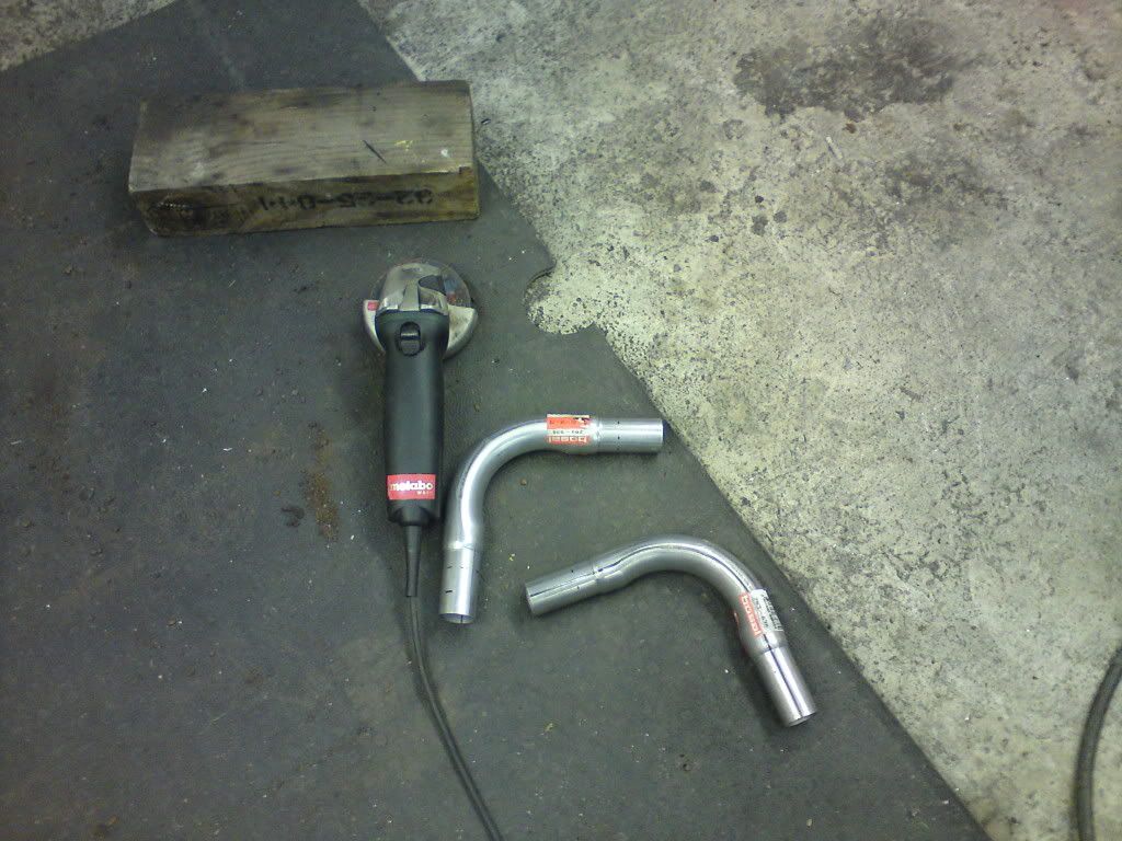

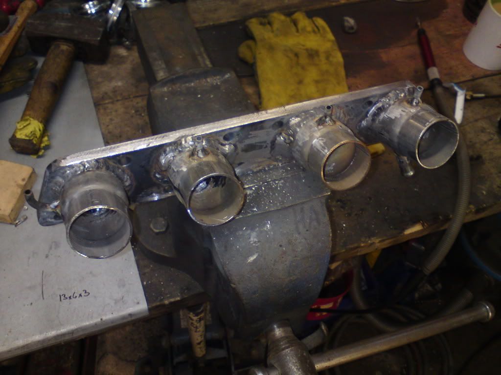

Thursday at work brought some very interestingly shaped 38mm bends, it looks like they are 45mm bends with the ends shrunk down to 38mm.
This put paid to my original idea for the manifold as I wanted to keep the carbs quite close to the head. After much deliberation I finally made the cuts, then tickled them about with the soft pad on the grinder to get them to sit as right as possible, finally welding them on at about 11pm. Had to have a trial fit to see if I'd got the manifold right.................Success! :D
Today I took it to work and spent my breaks welding and die grinding the inside into a nicer, curvier shape (round pipes, weird cloud shaped ports)
When I got home I got to work adding the take off for the servo, which I cut out of the spare K10 manifold I had, and buzzed it in
Then I got on with the take off for the vacuum advance and the balancing take offs. The piece of pipe I'd had set aside for this turned out to be made of some kind of odd alloy, which of course I only discovered when I tried to weld it in into manifold.
Looking around the garage the only suitably sized pipes were the vacuum take offs on the spare K10 and surplus K11 manifolds, some deft cutting and welding later I have all the take off I need.
Cut down 16 allen cap bolts to the right length for the manifolds and 10 stainless button head bolts for the rocker cover.

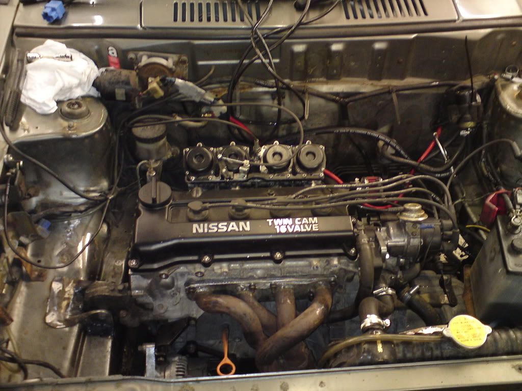

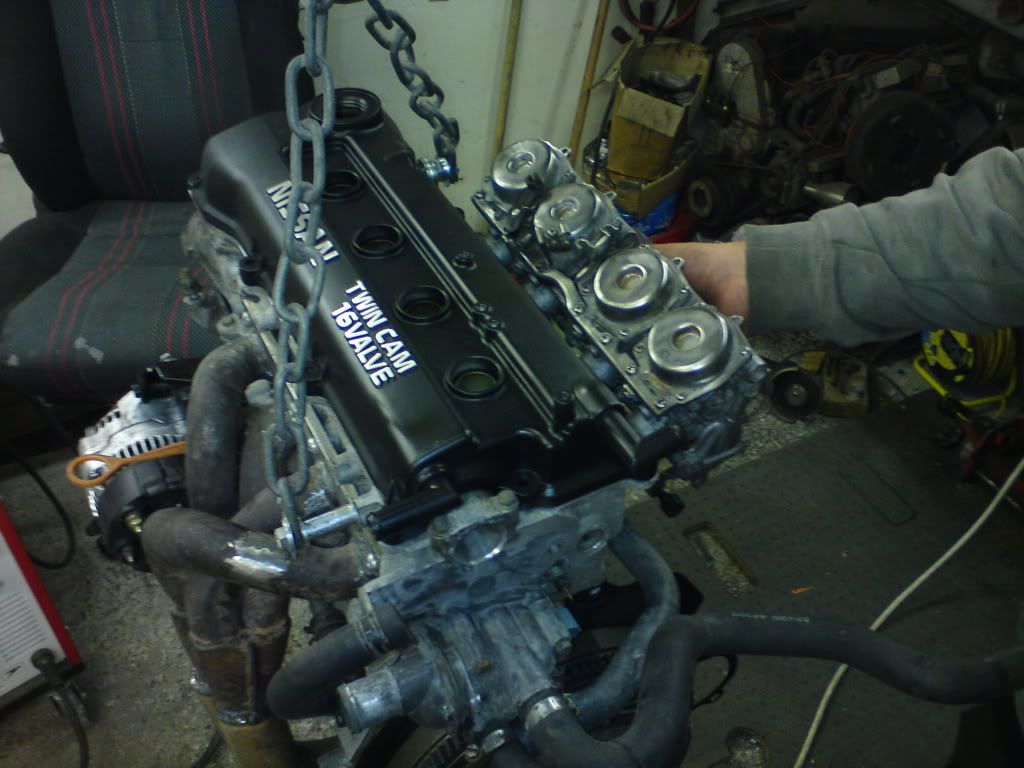

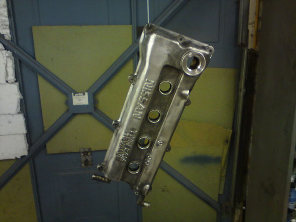

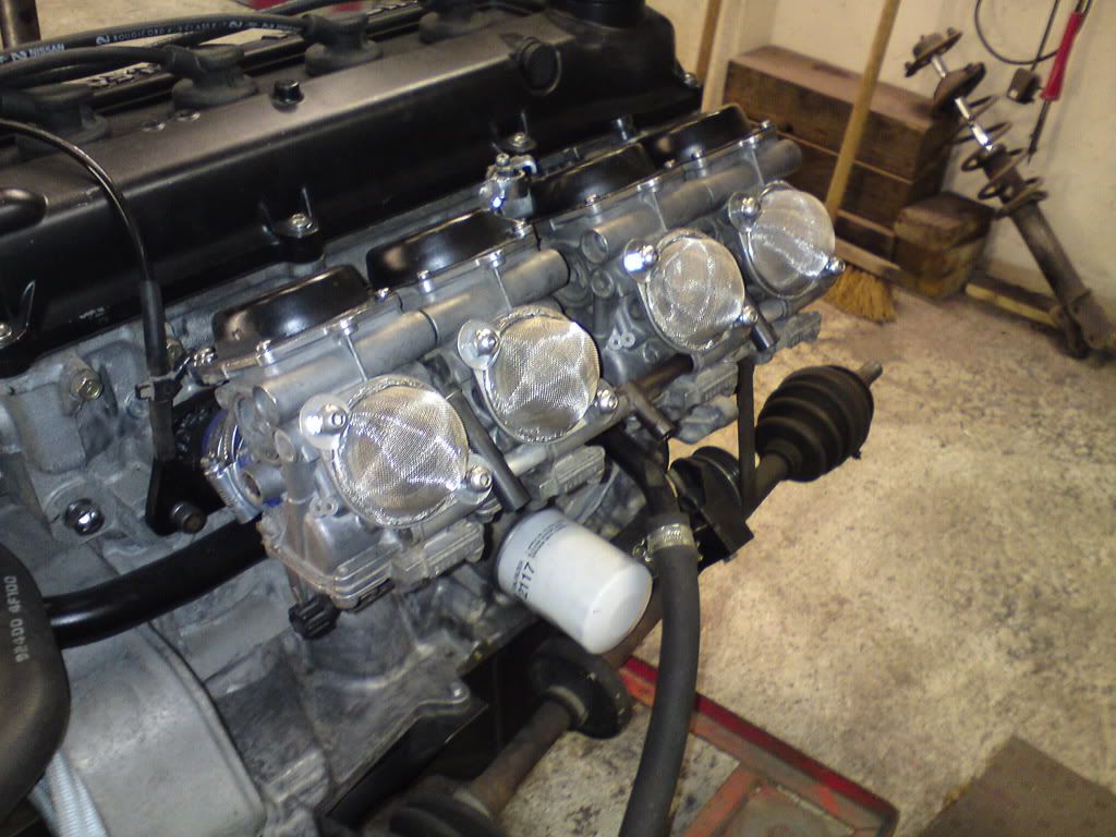

Fitted the rocker cover, plugs and leads while the paint was drying on the inlet. Discovered that I'll need another No2 lead as No3 lead isn't long enough to reach the K10 cap, all the other leads fit though so that's a bonus :).
Fitted the inlet, carbs and plumbed up the vacuum advance. Then fitted the rubber caps to the balancing take offs.
More soon!(Y)

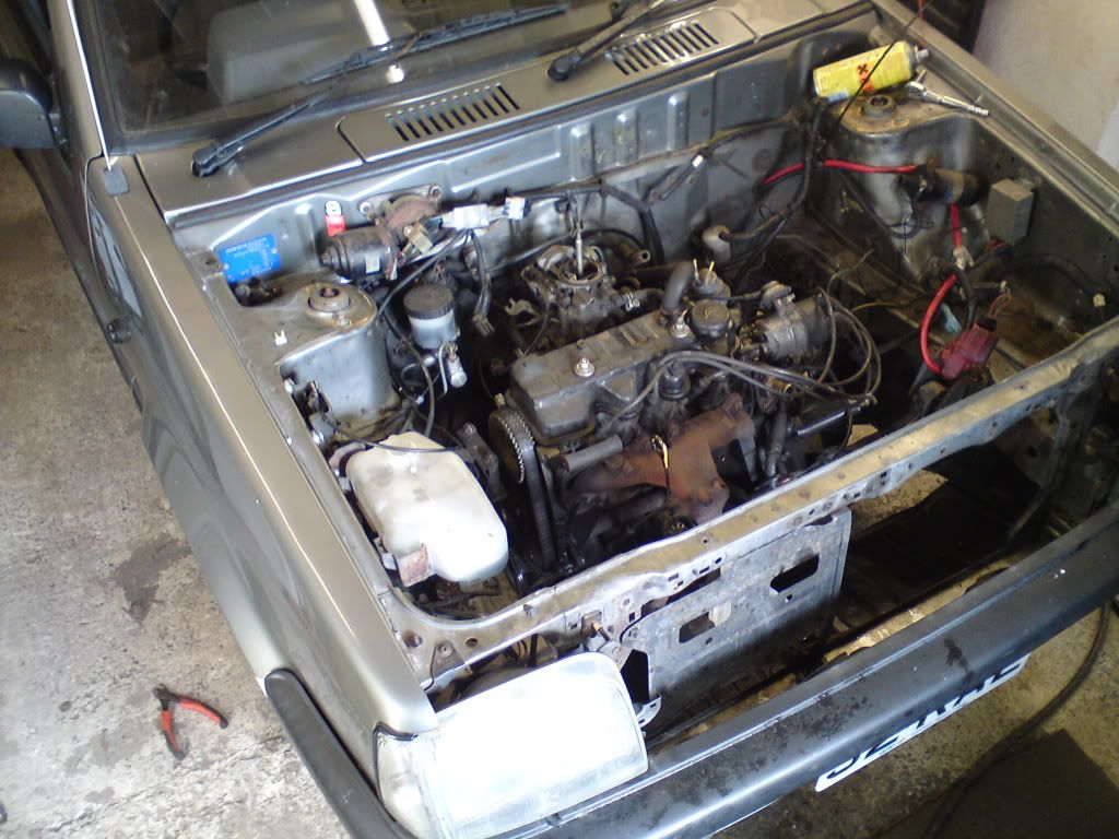

After spending a great day up at Area 52 yesterday, I got the garage sorted out so that there was space for my car in there.

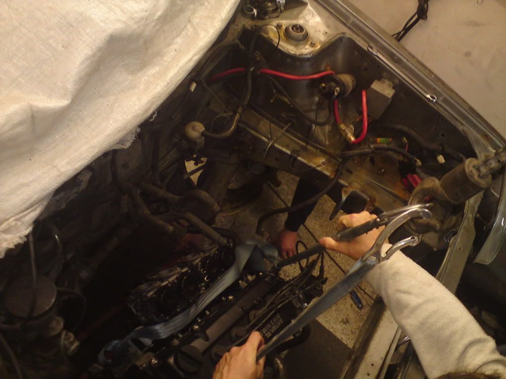

This morning 24vster and myself dropped the coolant and removed the rad out on the road, so we wouldn't have to work in a puddle all day. With the car in the garage work commenced on getting the very tired MA12 and all the front hubs, wishbones and driveshafts out......
With all the excess stuff out of the way we got the K11 hubs, wishbones and track rod ends on. Of course I don't seem to have taken any photos of them but the only thing that didn't fit was the K11 ARB which is gonna take some more thought once the exhaust and gear linkage are sorted.
After a trial fit it became clear that:
a) - The K11 driveshafts are the same length as the K10 ones, this isn't so great as the diff on the CG13 'box is wider so some cutting and shutting is gonna be needed.
b) - To get the engine and box sitting where I want them I'm gonna have to do some mount fabrication.

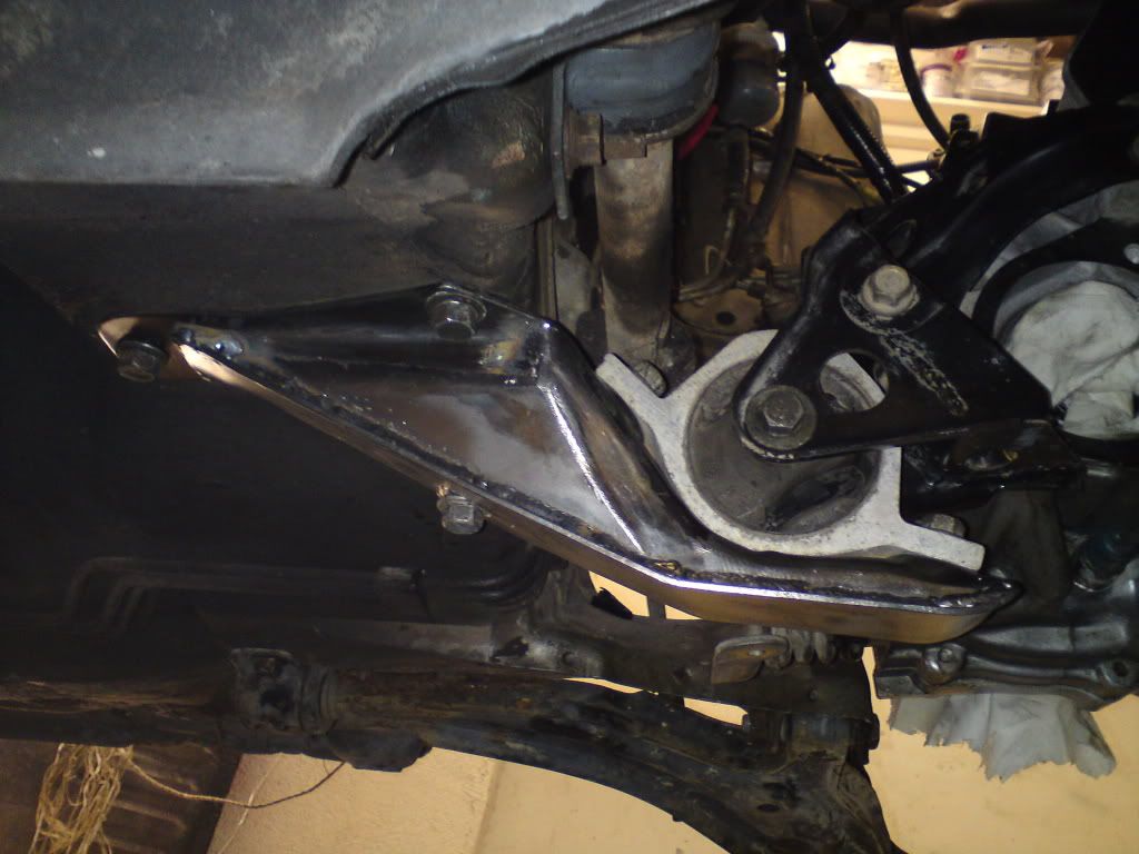

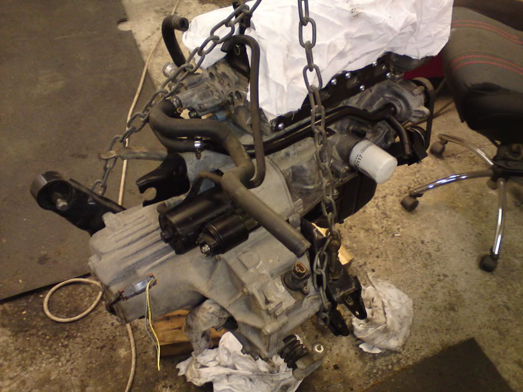

N/S mount is modified and O/S mount comes off
Engine and 'box back in to mark where the mount needs top be moved to
Marked and ready to cut

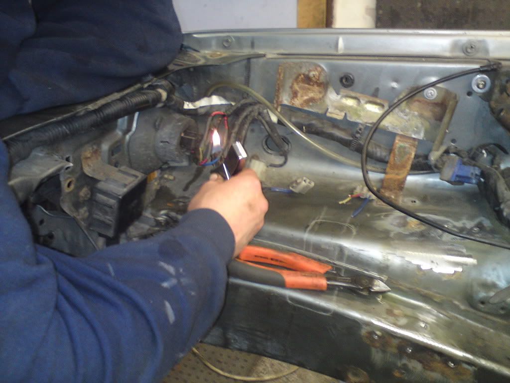

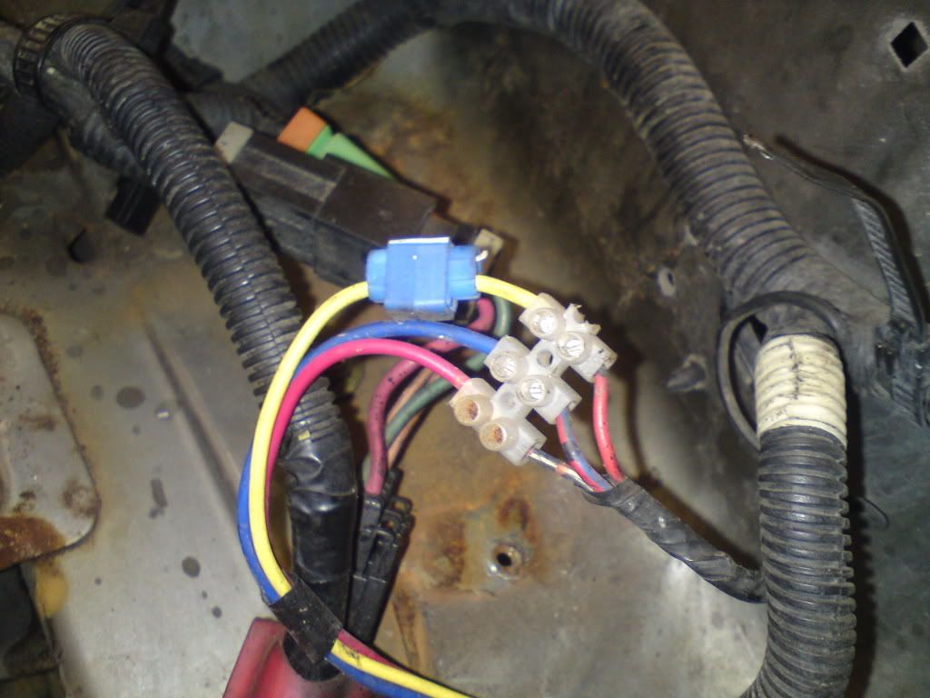

Meanwhile 24vster decides that he can't cope with seeing these unpleasantnesses in the headlight wiring anymore..........
So he removes them, solders and heatshrinks them on both sides

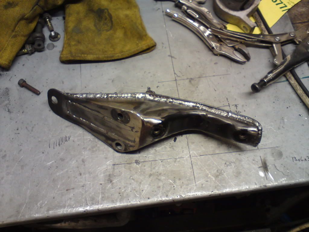

Then I can get on with modifying the mount so that it fits in its new position, and finally welding it in
Finally it sits in the hole supported by its own mounts for the first time............
If you look closely you can see that a trial fit of the front steady sees it bolted up and at a bit of a funny angle. The bush at the top end of this has a lot of (designed in) movement, so a modified bar and mount............
............ see the whole lot line up properly and with less flapping around.

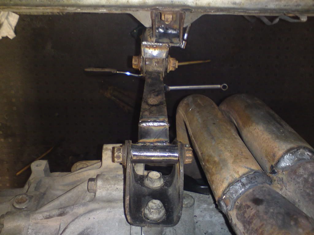

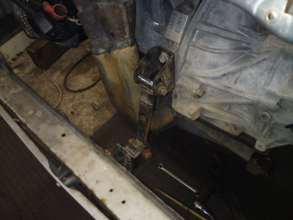

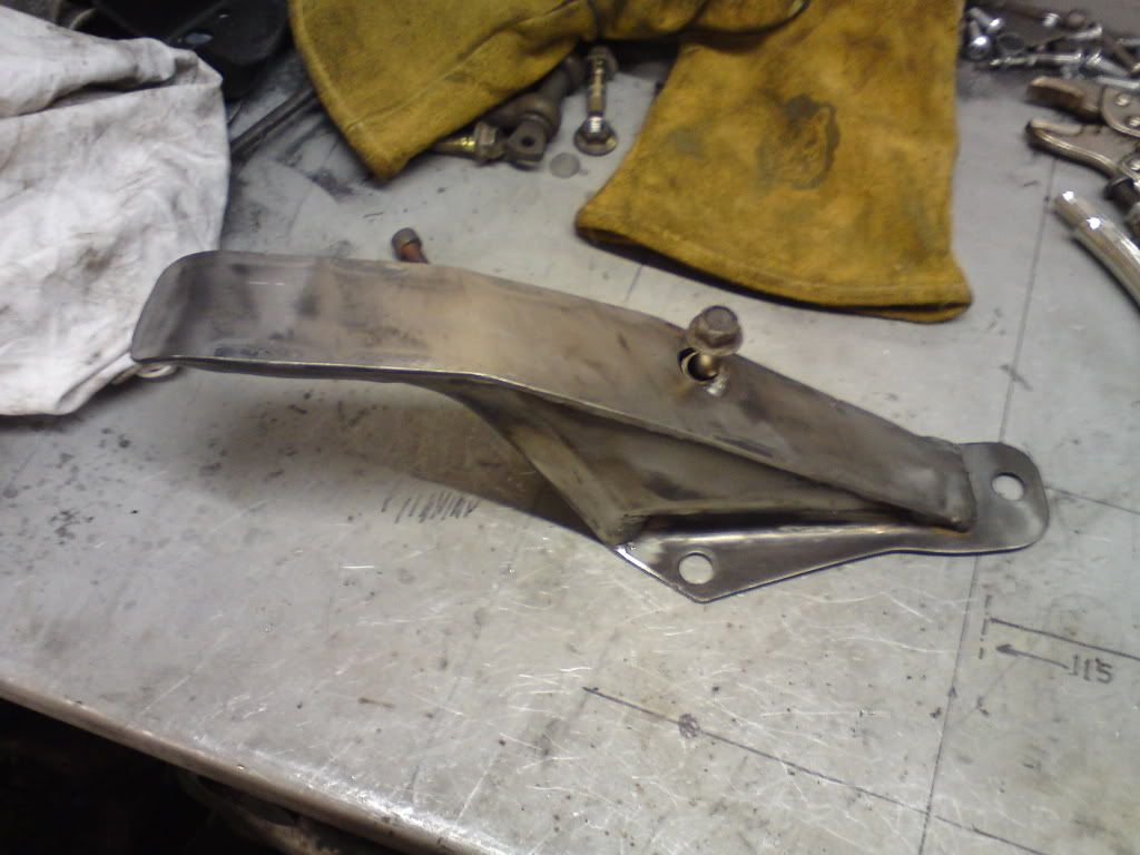

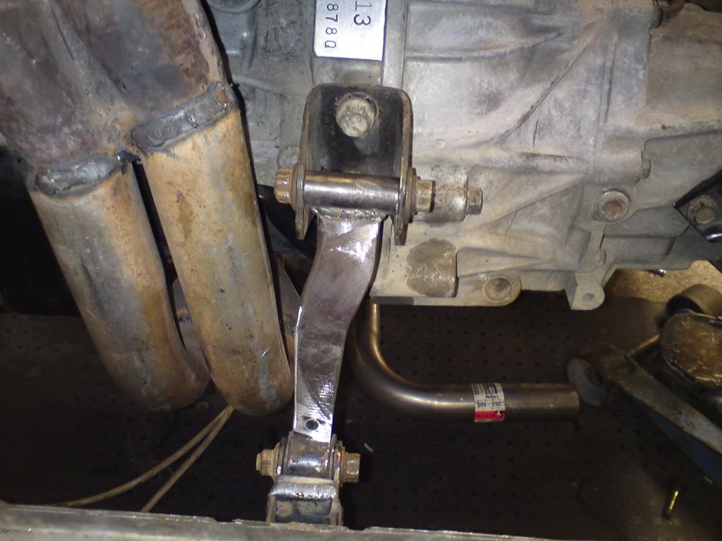

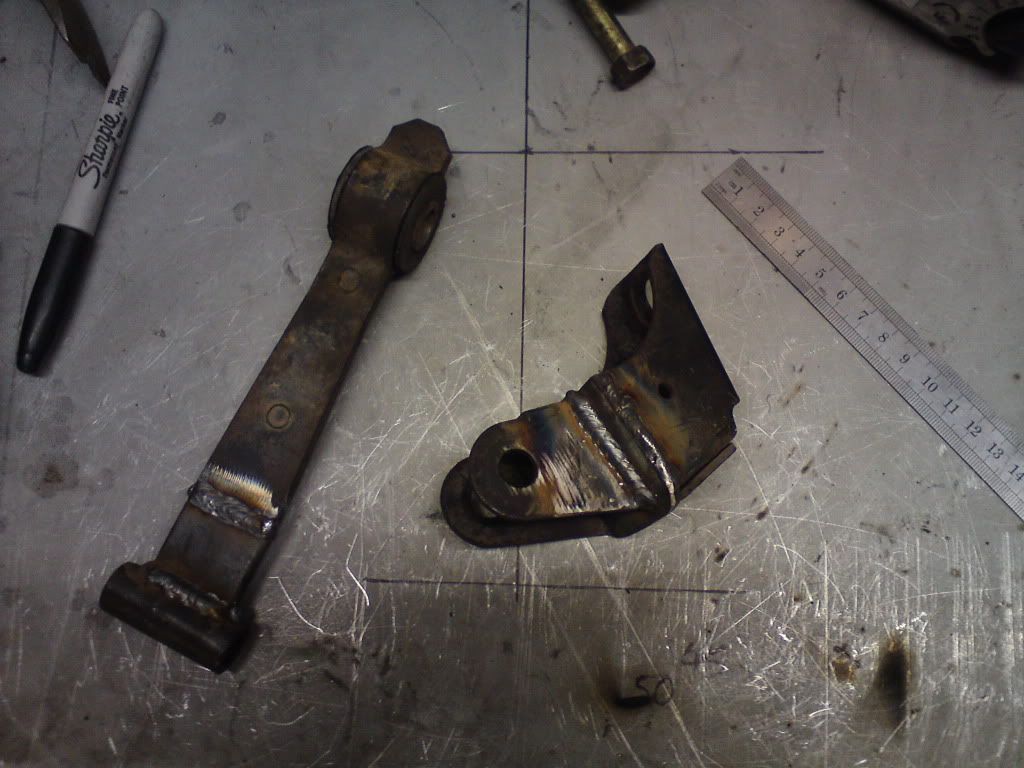

Last night I cracked into the rear engine mount as soon as I got back from work, K10 rear section spliced into a chunk of the K11 crossmember......
........and fitted :)

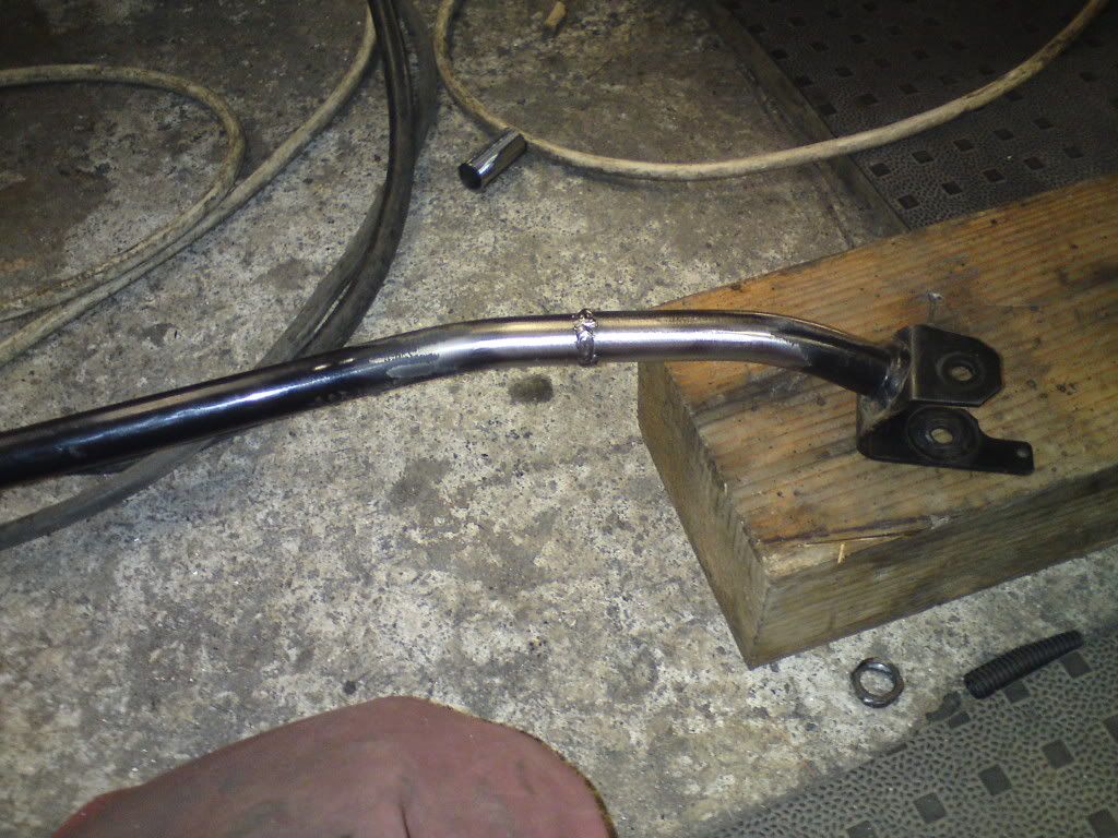

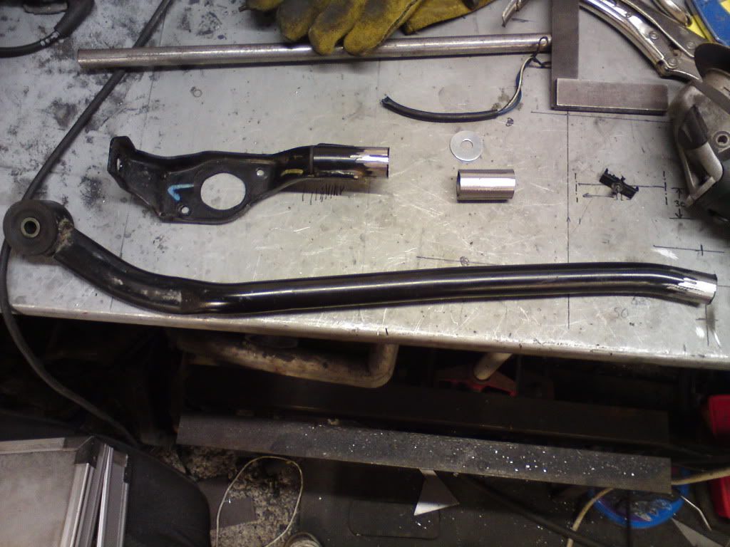

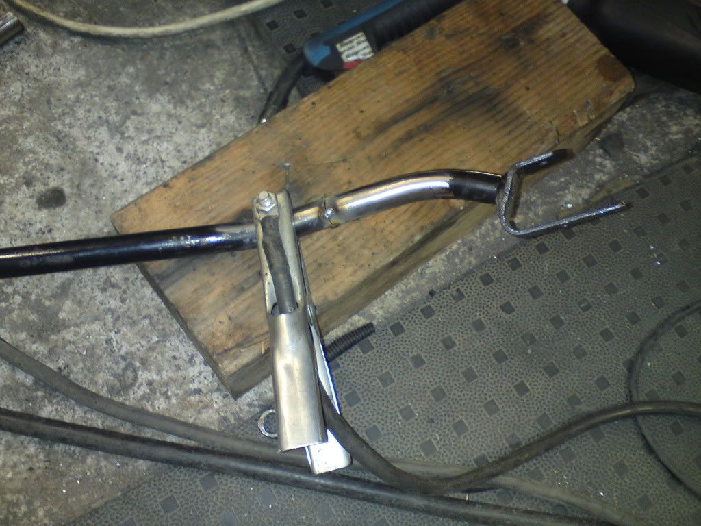

K11 Gear linkage steady bar chopped......................
.....and welded (twice 'cos I got the measurements wrong :p )
I also modified the rear where the mount attaches and drilled the floor to take the K11 mount.

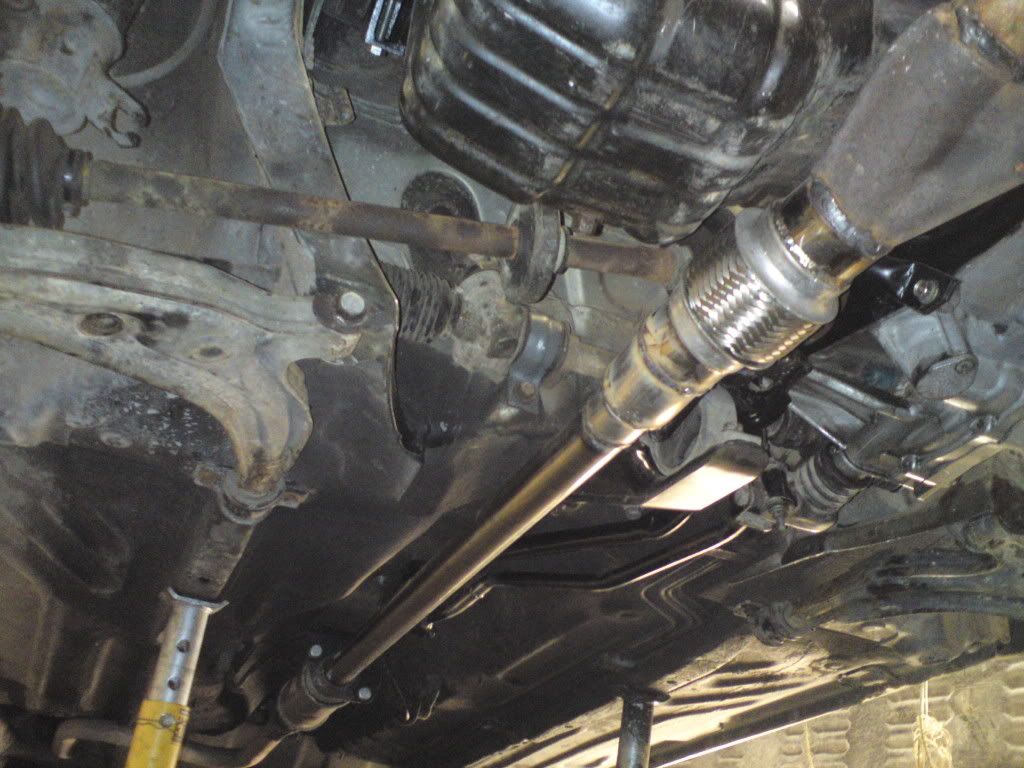

When it got too late for noisy stuff I tried the driveshafts, because I've shifted the engine and box over I only need to cut and shut the short shaft, the long shaft fits! :cool:
I also measured the exhaust and the driveshaft so that today at work I could order the bits and pieces to do the exhaust and get hold of the the old boy that did the distributor adaptor to knock me up a collar for the driveshaft.

Exhaust done, probably not the ideal set up but I don't want it to drown out the carb noise and I can't afford to build a new rear section from scratch. Probably best to give it a bit of back pressure too.
............and fitted

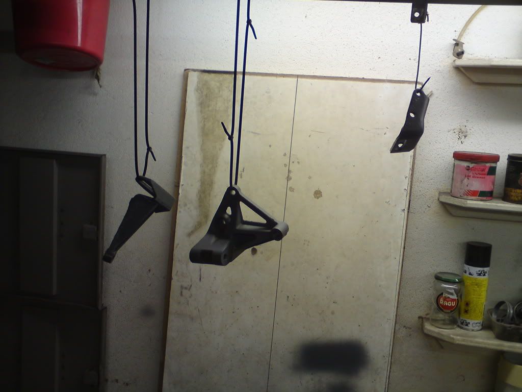

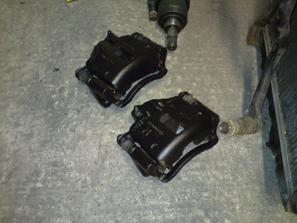

Pictures of the descaling and painting job 24vster very kindly did on the K11 calipers for me last night, cheers mate :cool:

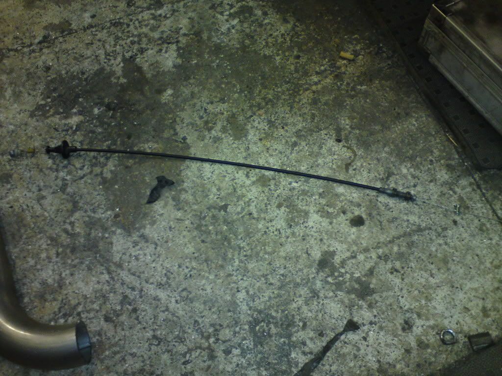

When it got too late for noise again I knocked up the throttle cable using the K10 one and a Merc Vito rear door catch cable, just got to modify the bracket on the carbs to take the adjuster and it can be adjusted to suit.

i dont know what carbs your using, or how the position of them is different to mine but i used the k10 throttle cable on its own and it was fine.
superls - it might be because I've moved the engine over, the K10 cable probably would've fitted as was but it was a bit of a tight stretch so I made the new one.

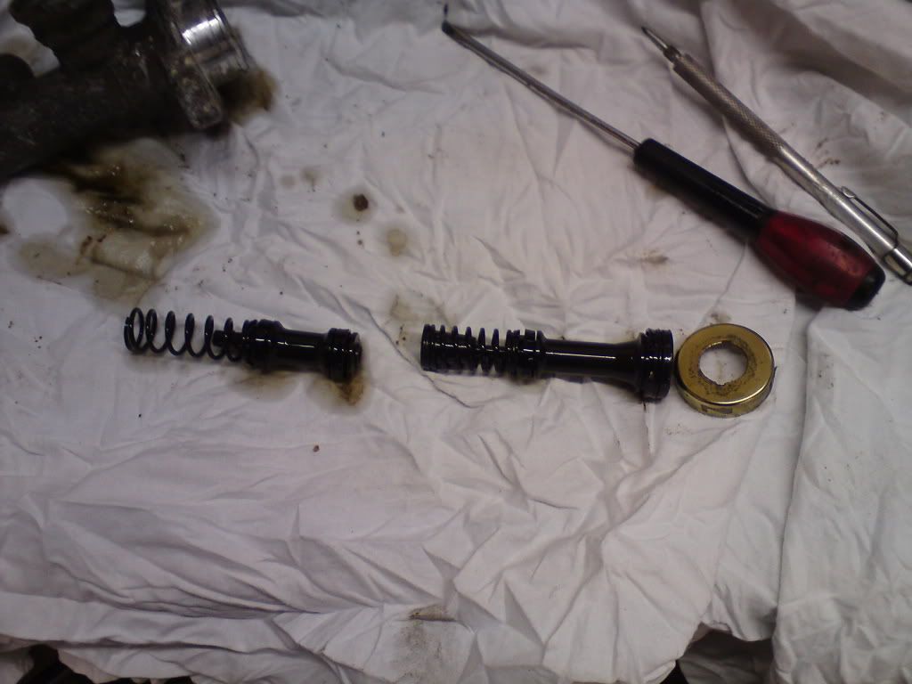

Moved onto the plumbing next, after playing about with the hoses the time came to fill it back up with water.............and it leaked like a sieve from the back of the thermostat housing :( Further investigation revealed that the area that the bottom bolt goes into had broken off from the rest of the housing. Various expletives were swung immediately into action but when that approach seemed unlikely to solve the problem we resorted to plan b: Go down to the factors and purchase some jbweld (had to go down there to get a choke cable anyway so 2 birds one stone and all that)
On my return I got busy sticking the piece back in. Although the 'kwik' version of jbweld sets in 4 minutes, it takes somewhat longer to reach the concrete like consistency needed. With every ounce of self control I have I busied myself sorting out the fuel side of the plumbing whilst 24vster and the captain fitted the new (preowned) speedo cable, fuel pump relay and wiring.
By the time that had been done the jbweld had gone off enough to allow reassembly, and after much crossing of fingers the cooling system was refilled. Success again! No water leak!

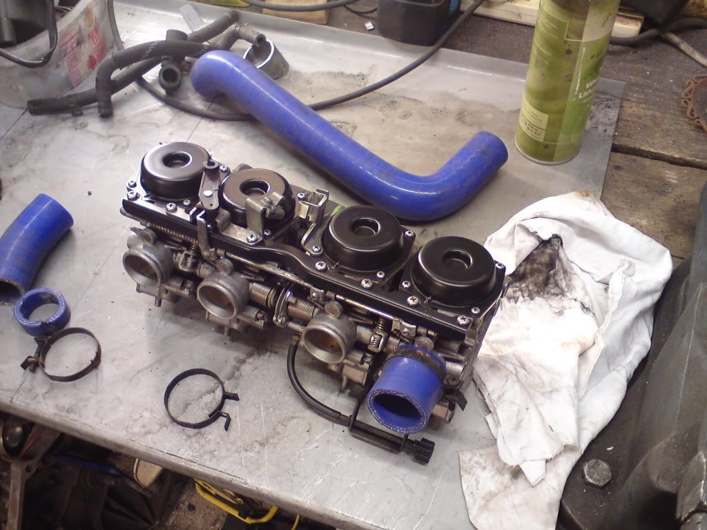

Whilst setting the timing it became apparent that the fuel was leaking out of the seals were the fuel pipe joins to the carbs, but it ran!
Off came the carbs again for some more dismantling, a further trip to Halfrauds for a box of assorted o-rings and some refitting saw it running again. Whilst balancing the carbs we noticed that at tickover the fuel pressure was too high for the float valves to stay shut meaning that we were again losing fuel, except this time out of the overflows.
Not having a fuel pressure regulator to hand meant resorting to the ghetto 'mole grips on the fuel pipe' method of fuel pressure regulation.

Last instalment left off on Saturday night, it was running but felt starved at over 3k.
So back at HQ we downloaded the CBR600 HBOL and sussed out what size jets were in the other set of carbs that I bought first.
The ones on the car had 105 main jets in, the others had 120s in, along with larger slow running jets and emulsion tubes. These were removed and cleaned ready for Sundays escapades.
Sundays first job was to remove the carbs and swap the jets and emulsion tubes. This done they were refitted, balanced and a series of test drives were done ;)
Vast improvement! Starved feeling moved to 5.5 to 6K. More power at the bottom too, still feels torquey and pulls from low revs in top gear :D I've ordered a couple of drills to take the old jets out to 130 and 140 to see what effect this will have on the power.

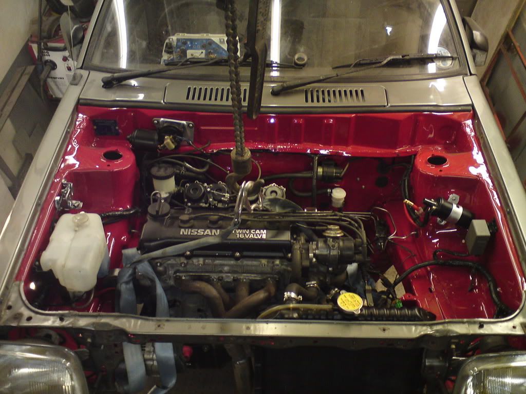

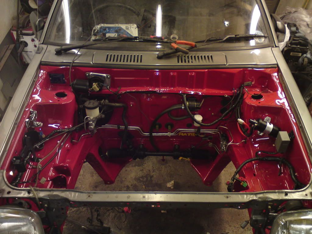

This done and with the car still sat out on the road I cleared up the garage in readiness for the pretty up. By 11pm Sunday evening the engine bay looks like this:

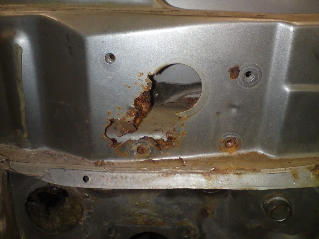

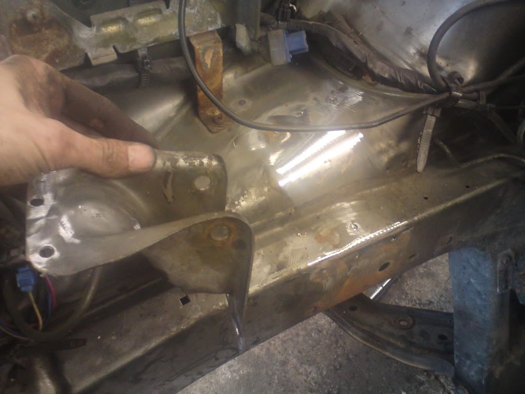

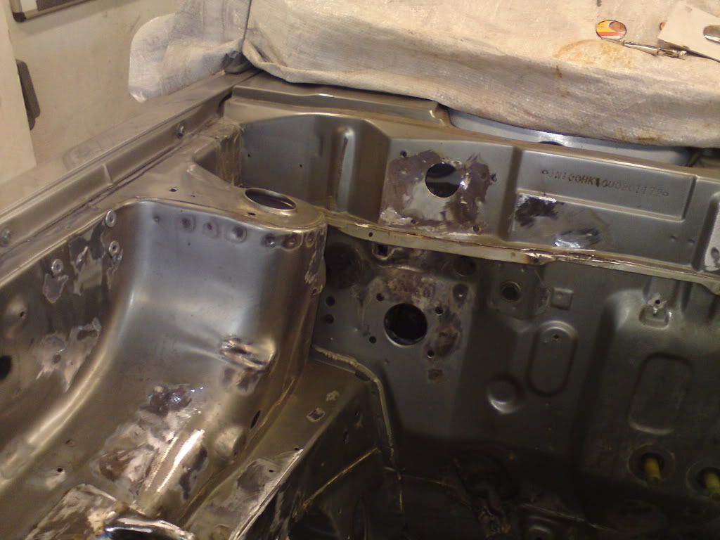

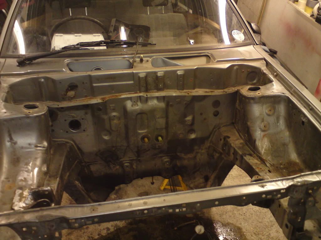

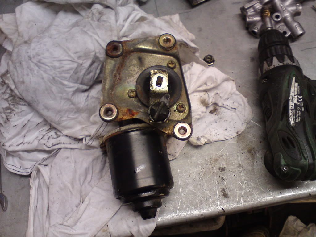

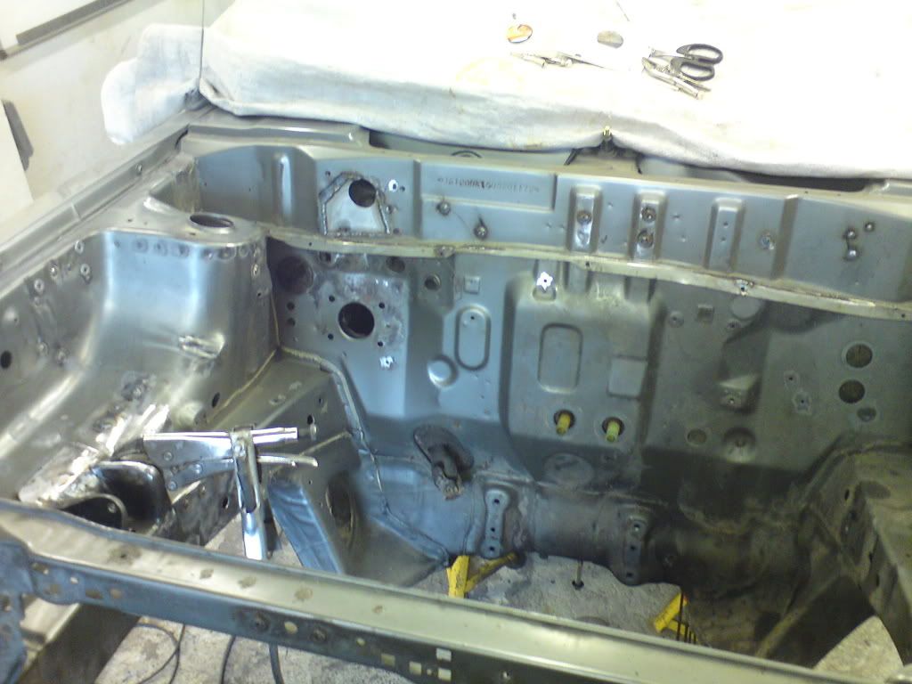

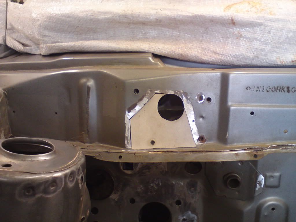

Today I started welding up the area behind the wiper motor......

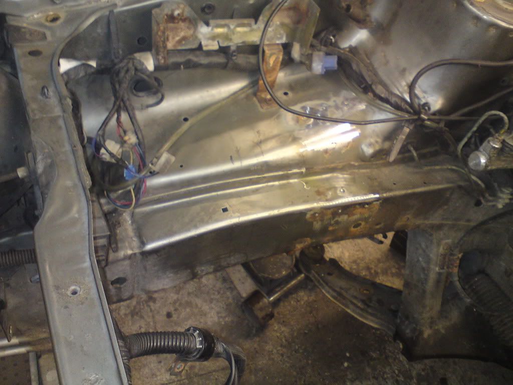

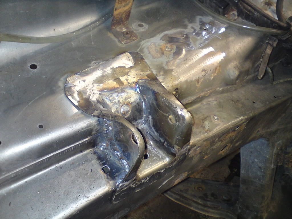

.........and started welding up the excess holes in the inner wings and chassis legs..........

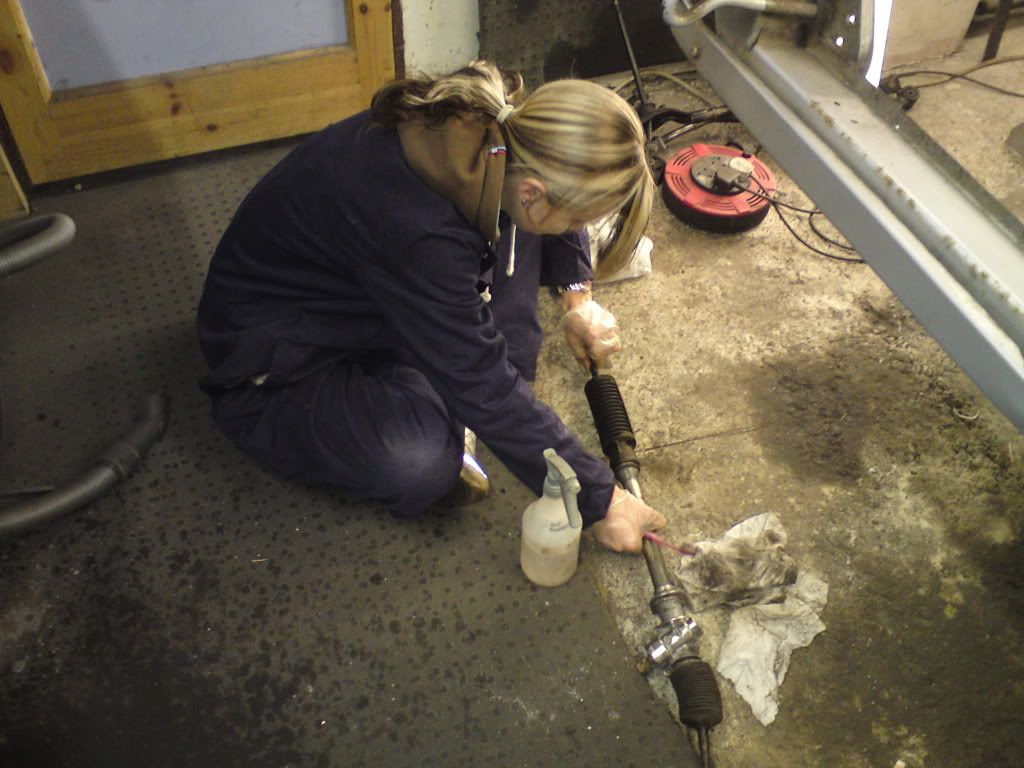

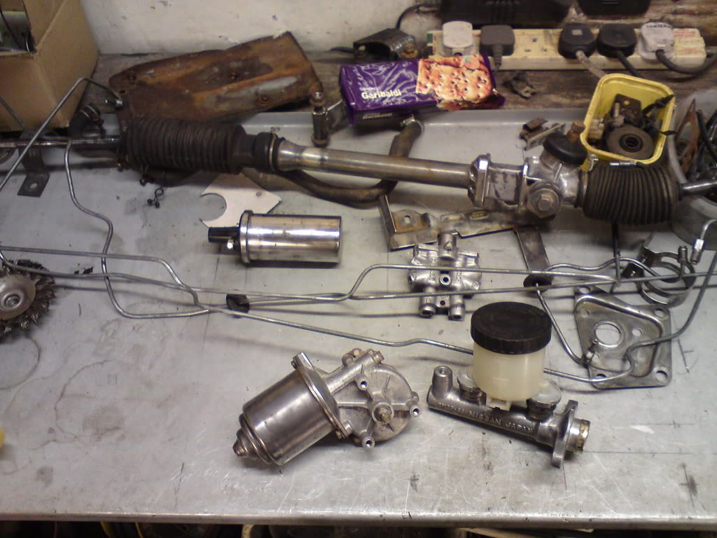

After dinner SWMBO got kitted out in an old pair of my overalls and got busy cleaning and degreasing the engine bay :grinning:
.........whilst I got on with stripping and cleaning all the bits I'd taken off, taking a few reference pics along the way to aid reassembly
SWMBO had finished the engine bay..............
............and got stuck in cleaning bits with me :grinning:
Meaning that by close of play this evening we had this pile of bits ready to paint/fit :D
More soon!
It's so pretty!

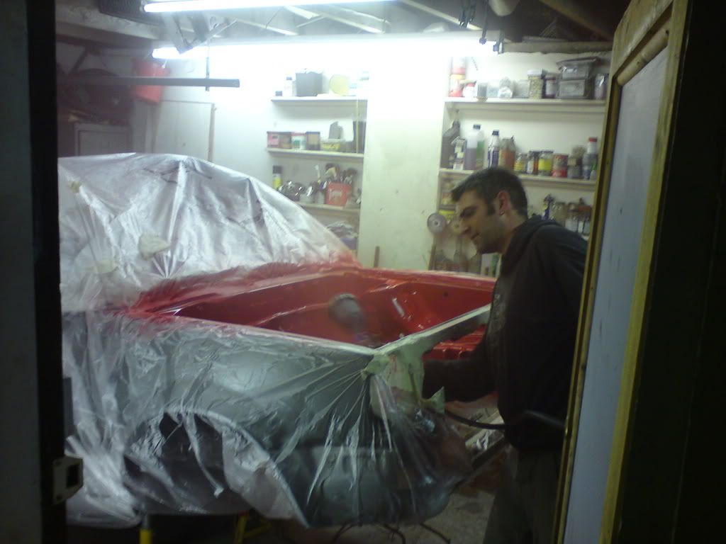

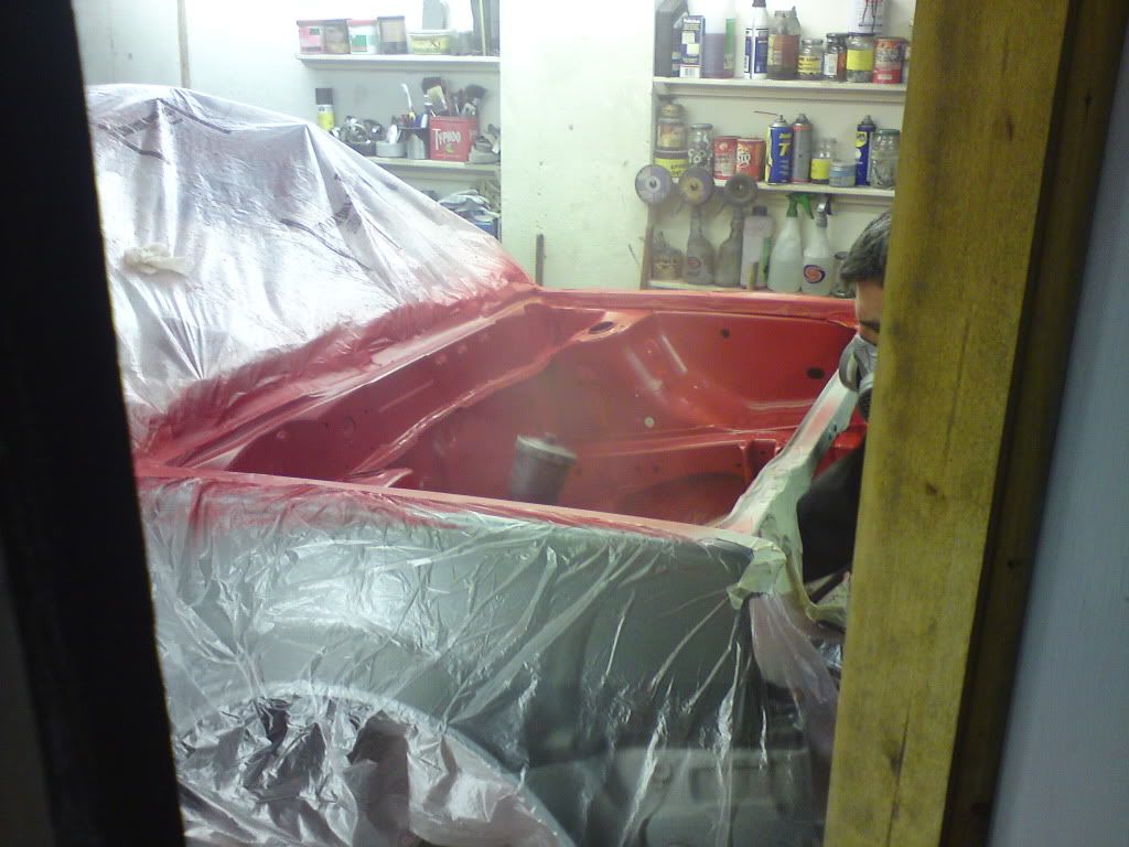

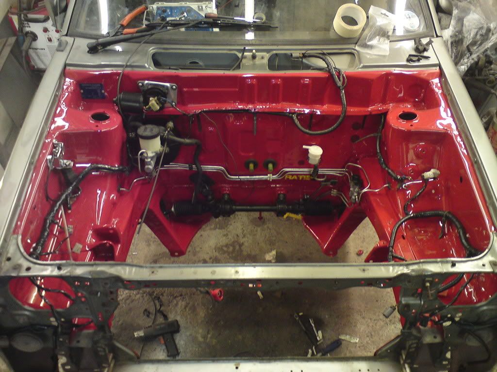

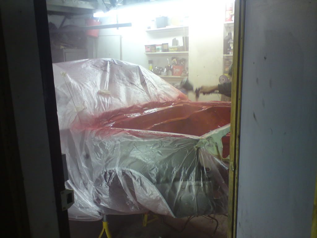

Today, after a rainy ride over to my mates on SWMBOs moped to get some scotch pads and some 400 discs, I got to work getting some filler on the welding and flatting it all down.
Took a short break to fit a towbar to a friends Audi during which my mate turned up and started masking and getting some primer on. After dinner we were straight back out there, here's Charli putting the first coat of basecoat on
Second coat of basecoat
Ist coat of topcoat
And partially demasked after the second top coat!:grinning:

More stuff to clean, more stuff to paint!

nexussteve - At the moment I'm gonna say yes, This weekend should see the carbs set up (hopefully) then I'm gonna try and do a cheeky rolling road sesh to find out for sure. It feels a heap better already with the bigger slow running jets in it pulls really strongly from low revs and the noise makes me grin like a loony :p

Yesterday was mainly spent realising just what a small proportion of the engine bay stuff I'd actually cleaned up! So lots more cleaning, painting, threading loom and brake lines all whilst trying not to scratch the paint. I think that could be why I don't usually 'do' shiny, reassembly has been such a slow process.
Close of play yesterday
Today saw more of the same, 7pm:

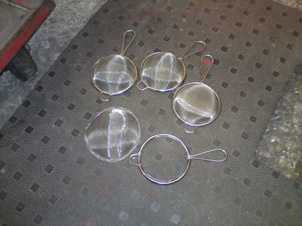

Yesterday I'd been to Sainsburys to buy some tea strainers, erm I mean air filters. This evening it was time to make them fit. Take 4 potential air filters......................
...................and rework into something that'll stop leaves/stones/nuts and bolts/small children being sucked into the carbs
Then put the engine back in, Close of play tonight, nearly plumbed :D
Damn postal strike means it looks like it'll be Saturday before my re-jetting drills turn up, Nevermind, more soon!

BUT please lose the gauze, they neither filter the air or help the flow. Get some proper filters on there as soon as possible.
i think the filters will be fine (a big surface area, and i ran my super s with no filter at all for a couple of years :wasntme:)
better still, now run 4 pipes through the bulkhead exiting behind the dash :cool: (then buy a motorbike intercom for you and any passengers lol)
