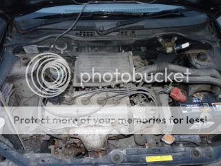

Also investigate this..

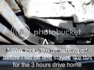

Any ideas what it could be from? oil filter leak that's made its way to there? I took a bit of a gamble buying it but as id travelled 3 hours to see it, i took the plunge and have to deal with any consequences..

Watch this space & any advice about the 'oil'(?) would be appreaciated :)

could be a sump leak from one of the half moons on the g/box from the looks of it or at worst crank seal? if you want oil go to nissan and get the genuine stuff its actually cheaper than halfrauds. i think the paint underneath is the same colour too mate.

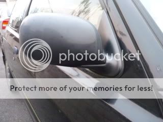

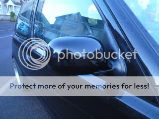

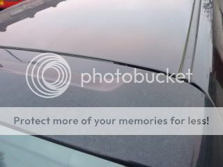

Some pics from today..
Before:
After:
Before:
After:
Whole car needs a good going over really, will wait untill ive taken bumpstrips off though :) more pics..

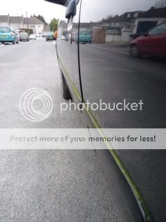

Thanks :) yours too mate! I pulled a bumpstrip off today stupidly without any heat and all (and I mean all) the glue stayed on the car :( I managed to remove about 2 inches before I gave up (it's been a tiring 4 days and the added petrol fumes didn't help..) and theres a slight ridge (cant really feel it with a fingernail) so I'm hoping it'll polish out, I took a pic at the time is this normal when removing them?..
I need sleep, up in 5 1/2 hours with a mock aerodynamics exam in the morning :(
Haha I did that with mine gave up trying to get the glue off after an hour or so..... White spirit works well and my dad suggested sugar soap (if the fumes are that bad)
try a rubber wheel thing on a drill we use it at work to remove the glue and stuff from bump strips and doesnt leave a mark! i can imagine it would if you hold it in one place
Is that a toffee/caramel/eraser wheel? Are they the same thing or different? Had a look on b&qs website and couldn't see them but tbh I wasnt looking very long
I found the easiest way to get the glue off was to hold a heat gun/hair drier over the glue until it's hot then rub like a good 'un. If theres a bit left after that wd40 helps a lot too. :)

Cheers for the advice guys (Y) i think i cocked up by not heating the strip which meant all the glue stayed on the car, just made more work for myself lol Couldnt find a toffee wheel after work, the hunt continues but i did buy some autoglym tar remover cause it said it dissolves tar and removes sticky residue so it might be nicer to my skin than petrol and still work as well (if it can dissolve tar anyway)..

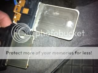

Swapped heater resistor card for the working one, was interesting to see that they were different sizes (knackered one is the bigger of the two)

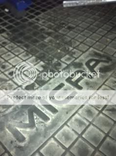

factory mats :)
No you didn't i heated mine up and glue still on the car as we speak. Possibly even melted into the paintwork...

mate i used a caramel wheel nabbed from work the other day on my strips took em off and about 40 mins later all glue and stuff removed and a t-cut then was as good as new

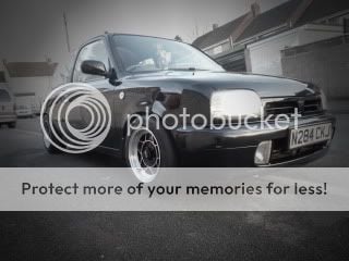

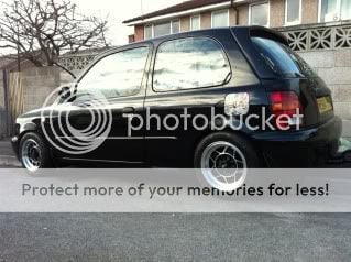

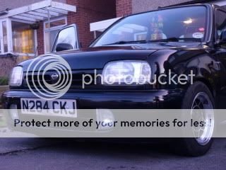

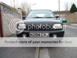

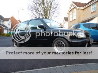

Front corsa coilovers are fitted now, bit of drama earlier when the started working themselves loose but I think they're sorted now. I'll give more info on what I did soon, but for now, here's a pic of her after a wash :)
Cheers! I took some more snaps yesterday..
New mods include: Corsa front suspension (will get around to doing the back soon), fresh gear oil, engine flush, fresh oil and filter, new plugs, matt black badges and a ruddy good clean so now there's no moss in sight haha :grinning:
