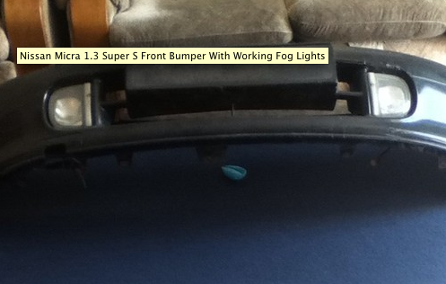

SUPER S BUMPER
http://www.ebay.co.uk/itm/Nissan-Mi...arts_Vehicles_CarParts_SM&hash=item19d4a6f2cc
