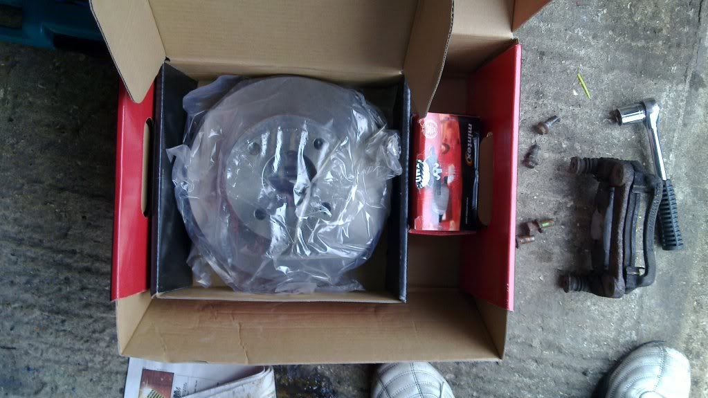

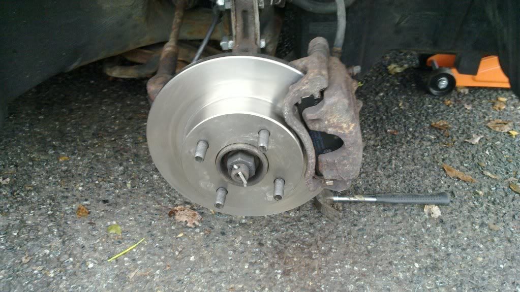

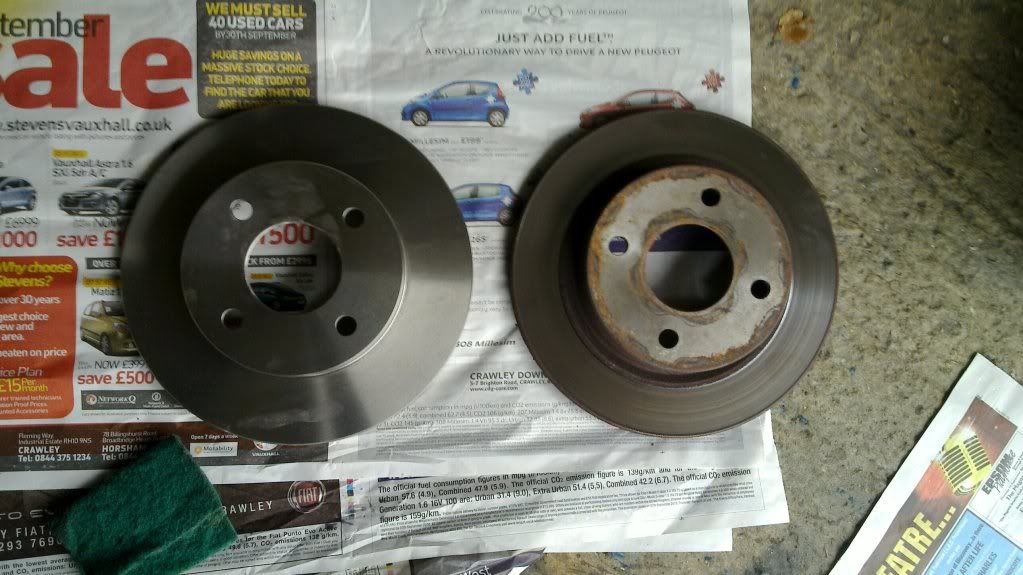

solid mintex brake discs and pads for £36 posted.
after couple of hours, lots of swearing and bashing
old vs new
cheers
thats just bigger discs and pads on the standard caliper?
well worth it if so!!
It does look bigger though but the new ones are standard 234mm in diameter so its ether optical illusion or the old one were smaller :( Still worth it I had some terrible sound coming from the offside.
I've just traced it in coreldraw and it's definitely bigger :glare:.

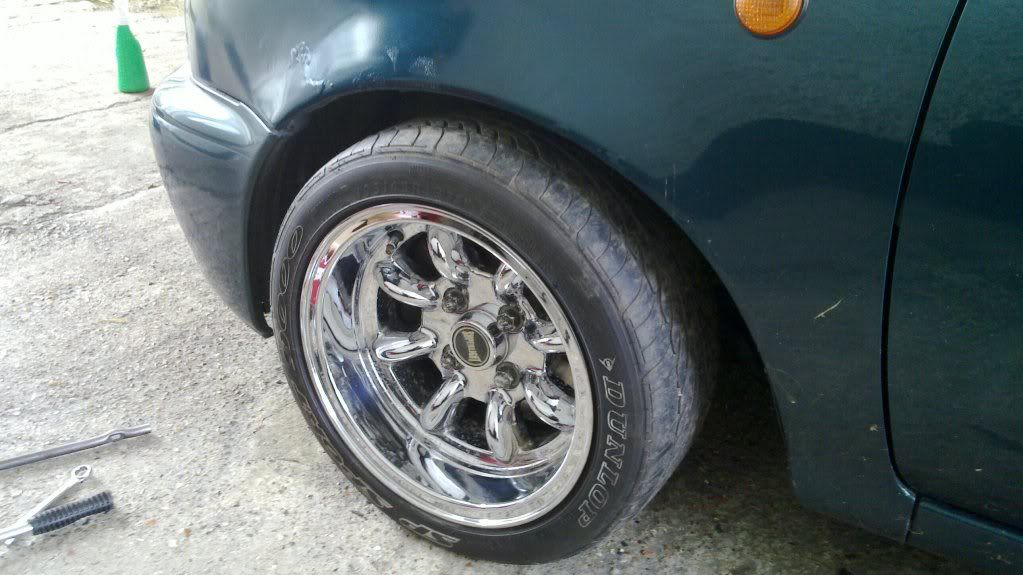

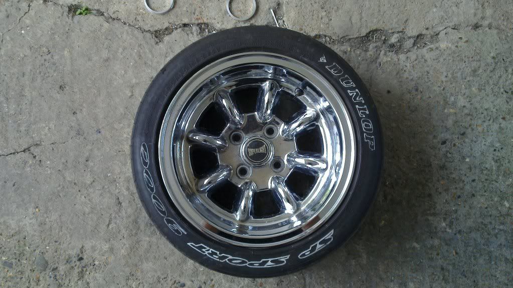

Why are they always too wide? :( 13x7 et-7 running 195/45
Is it possible to make these legal with stretch and camber or not? Could someone who is running similar wheels confirm that? cheers
Cheers guys.This is the third set Im getting for the micra and I GOTTA make it work this time. fwn I think it should be fine I just need some tyres thats not that tall or its gonna end up in the arches. Something like 165/55/R13, but they seem to be quite expensive. :eek:
165/55/R13 nankang seems to be option.
EDIT. stretch is not illegal yet
i had some of those nankangs a few years ago and they were fine when new, and lasted quite long (very poor grip when near the limit tho :eek:)
Hey, loverly wheels. Verrry similar to mine. And my tyres are 175/50 r13 if that helps with visualising anything. I personally don't think 165/55 will have enough stretch to fit without some serious camber I'm affraid(from looking at willtheyfit.com) 155/70 might fit under arch, but like you say may rub. They must be some low profile 155 r13s out there I'd have thought, but I can't find any:glare:
I hope you find a way pal, and I may follow suit at some point:wasntme:

this is 13 x 7 et 6 with 165/55 with negative camber on front, you may need an arch roll and flare buddy, wheels look awesome

Cheers man. I know i might need it. Im researching what tyre gives me the most stretch without being extreme :glare:. I really dont wanna touch the arch :(
rent an arch roller of ebay for 50 quid for the weekend, you and shuan go halves, there isnt a thinner tyre for a 7 that would look decent on those wheels, youve got your 155/70s or whatever but i doublt youd like em?
if i remember properly these are 14 x 8 and he's flared and rolled front and back, its the only way to go without bolt on arches matey
if your not sure about doing it yourself try www.archenemy.co.uk top job but pricey, good luck matey(Y)(Y)
your gonna need front and rear negative camber, stretched tyres and arch roll to get them to fit mate
may just be easier with bolt on arches colour coded mckenzie?

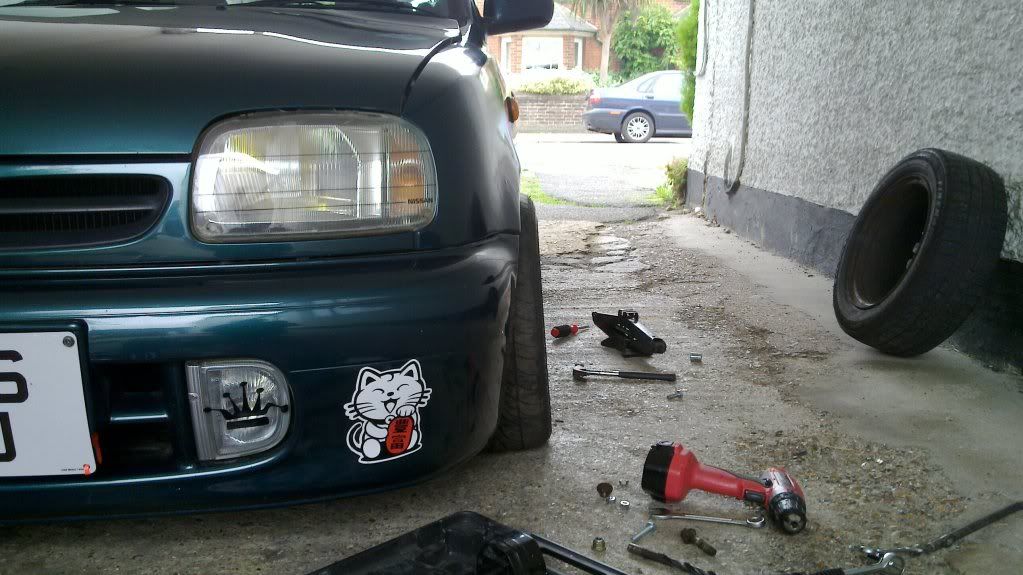

aw man. i always liked that aussie micra. the reason why i dont wanna touch the arches is that the front has been filled and rolling would make the filler crack and i dont have the money to sort them now. i will do front camber today and see how much loos is still needed.
i was actually thinking of 155/70. looks good on pics. cheers
camber bolts?
your very close their,to legal
I know mate, so close at the front, not the rear though :/
I have them camber bolts, but they seem to do big FA. This was bit of DIY. Used the drill technique on top hole and used m10 bolt in bottom. I know im gonna get slagged for being unsafe, but i dont care.
Looks awesome get the 165/55s there perfect your gonna need rear axel mod and roll your arches mate or they gonna rub
Cheers. I will get the tyres when I get my hand on some cash. I will do the rear axle when I feel for it :D lol. Not overly confident about cutting my axle and then welding in back together with my arc welder, but I guess there is not other way. :eek:
EDIT: about the arches, Im just gonna do that ghetto pipe trick
Hows your welding?
If youre not 100% confident id get someone whos a pro weld it for you...get it done cheap. :) last thing you want is a bad weld on the rear axle.
Arch widening you could try placing the jack and some blocks of wood inswide the arch and try pushing it outwards, dunno if it'll do what you need though. The pipe trick will though just gotta be careful :)
How stiff is your suspension? as the rear wheels look close the arch at the moment.
My welding is ok, but Im not 100% about welding my axle, so I will probably get someone to do it for me especially with that stiff suspension. The rear is not centered yet after the lowering.
i think boxed arches would house those wheels nicely CZ :cool:
