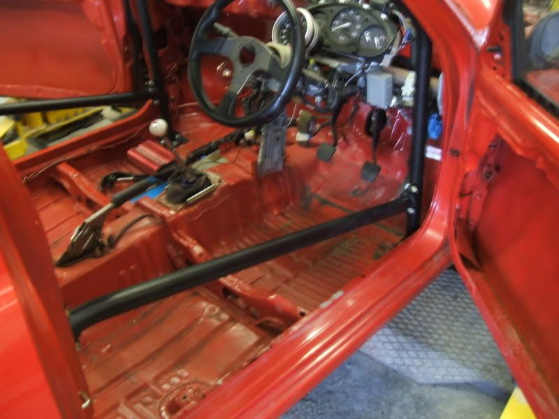

Here is are a number of pictures showing the progress so far...

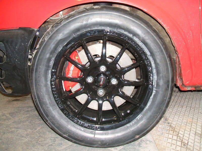

Who was it that said GTiR brakes were overkill...LOL!!!
No more drum brakes at last!!!

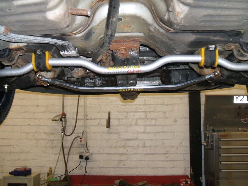

I will keep you guys updated as the work progresses over the next number of weeks. We still have to fit the wide arch kit on the front and then prep. it & paint it black. Then have the suspension setup, and then finally map it for higher boost levels.
Cheers
Dave

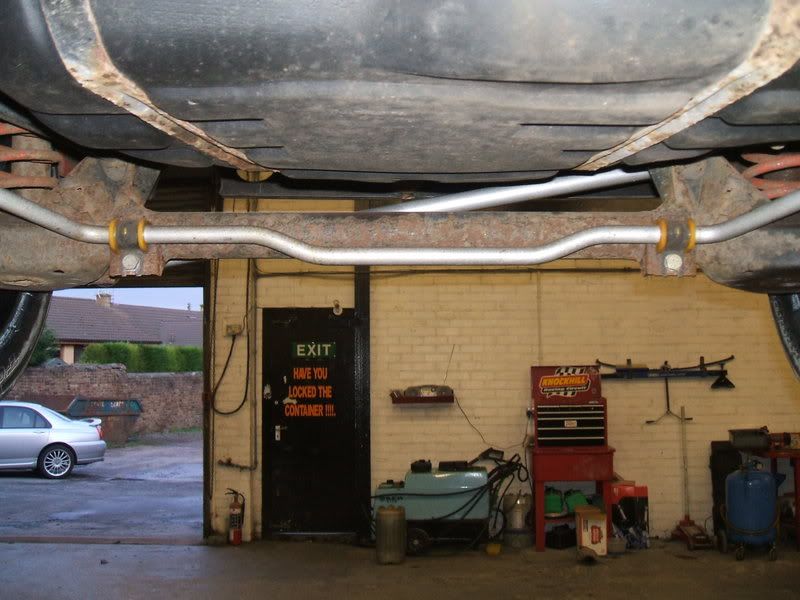

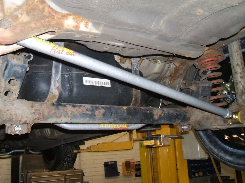

P.S. Do all K11 Micras get as rusty on the underside, or just all over in general?
looks like its only surface rust, wire brush it all off and give it a paint of black then waxoil or underseal the whole underneath
have a look under mine then... its done 107,000 miles and not a spot of it...
thats a BIIIIG brake set.... kinda what im looking for..lol
whats it running then?
The brake setup is a FASTBRAKE kit from the U.S.
It bolts straight onto the K11 hubs and you don't need any shims or crap to make it fit.
All you need is a 15" wheel (only certain ones though) or bigger to make the kit fit.
If you are interested then give Greg Vogel a call on 0017605352259 and ask him for the same kit that I have. Tell him Dave Bull with the Micra sent you.
I paid about £700 for the kit delived to my door inc. all shipping & taxes.
This included 2x racing bells, 2x 300mm discs, 2x Wilwood Dynalite 4 piston calipers, 2x stainless stell braided lines, 2x caliper mounting brackets, 1x brake pad set and all required mounting bolts & nuts etc.
They also do a slightly smaller kit with the same calipers but with a smaller disc for about £600 or there abouts.

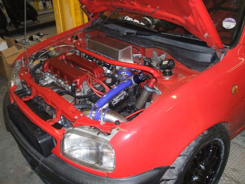

P.S. Last power figures were 409 BHP & 322 lbft & 10 psi on the last dyno. run.
a 409bhp micra?.... no one will believe me either/
i told a few guys at work and all they said was "peh its a micra" every time i mention it... all i have to say is, " theres a 400bhp micra......" and they all sulk away...

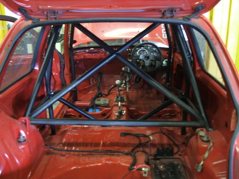

whay great minds think alike, i have the same rims and roll cage and steering wheel :)

tellin fibs...its on 105,473:wasntme:
but the master cylinder is leaking, and i cant get one anywhere.
but i asure you its rust free, i got a coment from the tester telling me where they usualy rust....not a bit of it..haha.
its down to the under side of my car being covered in a small layer of oil from a leaky engine seal... thats now been fixed. under the oil its like new,.
